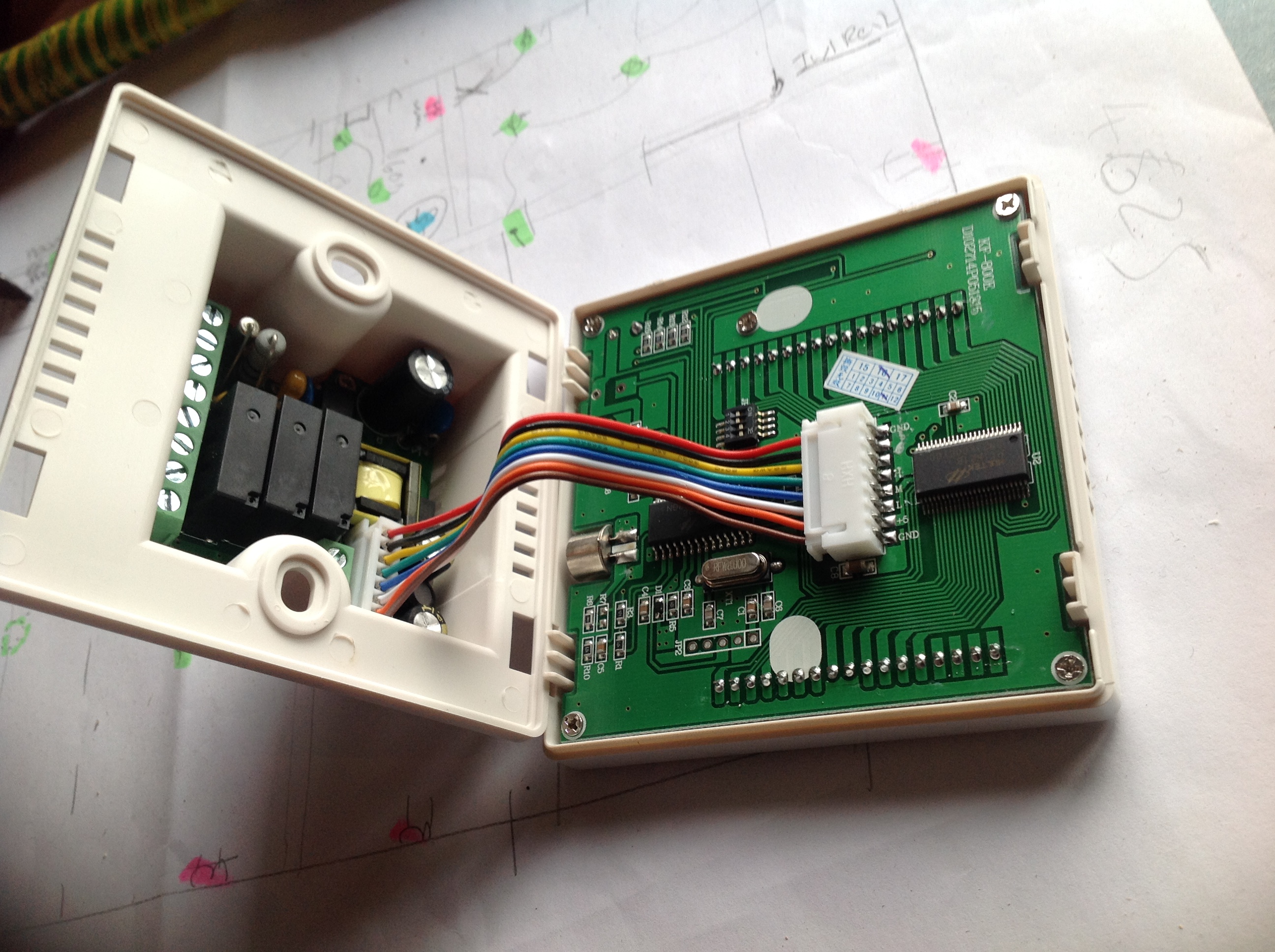

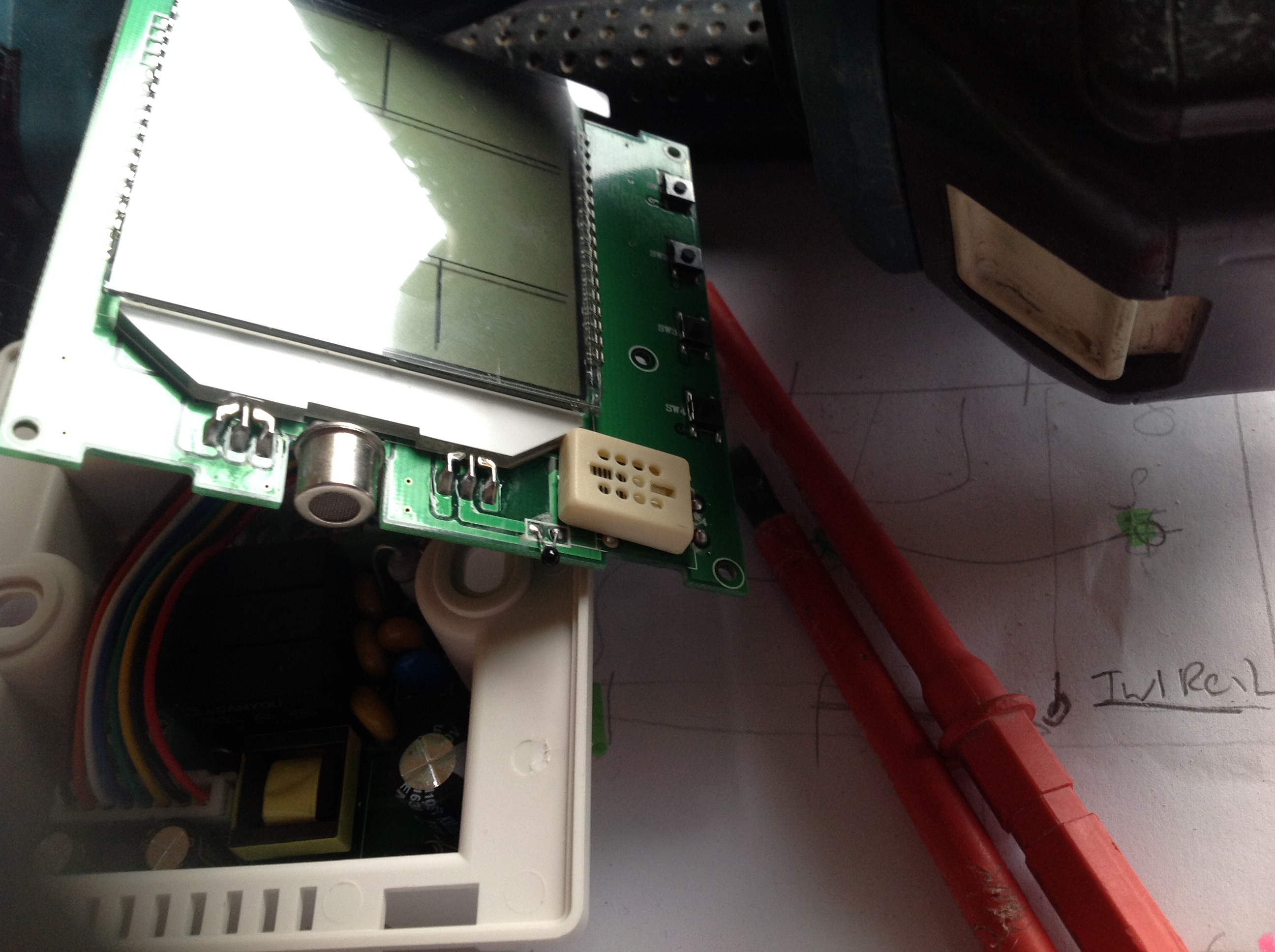

Crofter Posted May 15, 2017 Author Share Posted May 15, 2017 Ok looking inside the controller I find this: I'm guessing the humidistat will be the little beige box in the 2nd photo? Link to comment Share on other sites More sharing options...
PeterW Posted May 15, 2017 Share Posted May 15, 2017 Yep the cream one but how it's supposed to detect humidity there I've no idea..! The front looks sealed on that. CO2 sensor is the one at the bottom. I think it's a cheap 2 wire sensor - easily removed and extended on a length of ordinary bell wire ....! Just re-read the instructions - does it do humidity based fan control as it seems to say it's only CO2 ..?? Link to comment Share on other sites More sharing options...
Crofter Posted May 15, 2017 Author Share Posted May 15, 2017 There are vent holes in the casing that line up with the sensors. If the big silver one is CO2, is that tiny little black blob on legs for temperature? It is supposed to control via humidity, but the instructions do a good job of obfuscating that! Link to comment Share on other sites More sharing options...
PeterW Posted May 15, 2017 Share Posted May 15, 2017 Just now, Crofter said: There are vent holes in the casing that line up with the sensors. If the big silver one is CO2, is that tiny little black blob on legs for temperature? It is supposed to control via humidity, but the instructions do a good job of obfuscating that! Yep that's a thermistor. Any chance of a photo of the end of the beige block where it meets the circuit board ..? Link to comment Share on other sites More sharing options...

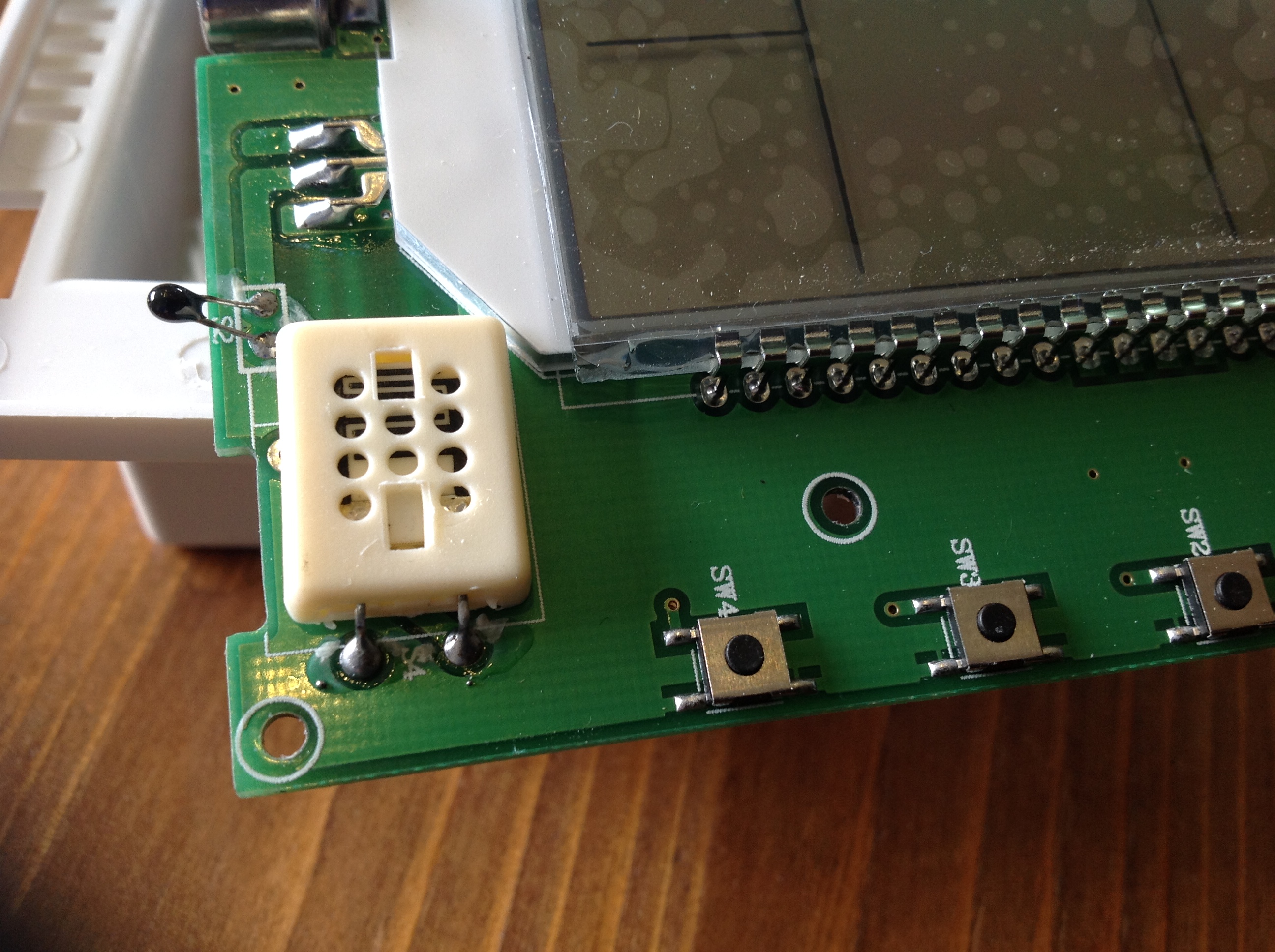

Crofter Posted May 15, 2017 Author Share Posted May 15, 2017 6 minutes ago, PeterW said: Yep that's a thermistor. Any chance of a photo of the end of the beige block where it meets the circuit board ..? Will have to wait till tomorrow. Thanks for all the help on this! Really appreciate it. I'm busy browsing google images and ebay to see if I can spot this component. Is there an easier way?? Short of unsoldering it to see if there's anything written on the reverse side... Link to comment Share on other sites More sharing options...
PeterW Posted May 15, 2017 Share Posted May 15, 2017 Just de-solder that one and extend it with a wire - should be fine if you mark the correct polarity. 1 Link to comment Share on other sites More sharing options...
Temp Posted May 15, 2017 Share Posted May 15, 2017 Pretty sure that yellow/cream/beige thing will be the humidity sensor. I couldn't google up an exact match but take a look at google images.. https://www.google.co.uk/search?q=humidity+sensor&source=lnms&tbm=isch&sa=X&ved=0ahUKEwjznqWW6_LTAhXqKMAKHRrMBEEQ_AUICygC&biw=1340&bih=779#imgrc=_&spf=1494883538482 Look in through the vents, does it look a bit like this inside? Link to comment Share on other sites More sharing options...
PeterW Posted May 15, 2017 Share Posted May 15, 2017 (edited) That looks very "binary"...... Edited to add that I've just looked and these are good to 3% accuracy ..! Can pick them up for £2 on eBay so removing the old one intact may not be an issue. Edited May 15, 2017 by PeterW Added info Link to comment Share on other sites More sharing options...
Crofter Posted May 16, 2017 Author Share Posted May 16, 2017 @PeterW @Temp See closer up pic- looks like you are right on the money. I have an electronics engineer friend who I might enlist for this as he's bound to have a steadier soldering hand than I do! Would it be worth hooking up a little jack socket, or maybe just a wago or chocblock, to connect the extension wire? Link to comment Share on other sites More sharing options...
PeterW Posted May 16, 2017 Share Posted May 16, 2017 I would just de-solder that and get it onto some wire - use something reasonably "chunky" like a speaker wire as these work on resistance so you want to not affect that if possible. You could just use a 3.5mm mono jack for ease - £10 would get you an extension of 10m which should easily be enough to get into a duct. Link to comment Share on other sites More sharing options...
ProDave Posted May 16, 2017 Share Posted May 16, 2017 Just use the small size wago's as good as anything. It's not like you will want to unplug it often is it? If trying to remove that, the tip is a really hot soldering iron as you have to heat the mass of the board and the plated through hole. Heat the solder that's there and one leg at a time pull the component out. Only then use a solder sucker or solder wick to clean the hole out. If it's lead free solder, a little drop of 60/40 applied will make it flow a lot better. If you can't desolder it without messing up the board, just snip the wires as close to the board as you can. Solder the new wires onto the board and there should still be enough on the sensor to solder onto. 1 Link to comment Share on other sites More sharing options...
