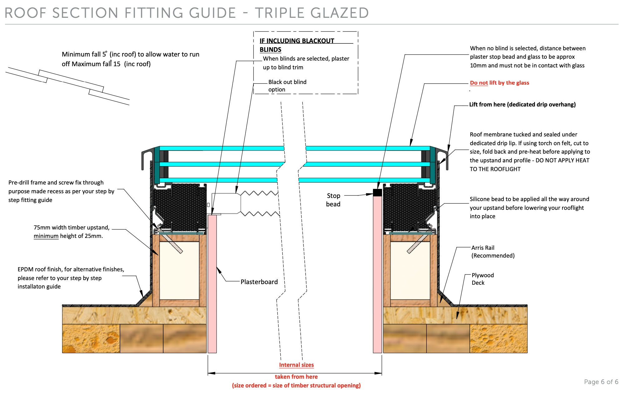

Dreadnaught Posted April 20, 2022 Posted April 20, 2022 This is for my flat roofloghts (I have nine in my new build). Hope it helps.

Tony K Posted April 21, 2022 Author Posted April 21, 2022 Thanks @Dreadnaught that's very useful. Is the upstand shown in the detail a pre-produced one? It doesn't look like something a person would make themselves. I am veering towards making this kind of thing, then adding insulation into the gaps between the beams, and perhaps across the face of the beams too. 1

Dreadnaught Posted April 21, 2022 Posted April 21, 2022 3 hours ago, Tony K said: Is the upstand shown in the detail a pre-produced one? No, not pre-produced by the manufacturer. It is for the customer to make their own up-stand. In my case I entrusted the up-stands (all nine of them, and complete with their 5º fall) to my timber-frame designer and the up-stands were installed along with the rest of the timber frame. All I had to do was plonk the rooflights atop with some glue and screws. It was an easy install. In fact the biggest challenge was not the up-stands or the installation. It was getting the biggest of the rooflights, at 152 kg, on to the roof in the first place. (I am sitting under that rooflight now as I type this.) 1

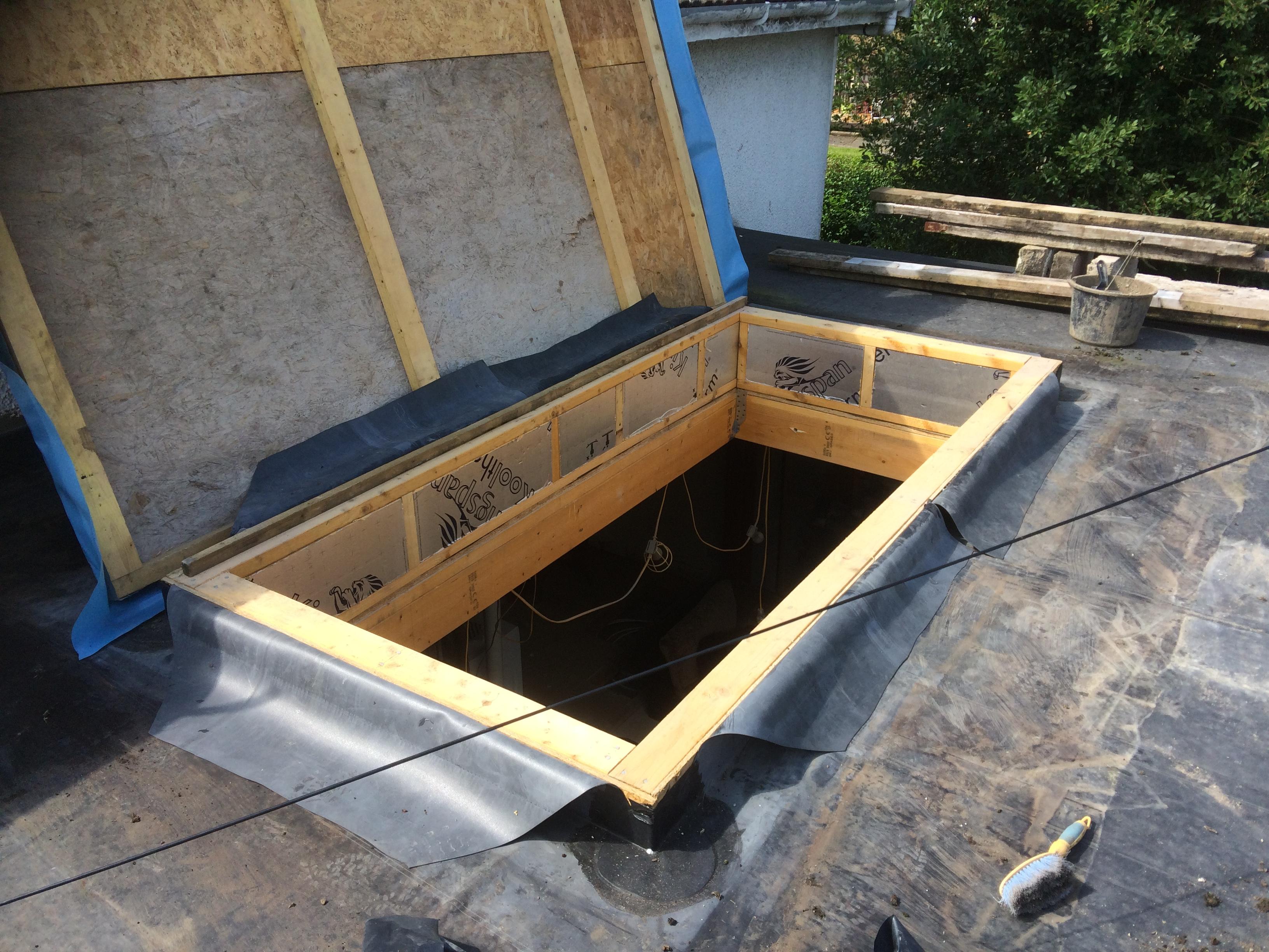

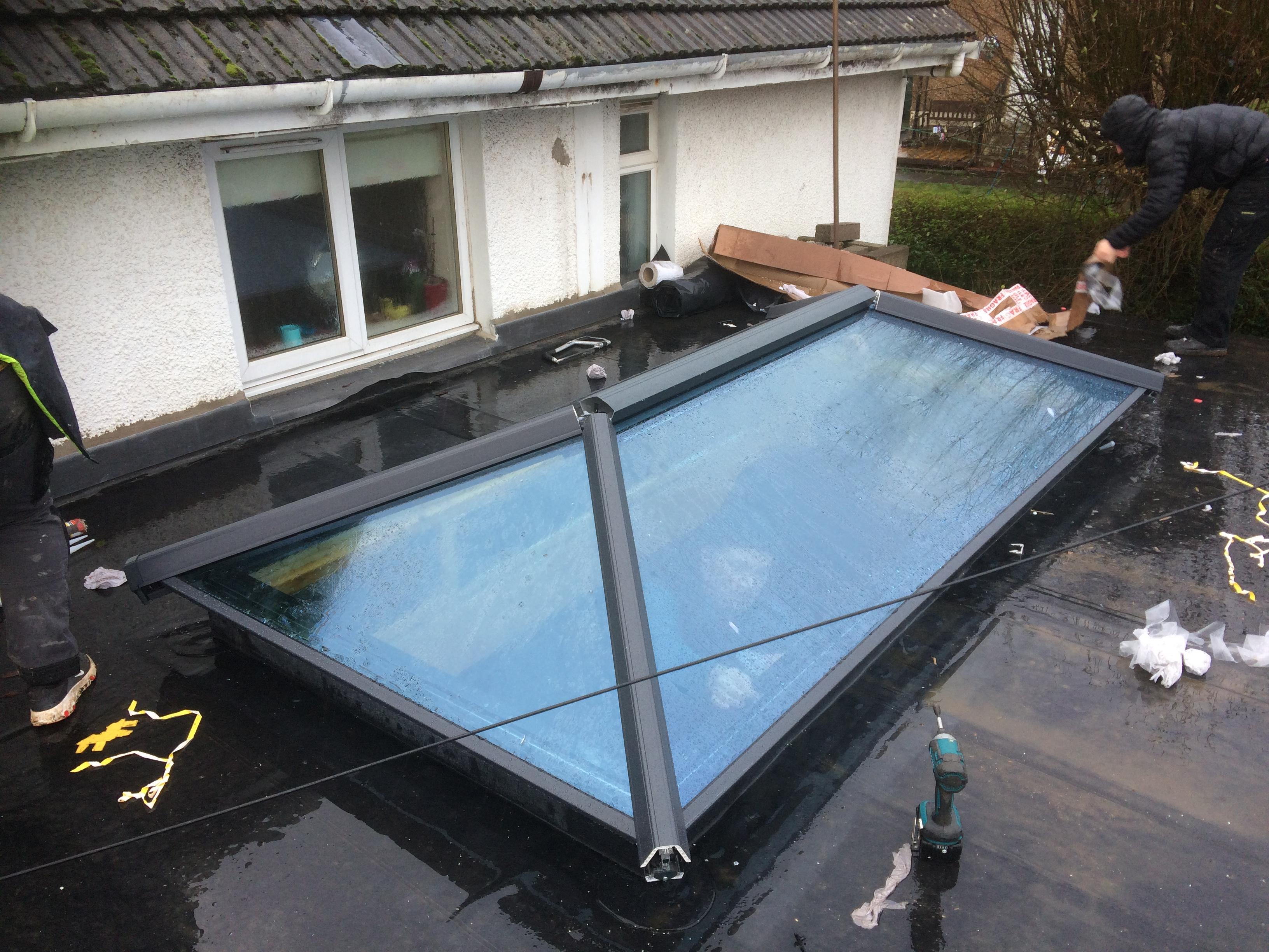

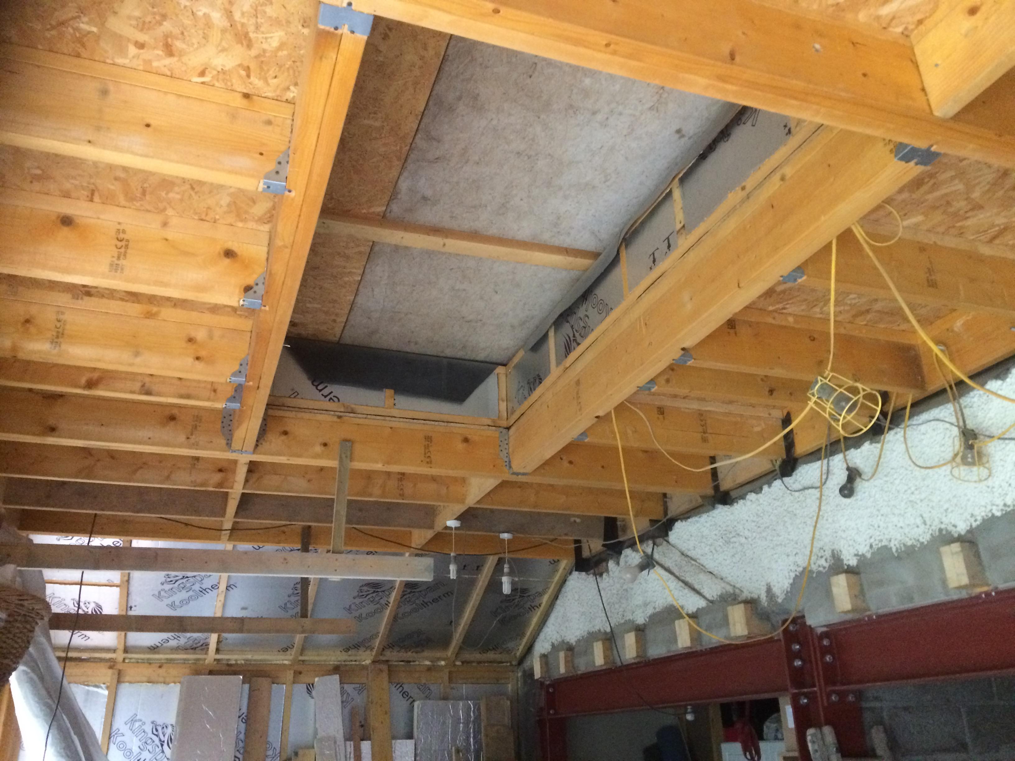

Gus Potter Posted April 21, 2022 Posted April 21, 2022 A few photos of mine. Warm roof. Upstand 150mm, don't skimp on this as in the regs and also you get snow building up round about it, you also can get splashing from the rain.. funnily you can see this in the regs when they say a DPC should be 150mm above ground level. Over kerb size in the photos is 1420 wide x 2855 long. Upstand is framed in 95 x 45, 70mm PIR between and lapped with 200mm of PIR inder the EPDM covering so only 150mm is exposed at the 70mm insulation thickness. Opted not to do insulated plasterboard on top as it was closing in the aperture. Instead accepted that the upstand would be less well insulated and did compensatory U value calc and upgraded the rest of the insulation. Basically the lantern was so expensive that there was no way I was going to shut down the effective opening any more than I had to. Light is fantastic. Still need to do the roof of the main house.. soon! 1
Tony K Posted April 22, 2022 Author Posted April 22, 2022 Very nice @Gus Potter. I note your comments on the trade off between a smaller aperture and better insulation (although you've hardly scrimped, even in the upstand). I have a cold deck roof, and I feel that I will need to narrow the internal opening by lining the upstand with a little extra PIR to address the tendency for cold bridging. I am using a flat roof flat skylight, so I have to build a slight fall into the upstand, whereas you (I presume) would build yours flat and level to accept that lantern?
