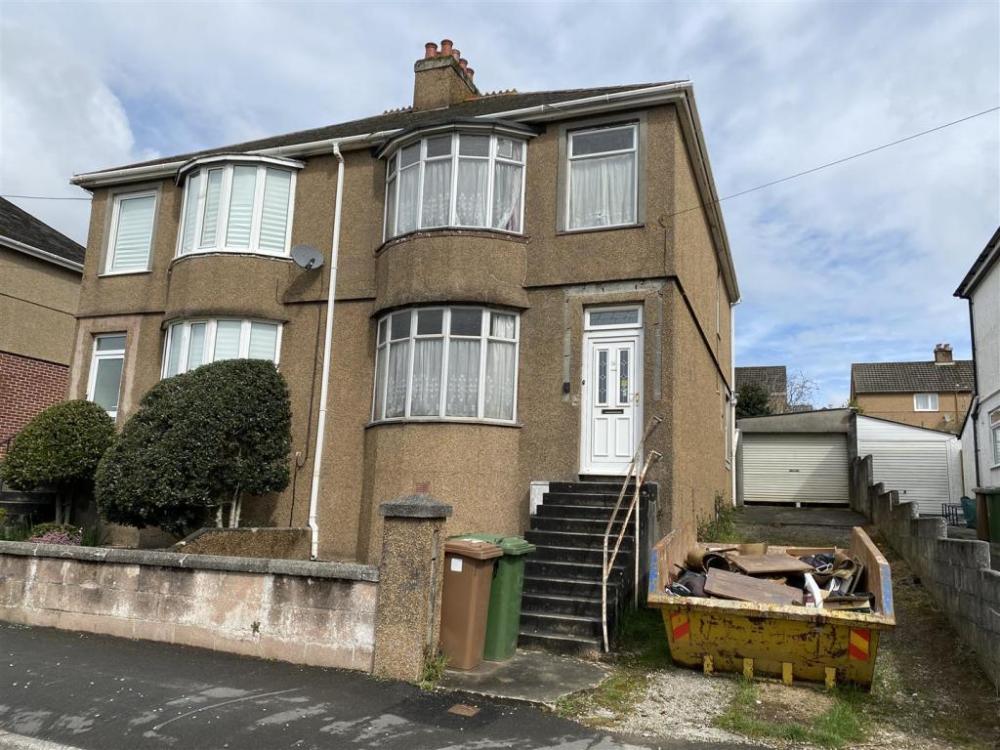

RedMango Posted April 23, 2022 Author Posted April 23, 2022 5 hours ago, Russell griffiths said: Sorry but you have picked the wrong type of house, you would need to update that by such a huge amount it would cost far more than it’s worth. You can update it and add good amounts of insulation, but to get it to a point of low energy bills, you will need to rip the lot back to bare plaster, all floors up, windows out and resize the openings to take insulation on the reveals. It can be done, but you need to ask yourself is it worth it, chucking £100 grand plus at something. You could do it up and make some cash and move on to the next project, with the aim to build a real good one one day. To be honest that sounds exactly like i was planning on doing. Minus the resizing of the window openeings as i didnt know about that but most have rotted away so they've probably resized themselves. We will be throwing at least 50k into the house maybe more down the line as we plan on keeping it for 30+ years after which ill kids will have it. But i do get your point that its partly wasted. I think after doing more reading im going to stick with radiators i think most are right in saying i will never get the house efficent enough to benifit from UFH.

HughF Posted April 23, 2022 Posted April 23, 2022 52 minutes ago, RedMango said: To be honest that sounds exactly like i was planning on doing. Minus the resizing of the window openeings as i didnt know about that but most have rotted away so they've probably resized themselves. We will be throwing at least 50k into the house maybe more down the line as we plan on keeping it for 30+ years after which ill kids will have it. But i do get your point that its partly wasted. I think after doing more reading im going to stick with radiators i think most are right in saying i will never get the house efficent enough to benifit from UFH. Size the rads for a flow of 45 deg and you’ll be future proofing yourself. As I said, irrespective of what you use to generate the heat, do try and do a heat loss calc and rad sizing exercise. It’s well worth an hour with a tape measure and half an hour in front of excel. 2

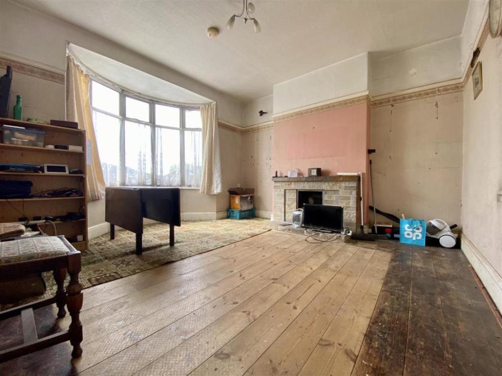

Iceverge Posted April 23, 2022 Posted April 23, 2022 200mm EWI, rewire and new 3g windows. 300mm + attic insulation. Mineral wool batts in suspended floor supported by membrane drooped between. 2 X split unit A2As. One upstairs and one downstairs. ESHP for DHW. No wet CH. You can include a spur for a spare electric rad if you think you'll need it. (I bet you won't) It's the cheapest "proper" solution I can think of. 1
RedMango Posted April 24, 2022 Author Posted April 24, 2022 18 hours ago, Iceverge said: 200mm EWI, rewire and new 3g windows. 300mm + attic insulation. Mineral wool batts in suspended floor supported by membrane drooped between. This is exactly what I'm planning apart from the floors will be half PIR and half Wool and I don't have the funds for EWI yet but its the next stage. I'm not au fait with the abbreviations sorry, what are A2A & ESHP?

RedMango Posted April 25, 2022 Author Posted April 25, 2022 Thanks. Any particular reason for the air con? We have windows open regularly? I'm definitely going to size the rads and pipe work ready for a ashp but I'm just not ready to take that leap. I'll just run a combi at a low temp and when it breaks replace it with one. I'm not sure I'm doing the heat loss calcs right. Used 5 or so online and all give me between 5.5k BTU to 8k BTU (just working off the living room ATM till I can grasp the calculations etc. If I'm to work of a delta of 30 instead of 50 then it's about double so I'd need a output of around 15k BTUs ?? 😂 Or am I missing something

RedMango Posted July 22, 2022 Author Posted July 22, 2022 Update: Hi all thanks for the input. So house is due to complete soon and waiting to hear back from a survey in the next week before exchange. I have found out though that the house is a lot more insulated that previous thought. It has/will have triple glazing, insulated cavity walls, insulated suspended timber floor, insulated roof. I still haven't decided between getting a ASHP or Combi but I'm doing lost of heat loss calcs and getting averages so ill come back with more precise numbers but a ball park is between 900 - 1400w per room. As my 1st job on the list when moving in is to take up the floor for rewire, insulate and plump. Do I install UFH or Radiator pipe work?

Adsibob Posted July 22, 2022 Posted July 22, 2022 On 23/04/2022 at 09:47, Russell griffiths said: Sorry but you have picked the wrong type of house, you would need to update that by such a huge amount it would cost far more than it’s worth. Well that rather depends where the house is. I just spent several hundred thousand pounds doing exactly what @RedMango is proposing to do. We did go somewhat ott, ripping out the joists, putting posi joists in so that we could do MVHR, new roof joists as well, new roof, new windows, new floors, new ceilings, new everything really except 3 walls of the house. But even those were refurbished from inside and out. Unrecognisable from original house. It still cost me less than half what I paid for the house, and now the house is worth much more than what I paid for it (even including the £kkkkkk we’ve invested in all the works.

Russell griffiths Posted July 23, 2022 Posted July 23, 2022 @RedMango are you sure about the cavity walls.
RedMango Posted July 23, 2022 Author Posted July 23, 2022 28 minutes ago, Russell griffiths said: @RedMango are you sure about the cavity walls. As sure as I can be without looking myself. But both reports have come back saying it is and the searches found the council had an application for cavity wall insulation to be fitted on the property. I'll of course double check once I've got the keys but the previous owner from what I gather was a bit of a builder/DIY enthusiast so makes sense he had it added back when there was the big push by the gov to get home cavity's insulated
Russell griffiths Posted July 23, 2022 Posted July 23, 2022 1 hour ago, RedMango said: As sure as I can be without looking myself. But both reports have come back saying it is and the searches found the council had an application for cavity wall insulation to be fitted on the property. I'll of course double check once I've got the keys but the previous owner from what I gather was a bit of a builder/DIY enthusiast so makes sense he had it added back when there was the big push by the gov to get home cavity's insulated Ok, I thought in the 1930,s it was all solid 9inch brick.
RedMango Posted July 23, 2022 Author Posted July 23, 2022 Now i've done some proper heat loss calcs the rooms are between 500 and 900w
