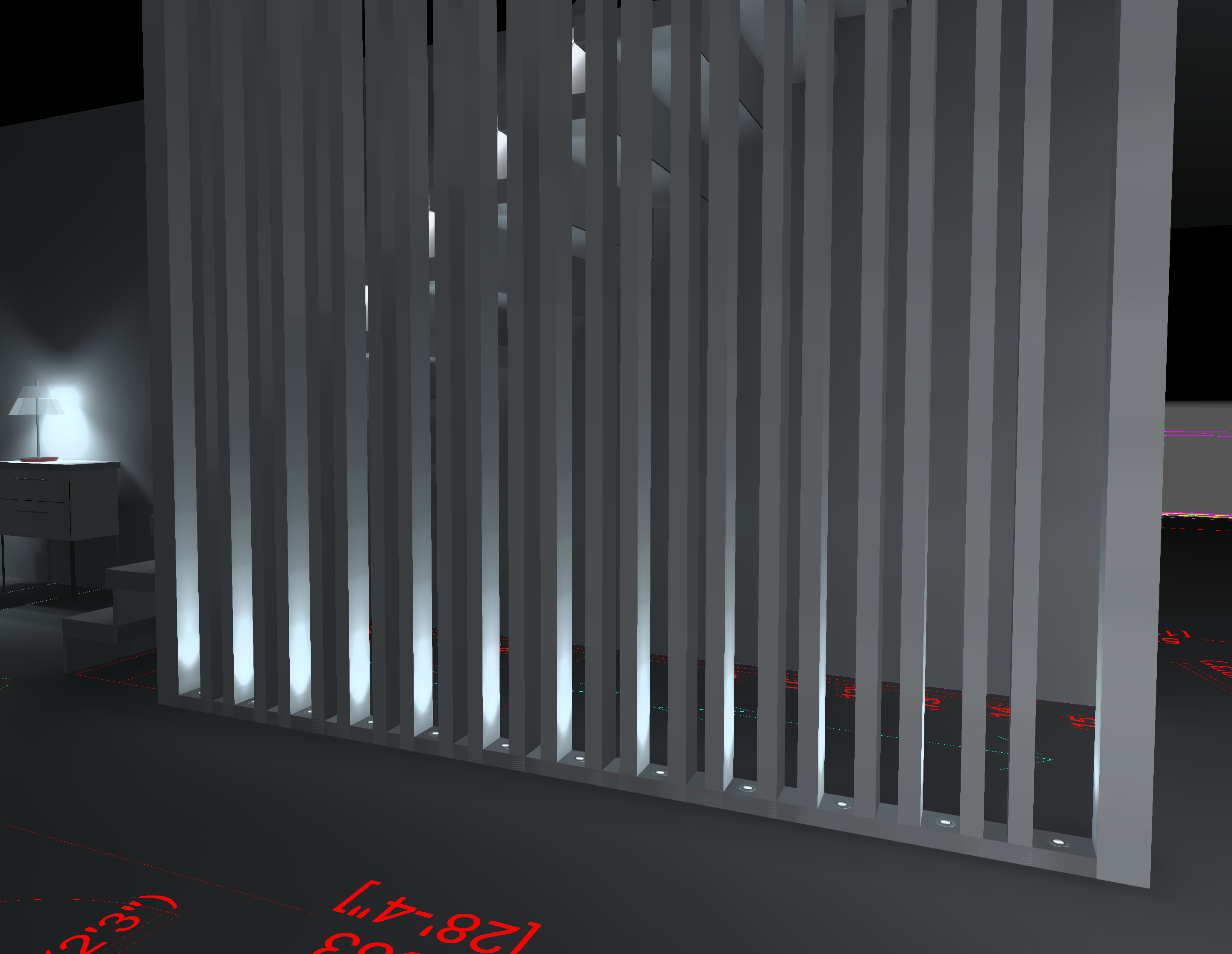

Thorfun Posted April 6, 2022 Share Posted April 6, 2022 I am planning to control our lights with Loxone and the current plan is to use DMX. we have situations where we'll have multiple LED spots in a row and I'm wondering if every spot needs a power cable brought back to the cabinet? e.g. along our vertical posts next to the stairs we're planning uplighter illuminating the posts as shown in the mockup below. that's 12 LED spots. so will I need 12 x power cables running back to the Loxone cabinet or is there a more efficient way of doing this? Link to comment Share on other sites More sharing options...
tonyshouse Posted April 6, 2022 Share Posted April 6, 2022 Will they be all on, all off? Or say half of them on sometimes? Link to comment Share on other sites More sharing options...
Thorfun Posted April 6, 2022 Author Share Posted April 6, 2022 Just now, tonyshouse said: Will they be all on, all off? Or say half of them on sometimes? sorry. meant to mention that! in this situation they will be either all on or all off or all dimmed. obviously, for lights that need to be individually controllable they will have their own power cable. Link to comment Share on other sites More sharing options...
tonyshouse Posted April 6, 2022 Share Posted April 6, 2022 Loop them all in to a single wire then 1 Link to comment Share on other sites More sharing options...
Thorfun Posted April 6, 2022 Author Share Posted April 6, 2022 Just now, tonyshouse said: Loop them all in to a single wire then oh! cool. didn't realise you could do that. 🤦♂️ I really should speak to my electrician about this stuff. that's the problem with a million things going around your head there's just not enough time to deal with them all! Link to comment Share on other sites More sharing options...

Adam2 Posted April 10, 2022 Share Posted April 10, 2022 On 06/04/2022 at 12:17, Thorfun said: along our vertical posts next to the stairs we're planning uplighter illuminating the posts as shown in the mockup below Can I ask where you're sourcing your posts, have a v similar idea for divider by dining area Link to comment Share on other sites More sharing options...
