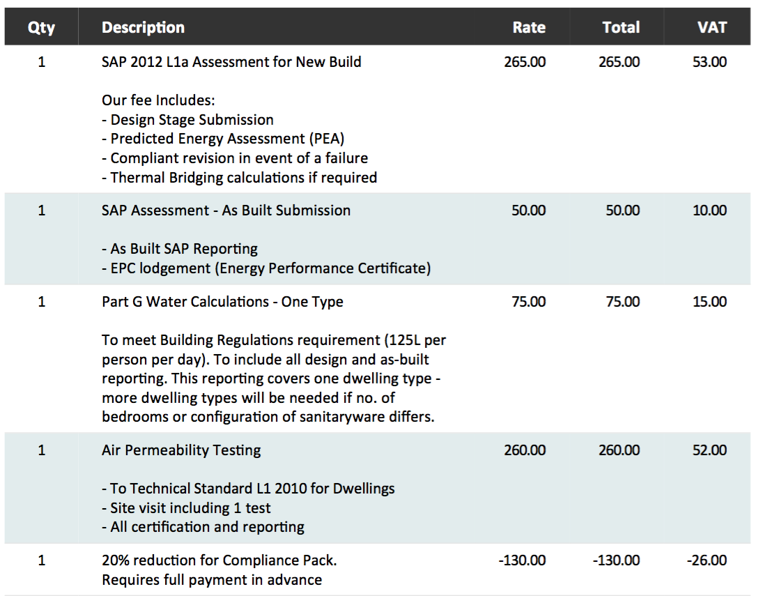

RichS Posted May 10, 2017 Posted May 10, 2017 (edited) Firstly sorry if this is in the wrong section, couldn't really find anything that mentioned SAPs. Anyhow, what is a fair cost for SAP calculations. I have just contacted an on-line firm and this is their response, "Our fee to provide the design and as built SAP calculations would be £90 + VAT. We would charge £40 + VAT for the EPC" Now I'm not sure what I was expecting but at £130 + VAT that seems a pretty decent price to me. Anyone know better?? Edited May 10, 2017 by RichS Clarity

jack Posted May 10, 2017 Posted May 10, 2017 If it's for an as-built SAP, that's a more than reasonable price. It's so low that I'd be making sure everything will be done properly. For example, what happens if you don't reach the required numbers on the first run through? Is there a surcharge for each round of recalculation? I paid quite a bit more to get ours done, because we had a lot of "odd" (according to most SAP assessors!) features on our house (PV, waste water heat recovery, triple glazing, unusual twin-stud construction technique, etc). I'm sure I could have had it cheaper, but they'd have cut corners and made a lot of assumptions. Having spent a lot of time and effort trying to reduce the amount of energy we used, I wanted to get a SAP assessment that took all of that into account and gave us a nice high number!

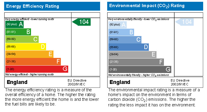

billt Posted May 11, 2017 Posted May 11, 2017 11 hours ago, JSHarris said: The sad fact is that house buyers don't seem to give a damn about EPC certificate ratings, they are more interested in the price, the area and the kitchen and bathroom bling. And quite rightly too. The EPC rating is completely without meaning to the average non-technical house buyer; it doesn't relate in any meaningful way to the energy costs of any particular house, which would be the only interest they would have in it. The EPC/SAP rating is completely without meaning to the technical house buyer. One would assume that it relates closely to the energy usage and hence cost of running a building, but it doesn't. As far as I can see it is supposed to correlate with some not clearly defined environmental cost of energy. That results in completely bizarre ratings where the type of fuel used and any renewal energy generation scheme completely outweighs the standard of insulation and construction. If you want an A rating use mains gas and have 4kW of PV. Everything else has minimal effect on the SAP score.
Stones Posted May 11, 2017 Posted May 11, 2017 Have to agree with a lot of what @billt says above. When we built our last house, I was very disappointed to find that despite the high levels of insulation (U values for walls and roof were 0.1) and a heating energy requirement of a few thousand kWh had a lower score than the developer built house we were then living in which was built to minimum regs of the time (2005) and had a heating requirement 5 times higher. That house had mains gas whereas the new build didn't. It struck me then as it does now, that the system was designed to make mains gas seem the best and most 'eco' fuel source, simply because it is the primary fuel source for the majority of homes. When we came to sell that house, we had an EPC which had been issued when our PV was installed. In Scotland, we still have to get a home report done, and I remember telling the surveyor I had a valid EPC. He point blank refused to use it and said he would not issue the home report unless he had refreshed the EPC, his arguement being there could have been changes made since it was issued. The new SAP overwrote the old one on the register. No changes had been made to the house but the result of his EPC was slightly different to the one before. Given EPC's are only valid for 10 years, what's going to happen to all of the EPC's that members have worked to get top notch results. I stand to be corrected, but my understanding is that future assessments would be based on rdSAP, which being based on a lot of assumptions, risks devaluing the result previously obtained. 12 hours ago, JSHarris said: ...which does rather beg the question as to whether they are worth the paper they are written on.................. My experience is quite simply no. Unless and until they form the basis of local taxation, then they will remain irrelevant to most. If they were to be used, I suspect a good deal of revision would have to go into the methodology used and the penalty attached to houses that do not use mains gas (especially in areas where main gas is not available, but other supposedly environmentally friendly forms of energy are).
Jeremy Harris Posted May 11, 2017 Posted May 11, 2017 (edited) The most ludicrous example of how daft SAP EPC ratings are in the real world was with a chap who was doing a new build next to some old stables. The house had a couple of large outbuildings, on which was fitted 50 kWp of PV. The EPC came out at A136! It's discussed in this thread on the AECB forum: http://www.aecb.net/forum/index.php/topic,5124.0.html with me being just a wee bit critical about the EPC and its fitness for purpose. Edited May 11, 2017 by JSHarris

Jeremy Harris Posted May 11, 2017 Posted May 11, 2017 IIRC, taking our PV out of the SAP calculation reduced our EPC score by around 10 points. We would still have been in Band A, but wouldn't have had the silly rating that's over 100, so fairly pointless. On the subject of fuels, I have a feeling that the current iteration of SAP may be a little different to the version we used, and may well not have such a strong bias towards mains gas, as I think the emission factors were changed, as was the way PV contribution is calculated. I suspect it still errs on the side of giving a better result for mains gas, but then that's reasonable, as mains gas is generally the most efficient fuel for providing heating and hot water, and still beats the average performance for heat pumps, both in terms of cost and emissions, I believe.

Clive Chitty Posted May 16, 2017 Posted May 16, 2017 As a SAP Assessor I was very interested to spot your discussion. A few comments: 1. The price RichS was quoted can only be described as rock-bottom. I would struggle to do a decent job on anything much bigger than a shoe-box for that much money. Pricing does depend strongly on size and complexity, and I always ask to see drawings before quoting. EPC's are subject to random audits according to a strictly enforced sampling regime, and must be within 4% of the auditors independent calculation, so an assessor who cuts too many corners won't stay in business for very long. 2. SAP Assessments are always based on drawings and notes, and never on a site visit. 3. SAP is designed for the general housing market, and can only be described as a "blunt instrument" when applied to anything like Passivhaus. Even the most conscientious of assessors will struggle to find ways to accurately represent some of the technologies used and performance levels achieved, using the approved software. If the manufacturer or installer hasn't seen a need to get what they produce tested and approved by BRE, then the SAP assessor may have no alternative than to use some very inferior default figures. You need SAP to show Building Control that you are following Building Regulations - but don't expect it to tally with the performance predicted in the Passivhaus design documents! 4. A SAP rating over 100 isn't silly - it means you are getting enough energy from renewables to more than cover your needs, and on average have some to spare (eg to feed back into the grid). 5. Whether a SAP rating and EPC fairly represents an actual dwelling comes down to the honesty of the builder/developer and how well Building Control do their job. My impression is that some Building Inspectors are much better than others. I'm sure there is some abuse of the system, but generally an EPC has to be a good idea, as it may be the only thing that gives prospective house buyers a handle on the likely running costs of their shiny new home.
