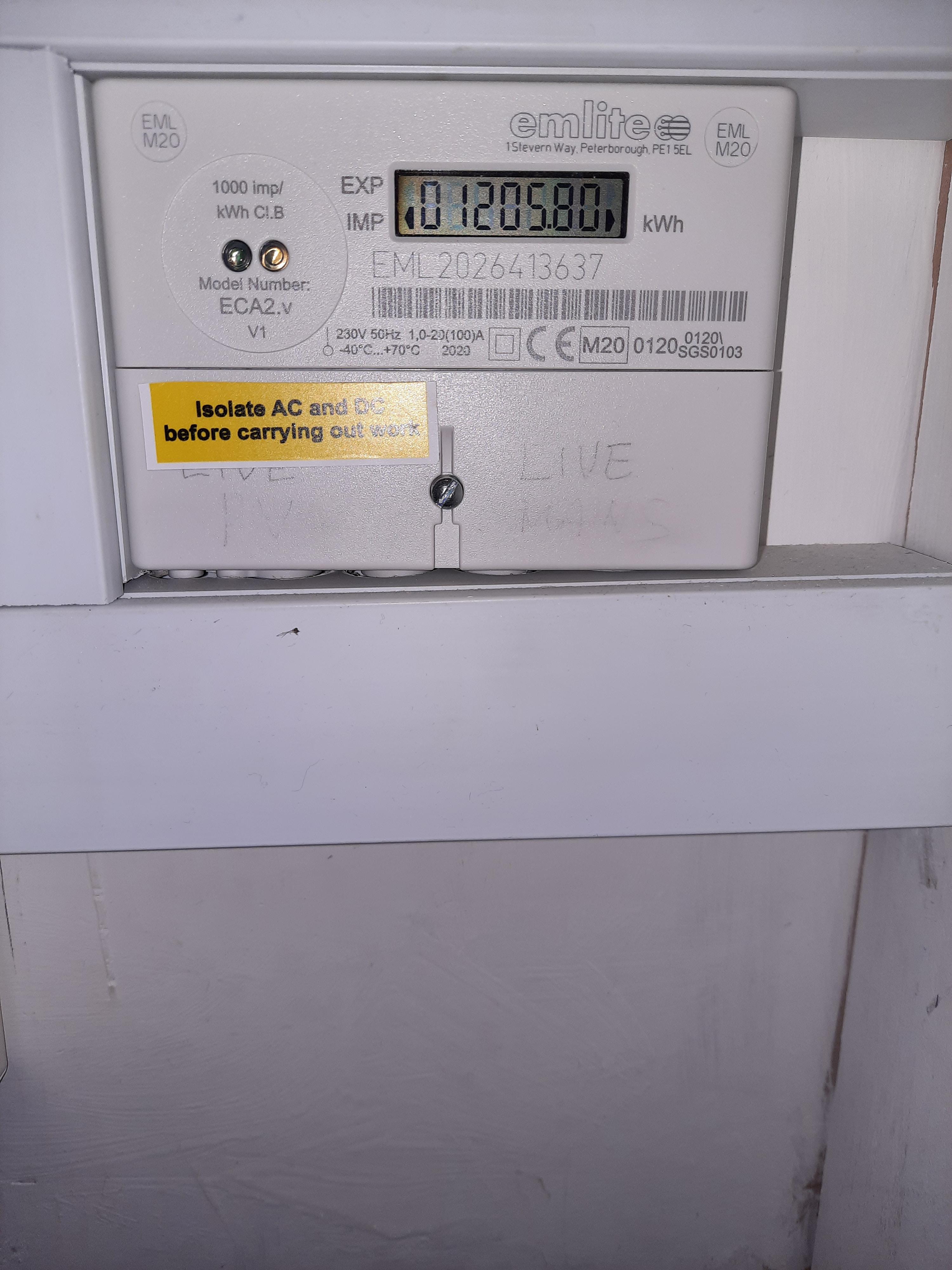

Barryscotland Posted March 31, 2022 Share Posted March 31, 2022 Our install has been operational for about a month now but im not understanding why the generation meter is reading a total of .9kwh and the invertor is saying we have generated a total of 280 kw. Should the 2 not be the same? Link to comment Share on other sites More sharing options...

ProDave Posted March 31, 2022 Share Posted March 31, 2022 Post a picture of the meter and how it is connected. It would not be the first time the installer has connected a generation meter backwards. 1 Link to comment Share on other sites More sharing options...
JohnMo Posted March 31, 2022 Share Posted March 31, 2022 We had the same, the generation meter was connected the wrong way round. Swopped over the input and output leads to other side of the meter and all was fine after that. Link to comment Share on other sites More sharing options...
Barryscotland Posted March 31, 2022 Author Share Posted March 31, 2022 This is the meter and its wired the input from the solar and output is into meter. So if its reading low on the meter it just means we are using most of what we are producing? Thought that as power needed to 'pass through the meter' to get to the consumer unit so it could be used it would all register on the meter Link to comment Share on other sites More sharing options...
ProDave Posted March 31, 2022 Share Posted March 31, 2022 When using that as a GENERATION meter, the "input" from the inverter goes to the left hand 2 terminals and the right 2 terminals connect to your consumer unit. We really need that photo is is not clear from your description how it is wired. Link to comment Share on other sites More sharing options...
Barryscotland Posted March 31, 2022 Author Share Posted March 31, 2022 4 minutes ago, ProDave said: , the "input" from the inverter goes to the left hand 2 terminals and the right 2 terminals connect to your consumer unit. That is how it is wired up. two left terminals are marked input and they are from solar invertor and the two on the right are marked output and they go into the consumer unit. Link to comment Share on other sites More sharing options...
Barryscotland Posted March 31, 2022 Author Share Posted March 31, 2022 Link to comment Share on other sites More sharing options...
ProDave Posted March 31, 2022 Share Posted March 31, 2022 It seems counter intuitive but try swapping the meter input and output and see if that reads properly. Link to comment Share on other sites More sharing options...
JohnMo Posted March 31, 2022 Share Posted March 31, 2022 12 minutes ago, ProDave said: It seems counter intuitive but try swapping the meter input and output and see if that reads properly. Exactly what I had to do, when I found some instructions online, that is what it also said to do. Normal meter reads how much energy is pulled from the grid, PV meter reads how much is pushed from the inverter, so they are working in the opposite direction to each other, using the same type/ model of meter Link to comment Share on other sites More sharing options...
Marvin Posted March 31, 2022 Share Posted March 31, 2022 @Barryscotland Like this. PV left. Mains right. Link to comment Share on other sites More sharing options...
Dillsue Posted March 31, 2022 Share Posted March 31, 2022 The picture you posted seems to show a meter that logs import and export. Are you sure the .9kwh youre reading isnt the inverters import showing the total nightime consumption when the grid powers the inverter?? Link to comment Share on other sites More sharing options...
Barryscotland Posted April 3, 2022 Author Share Posted April 3, 2022 On 31/03/2022 at 19:33, Dillsue said: The picture you posted seems to show a meter that logs import and export. Are you sure the .9kwh youre reading isnt the inverters import showing the total nightime consumption when the grid powers the inverter?? I think that might of been what was happening, I’ve swapped the input and output wires as suggested by a few people and the meter is going up much quicker so thinking it was just wired back to front. Link to comment Share on other sites More sharing options...
Dillsue Posted April 3, 2022 Share Posted April 3, 2022 5 hours ago, Barryscotland said: I think that might of been what was happening, I’ve swapped the input and output wires as suggested by a few people and the meter is going up much quicker so thinking it was just wired back to front. It wasnt wired back to front, it was just the display was only showing import figure. That may have been because it only shows the current flow direction and you only looked at it when system wasnt generating and importing to power the inverter?? I think you can change what the display shows but a read of the manual would be needed!! Link to comment Share on other sites More sharing options...
