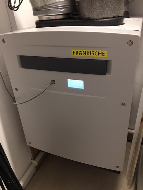

I think it may be coming via MVHR as I cant see how else it would be occuring.  The unit makes a lot of gurgling and glugging noises and often sounds like there is water sloshing around inside.  The condensate trap seems to dry out quickly and I have to put water in...and its really difficult as its a u bend under the unit with not much clearance between unit and floor to get under it.
We are getting headaches and sore throats in certain rooms in the evenings, I have been opening windows in the day so problem not occuring then. I have now turned off mvhr to try and see if that helps.
Any ideas? Should I get MVHR engineer out?

TBH, I doubt very much that it's anything to do with the ducts at all.  The air flowing through the room supply ducts will keep them dry, as long as they are inside the insulated envelope or are well insulated, and at this time of the year there's practically zero chance of getting condensation in the ducts, anyway.
It's far more likely to be a problem with a trap somewhere, and the MVHR is then drawing in smells from the drains.  I didn't trust the suggested arrangement for the MVHR trap in the instructions for ours, so I raised the MVHR up on a stand, to get better clearance underneath it (also allowed me to fit anti-vibration mounts) and plumbed the drains to a normal 32mm U bend trap.  I also plumbed the water softener drain to the same trap, which makes sure it stays topped up.
The mention of gurgling noises suggests that air is being pulled up past the MVHR drain trap arrangement, and I'm near-100% certain that your problem will be with that being too shallow, or perhaps with water being sat in the drain tray in the MVHR because it's not angled properly towards the outlet.

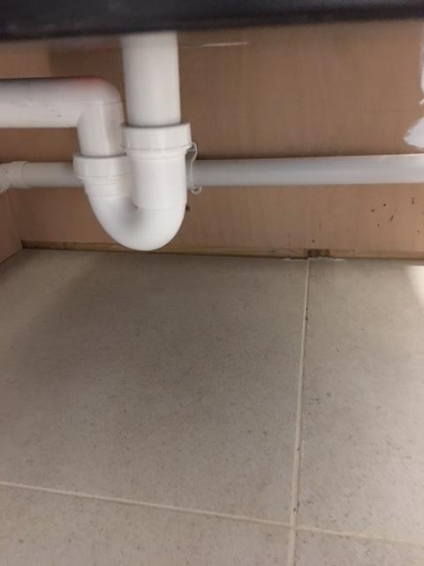

Thank you.  I am no plumber and cant immediately see how I would fix this to my waste....will have to ask a plumber I think unless anyone can advise....
this is my current waste its just a ubend and there is a little plastic ball in there, seems to float.
Is this trap just serving the mvhr condensate ?
If so it's probably nothing more than the water in it has evaporated.  Just pour a jug of water down it from inside the mvhr unit and try it again.

It is just the MVHR trap.  I have been taking the ubend bit off and filling it with water and then screwing it back on, not easy doing that in the small space under the unit..... there is no where obvious on the mvhr unit to pour water would I have to unscrew the front cover?  Sorry I'm really thick with these things LOL
I'm inclined to think that there may be an issue with the angle that the MVHR is fitted at, and that perhaps the drain tray isn't allowing condensate to flow easily to the drain hole.
It should be pretty easy to check if the MHVR has been mounted dead level, some are quite critical of being mounted level as the angle on the drain tray often isn't very great.
For the longer term, once it's been levelled properly, then I'd go along with the suggestions by @JanetE and @Nickfromwales and fit a waterless trap, but before doing that I'd want to be absolutely certain that you don't have condensate pooling in the drain tray inside the unit.
