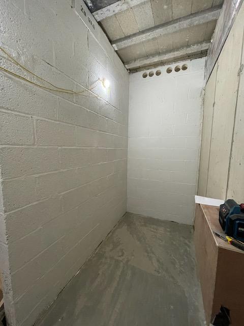

Thorfun Posted March 20, 2022 Share Posted March 20, 2022 greetings. our plant room is in the basement and we've had the whole thing (basement that is) screeded with Cemfloor liquid screed. There is 15mm throughout to put a finished flooring in so we're most likely going to go with LVT throughout the entire basement. But what is recommended for the plant room? should I just leave the screed and live with a 15mm step down in to it or should I put tiles down and have a small step up (maybe 5 - 10mm) in to it or should I put cheap lino...errr....I mean LVT in it just to keep it the same level as the rest of the basement? With tiles I'm concerned about fixing down in to it as I'll have to go through tiles and I wonder if spending money on LVT for a plant room is just crazy when I have a pretty smooth screed already. Also, the plant room is against the exterior wall of the basement so one wall is concrete (250mm thick) and the other 3 are dense concrete blocks. What would be the best way to cover these? I think the concrete wall should just be painted as it's pretty smooth already but how about the block walls? I was thinking of putting ply on the walls to make a smooth surface for fixing to but don't want to reduce the size too much so would have to limit myself to not too thick ply. or is that just a waste and I should simply PVA it all and paint it? ideas? Link to comment Share on other sites More sharing options...
Mr Punter Posted March 20, 2022 Share Posted March 20, 2022 LVT is only about 3mm thick. Just paint on the plant room walls. 1 Link to comment Share on other sites More sharing options...
Thorfun Posted March 20, 2022 Author Share Posted March 20, 2022 4 minutes ago, Mr Punter said: Just paint on the plant room walls. yeah. figured this would be best. is PVA enough to seal the concrete blocks or should I be looking for something a bit more specialised? 4 minutes ago, Mr Punter said: LVT is only about 3mm thick. plus underlay though, right? but, even so, with 5mm underlay it would still only be an 8mm step down in to the plant room. so, just paint the plant room floor sounds like the best and most cost effective route! 🙂 Link to comment Share on other sites More sharing options...
Mr Punter Posted March 20, 2022 Share Posted March 20, 2022 I have only had LVT onto chipboard sub floor with no underlay. If they are not paint grade blocks they can be a pain to get the paint to cover. Link to comment Share on other sites More sharing options...

Thorfun Posted March 20, 2022 Author Share Posted March 20, 2022 thanks guys. I've ordered some interior block filler paint for the block walls and some acrylic floor paint for the floor. should do the job and probably cheaper than plasterboard or ply at the moment! I'll update this thread once I've finished it for appraisal of my work. 😉 but more seriously, in case any one else has the same question and wants to know how my solution went. Link to comment Share on other sites More sharing options...

Thorfun Posted April 3, 2022 Author Share Posted April 3, 2022 I ended up painting the walls with a roller and used Dulux Trade Blockfiller. probably would've got a better finish spraying as it was really hard to try and fill the gaps in the blocks but I think it came out alright and it is, after all, just a plant room! we decided to leave the external concrete wall as is (à la @Bitpipe) which we also like and it'll be the only room that retains that concrete look. Bought some grey floor paint but haven't done that yet even though it might look like it but the screed was grey! Link to comment Share on other sites More sharing options...
