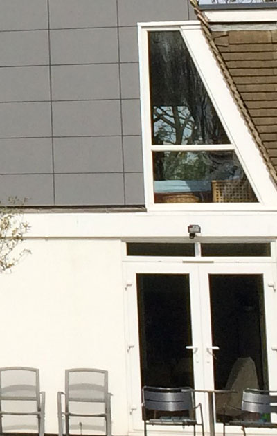

ThePoplars Posted May 5, 2017 Share Posted May 5, 2017 I hope somebody on the forum might be able to help me. We have a trapezium window on our bedroom (approx 1.5m at widest point) and are considering creating a balcony that we access through the opening, however, it's a trapezium shape so it makes things a bit (lot) more complicated. The options we have considered (and discounted): Inward opening door - not enough space for door to swing Outward opening door hanging from angled side of opening - probably puts too much strain on hinges (but happy to be corrected on that?) Outward opening door hanging from straight side of opening - will require more space on the balcony to allow the door to swing out. Creating a narrow rectangular door within the trapezoid - will spoil the look of the window with the extra vertical lines Sliding pocket doors - this is a possibility but we would have to create a pocket and does anybody know a company who makes them in custom shapes? A custom Roof Terrace door (like the one made by Velux) - does anybody know a company who would be likely to make something like that? Or, the ideal world solution that we have no idea whether it exists or not: A door that pushes out then slides on runners fixed along the front of the house - has anybody ever seen something like this? Any help or alternative solutions gratefully received. 1 Link to comment Share on other sites More sharing options...

Mr Punter Posted May 6, 2017 Share Posted May 6, 2017 Maybe easier to create a new opening to the left. What is the grey cladding btw? Link to comment Share on other sites More sharing options...
Simplysimon Posted May 6, 2017 Share Posted May 6, 2017 i don't understand why option #3 is discounted, door width at the bottom is the same, therefore same swing and space. making a timber door that shape is no problem. Link to comment Share on other sites More sharing options...
Nickfromwales Posted May 6, 2017 Share Posted May 6, 2017 59 minutes ago, Simplysimon said: i don't understand why option #3 is discounted, door width at the bottom is the same, therefore same swing and space. making a timber door that shape is no problem. Yup, by far the best, easiest option. Creating a gull-wing door that opens upwards would be lunacy. First big gust of wind, bye bye door. Not enough width on the top for the physics to work on that one imo. Link to comment Share on other sites More sharing options...
ThePoplars Posted May 6, 2017 Author Share Posted May 6, 2017 @Grosey - so the mechanism exists, that's great. Definitely worth further exploration, thank you! @Ferdinand, replies below and a new photo to give a better understanding :-D 14 hours ago, Ferdinand said: @ThePoplars How tall is it? 2250mm How wide is the opening at the top? 450mm (and 1300mm at the bottom) Is the full size of that frame on the right required? The "frame" on the right is actually a dormer which is slightly set back - the wall of the house runs parallel to the slant of the window. Is it currently upvc or wood? It's currently upvc - but we are considering replacing the french doors beneath with grey aluminium. Is there a limit to the budget ? At the moment we're wanting to add it to the design to get through planning but may not actually build. If we were to build, it would have to cost less than £10k for the full balcony (metal pillars from the ground floor, metal grill for balcony floor, glass surround, and this door) Answer these and I can do a fairly thought out answer. Thank you so much :-D @Mr Punter We had considered it, but it's a south facing wall and the room gets very hot so I should have added it as a discounted option. The panels are Trespa I believe (previous owners had them fitted, mentioned the name once when we were buying, and didn't leave any paperwork). @Simplysimon We discounted option 3 because to get the door to swing out, we would have to have to allow space to arc around and back against the grey panel wall so there couldn't be any furniture in that area. It would make the balcony much bigger than we need it to be. Also, and I'm sorry I didn't make it clear, we would want most of it to be glazed. @Nickfromwales Yes, we have discounted the gullwing. Although I really do like the concept of the Velux Roof Terrace door with the top opening like a gullwing because we often have foxes in the garden feeding next to the patio and it would be great to get a photo of them that wasn't through glass. Thanks everyone for your contribution - much appreciated. Link to comment Share on other sites More sharing options...

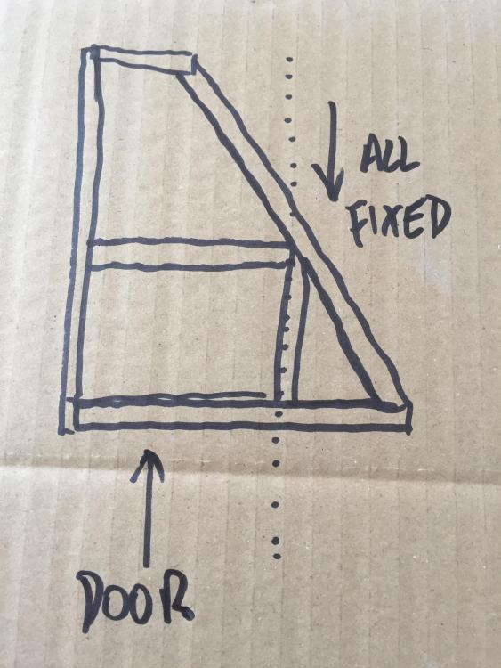

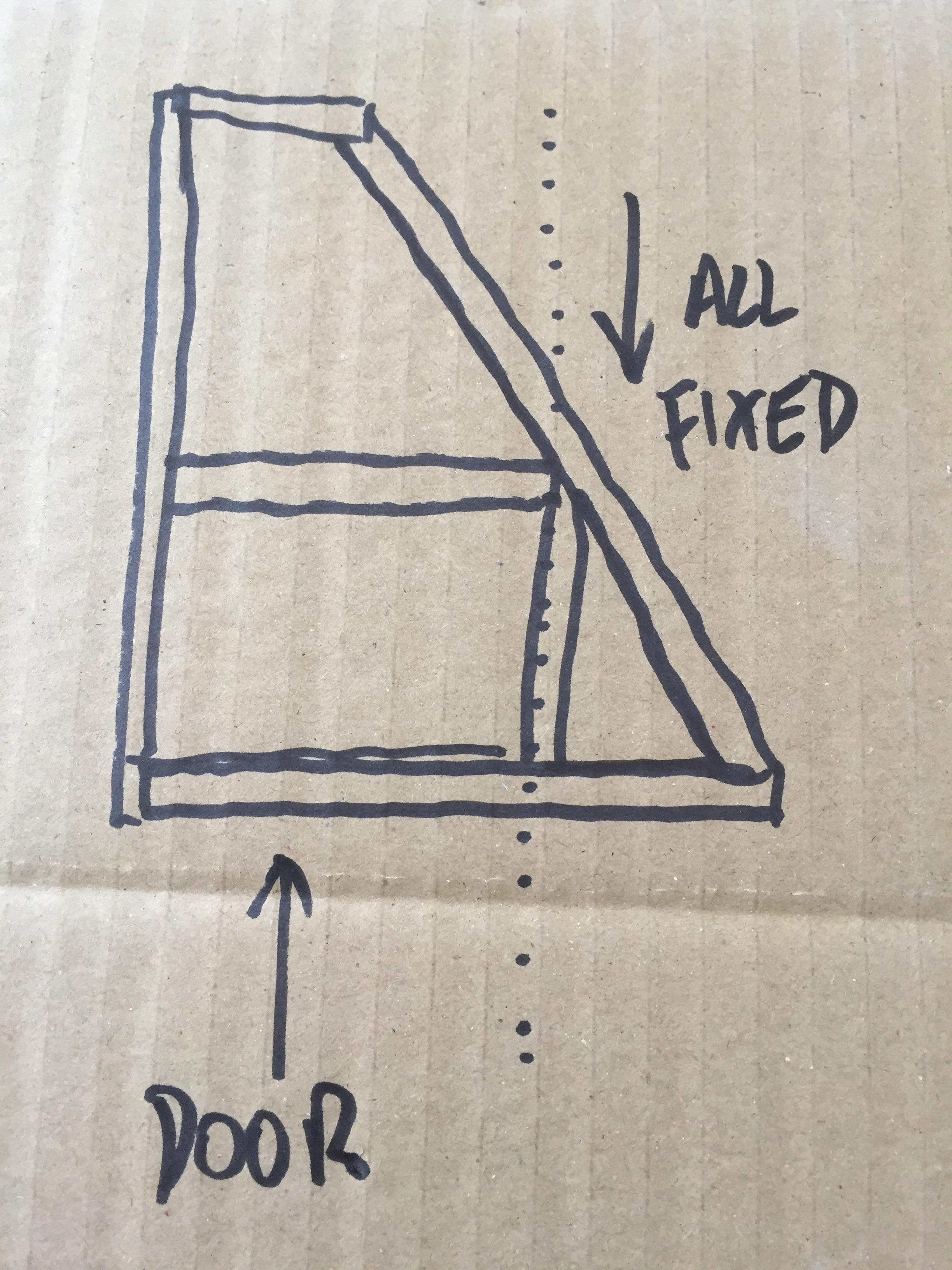

Mr Punter Posted May 6, 2017 Share Posted May 6, 2017 The most practical solution may be to have a small triangular fixed light in the bottom right corner and a narrow door to the left. This would mean that you do not need so much space inside / outside. Link to comment Share on other sites More sharing options...
Nickfromwales Posted May 6, 2017 Share Posted May 6, 2017 8 minutes ago, ThePoplars said: We discounted option 3 because to get the door to swing out, we would have to have to allow space to arc around and back against the grey panel wall so there couldn't be any furniture in that area. It would make the balcony much bigger than we need it to be. Also, and I'm sorry I didn't make it clear, we would want most of it to be glazed. That's easy. Make the bottom section shorter and straight by leaving the bottom right 'triangle' as part of the frame . ? You can have far less door that way too. Link to comment Share on other sites More sharing options...
ThePoplars Posted May 6, 2017 Author Share Posted May 6, 2017 @Mr Punter and @Nickfromwales Splitting the space up like that does make sense on paper, but I don't like the look of it . We had been thinking of putting an opening window above the door to cut down on the size and give some through ventilation. Link to comment Share on other sites More sharing options...

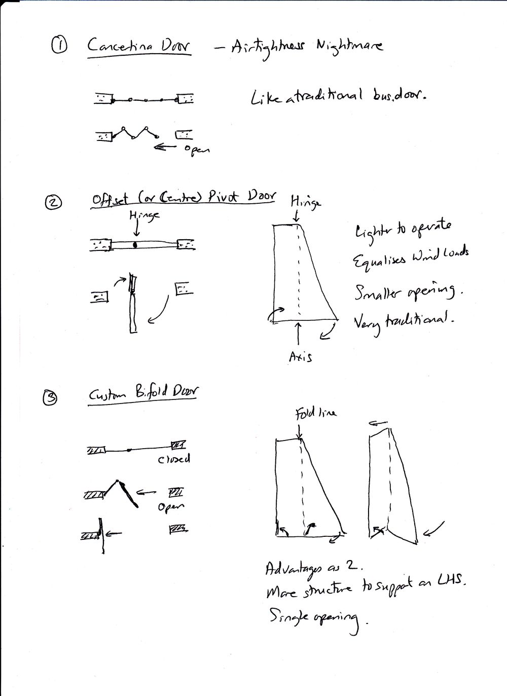

Ferdinand Posted May 7, 2017 Share Posted May 7, 2017 (edited) If you just want to do the window as is, here are three more types of door which would work fine ... 2 and 3 are perhaps much more straightforward than anything suggested so far. Both could be fabricated in steel or hardwood, and done in hardwood by a local skilled chippy with DG units from a local company (I would go laminated to be anti-shatter just in case). If you are sensible you would have a vertical glazing bar where the fold or pivot occurs for robustness and stiffness, and have 2 DG units - or do very careful calcs. The company I linked upthread may have the kits. Phone up and ask, then if they say no ask who does have them. 1 - Concertina. Bad Idea. 2 - Offset pivot - basically the hinge is part way across the door. Make larger doors more manageable. One issue is that your resulting opening is only 18". My solution to that would be to enlarge the opening to line up with the one below. Work really well paired as narrow French doors too. 3 - Custom bifold. You can do offset bifolds, where the track leaves the door more outside than inside or vice-versa. Again, completely normal. But I still say that you need to think carefully about the whole scheme first not the window. Edited May 7, 2017 by Ferdinand 1 Link to comment Share on other sites More sharing options...

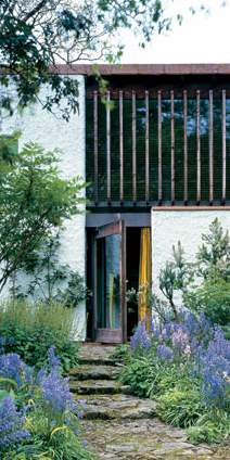

Ferdinand Posted May 7, 2017 Share Posted May 7, 2017 (edited) Examples of pivot doors. Article in HB&R about pivot front doors: https://www.homebuilding.co.uk/pivot-doors/ 12 Examples leading to patios: http://www.stevewilliamskitchens.co.uk/an-alternative-to-the-sliding-door-12-pivot-doors-leading-to-patios/ Domestic British at the house of Peter Aldington. This has been there since the 1960s. Photo credit: Turn End Trust http://www.turnend.org.uk/charitable_trust/ Frank Lloyd-Wright at Biltmore Hotel I am sure that Frank Lloyd Wright used them in domestic settings in the 1930s and 1940s, and finding some in Arts and Crafts or historical settings would not surprise. F Edited May 7, 2017 by Ferdinand Link to comment Share on other sites More sharing options...
Jeremy Harris Posted May 7, 2017 Share Posted May 7, 2017 We had a wide aluminium pivot door fitted to a new build lab as the outer door into a draught lobby. Both water and wind blew around the edges and we had the main contractor back snagging it around half a dozen times until in the end it was replaced with a pair of asymmetric aluminium double doors. The problem was that it was near-impossible to get the door seals to work, especially in the region around the pivot. I think they work well indoors, but I'd personally not want to use one as an external door. Link to comment Share on other sites More sharing options...
Onoff Posted May 7, 2017 Share Posted May 7, 2017 Imo @Ferdinand's option 3, the custom bi-fold does it for me: + adding the vertical member matches the ground floor door. Yes you lose a bit of light (live with it or move the door entirely ) + once open you'll lose some of door across the width of the wall and it won't impede so much into the width of the balcony. - would you end up with a bit of a triangular trip hazard sticking out? Link to comment Share on other sites More sharing options...
Ferdinand Posted May 7, 2017 Share Posted May 7, 2017 3 minutes ago, JSHarris said: We had a wide aluminium pivot door fitted to a new build lab as the outer door into a draught lobby. Both water and wind blew around the edges and we had the main contractor back snagging it around half a dozen times until in the end it was replaced with a pair of asymmetric aluminium double doors. The problem was that it was near-impossible to get the door seals to work, especially in the region around the pivot. I think they work well indoors, but I'd personally not want to use one as an external door. From the HB&R article I linked: Quote Due to the nature of this type of door, weather seals can be a little trickier than with standard doors, as it is hard to get a continuous seal along the top and bottom. However, you can get doors with drop-down seals that are activated when the door closes. Still, it’s wise to fit some form of porch over the door, particularly in exposed locations. F Link to comment Share on other sites More sharing options...
Ferdinand Posted May 7, 2017 Share Posted May 7, 2017 (edited) 12 minutes ago, Onoff said: Imo @Ferdinand's option 3, the custom bi-fold does it for me: + adding the vertical member matches the ground floor door. Yes you lose a bit of light (live with it or move the door entirely ) + once open you'll lose some of door across the width of the wall and it won't impede so much into the width of the balcony. - would you end up with a bit of a triangular trip hazard sticking out? All true. The window is so stonkingly high that the 6" or so sticking out of the folded door should not be material - you will get enough back in the angled portion. I would make one out of corrugated cardboard or insulation sheet to check clearances. If hinged on the axis suggested with no changes to the opening it will be roughly 450mm one way and then 1050 the other way which leaves a 600 wide triangle at lower height which could bark your shins. That could be managed by eg: - adding 650 to the opening so it would line up, - having a narrow balcony (projecting Juliet) balcony if desired so that the triangle was flush against the side of the balcony and it is impossible to get past it unless you are in the prcess of defenestration in which case you would probably want it there - arranging the fold such that the projection is on the inside then creating a design feature eg built in wardrobe against which the trip hazard would be flush - have a third leaf so the triangular trip hazard folds back on itself. Lots of options . Or making the opening a bit wider and fitting a normal door and triangular fixed window :-). Ferdinand Edited May 7, 2017 by Ferdinand Link to comment Share on other sites More sharing options...
