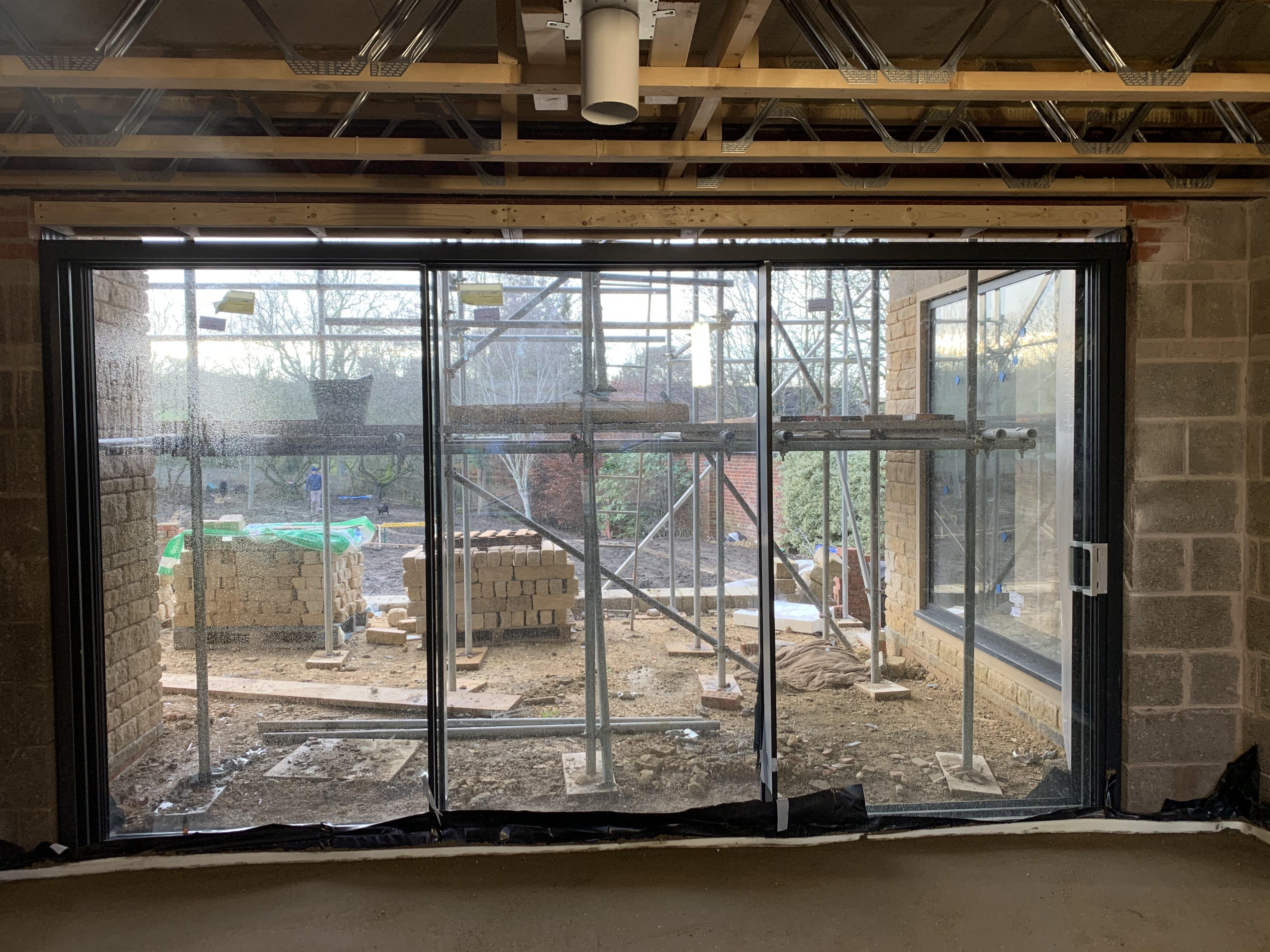

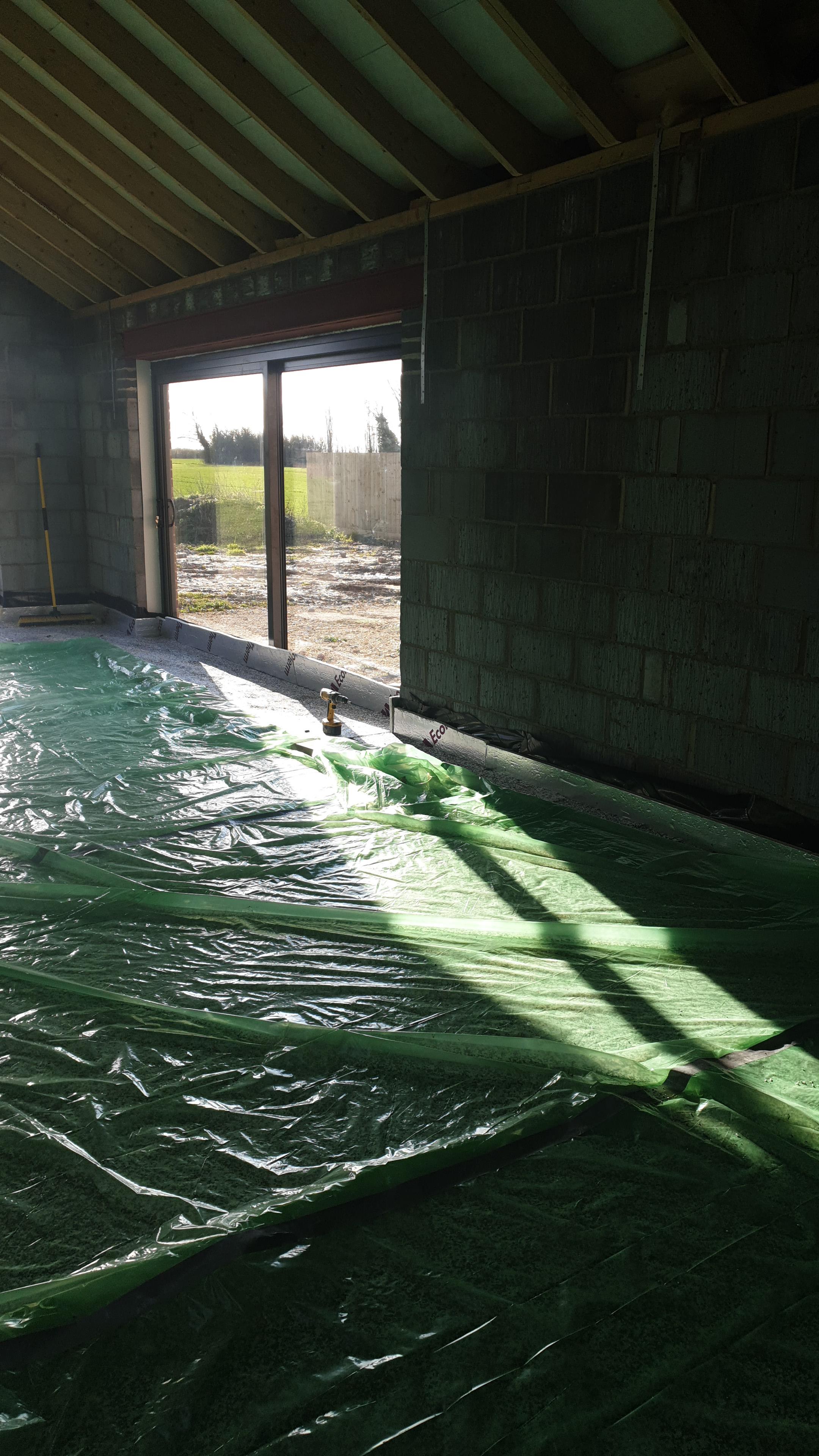

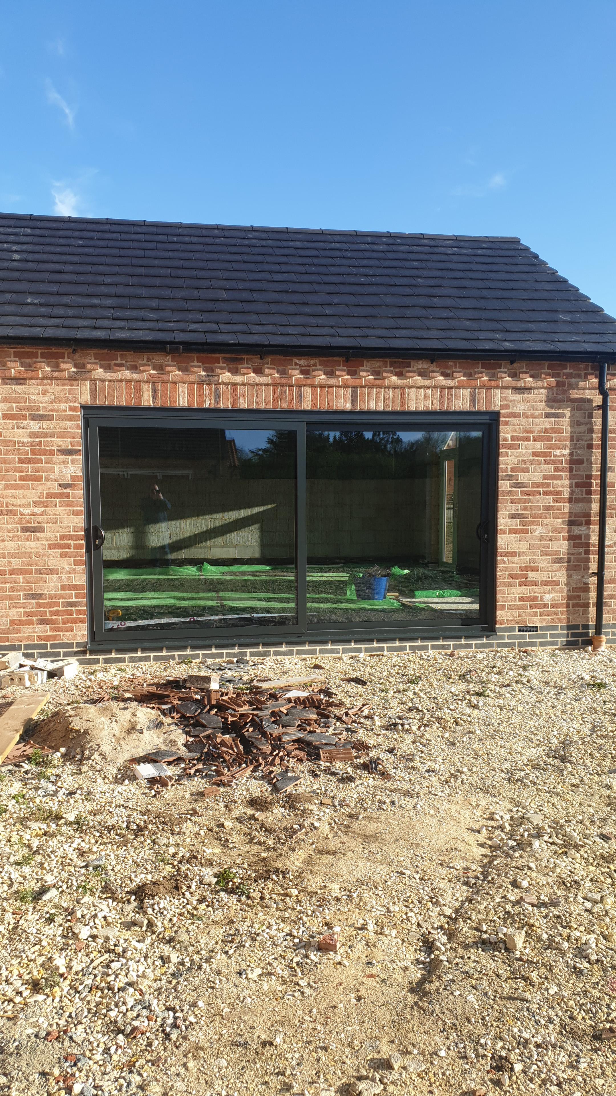

Buzz Posted March 12, 2022 Share Posted March 12, 2022 4.2 m double track went in this week . Link to comment Share on other sites More sharing options...
SBMS Posted March 12, 2022 Author Share Posted March 12, 2022 3 minutes ago, Buzz said: 4.2 m double track went in this week . Thanks @Buzz! Link to comment Share on other sites More sharing options...
SBMS Posted March 12, 2022 Author Share Posted March 12, 2022 @BuzzWhich system/manufacturer did you go for? Link to comment Share on other sites More sharing options...
Buzz Posted March 12, 2022 Share Posted March 12, 2022 18 minutes ago, SBMS said: @BuzzWhich system/manufacturer did you go for? Used a local supplier for all our windows and doors they are not one of the branded names that get mentioned a lot on here but we are happy with them. 1 Link to comment Share on other sites More sharing options...

Buzz Posted March 20, 2022 Share Posted March 20, 2022 1 hour ago, richie9648 said: Completely unrelated to this - what did you use to close off the cavities ? not the clearest of picture but used a standard 150mm cavity closure. Link to comment Share on other sites More sharing options...

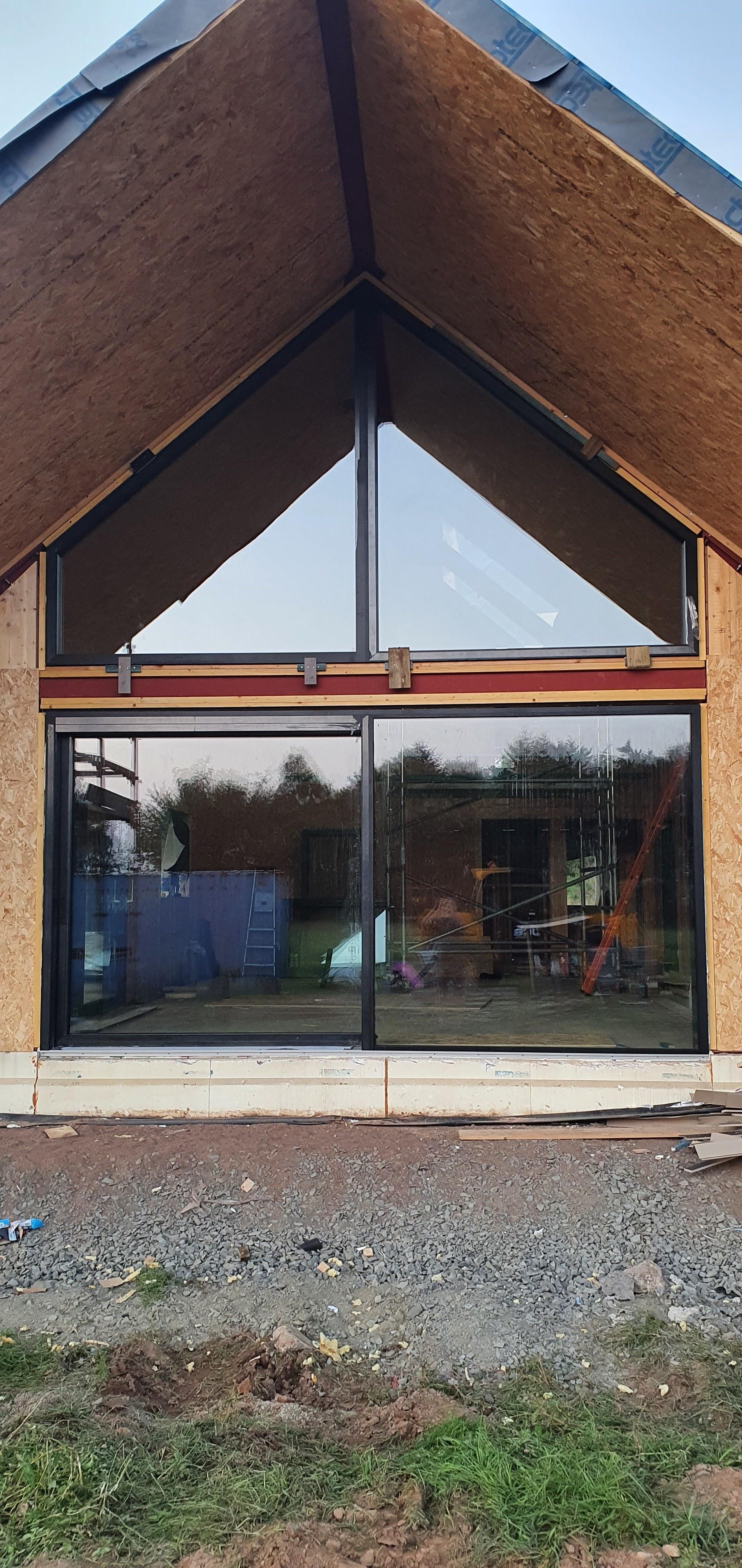

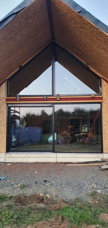

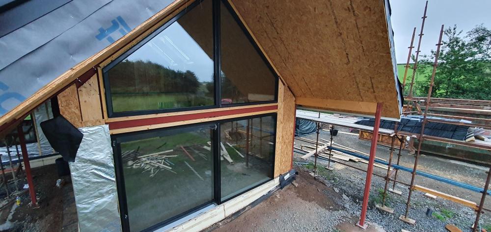

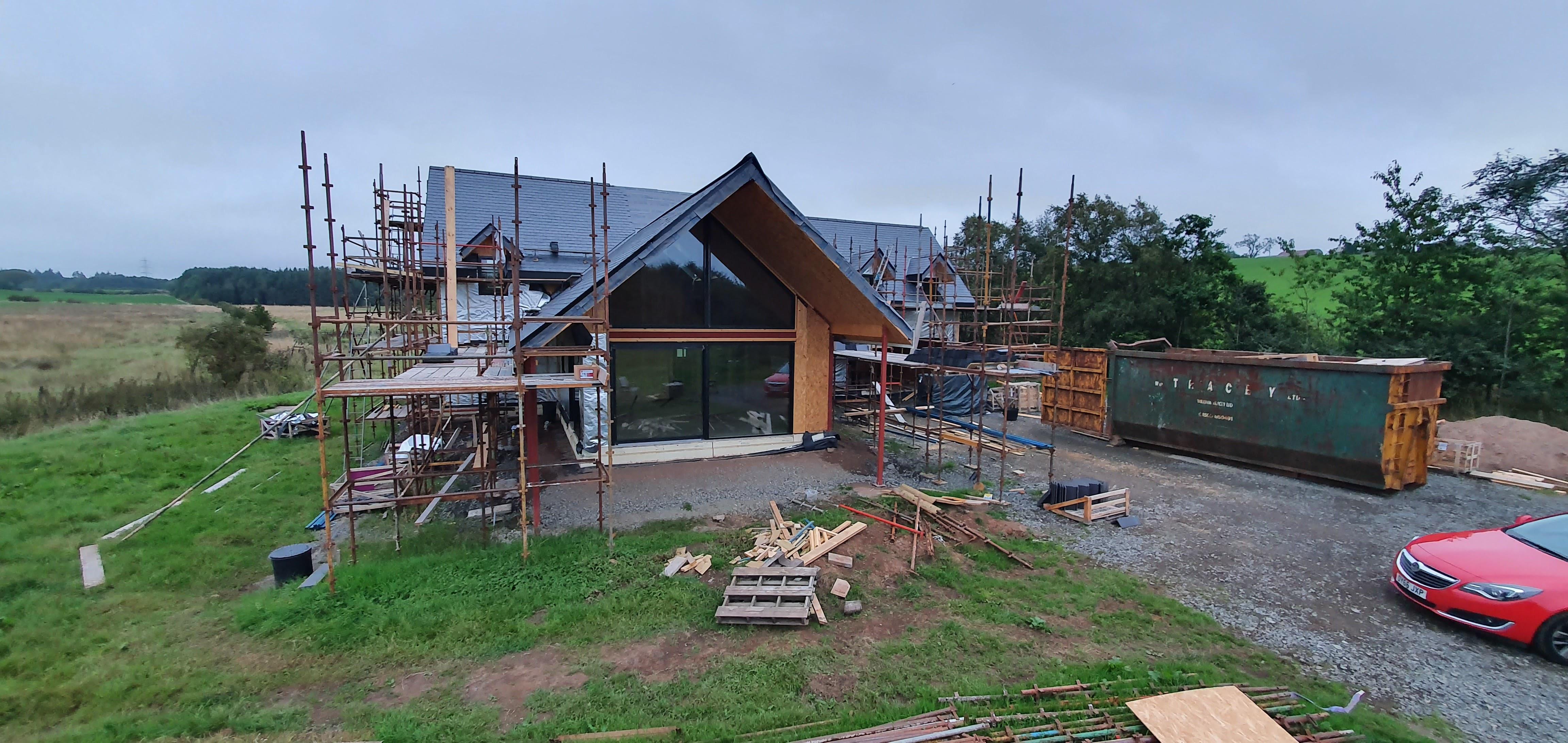

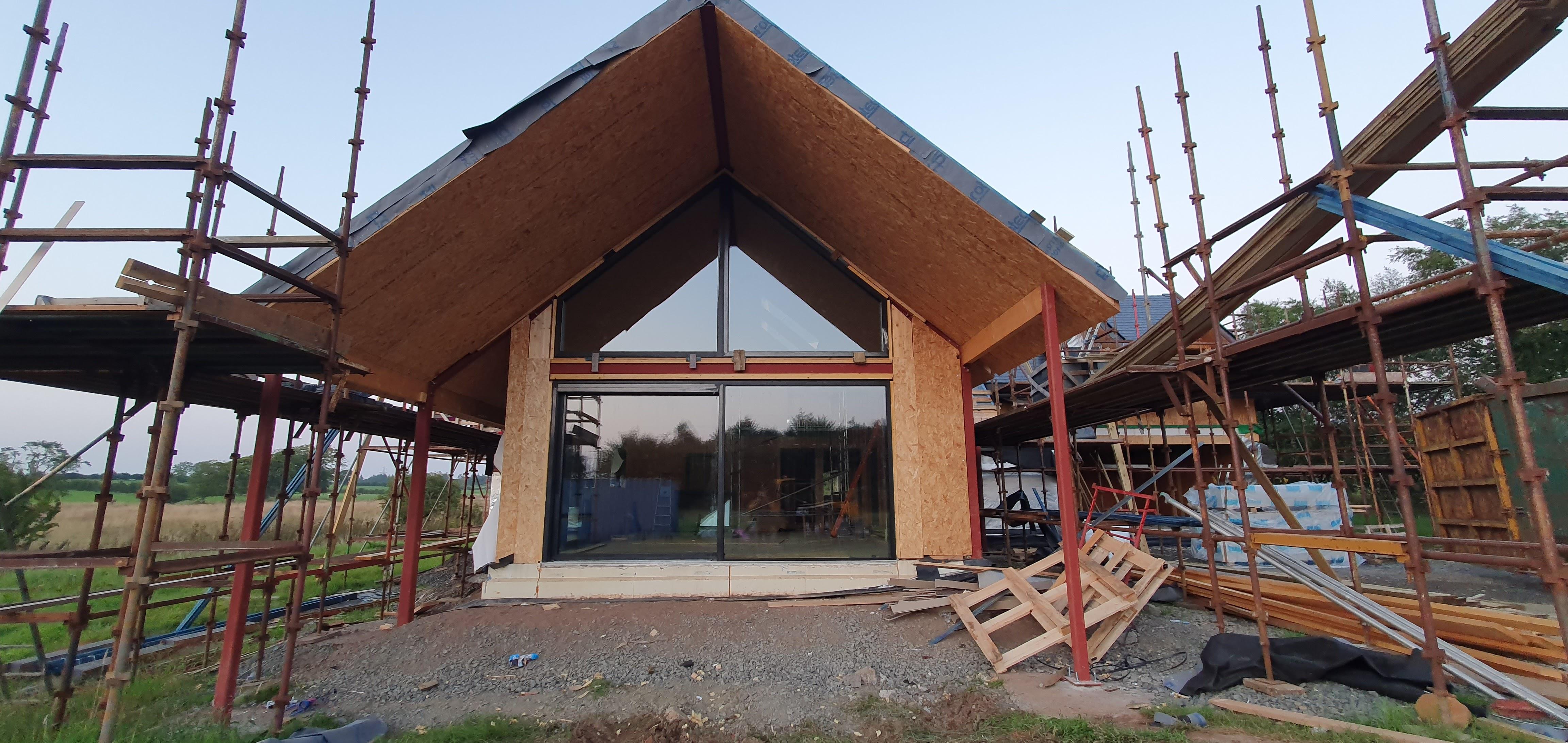

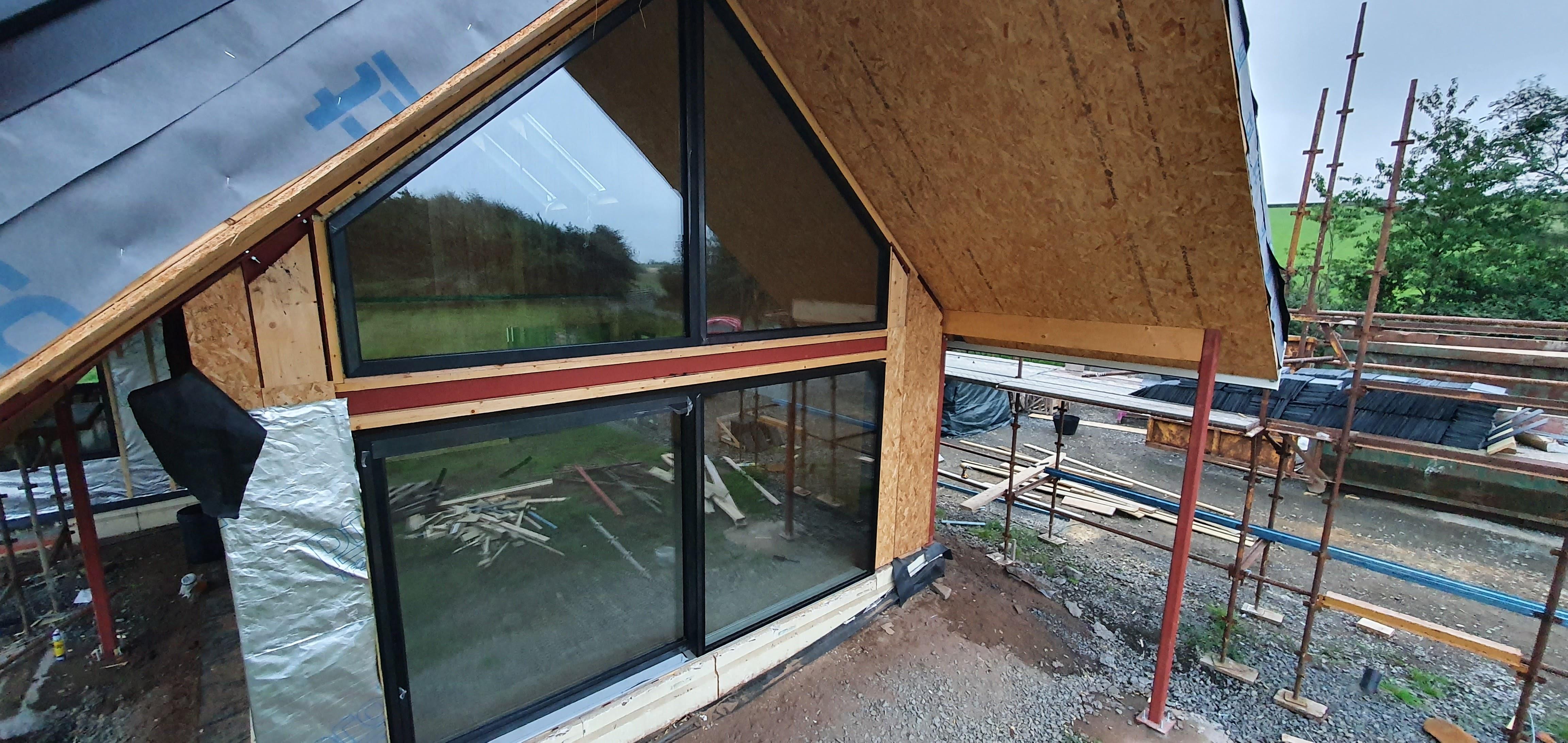

SuperJohnG Posted March 21, 2022 Share Posted March 21, 2022 I have a 4.6m double, from zyle fenster in black. Will post a pic tomorrow 1 Link to comment Share on other sites More sharing options...
SBMS Posted March 21, 2022 Author Share Posted March 21, 2022 Thanks @SuperJohnG has anyone got a 4m ish triple pane? It seems that 4m double sliders are more popular - is there any reason for that out of interest to those who have them? Link to comment Share on other sites More sharing options...
Lbut Posted April 9, 2022 Share Posted April 9, 2022 I can show you pictures of both, we have 2 sets originally fitted as 3 panes (but they were mis measured) now fitted as 2. The 3 panes are for for sale if you are interested? The 3 panes are 4.1m x 2.4 (approx) Link to comment Share on other sites More sharing options...
craig Posted April 18, 2022 Share Posted April 18, 2022 On 21/03/2022 at 00:24, SuperJohnG said: I have a 4.6m double, from zyle fenster in black. Will post a pic tomorrow Get that bad boy posted 😉😂 Link to comment Share on other sites More sharing options...
SuperJohnG Posted April 18, 2022 Share Posted April 18, 2022 These are mine...4.6m wide 2.3m high I think. Very pleased. Having triple sliders is OK if you want 2/3rd open but I have 50% opening and happy it's very wide. 1 Link to comment Share on other sites More sharing options...
