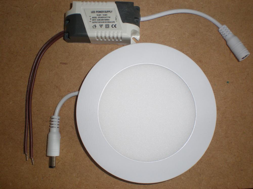

Jeremy Harris Posted May 29, 2016 Share Posted May 29, 2016 I'd second the view that the panels are great. I have a mix of 3W and 6W round panels in the kitchen/dining room and a rectangular 16W panel in the hall, and they are better by far than the MR16 12V LED downlighters I was using (and still am in the bathrooms, utility room and WC). The nice thing with the panels is that they are barely thicker than the plasterboard and they run pretty cool, so they are easier to fit where the VCL is in fairly close proximity to the back surface of the plasterboard. Link to comment Share on other sites More sharing options...

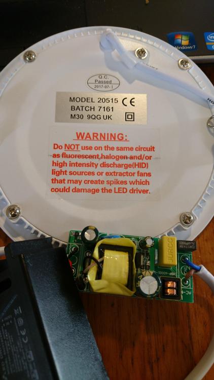

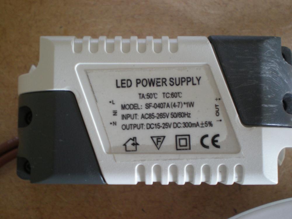

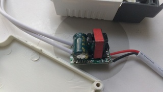

Guest Alphonsox Posted May 29, 2016 Share Posted May 29, 2016 Did you use these panels with the manufacturers power supply ? Or were these modded in some way ? Link to comment Share on other sites More sharing options...
Jeremy Harris Posted May 29, 2016 Share Posted May 29, 2016 The panels I bought came from China with rubbish power supplies, but they are exactly the same panel lights sold at several times the price by some of the UK re-sellers, the only difference being that the UK resellers are generally using better constant current power supplies. Both the 3W and 6W panels need a 300mA constant current supply, with the voltage at the LED unit varying from around 10V for the 3W panels to around 20V for the 6W panels. At the time I fitted our lights I couldn't find a supplier of decent power supplies, so made up my own system for driving the lights, but I would guess that some hunting around would source some decent constant current supplies that don't emit loads of radio interference. There's a bit in my blog about these dreadful power supplies, here: Link to comment Share on other sites More sharing options...

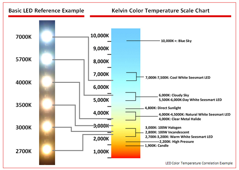

Stones Posted May 30, 2016 Author Share Posted May 30, 2016 (edited) I used an IP65 spot over the shower in my last house and it did the job in that enclosed space. Not sure they would be the answer for the whole room. I think it's time to order up a sample and take it from there. Question is, warm white or day (cold) light? Edited May 30, 2016 by Stones Link to comment Share on other sites More sharing options...

Calvinmiddle Posted May 30, 2016 Share Posted May 30, 2016 (edited) 2 hours ago, Stones said: Question is, warm white or day (cold) light? LED hut now have 3 options for GU10 fitting (and possibly other but haven't look as I needed only GU10s Warm White (2700 Kelvin) Daylight (4000 Kelvin) Cool White (5000 Kelvin) Edited May 30, 2016 by Calvinmiddle pic missing 1 Link to comment Share on other sites More sharing options...
