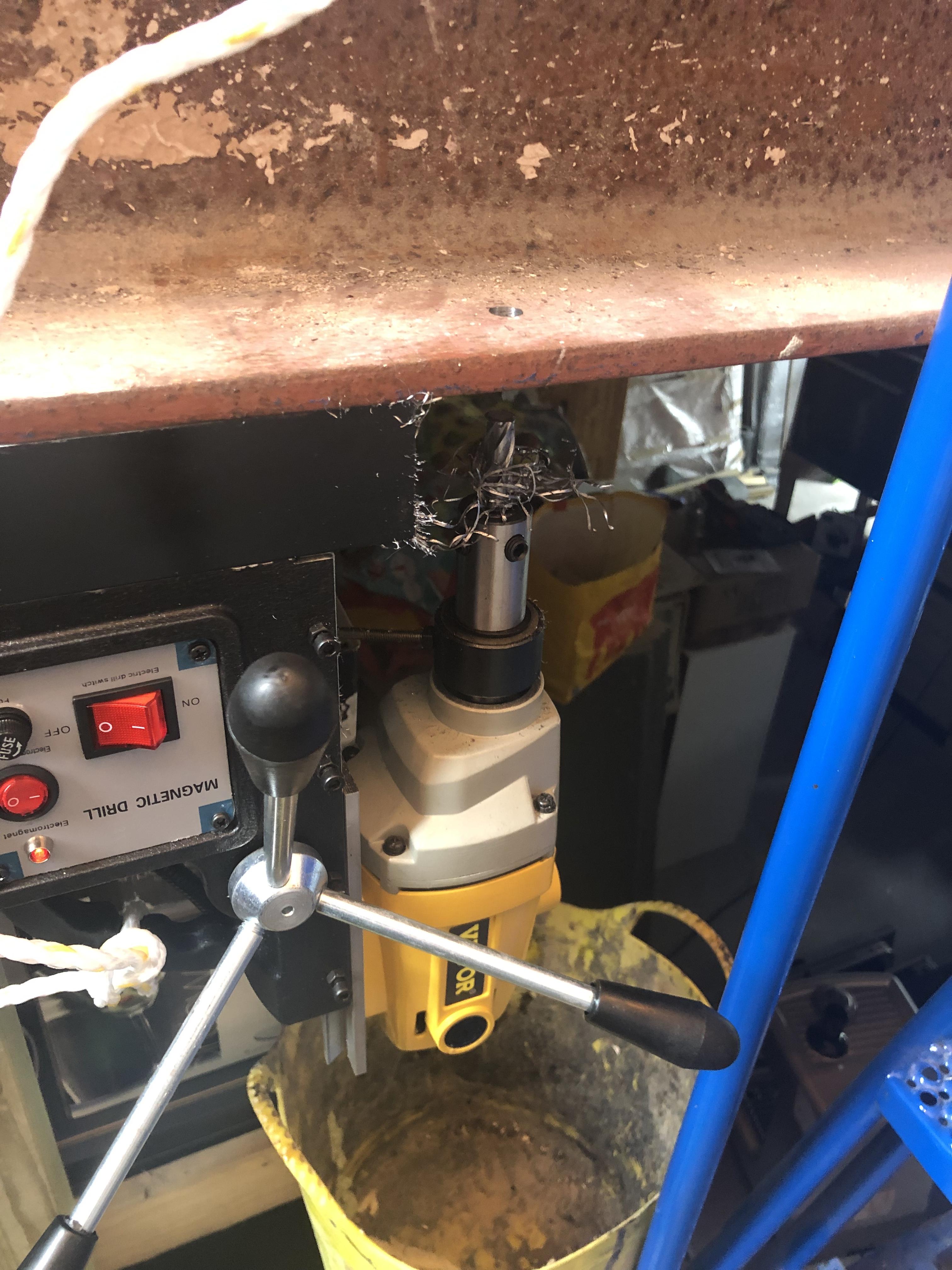

Pocster Posted April 12, 2022 Author Posted April 12, 2022 New toy alert !! Cooooooorrrrrrr . Makes drilling into steel easy . Must remember to disconnect power when SWMBO is standing under it . 2
Pocster Posted April 12, 2022 Author Posted April 12, 2022 It’s strange how ‘ surprised’ I am that the electro magnetic works !!

markc Posted April 12, 2022 Posted April 12, 2022 Rotabroach (or other generic annular cutter) is also great for adding another ‘half’ hole to existing for misaligned holes. use plenty of water (preferably with soluble oil) to keep the cutters cool and they last for ages before needing a regrind
Pocster Posted April 12, 2022 Author Posted April 12, 2022 On 12/04/2022 at 13:13, markc said: Rotabroach (or other generic annular cutter) is also great for adding another ‘half’ hole to existing for misaligned holes. use plenty of water (preferably with soluble oil) to keep the cutters cool and they last for ages before needing a regrind Expand Yeah it does have a 'cap' you fill with something oil based and is then fed to the tip. Amazon messed around with the oil delivery i.e. it never happened. Presume it's noting special. I just stop every 30 seconds and shoot some wd40 in the hole.
markc Posted April 12, 2022 Posted April 12, 2022 On 12/04/2022 at 14:19, pocster said: Yeah it does have a 'cap' you fill with something oil based and is then fed to the tip. Amazon messed around with the oil delivery i.e. it never happened. Presume it's noting special. I just stop every 30 seconds and shoot some wd40 in the hole. Expand It’s cutting oil, mix it roughly 1 part oil to 20-30 of water. WD is good but a squirt from a spray bottle or washing up liquid bottle every few seconds keeks the bits cool .. more important on the bigger diameter cutters. 1
saveasteading Posted April 12, 2022 Posted April 12, 2022 On 12/04/2022 at 12:50, pocster said: the electro magnet works Expand There may be a lanyard attached so that you can hook it onto a beam/scaffold in case the power fails. More to protect the machine and those below than the operator. It is not uncommon for the power to be switched off by the operator, oops, or someone below. 1
Pocster Posted April 12, 2022 Author Posted April 12, 2022 On 12/04/2022 at 17:55, saveasteading said: There may be a lanyard attached so that you can hook it onto a beam/scaffold in case the power fails. More to protect the machine and those below than the operator. It is not uncommon for the power to be switched off by the operator, oops, or someone below. Expand You can just about see it in the photo . Too be honest if the power failed / cut off though the 20kg drill wouldn’t fall on your head it would swing straight into your face …
Onoff Posted April 12, 2022 Posted April 12, 2022 When rotabroaching I use the cutting oil from Machine Mart in 5L containers . Also comes in 1L bottles. I just squirt it out of a Lucozade bottle.
