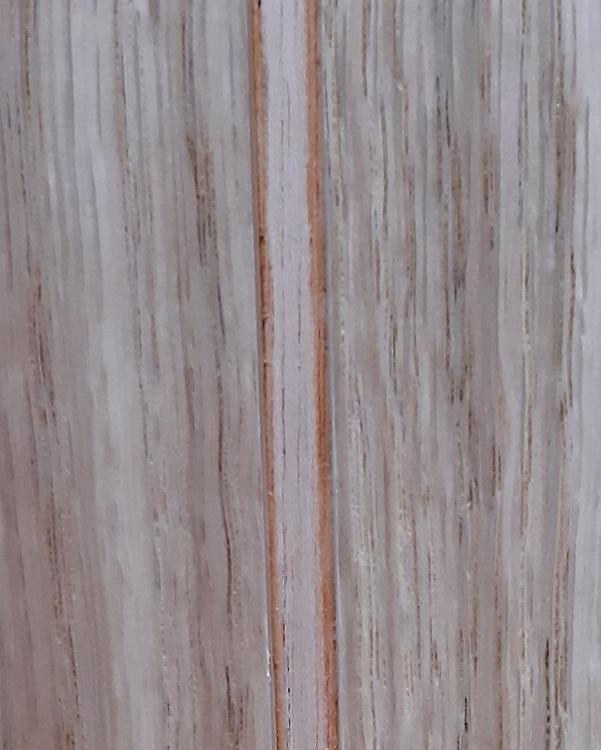

Firsttimebuyer Posted February 26, 2022 Posted February 26, 2022 Just bought our first house and hope to be able to make improvements ourselves, learning as we go. First problem encountered already so hoping for some guidance! Brand new beautiful solid oak door fitted. That went well! But I oiled it with Treatex clear oil as directed. When it dried, the vertical pattern grooves in the door have gone orange! What did I do wrong?! Should I sand the grooves back? The rest of the door looks great, but overall effect ruined by the orange tiger stripes! Can anyone help me? Thanks in advance
markc Posted February 26, 2022 Posted February 26, 2022 Hello and welcome … strange that a cut groove should go a different colour, can you see the matching grain in the grooves? a close up pic would help

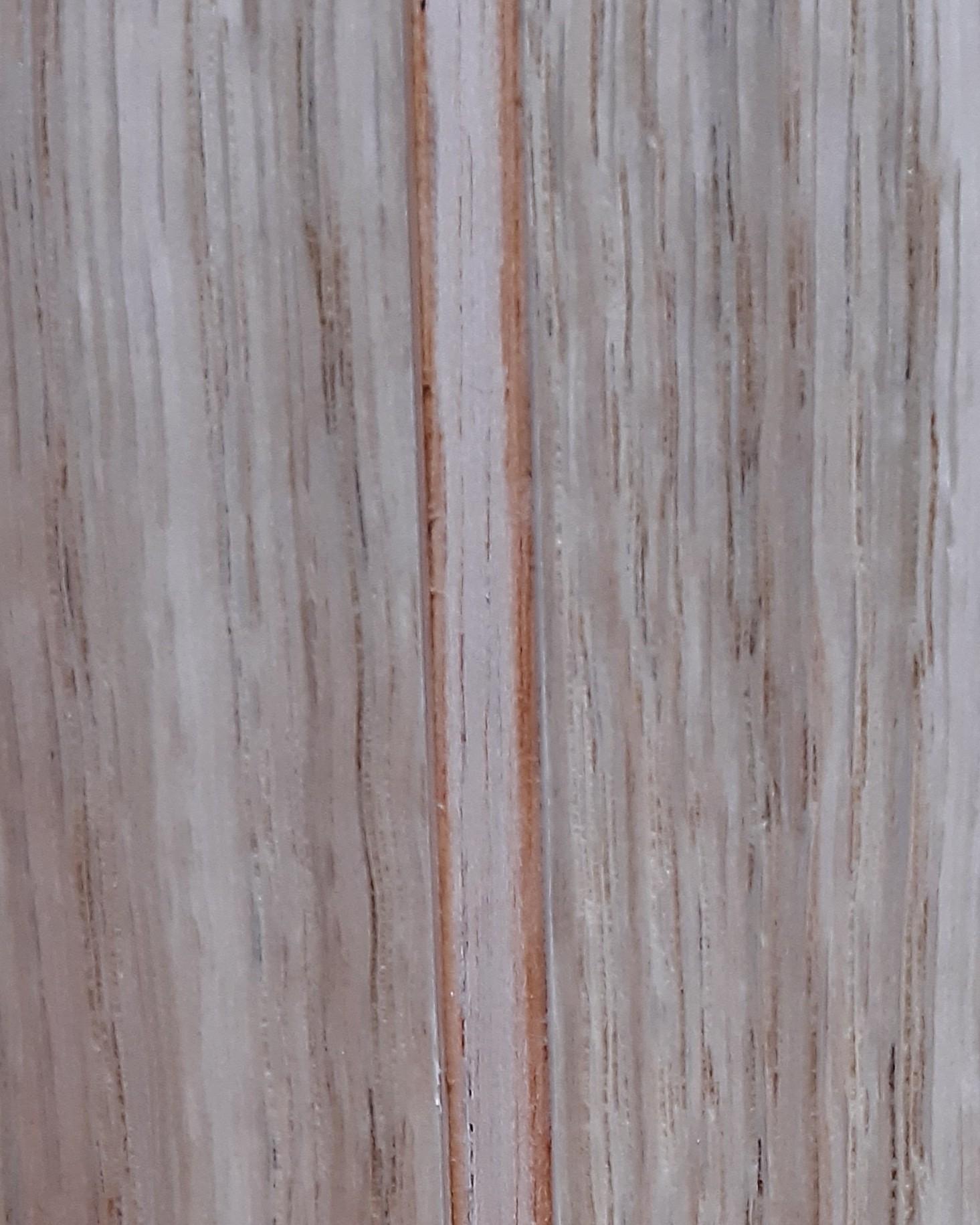

Firsttimebuyer Posted February 26, 2022 Author Posted February 26, 2022 Hi there, thanks for reaching out. I've attached a couple of photos not sure it's clear though? In daylight it's really quite bad
Gus Potter Posted February 26, 2022 Posted February 26, 2022 Is it veneered door? The discolouration could be due to this.. where the veneer has caught a bit of the sap wood. Or something to do with the glue type?
Firsttimebuyer Posted February 27, 2022 Author Posted February 27, 2022 Morning Gus. I sincerely hope it isn't veneered as I bought and paid for solid oak! I think I'm going to try sanding the grooves lightly today. As mentioned the rest of the door is perfect. Really odd. Ah well, sanding lightly can't damage it I guess and I have to do something. Thank you for messaging. I'll let you know how it goes. Wish me luck!
joe90 Posted February 27, 2022 Posted February 27, 2022 I would contact the supplier and ask them, you did exactly as directed, be interested in their reply!
CotswoldDoItUpper Posted February 27, 2022 Posted February 27, 2022 It could be a solid door that’s been veneered in oak, therefore a solid oak door. We’ve been caught out by this sort of misleading description before. Hope for your sake it’s not!
PeterW Posted February 27, 2022 Posted February 27, 2022 So I doubt it is solid oak as in a single piece thickness as it would be inhererently unstable. It would also move and bend with moisture in the air and the different humidity levels between indoors and outdoors so in reality it is likely built up of an oak frame with other oak laminations. What you are seeing is the discoloration from a lower layer or potentially a glue layer reaction - that would show in the way you have described if there is a 3-4mm top veneer over the core. First stop is to go back to the supplier with the photos and the exact product you have used at their suggestion and advise you have issues. Then ask for their advise on what to do next, and get them to sort the problem. Sanding could make it worse and expose more glue, and you may need to potentially strip the door and use a different oil so that is all for the manufacturer to resolve, not you !!
joe90 Posted February 27, 2022 Posted February 27, 2022 I have oak internal doors, but I know they are veneered and yes the “slots” are a little orange on a couple of them. Laminated doors are far more stable as said above.
Firsttimebuyer Posted February 27, 2022 Author Posted February 27, 2022 Wow! Thank you for your advice. Clearly I have a lot to learn. Who knew solid oak didn't actually mean solid.
SteamyTea Posted February 27, 2022 Posted February 27, 2022 (edited) The colour may change in a few days time. Or might not. Did you pay with a credit card? Edited February 27, 2022 by SteamyTea

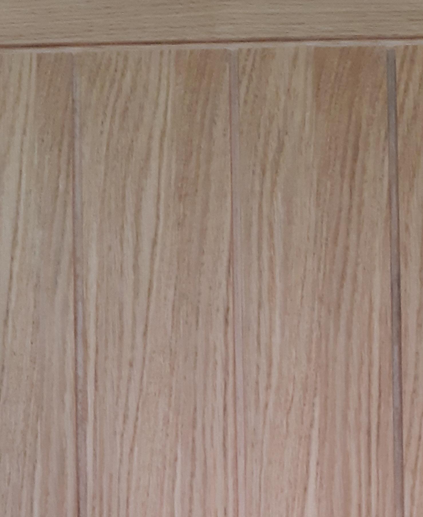

Firsttimebuyer Posted February 27, 2022 Author Posted February 27, 2022 OK I have an update, and I guess a confession. I bottled out when it came to contacting the door supplier. But it's not all bad news. I had a go at sanding the grooves and I think it looks OK. I know I'll have to toughen up and question when things aren't right and I'll try in future. But I can live with this, my doors look pretty good actually. When I oil next time, think I'll just roller the surface and not in the grooves, should avoid the orange stripe effect! 1
