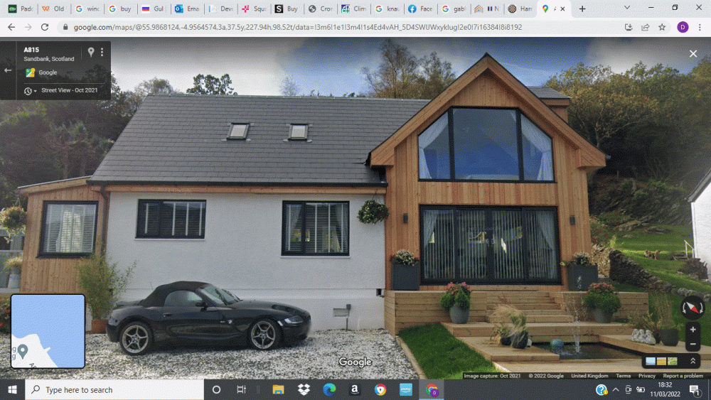

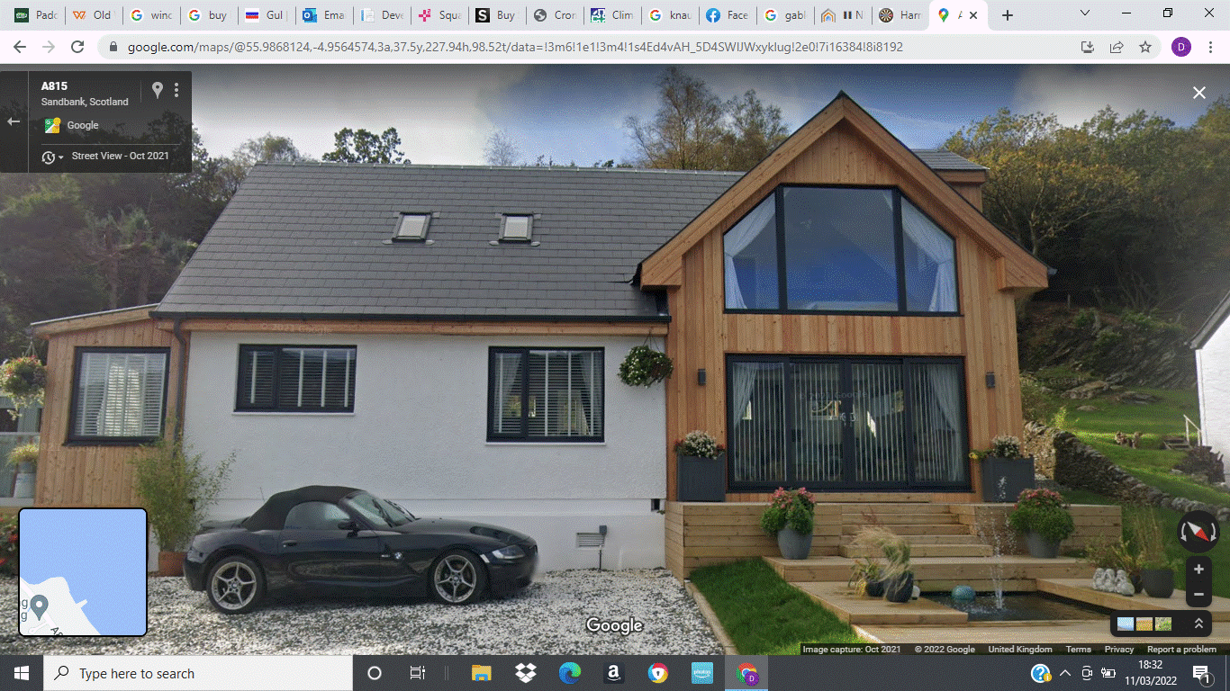

davejura Posted March 14, 2022 Author Posted March 14, 2022 To save money, we are seriously thinking of making the attic space "cold" for the time being. We are also thinking of changing the gable design to lose some of the glass. The sliding doors and glass panel above make up over 50% of the glazing cost! I've attached a photo of a local new extension which is a similar size to our gable (minus the ground floor!) and would hopefully save a fair bit whilst still looking good. I'd be interested in peoples thoughts. I can post more drawings tomorrow if anyone is interested!
Hobbiniho Posted March 15, 2022 Posted March 15, 2022 i have built/worked on several houses where the client hasnt had the money right away to complete the upstairs, they have fitted attic trusses but just left it bare, the key thing is to construct the structure it as if you are going to finish it and just fit infill panels where the windows are going to go and clad/roof over them, this means that when the time comes that you can afford it you simply just cut out the infill panel and fit the windows and there will be no structural alterations, the area where the stairs goes usually just becomes a very large cupboard until the time to convert
