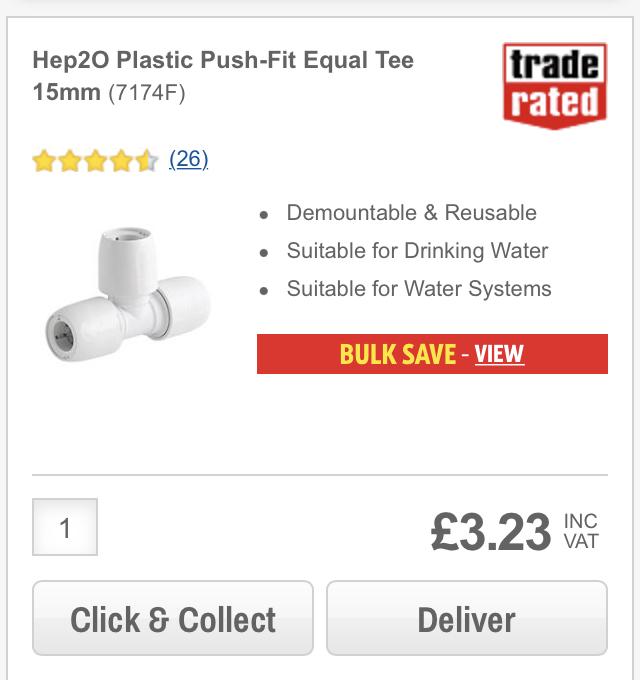

@ProDave I found a Hep ‘T’ on Screwfix in the end and went for that. Couldn’t find one on my first search (hopeless). All sorted now, thanks for the assistance. ?

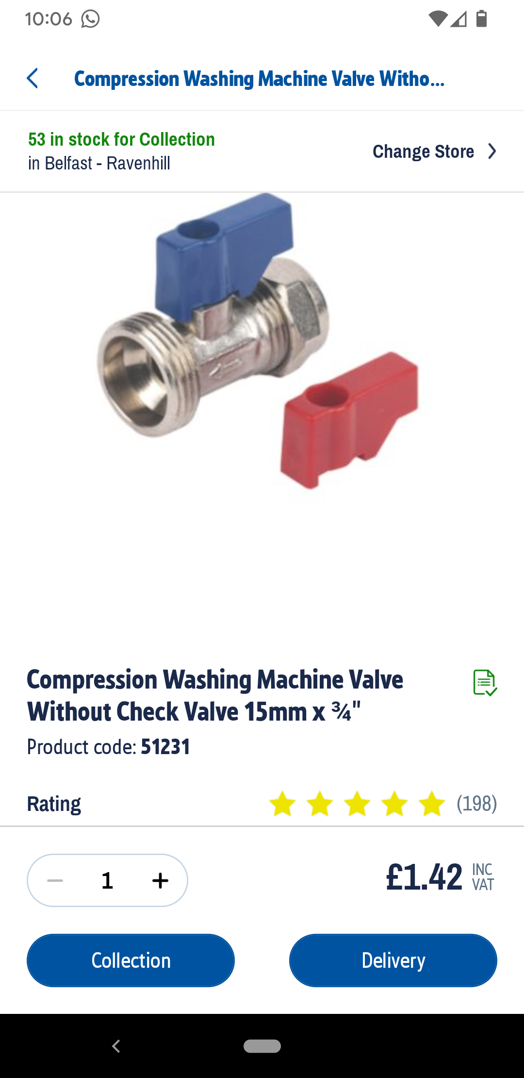

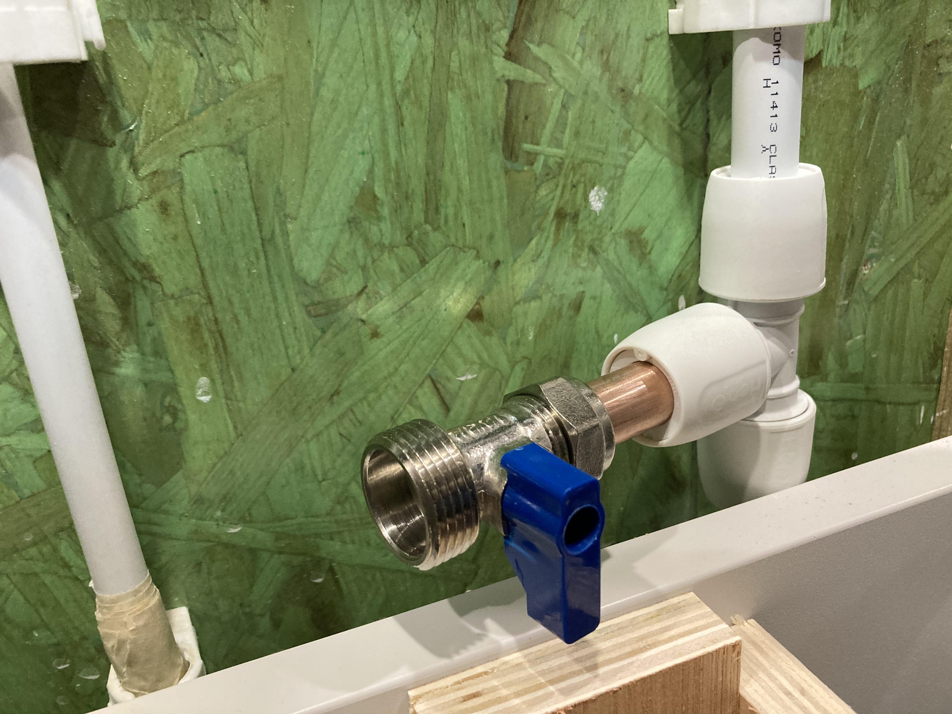

Seems well covered but I've done a few recently.
15mm tee. Short length of copper pipe and one of these valves.

I used one of these Hep2o equal ‘T’s a and a short bit of copper pipe.
