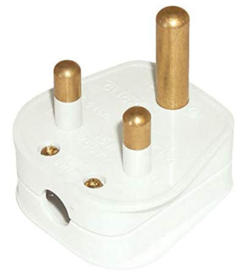

At least things have moved on in the safety department from the previous century, when 5A plugs didn't have insulated pins like their 13A counterparts did.
Now these I would have trusted my kids fingers with:598010539_Screenshot2022-02-2508_47_04.png.8c86b94db93474e7842239c757035fbc.png
