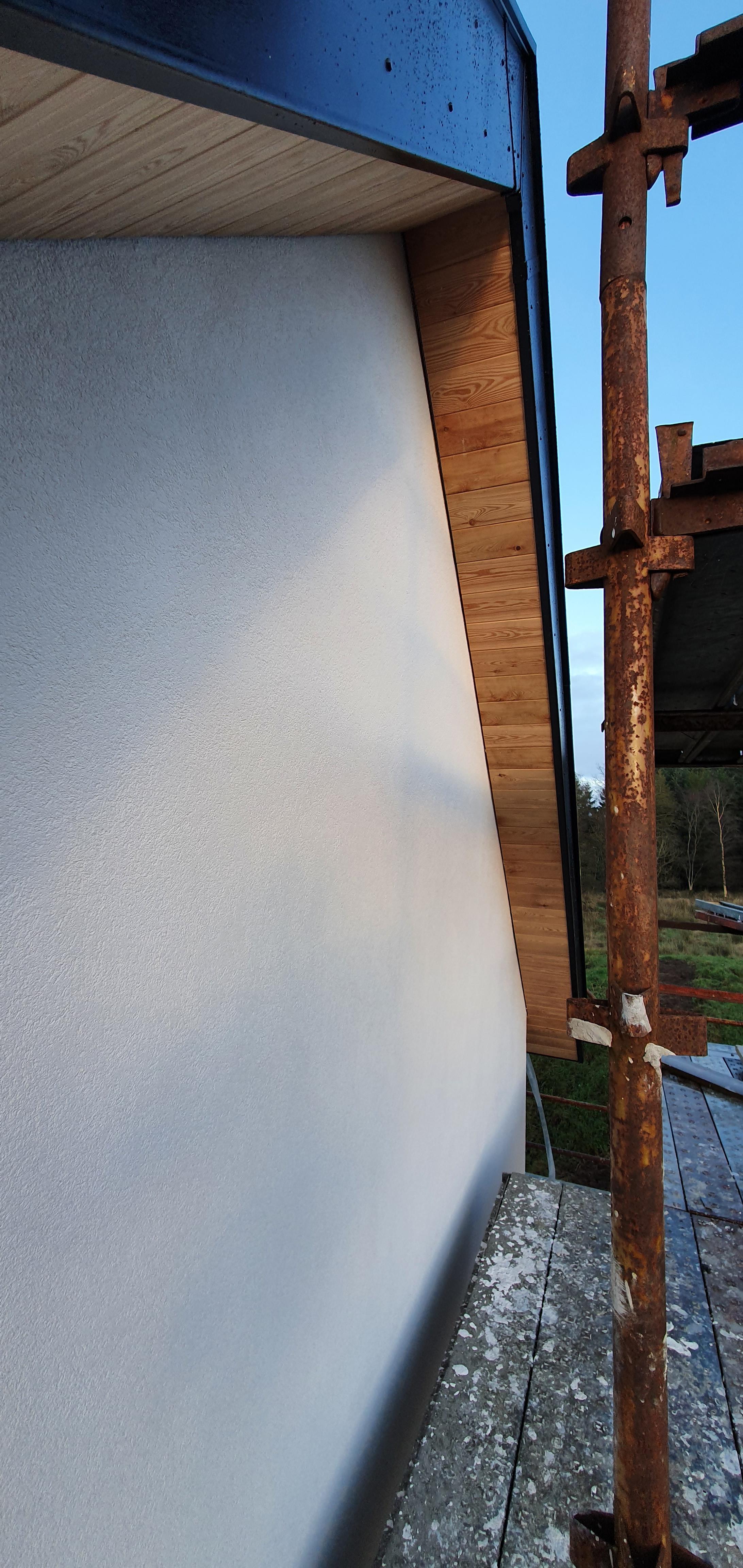

learner Posted February 22, 2022 Share Posted February 22, 2022 Hi Experts I need to fit my S&F's but cant decide... The house is clad in real wood TG weather board, some stained and some white paint and a lot of pain and money has gone in. I have anthracite windows and facias need to match I don't think i can bring myself to add plastic or foam facias on it, i really don't want any nasty looking stuff. £50ish per meter. So, i go for aluminium, looks great but £100ish per meter. What is wrong with timber at £20ish per meter, primed and painted. Ii know there's a chance it will rot over time but as the entire house wood, i cant see a problem, although my V V Good builder and others say its no good. All the timber will need maintenance over time... Any other options or advise is welcome.. Link to comment Share on other sites More sharing options...

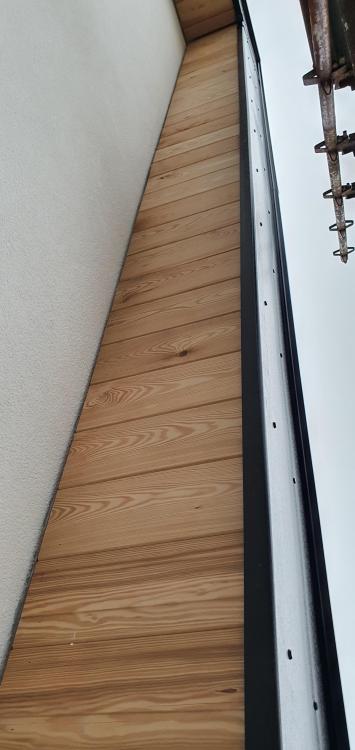

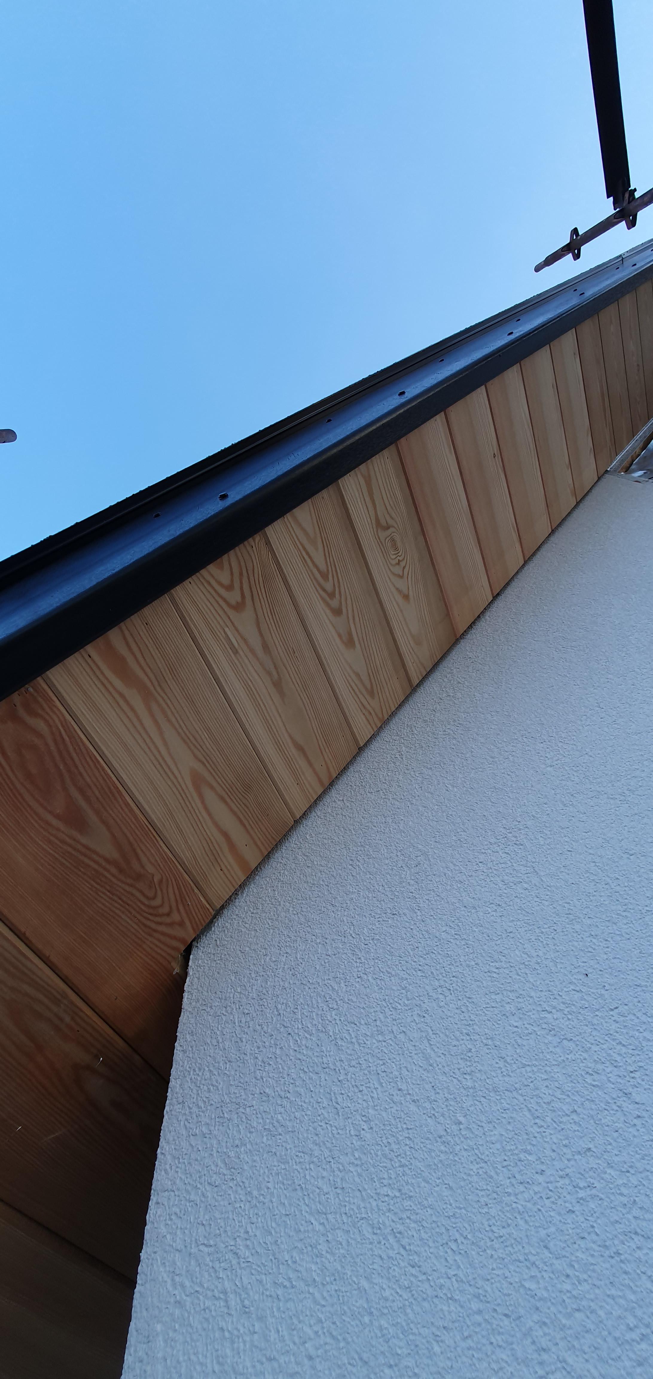

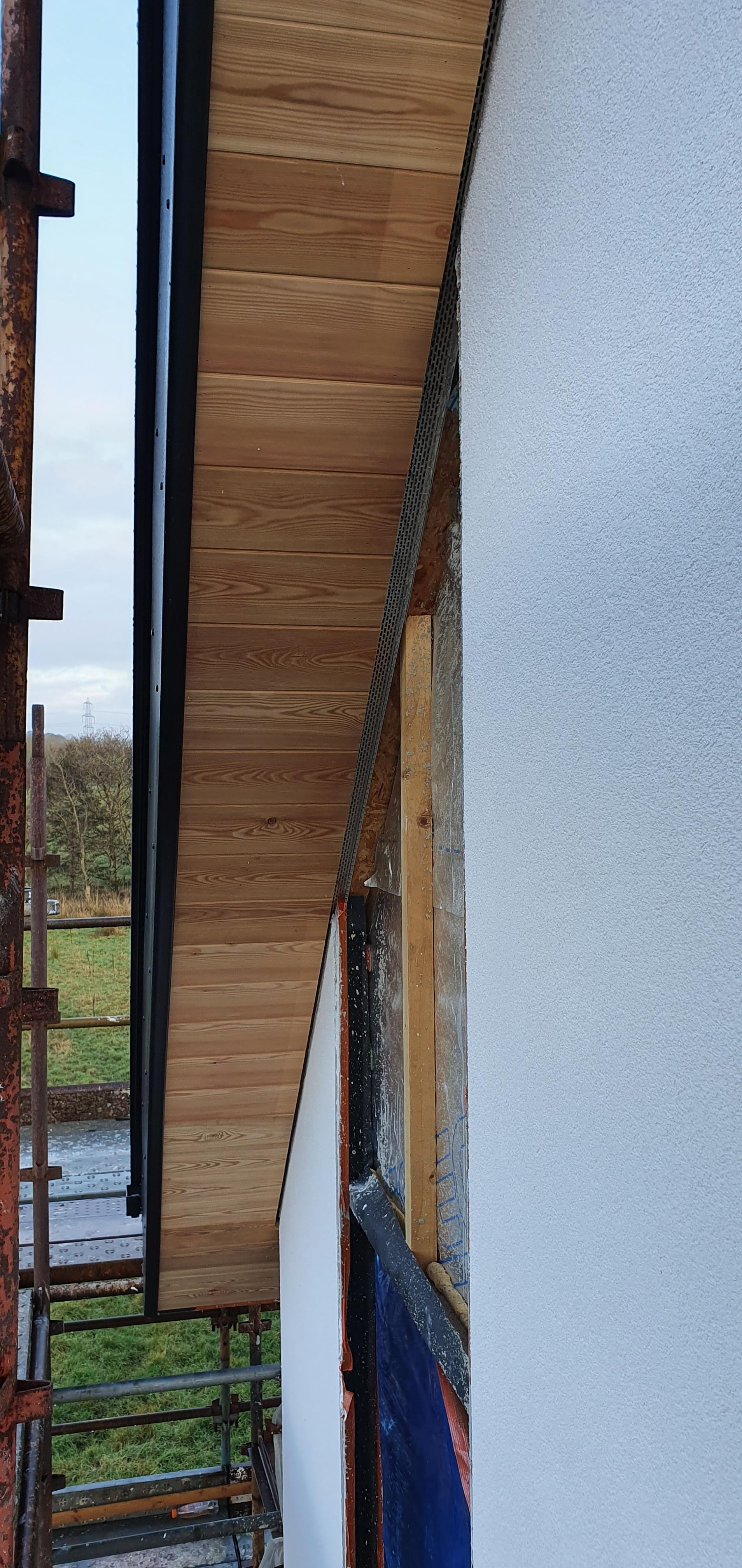

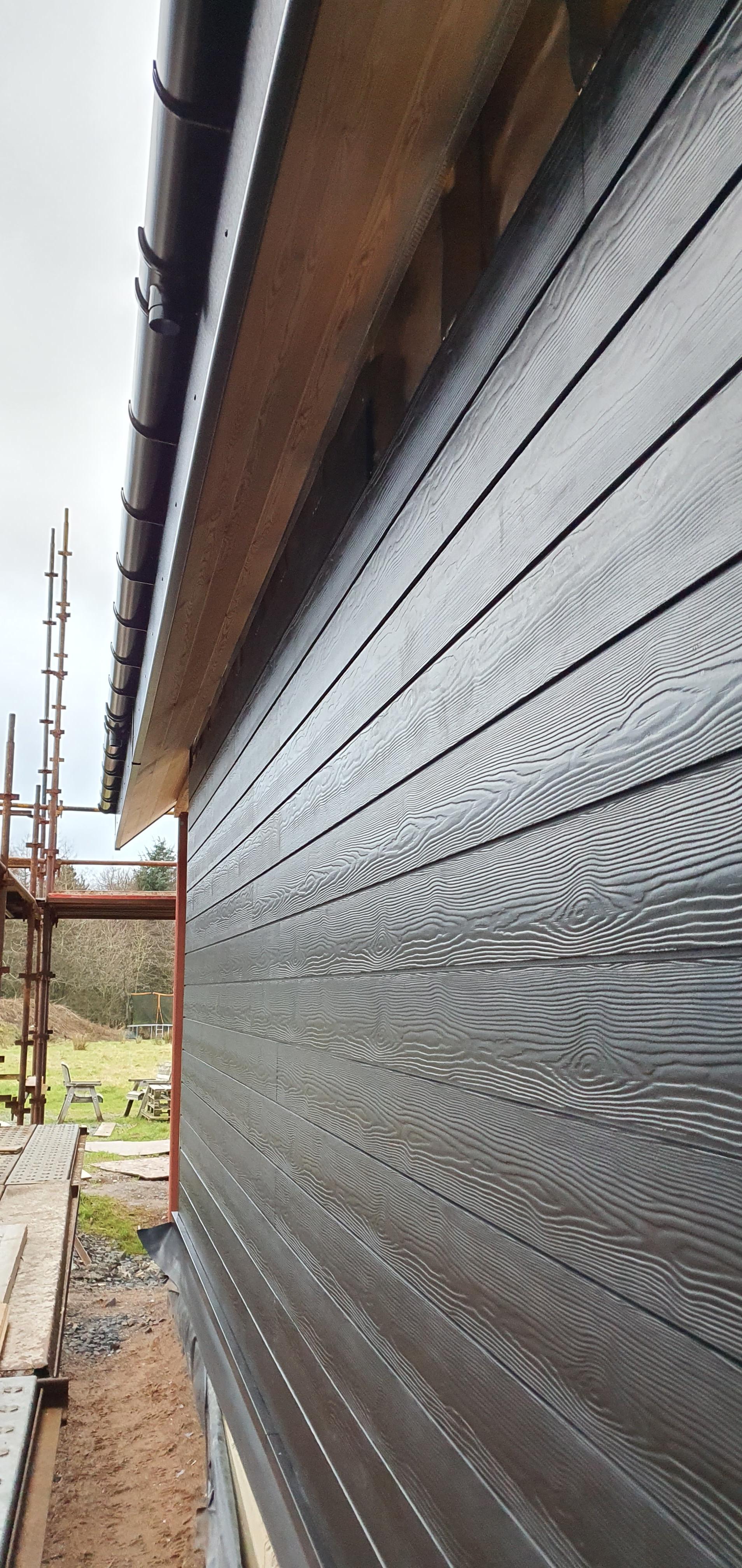

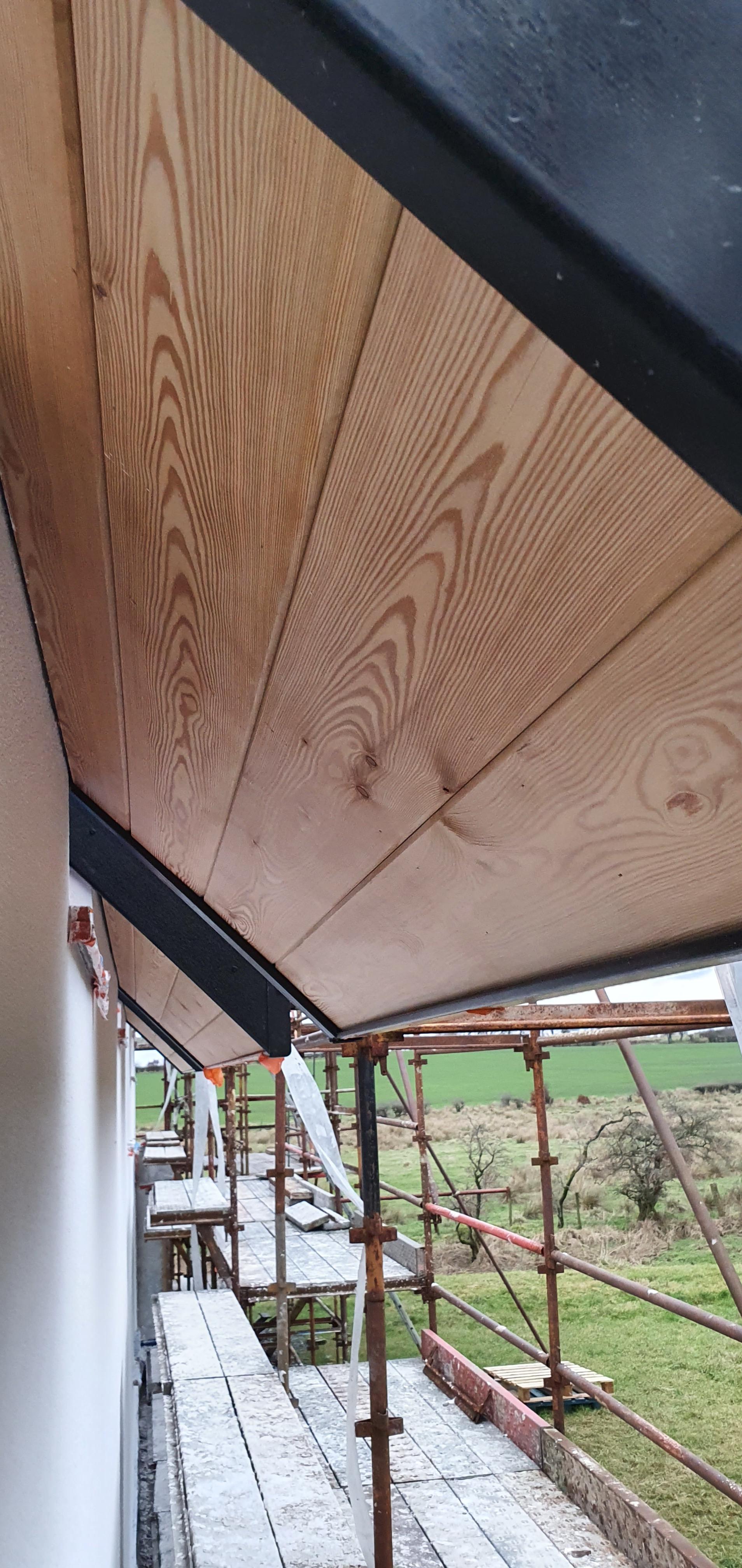

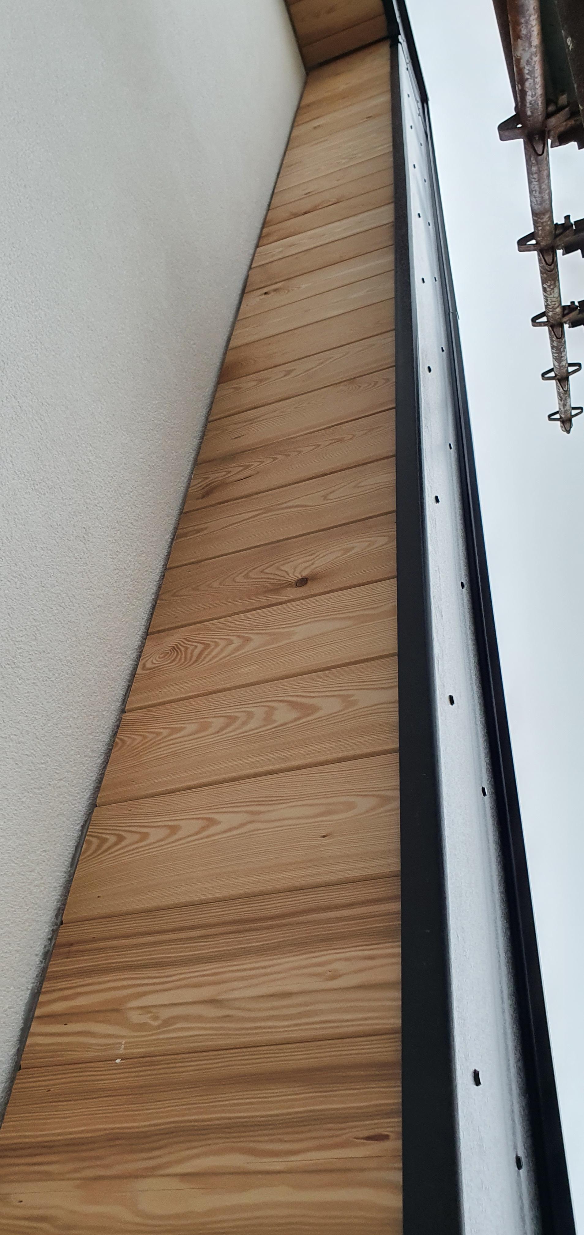

SuperJohnG Posted February 22, 2022 Share Posted February 22, 2022 I have siberian larch soffits and very expensive silicone render system...but opted fir cheap black ash fascias in plastic...they actually look really good. I was limited by the fascia depth at 300mm odd deep. Other option for no maintenance is fibre cement . I have black fibre cement cladding too. Link to comment Share on other sites More sharing options...
tonyshouse Posted February 23, 2022 Share Posted February 23, 2022 I used cedar for fascias and softwood for soffits, soffits get no weather they have darkened nicely with the reflected UV Link to comment Share on other sites More sharing options...
