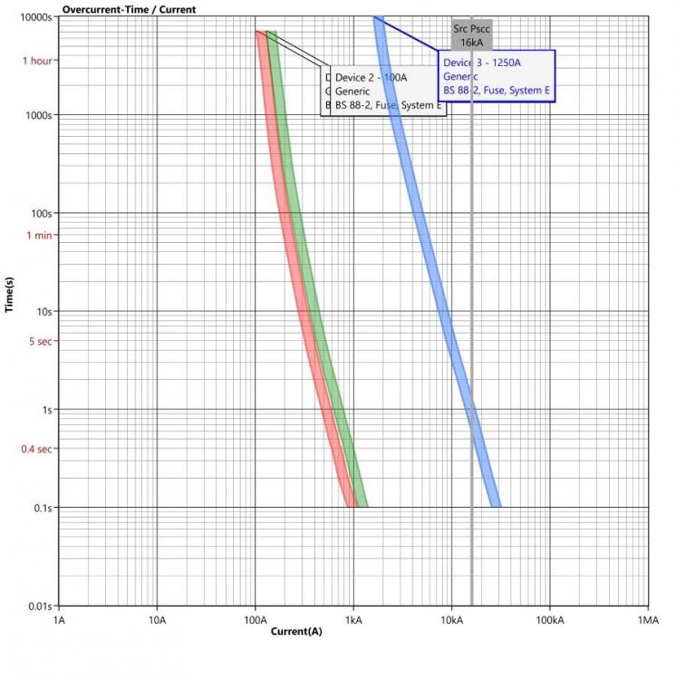

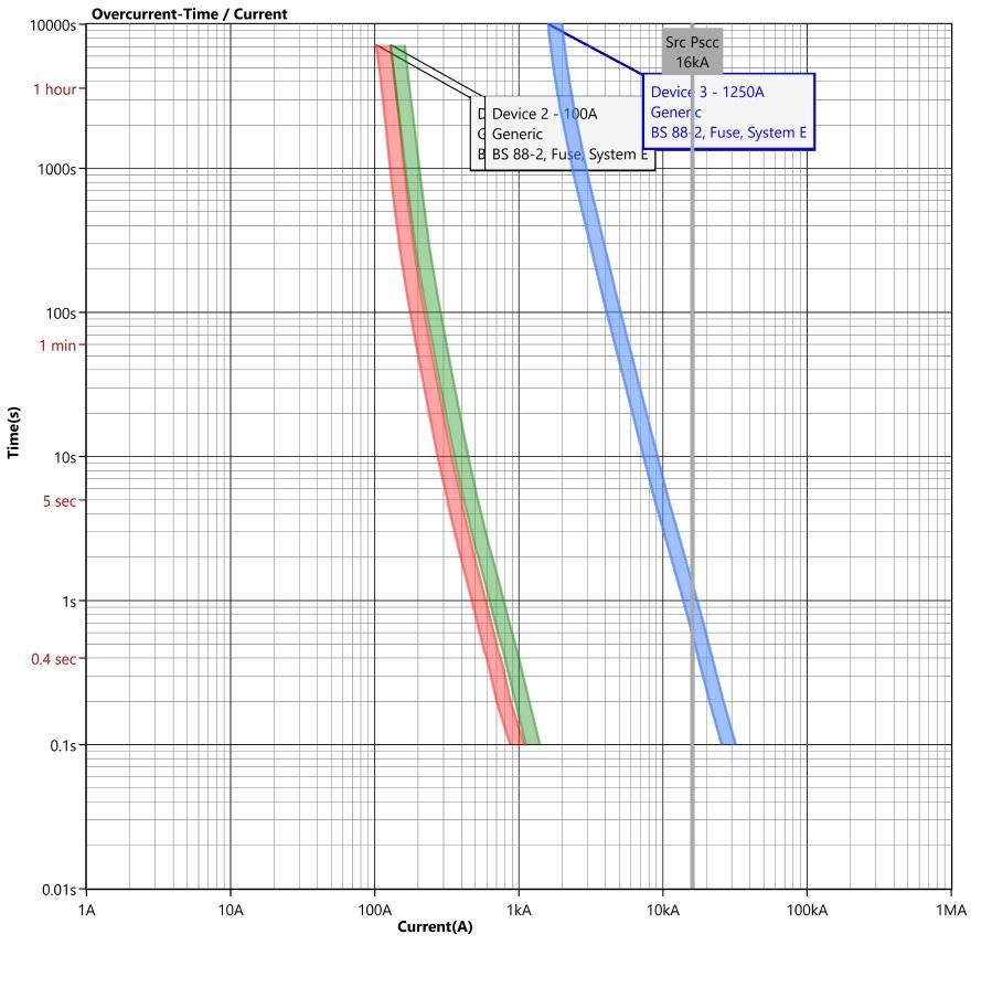

Carrerahill Posted February 23, 2022 Posted February 23, 2022 On 22/02/2022 at 18:34, SBMS said: Out of interest @Carrerahill what sort of a load would justify 3 phase? Expand A diversified load which demonstrates sustained current draw well over the 100A mark. When I do a load assessment, usually for a commercial/industrial development (residential, until now has generally just been taken as a 100A fuse) I take all the main plant loads, lighting loads, small power, lifts, water pumps, EVC, etc. and add them all onto a table. Small power for an office for example is based on office type and W per meter sq. So that gives an estimate of "uncontrolled loads" i.e. plugged in items. In your house you could work this out, by working out how many of you there are and what do you all do. Laptops, TV's, do you run washes a lot, cook a lot etc. etc. Lighting can be much more accurate as you spec the lighting and know the connected loads and switching arrangement so you can work out burn time. Then we apply diversity to the other loads. Lighting might be 80% if you assume stores, WC's etc. and occasional use rooms are not always lit, general power I usually take at 100% because I have already worked out estimated loads and I don't like to reduce it more if I am sure the estimate is good. Lifts in a busy office maybe 70-75%. Vent 90% Water pumps, 60% and so on. At the bottom of the speadsheet it spits out a amps per phase figure, then I add 30% for expansion. On this office I am doing just now the figure was 215A per phase before the spare 30%. So clearly this will be a 3 phase supply, but had that figure rolled up at 16A per phase and I knew that we could get single phase kit, I would propose a 25kVA single phase supply which is about 100A. If you PM me your email address I will send you the spreadsheet and you could tinker with it. I will leave it populated so you can see how it works. 1
ReedRichards Posted February 25, 2022 Posted February 25, 2022 @Carrerahillclearly knows vastly more than I do but I can tell you that the man who came to change my mains fuse assured me that these are very slow blow and you could exceed the nominal current rating of the mains fuse for some time without harm.
SteamyTea Posted February 25, 2022 Posted February 25, 2022 I was taught that fuses are designed to have a life, the higher the current, the shorter the life. Was not a straight line but an exponential curve. This is why, a low amp fuse i.e. may suddenly blow after years of sterling service for no apparent reason. Also why we have quick blow fuses.
Carrerahill Posted February 25, 2022 Posted February 25, 2022 (edited) On 25/02/2022 at 06:54, ReedRichards said: @Carrerahillclearly knows vastly more than I do but I can tell you that the man who came to change my mains fuse assured me that these are very slow blow and you could exceed the nominal current rating of the mains fuse for some time without harm. Expand Indeed, see my graph posted above, that is the fusing curve of a BS88 (what they fit in the fuse carrier of just about every fused supply in the land) 80A and 100A. To get a 100A BS88 to fuse within 1 second (which is slow) you would need nearly 800A. They will of course fuse within 0.1s at about 1000A which is basically instantaneous short circuit protection. Edited February 25, 2022 by Carrerahill 1
