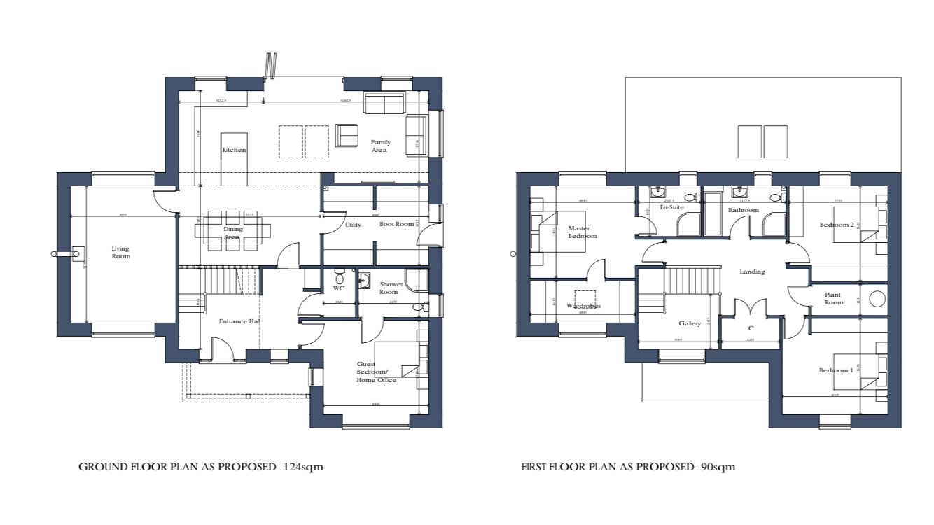

@Iceverge- our ground floor is 147m2 and is planned as a passive house quality build. My friends barn however is not. Built to building regs and is yet fully functional so he won’t have any idea till he starts trying to heat it to work out his usage. I guess the above calculations wouldn’t apply as you state.
I’ve been reading a lot on here regarding active slab heating options which I feel could be a good way to go. Having young children I guess that my heating will fluctuate a lot more than others. Likewise with DHW. I’m happy to seek input on this. I like the idea of the low capital cost of the Willis heater for a slab if I can arrange a solution for dhw. Again growing children may influence this decision.
Is the fan heater your main CH currently? Do you have any other system in place?
An ‘ease of use’ system would be preferable like you say without over complicating things. Coming from a joiner talking plumbing ?

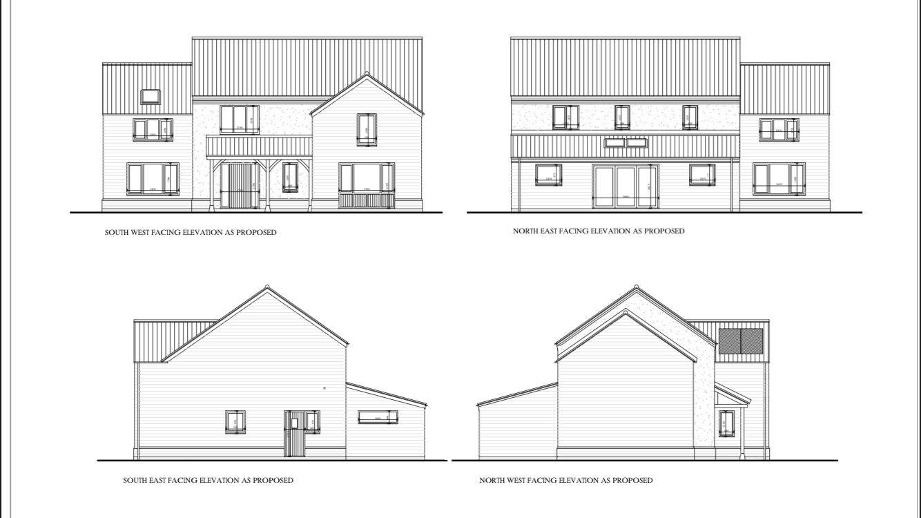

Your lack of east glazing will help minimise morning solar gain but you need a strategy for the southern aspect - blinds (internal or external) etc

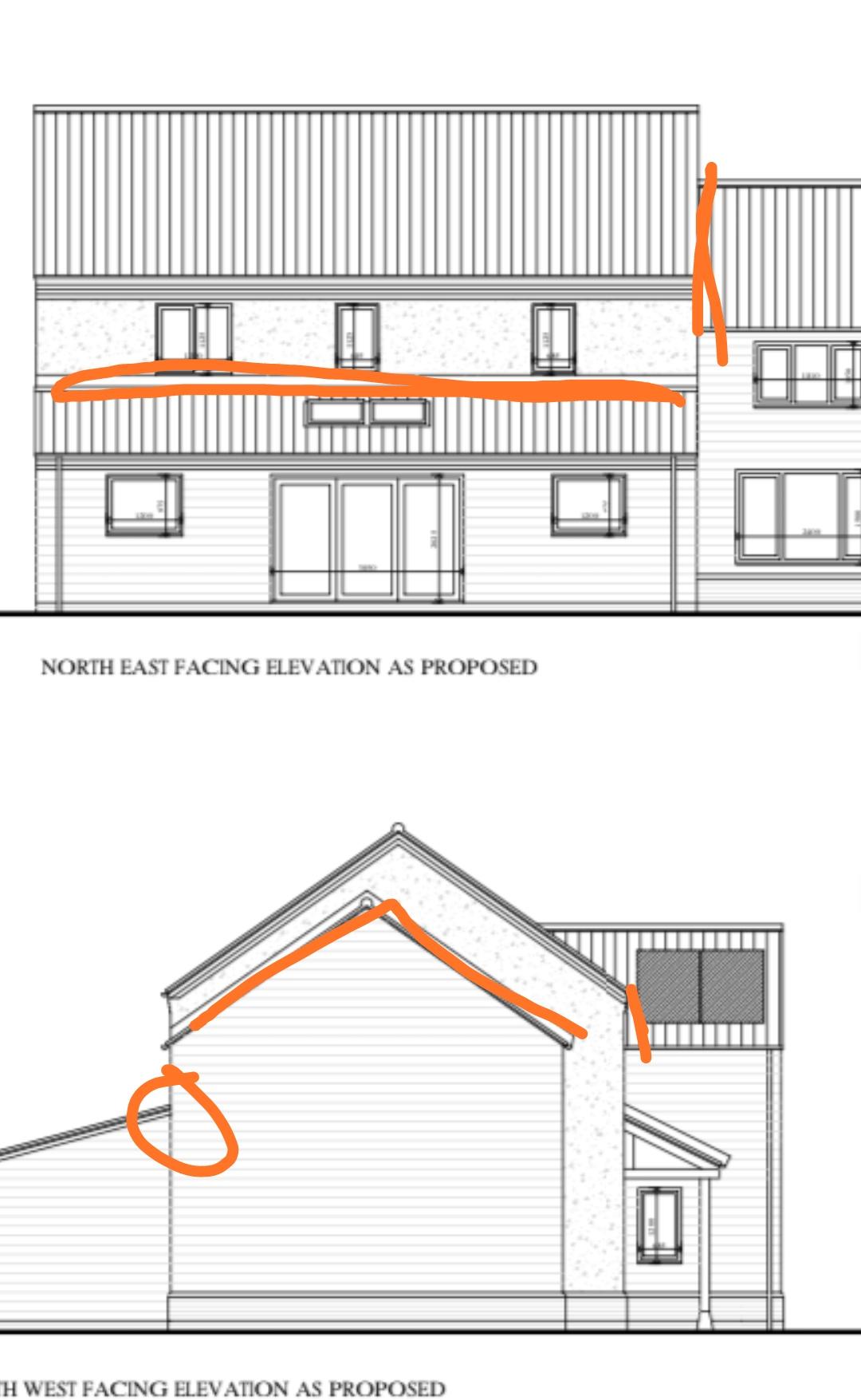

On 01/03/2022 at 22:24, Rishard said:
Does this provide heat into all rooms such as bathroom
Yes. It's remarkable really. It's almost like an absence of cold rather than heat though. Maybe towel rads would be nice in the bathrooms for point heat. We have spurs just in case. However I seem to be be somewhat obsessed by this and find myself making spreadsheets with 30 year coat benefits analysis of the merits of a €100 towel rad. It probably means it's not too much of an issue.
I have a lot of time for bill butcher. His denby dale videos are excellent.
Plant is an open question. MVHR, UVC plus plumbing. Electrical box. No real reason they need to be colocated however. A thing that bypassed me was there is no need for a hot water cylinder upstairs. Originally I was planning a thermosyphon boiler cooker and in later designs the cylinder just got left there. It would have been better in our utility. Keep the MVHR easily accessible. Filter changes are important.
The areas I highlighted above could be quite tricky to install thermal bridge free. Timber frame in cavity wall construction.
The sticky out bit with a steel to support the upper wall will be almost impossible.
Timber frame, EWI or ICF are your friend here.
Link to comment
Share on other sites
@Iceverge- your right, these are the tricky bits. They were raised in our discussions with bill. We did flesh out a few ideas but would be good to iron them all out while I’m at this stage pre building regs ect. For the steel carrying the upper block work above the rear extension we planned to have thermal block work above the steel up to the roofline insulation to reduce thermal bridging downwards. Thoughts? I’m happy to draw out some details. As for the main gable which continues up above the 1.5 story, I haven’t worked out the best solution for this yet, as you say EWI could work. Or timber frame this gable section up to the ridge. I would need to speak with our SE about some of the loading for the ridge though. Hoping to use gluelam for the ridge. Also, the constructions is block/cavity/block based on cost per m2 and other build really reasons. Even as a carpenter by trade I’m choosing blockwork however I can lay block too. Just to complicate things further we’re planning vaulted ceilings with provision for a few ‘on show’ trusses to help with our spans and add character. This makes the gable insulation detail pretty tricky but I’m sure I can find a way. Would love to know if others have worked through any of these details.
Link to comment

19 minutes ago, Rishard said:
The masonry approach is a lot cheaper for me being the main mason ... We plan to attack airtightness with wet plaster much the same as the Denby dale build.
Wet plaster is a big help, and I can understand your reasons for adopting a familiar construction technique, but you also need to address the main vulnerabilities that can lead to bad thermal bridging / air loss.  A couple of examples:
  • The inner blockwork is on the warm side of the thermal gradient.  You don't want a thermal bridge to the ring foundation that carries it.  Using something like Perinsul Foamglas blockwork for the couple of courses that span the FFL will dramatically reduce the bridging.
  • Don't mount your joist direct into the inner blockwork leaf, but rather place in wood fillers when blocking up and then fit and seal joist hangers during first fix. This way you avoid all of the airgap risks.
I am not saying this is the best way for you and your brother , but what I am saying is that you need to identify the risks and decide on construction approaches before you start the build rather than putting in retrospective mitigations.
