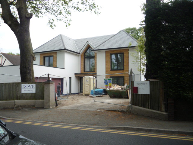

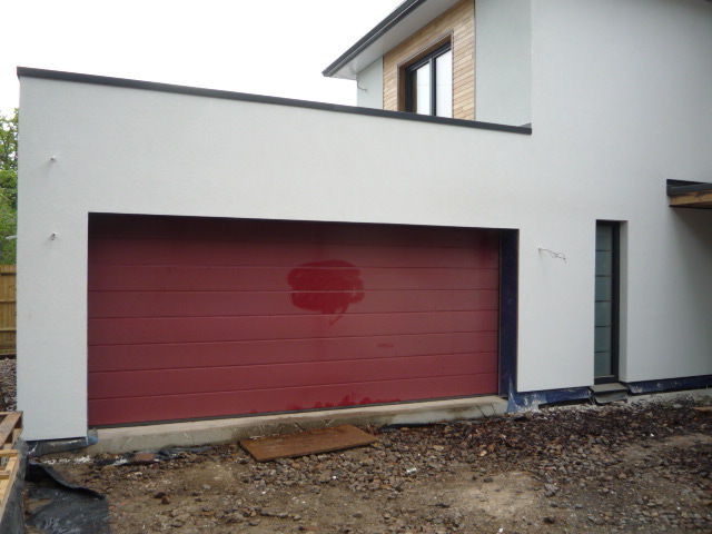

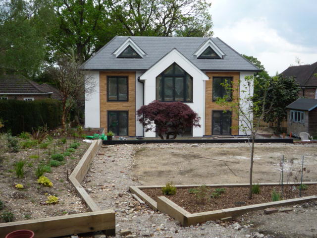

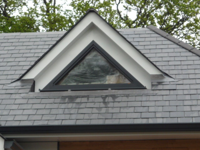

We used a guttering firm as we have alu-clad parapets, they then also did alu fascia, soffits and barges for the house and garage at a reasonable rate, as well as the guttering & downpipes - all powder coated in the same RAL as the windows (7012).
Most of it was fabricated on site (mitered joints) but some elements were welded off site (such as the boxes where fascia, barge and soffit meet).
Looks very smart and glad we upgraded from the planned white UPVC, however I would perhaps have gone for more welded joints than cut mitres as they look sharper.
I'd be surprised if a roofer would take this on as it's not really in their realm, but you never know.
Guttercrest.co.uk is a good place to source materials but I'm glad I didn't go down the DIY route as it looked very fiddley to get it right.

We used the same guttering firm as bitpipe. We used a combination of plastic  and aluminium soffits and fascias. All aluminium would have been very expensive as we have very large soffits around the house. MBC fitted all the wooden fascias and soffit ledgers and the guttering firm then fitted everything else - soffits, fascias, aluminium seamless gutters and then the alumnium trims around the dormers and gables.
We still have some aluminium trims to be completed around the garage doors.

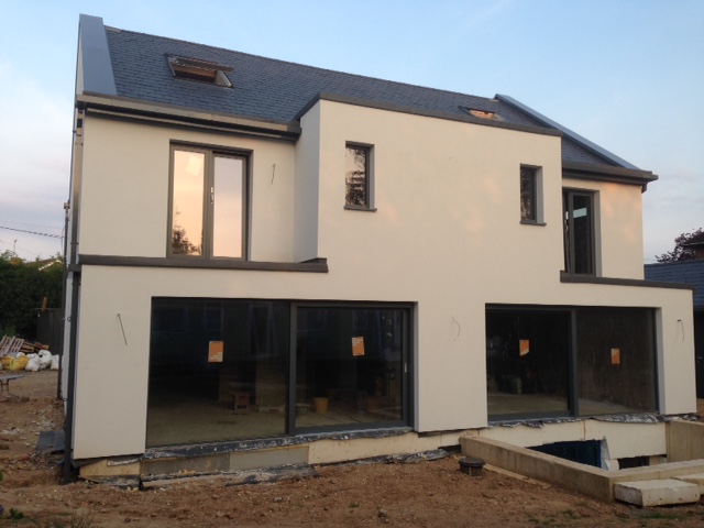

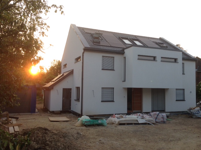

I'll add to what is now the "Readers Houses' section.
We used a Parex render system, window blinds were supplied in the wrong colour so are being changed for RAL 7012.
I was surprised at the amount of fitting required for the coping and other trim, like Herb, MBC left me with timber (OSB) soffits & facias but still a reasonable amount of work getting it up - the scaff had come down at that stage so it was done from ladders which makes it more tricky - be aware if you're considering DIY.

MBC formed the parapet, fasica and soffit on the main roof in OSB and built a frame for the utility and garage, they don't fit any finish such as uPVC or Alu.
Working with large (3m) alu sheets at that height is not trivial and was a lot more involved that I expected, making cuts to get the detailing right, expansion gaps etc. Glad I left it to the professionals.

I'd only agreed an 8 week hire period in the erection price, MBC covered some over-run as they were late starting but it was costing me 5% of the hire cost per week for over-runs so as soon as the render was done, I wanted shot of it.
I know HerbJ negotiated a much better arrangement and had his in place for much longer. Even with scaff in place, it's still a bit hairy clambering over a roof, especially wet slate !
