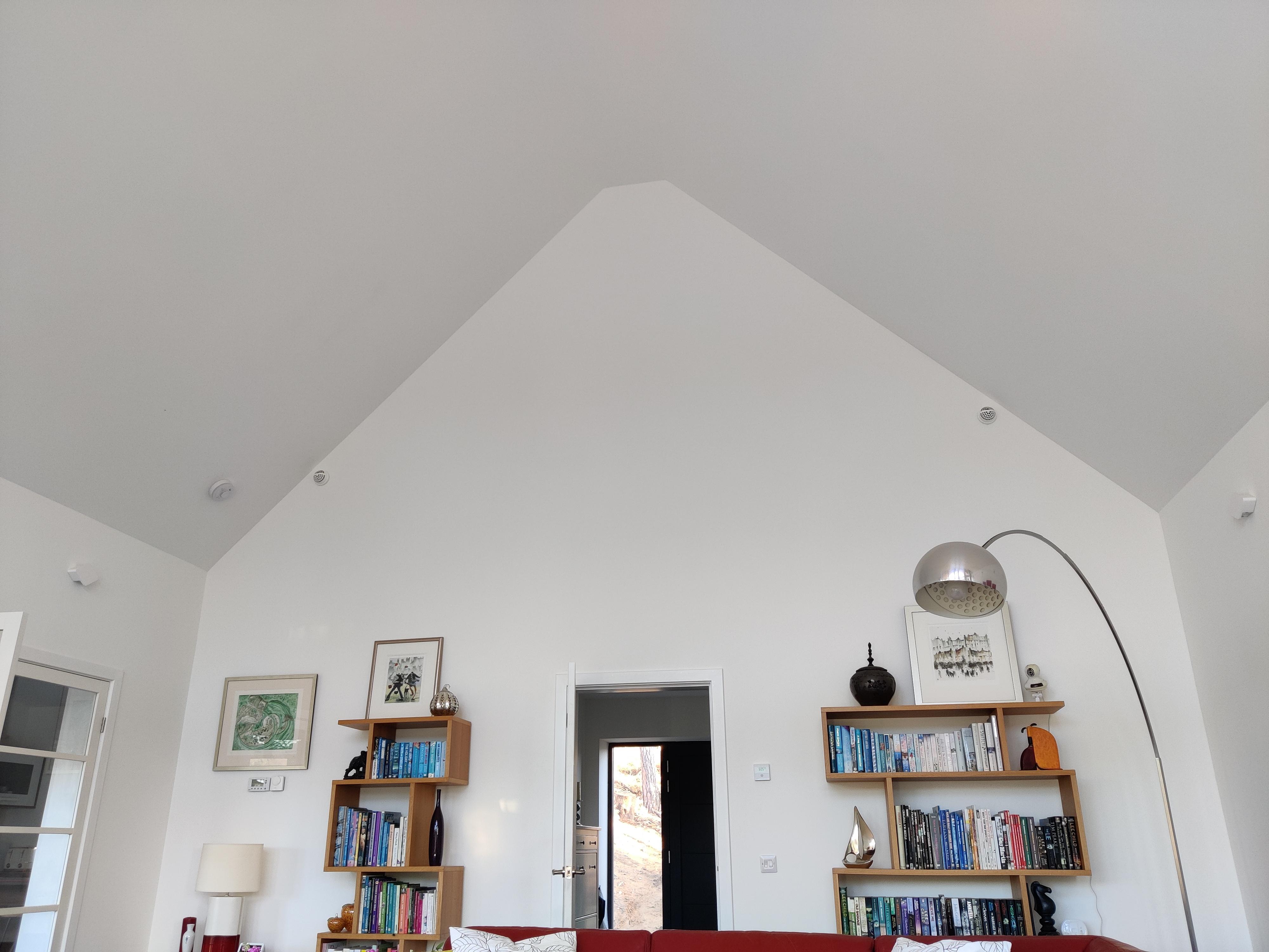

JohnMo Posted February 8, 2022 Share Posted February 8, 2022 54 minutes ago, jayc89 said: I hadn't mainly because the extension will likely double the footprint of the existing property so assumed MVHR would likely be justified. In reality it's only 2x downstairs rooms (plus hallway) that would be difficult to retrofit, which I think we could live with. Have a look at coanda effect nozzles, these will make the air travel from one side of the room to the other, so routing pipes is easier. These are what I used these for our supply nozzles. Zehnder 990326254 1 Link to comment Share on other sites More sharing options...
hb1982 Posted February 9, 2022 Share Posted February 9, 2022 17 hours ago, JohnMo said: Have a look at coanda effect nozzles, these will make the air travel from one side of the room to the other, so routing pipes is easier. These are what I used these for our supply nozzles. Zehnder 990326254 For clarity I supposed that is for side wall installation, at high level as close to the ceiling as possible? Link to comment Share on other sites More sharing options...
JohnMo Posted February 9, 2022 Share Posted February 9, 2022 Pretty much. Photos of mine in the lounge. The MVHR unit is in the plant room the other side of the wall. Pipe run approx 3m, to one nozzle on the other is about 8m. Also have one in the hall, that pipe run is also 3m. The air comes down after approx 4 to 6m depending on flow rate. So is in effect the same as having the nozzle on the other side of the room. Link to comment Share on other sites More sharing options...
