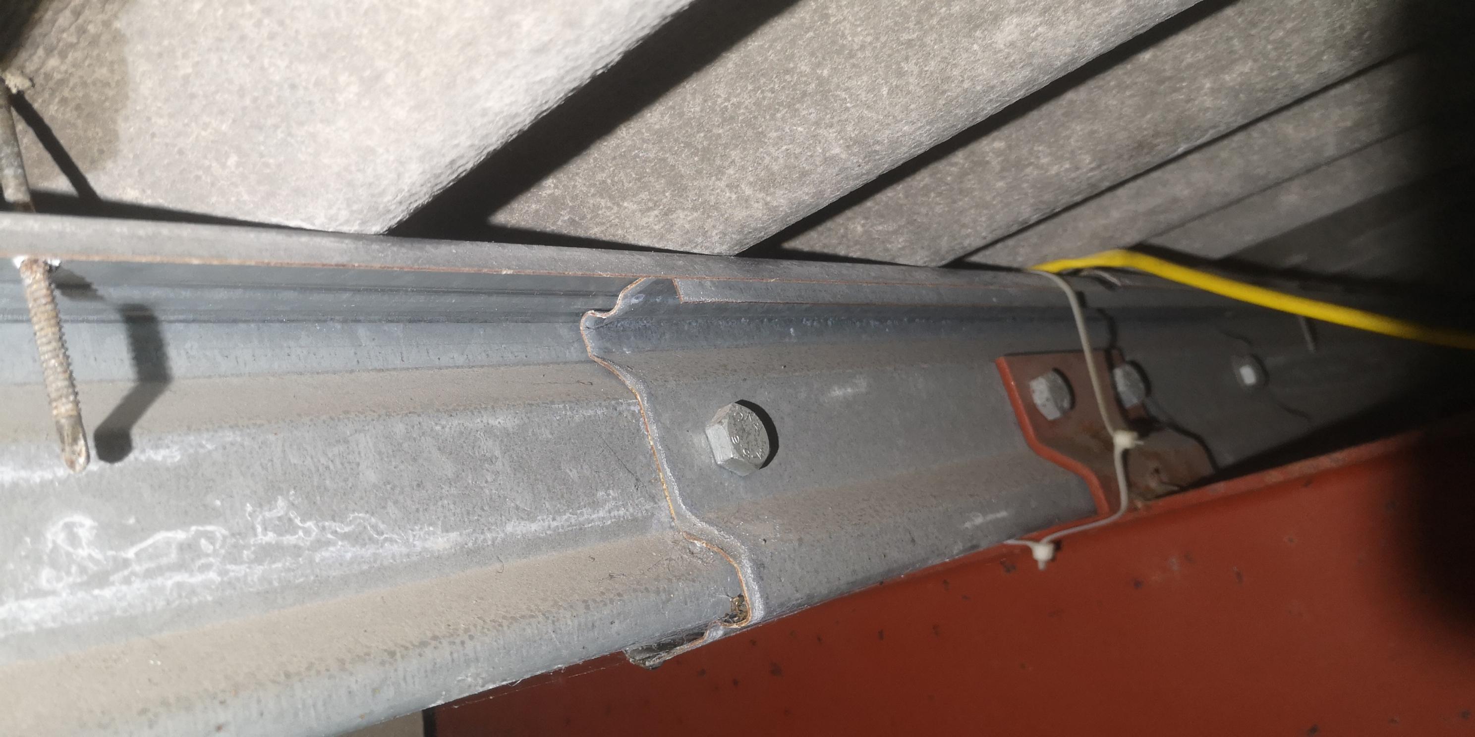

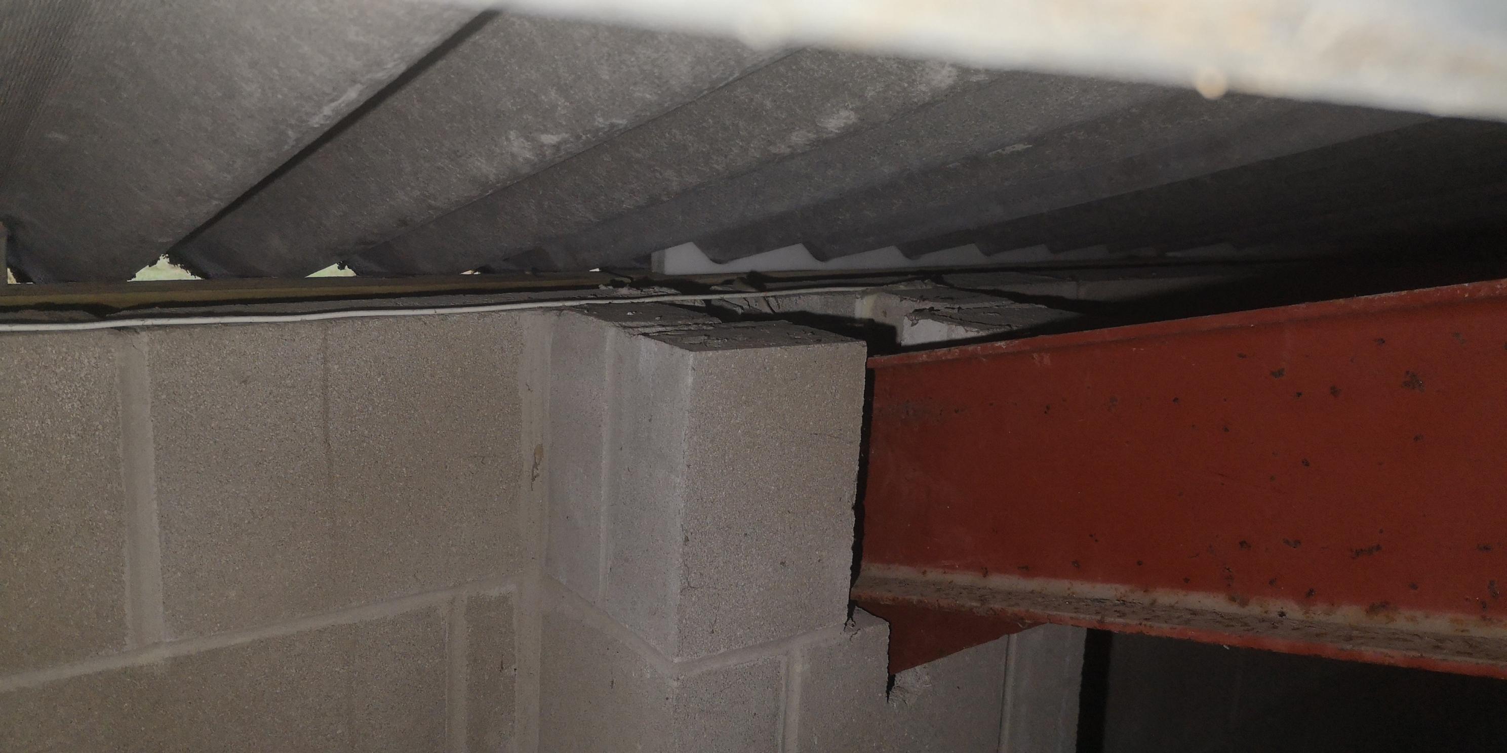

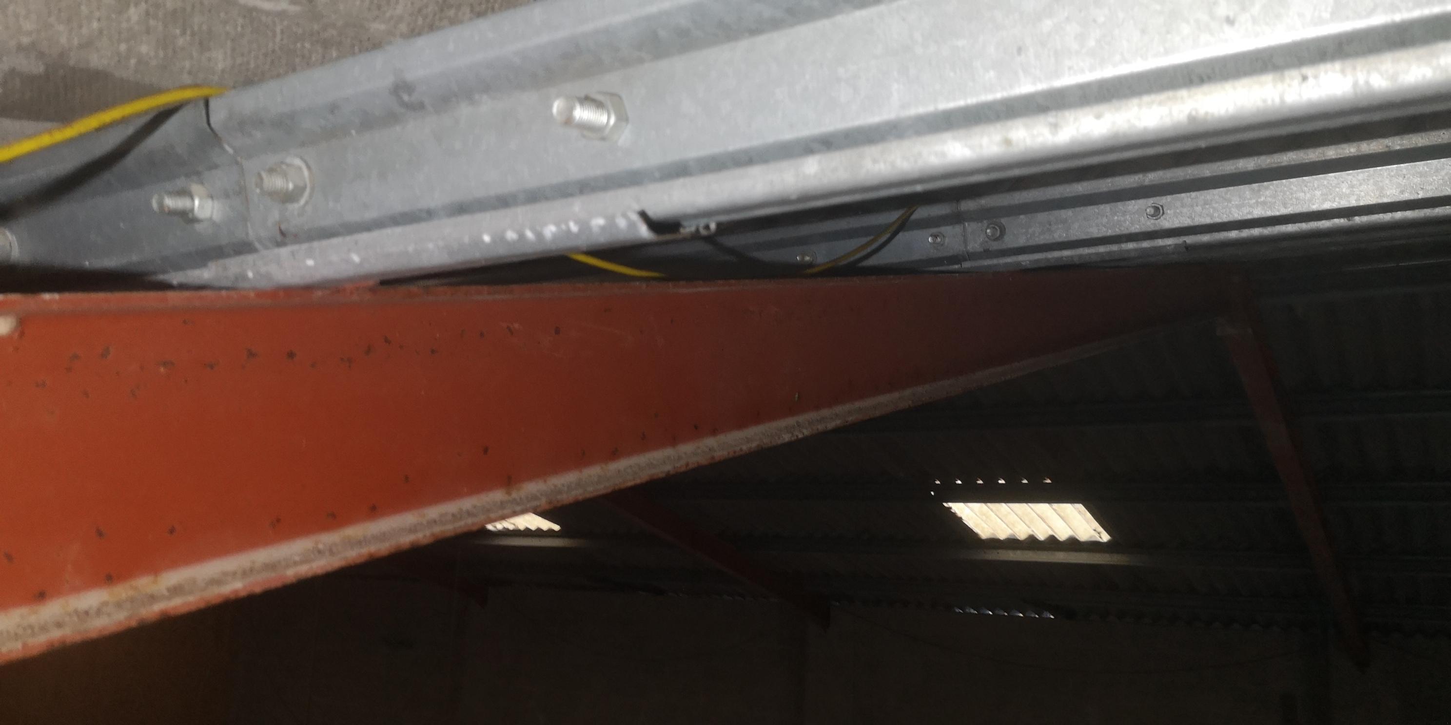

Roger440 Posted November 6, 2022 Author Share Posted November 6, 2022 Ok, so i have finally gotr up into the roof space to have a better look. A good point raised earlier, was if doing with some sort of membrane/rockwall about wind pressure above. Looking at these pics, id guess it could by blocked off. But it would still need ventilation somehow. As you can see in the third pic, a fair number of the screw holes leak slightly so get damp patches at times. I guess sealing these up will work, but thats a mamoth undertaking! In the back of my mind i keep thinking, maybe just spend the money and replace the roof with composite steel. All problems fixed in one go. And white on the inside too.............. But VERY spendy. Choices, choices. Link to comment Share on other sites More sharing options...

Roger440 Posted December 10, 2022 Author Share Posted December 10, 2022 Ok, im back. Again After lots of thinking, researching, pricing up etc, i think ive concluded that my cheapest viable and worthwhile option is celotex or similar in the roof, rockwool slabs on the walls covered in steel cladding. Ill put the celotex in between the galvanised purlins, which means smaller pieces thus easier to fit, but will need careful detailing. This leaves airflow over. I intend to use 120mm which means that i can have 20mm covering the bottom of the purlins. The only issue i see with that otherwise clever plan is the steel joists (red oxide) will be inside the thermal envelope in the roof, but outside it on the verticals, where they are in the cavity. Realistically, thermal issues aside, does anyone see a problem with that? Link to comment Share on other sites More sharing options...
