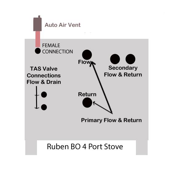

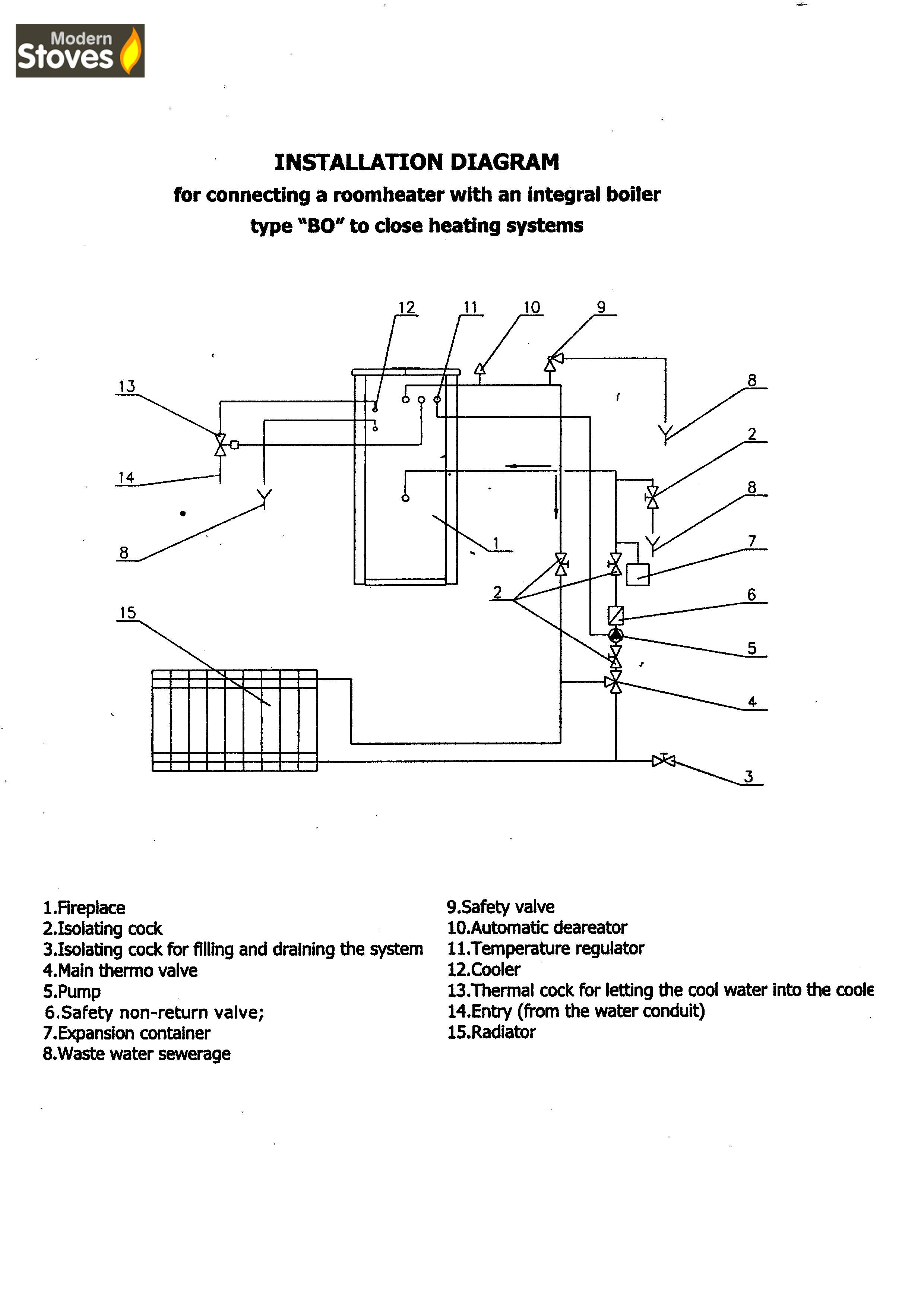

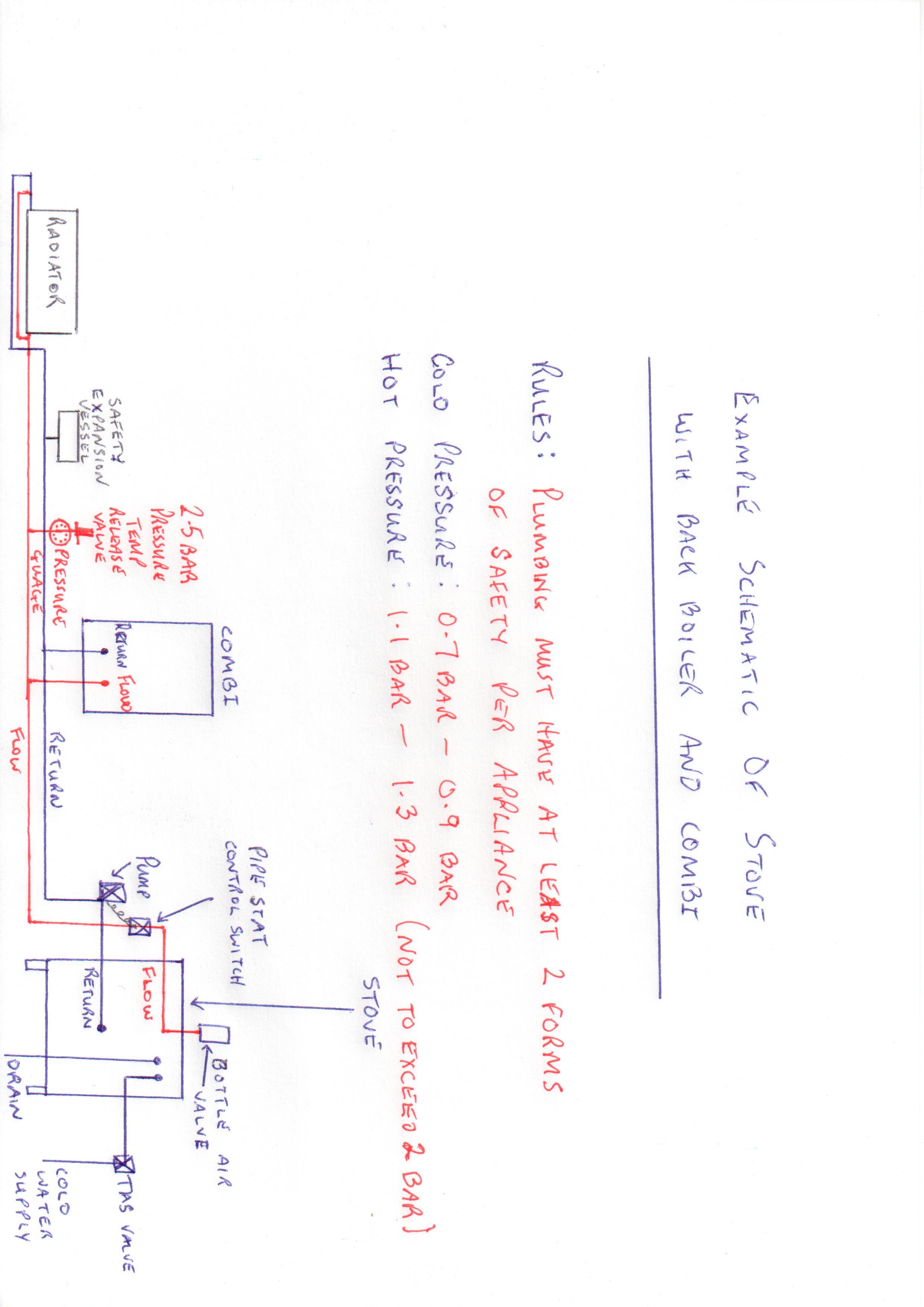

Lewis88 Posted January 28, 2022 Share Posted January 28, 2022 Hi, ive been doing as much research as I can to see what heating system would suit my family. I’m currently looking down the route of ASHP however I have decided that I am using a log burner/boiler. the stove I have decided on can be linked to a sealed system and I have schematics on how to link it to a combi boiler system (as per building regs) the stove has a 97 degree thermostat that will mix cold water and dump hot should that temperature be exceeded (doesn’t require electric for this). my question is can this type of system be linked to a ASHP thermal cylinder? My reasoning for this is myself and my partner will have the log burner lit in the afternoons and evenings when it is cold outside. As this is the time of year that ASHP is likely to struggle it seems perfect to marry the systems up. the stove itself is this: https://www.modernstoves.co.uk/product/stoves-with-back-boiler/istove-lux-15kw-multi-fuel-wood-burning-stove-with-back-boiler-4-water-ports-for-vented-or-un-vented-central-heating-hot-water/ and the company has provided me with these schematics to link it to a combi system. Can anyone see any issues to linking it to an ASHP instead? Link to comment Share on other sites More sharing options...
Bruno Posted January 28, 2022 Share Posted January 28, 2022 (edited) I have a similar setup (which I regret already, I never wanted to burn another log after I have the AHSP running?) This can be achieved either with a buffer tank which has 2 separate inputs (one from the burner and the other from the AHSP) or with "single-direction-flow" valves (sorry, no idea what's the English name for it) on the single input of the buffer tank (this was the option my installer chose in order to have a smaller buffer tank - separate input tanks are always bigger). This, however, has a big problem which must be taken care of: usually the circulating pump after the buffer tank (which goes to the radiators) is controller by the heat pump. When you are using the log burner, the heat pump will stop and so will the circulating pump. This is dangerous as too much heat can build in the buffer thank. It is therefore necessary to create a secondary command to the circulating pump: it is either activated by the AHSP or by the circulating pump of the log burner's water circuit. edit: IMO don't do it What you can do is take that money and replace your radiators with bigger ones, if possible ventilated. If you increase its emitting capacity you can work with lower flow temperatures and therefore increase efficiency. And don't forget insulation. Any heating source that you choose will need to restore whatever energy the house looses, so less losses less heating requirements. Edited January 28, 2022 by Bruno Link to comment Share on other sites More sharing options...

ProDave Posted January 28, 2022 Share Posted January 28, 2022 I would forget the back boiler in the WBS that adds so many complications as it's an "uncontrolled" heat source so there must always be somewhere for the heat to go preferably by convection so not relying on a pump. I would still fit a WBS (I have) with a few caveats: Only fit a room sealed stove, that draws it's combustion air from the outside directly via a duct and make sure it is one that draws primary AND secondary air from the duct (not all do) And site the stove in a place that heat can circulate to a lot of the house by convection. We achieved that by double doors from the kitchen / diner with the stove to the central stair well where heat can circulate upstairs and to the living room across the hall also with double doors. Our house has a worse case heat loss of 2.5kW so our 5kW stove will comfortable heat the whole house, in fact if you burn it too long it will overheat the whole house. It is important that the heat can circulate to most of the house otherwise it would very quickly overheat just the room that it is in. Link to comment Share on other sites More sharing options...

Lewis88 Posted January 28, 2022 Author Share Posted January 28, 2022 In response to ProDave, I can situate the LBS directly underneath a thermal store etc. the store would be on the second floor. I did see that the stove I had chosen could be used with vented or unvented cylinders so could an ASHP be linked to a vented cylinder without the same issues? Link to comment Share on other sites More sharing options...

TonyT Posted January 28, 2022 Share Posted January 28, 2022 Back in the day, the dunsley neutraliser was talked about in situations with WBS. https://www.solidfuelappliancespares.co.uk/product/c-type-neutralizer/ Link to comment Share on other sites More sharing options...
