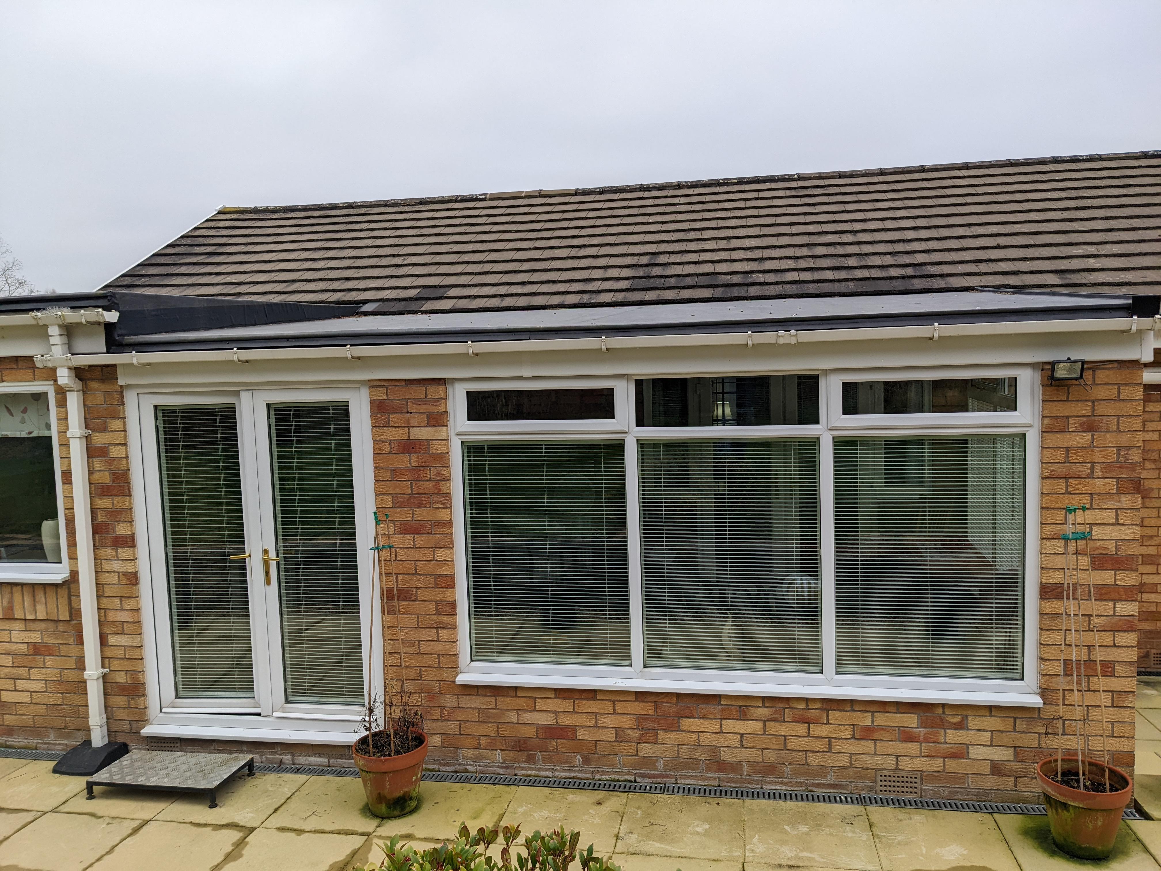

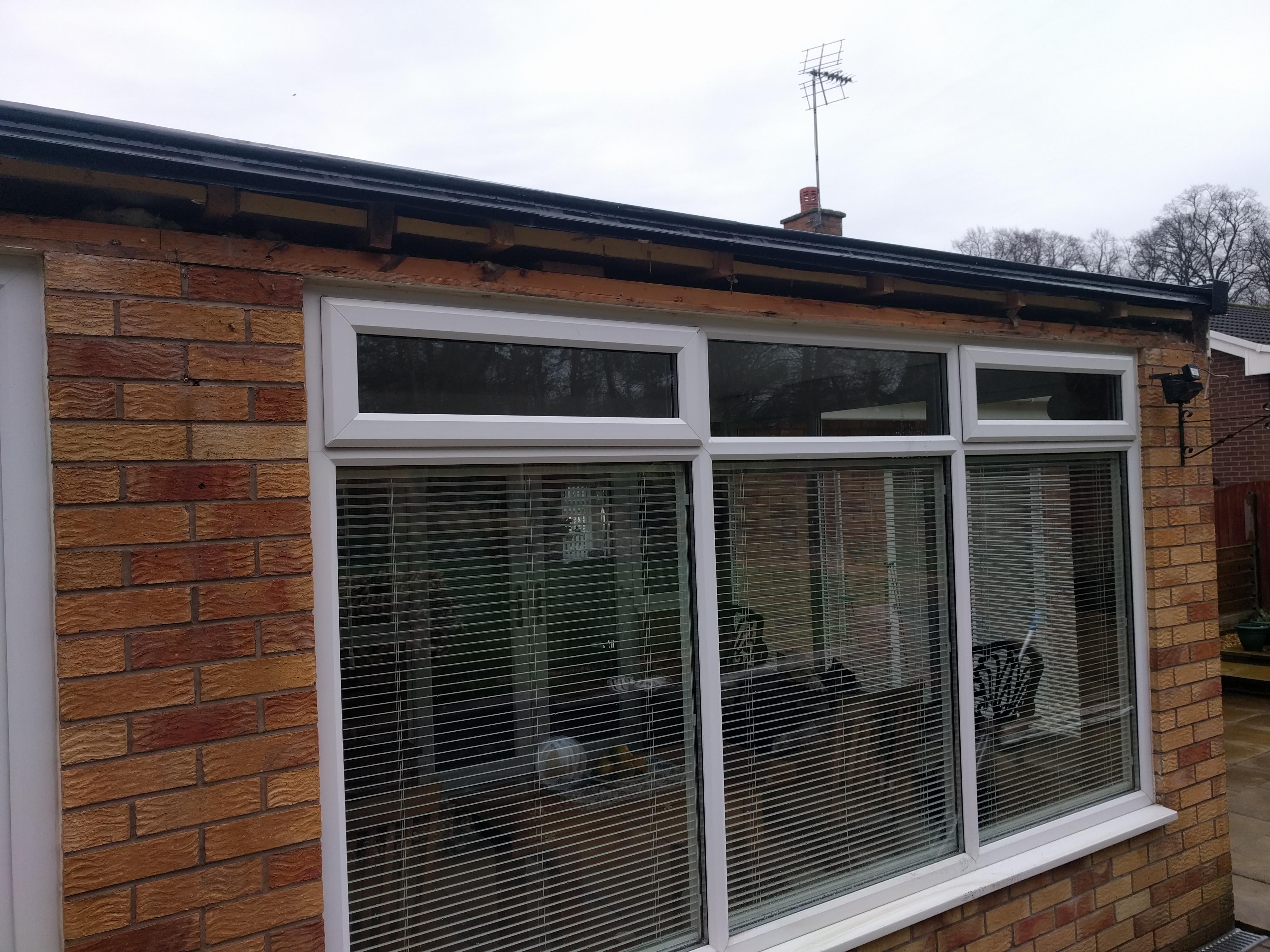

BobAJob Posted January 22, 2022 Posted January 22, 2022 A couple of years ago we had our EPDM covered flat roof recovered as the previous installer hadn't glued it to the roof. Today I had a fascia board on the roof replaced and the fascia board installer remarked that the roof wasn't the best. I'm no roofing expert, so I wondering if someone can tell me if this cross-section of the roof looks correct? To me it looks like nothing is supporting the wood spanning the roof so it's effectively floating in the air, which doesn't sound right to me.
BobAJob Posted January 24, 2022 Author Posted January 24, 2022 Can anyone help me with this, please? There are bits of wood running across the roof with yellow insulation boards in between, but the bits of wood running across the roof don't land on a piece of wood on the window/wall side and are just floating there. I think I might need to get the entire thing replaced in the summer. The roofer who did the new rubber roof on it didn't mention any problems with it. It was originally installed by previous owners about 10 years ago. I want it safe, water tight and well finished. It's about 6m x 2m. How much would that cost? Thanks
Dave Jones Posted January 24, 2022 Posted January 24, 2022 you have a cold roof, this means you need copious ventilation to keep it dry. Much better would be a warm roof.
Gordo Posted January 24, 2022 Posted January 24, 2022 (edited) Yeah that all looks like a bit of a bodge job. Wall plate on outer brick leaf vulnerable to decay and No obvious lintel / beam over window to support flat roof joists. Window is doing a fine job of support tho lol. Joking aside it’s Not going to straight forward job to sort that out properly as there is so little depth to work with. Likely a heavy angle iron or channel section (consult a structural engineer) And as Dave said the ventilation is also a problem. Warm deck advice is sound under new weather proofing layer. Edited January 24, 2022 by Gordo

ProDave Posted January 24, 2022 Posted January 24, 2022 What you are seeing there is a woefully poor lack of design and lack of detail. the rafters are probably supported on the wall plate on the inner leaf of the wall, something is supporting them, they are not just levitating there. That is the least of your problems. The way the insulation is fitted, it might as well not be there. you need to ventilate the gap between the rigid insulation and the roof deck board, but you DON'T want to ventilate the space under the rigid insulation and what looks like a poor bit of glass wool insulation below. To make the best of a bad job you want to seal up underneath the rigid insulation so that the necessary air vents in the soffit board only ventilate the space above the rigid insulation. so the space between the rigid insulation and the wall plate needs to be completely sealed, and when the soffit board goes back it needs vents at the top to vent the space above the insulation.

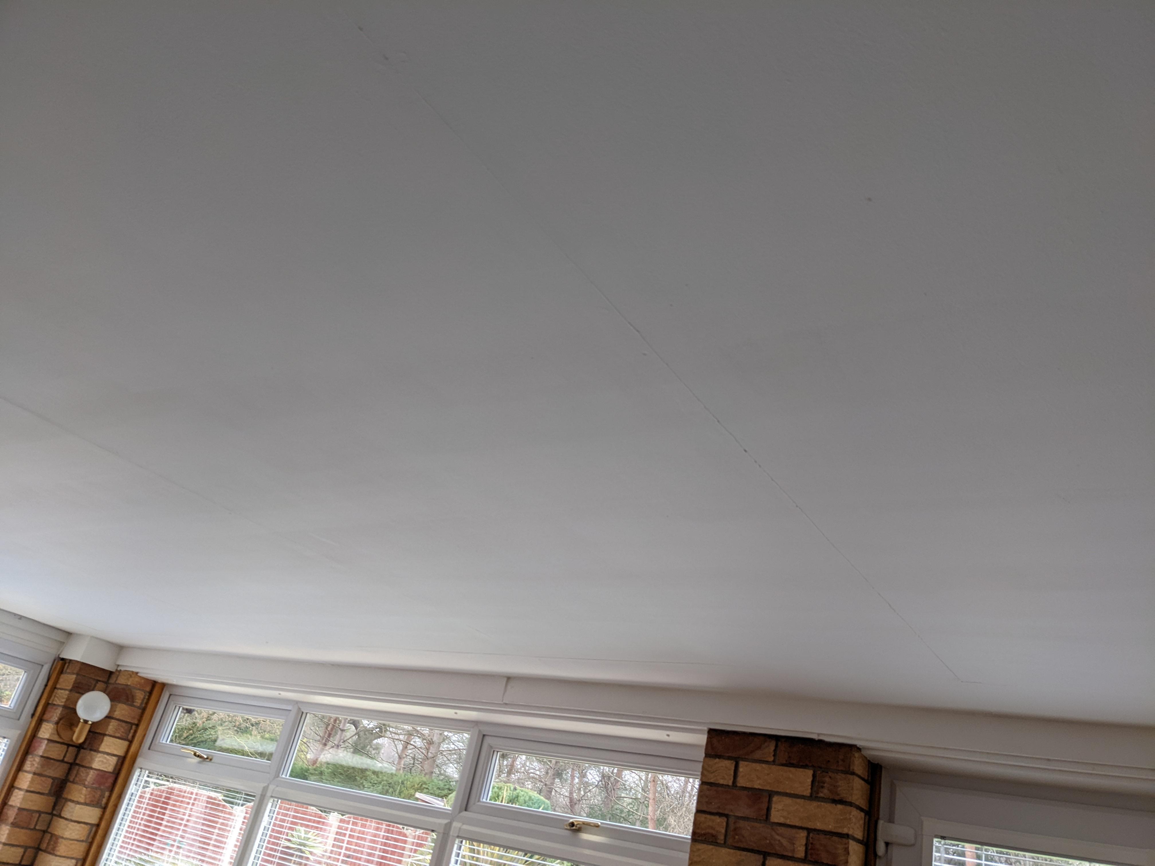

BobAJob Posted January 25, 2022 Author Posted January 25, 2022 Roof inside has cracks between the plasterboards.
