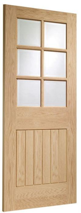

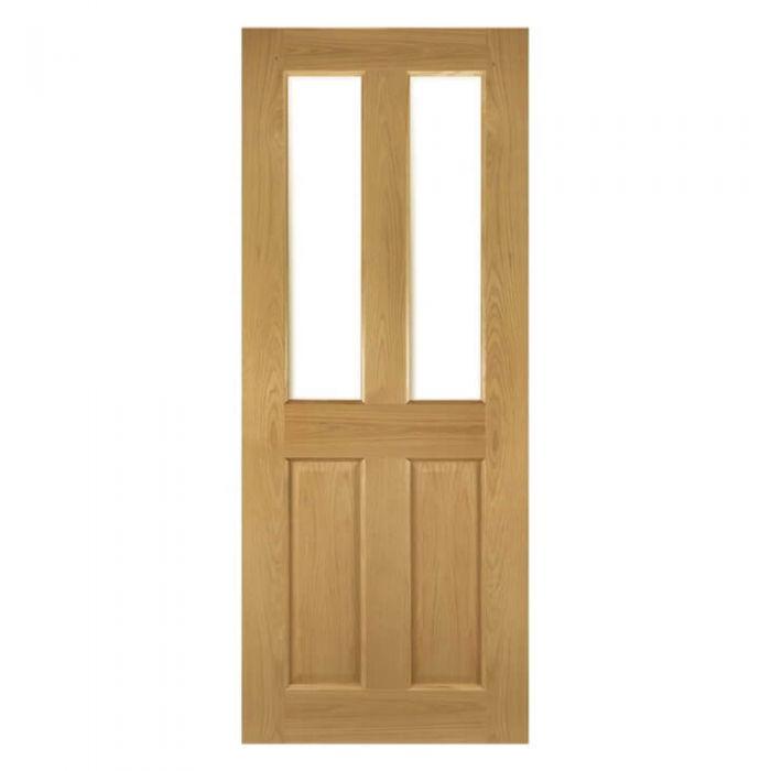

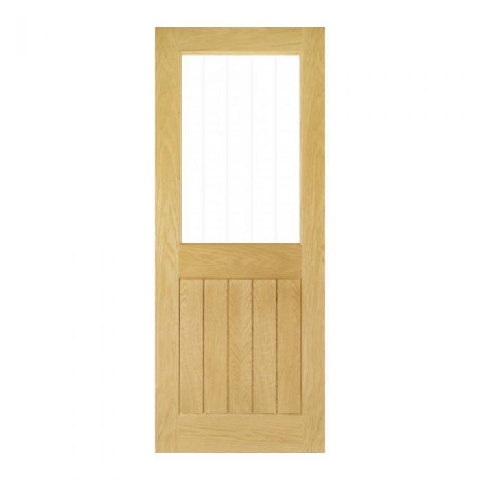

I'm trying to source some traditional looking doors for my build for the ground floor hallway. I was hoping to get a couple of 840mm x 199mm half glazed Downham style doors with frosted glass and I also have to get a 1680mm x 199mm double glazed door from hallway to kitchen.
The problem is that I'd like these to be quite traditional styles which would be no problem if they didn't also have to be fire doors (FD30). I've found the range of residential glazed fire-doors really very  restrictive (not to mention horrendously expensive!)
Can anyone recommend a supplier who has a decent range of traditional designs for glazed FD30 doors?

I got my doors from FSN (https://www.fsndoors.co.uk) not the cheapest but we were particular about the aesthetic so was one place we were not as budget sensitive.
Every door that opens onto the hall in basement, GF, FF and room in roof needed to be FD30. One of these has a large glazed panel (1.6m x .65m) and it was not cheap but entirely do-able.
