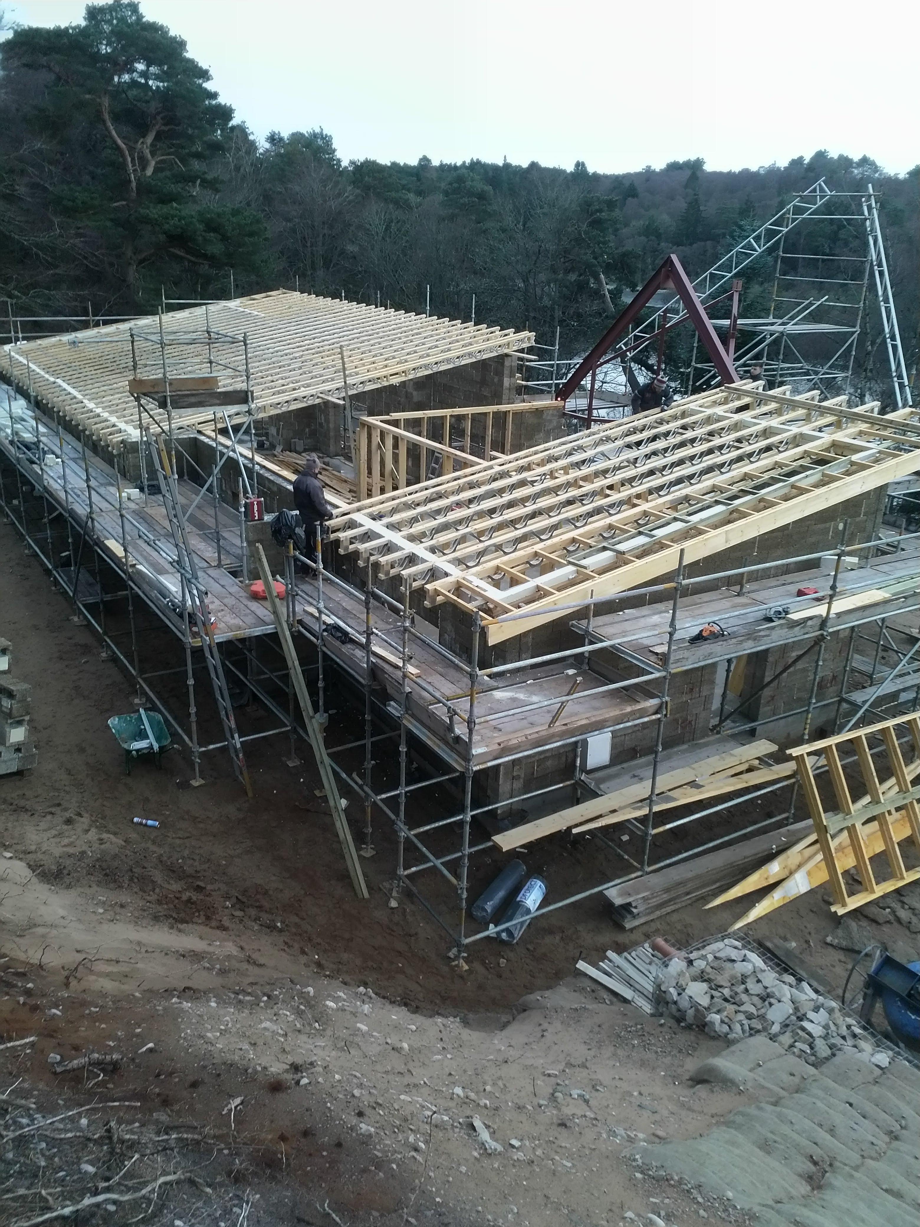

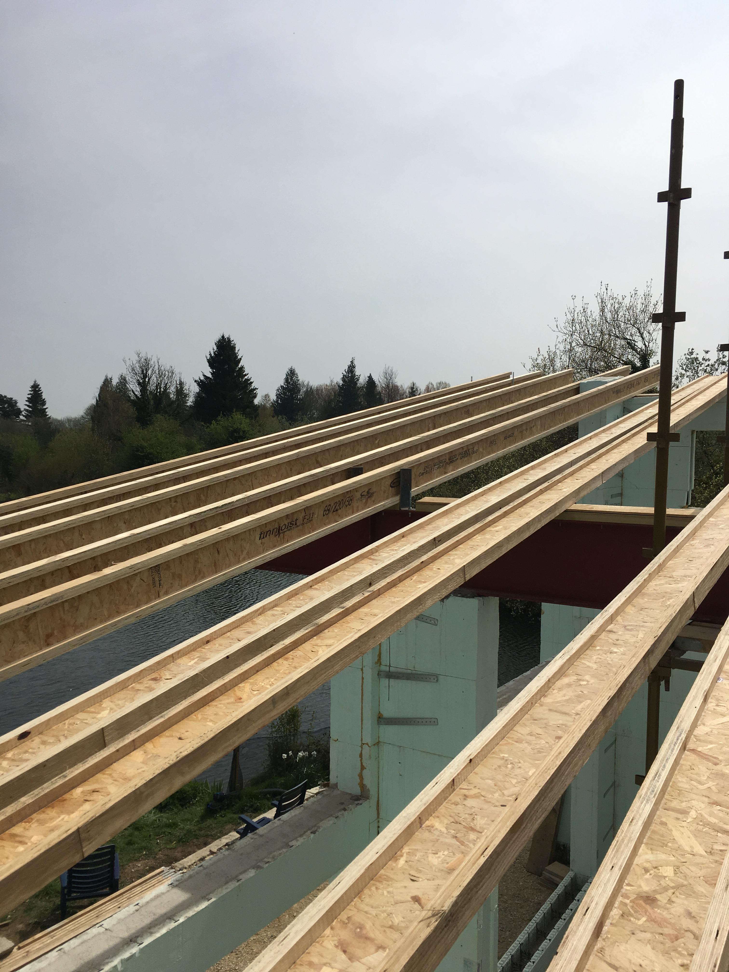

Russell griffiths Posted January 12, 2022 Posted January 12, 2022 i did mine with i joist, there are loads of different ways, maybe put some pictures up. What was the problem with the Nudura build.

Russell griffiths Posted January 12, 2022 Posted January 12, 2022 They come straight, lighter to use, longer lengths, mine were 10.9m with one central support. Do you have a design.

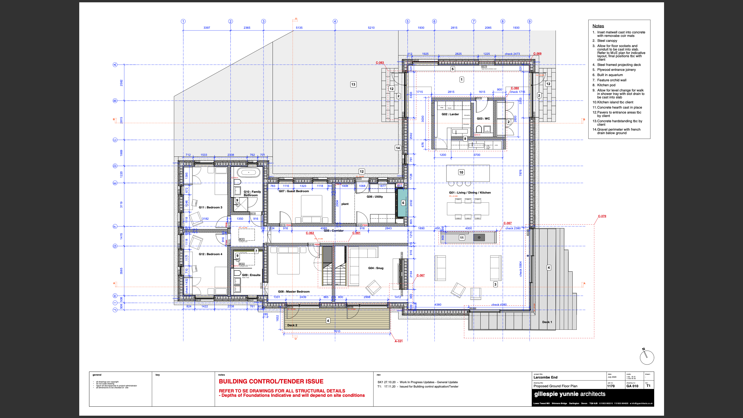

Tom Posted January 13, 2022 Author Posted January 13, 2022 Thanks Russel. The roofs have a maximum span from wall to ridge of 5m, with angles of 14, 22 and 23 degrees for the three different roofs. Floor plans attached to show how they are arranged, the largest and smallest "barns" on the right and left respectively have their ridges running vertically up the page, the middle barn has it running horizontally - hipped where it meets the larger barn, and gable end and valley gutter where it meets the smaller barn. It's all single storey with vaulted ceilings.
