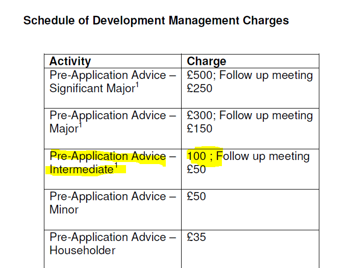

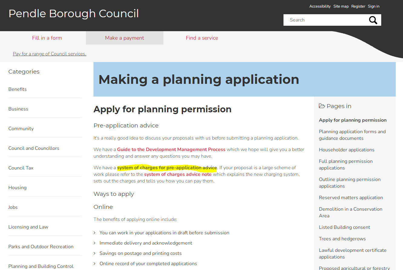

@IanR thank you for the input/feedback. Again its really appreciated. I have taken what you have said on board and as such will resolve the potential issues having "stuff in the lambing shed" may cause to ensure the best possible fall back plan of Class Q.
I believe now i am going to attempt to go down the full planning route and use Class Q as a fallback (if my understanding of the above is correct) it appears to be the best option.
This might sound like a stupid question but can i please ask from the following documents what should i be requesting in order to begin the pre-app ?
Planning Fees
Thank you.
