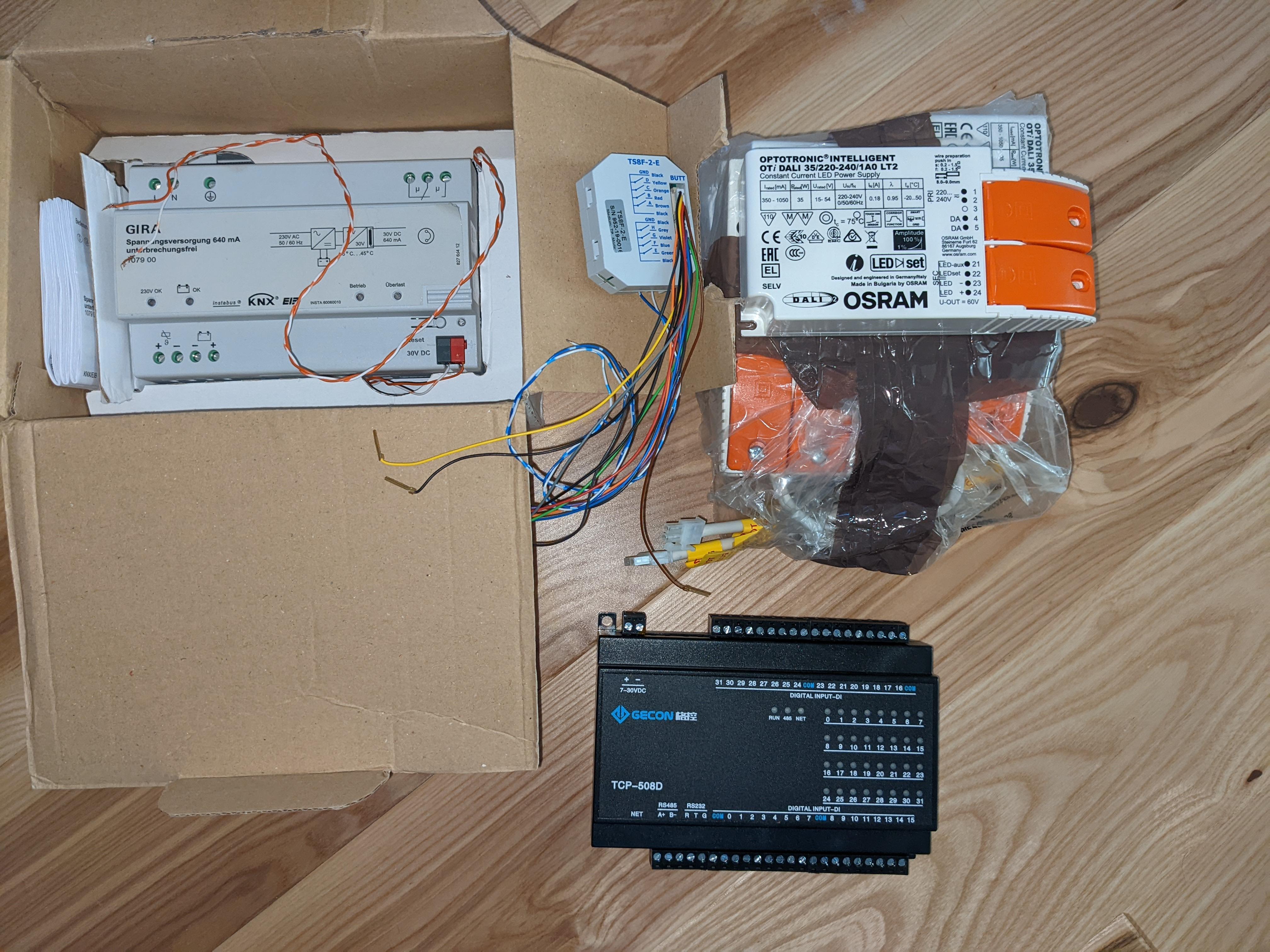

joth Posted January 9, 2022 Posted January 9, 2022 Left over from my build, all using protocols I decided not to go with in the end 1x GIRA KNX bus PSU (2nd hand from ebay) 1x Theben ts8f-2-e 8 way KNX digital input 7x Osram 350-1050mA constant current DALI LED dimmers (2nd hand from ebay) 1x 32 way modbus digital input (aliexpress special) Yours for the cost of P&P (or free free for collection in Herts or N1C London). If you feel compelled, or there's strong competition for any item, donations to buildhub coffers or shelter welcome ? 1

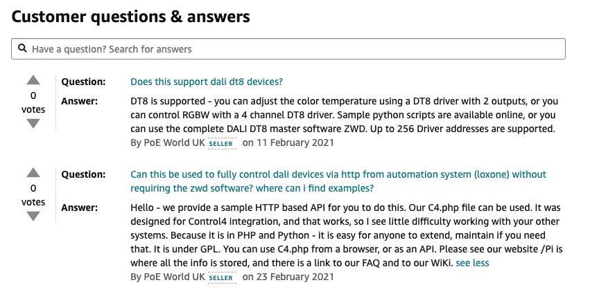

Dan F Posted January 12, 2022 Posted January 12, 2022 (edited) 4 hours ago, joth said: DALi was a tougher call, and often wish I had stuck to original plan and used it. I think the main downside was cost, especially as the Loxone Dali extensions are very limited and expensive. We are using DALI and very happy with the decision so far. Upstairs downlights are all on a one Loxone DALI extension, but by the time I add in low-level lighting, LED's and exterior lighting this would require 2-3 DALI extensions which as @joth rightly points out are expensive at around £450 each. It is only £7 per fitting, but the thing is, you need an address for all fittings (which you then group), whereas centralized dimmers can drive a whole circuit each. It does give you a lot of flexibikity though; for example there is one wall-washer in the breakfast area that shines on TV screen, which I can easily individually switch off depending on the lighting mood (or even if TV is on if I wanted to using smart plug). Before I go out and buy more than Loxone DALI extensions though I have one of these I got off of amazon which I plan to try to use https://www.amazon.co.uk/dp/B081TNRGMN/. This is good for 4 channels (256 devices) and needs a DALI power supply and Raspberry Pi and some minimal coding, but I'm pretty confident it'll work from my initial tests, it's just a simple ReST call out fro Loxone to Rapberry. Tunable white will be slightly more challenging, but no rush to get that working. Edited January 12, 2022 by Dan F 1 1
joth Posted January 12, 2022 Author Posted January 12, 2022 49 minutes ago, Dan F said: Before I go out and buy more than Loxone DALI extensions though I have one of these I got off of amazon which I plan to try to use https://www.amazon.co.uk/dp/B081TNRGMN/. This is good for 4 channels (256 devices) and needs a DALI power supply and Raspberry Pi and some minimal coding, but I'm pretty confident it'll work from my initial tests, it's just a simple ReST call out fro Loxone to Rapberry. Tunable white will be slightly more challenging, but no rush to get that working. Ah yes, looks like someone else on the internet has similar needs to you ?

Dan F Posted January 12, 2022 Posted January 12, 2022 Just now, freshy said: This looks very interesting, do let us know how you get on. It was really quite easy to get working with simple dimming and everything you need code-wise to do it is available online, I just haven't hooked it up to our install yet as we only recently moved and so ground floor lighting is all on a relay for now It was tunable white, which uses the more complex DT8, that needs more coding to get to work and expose via an API from Pi. Expensive as it is, the Loxone DALI extension achas an issue with DT8 anyway, with some devices at least (including the EldoLED drivers we are using for LED's); if a device supports both DT6 and DT8, rthen ather than use DT8 or let you choose, Loxone fails to recognise the device type at all!
