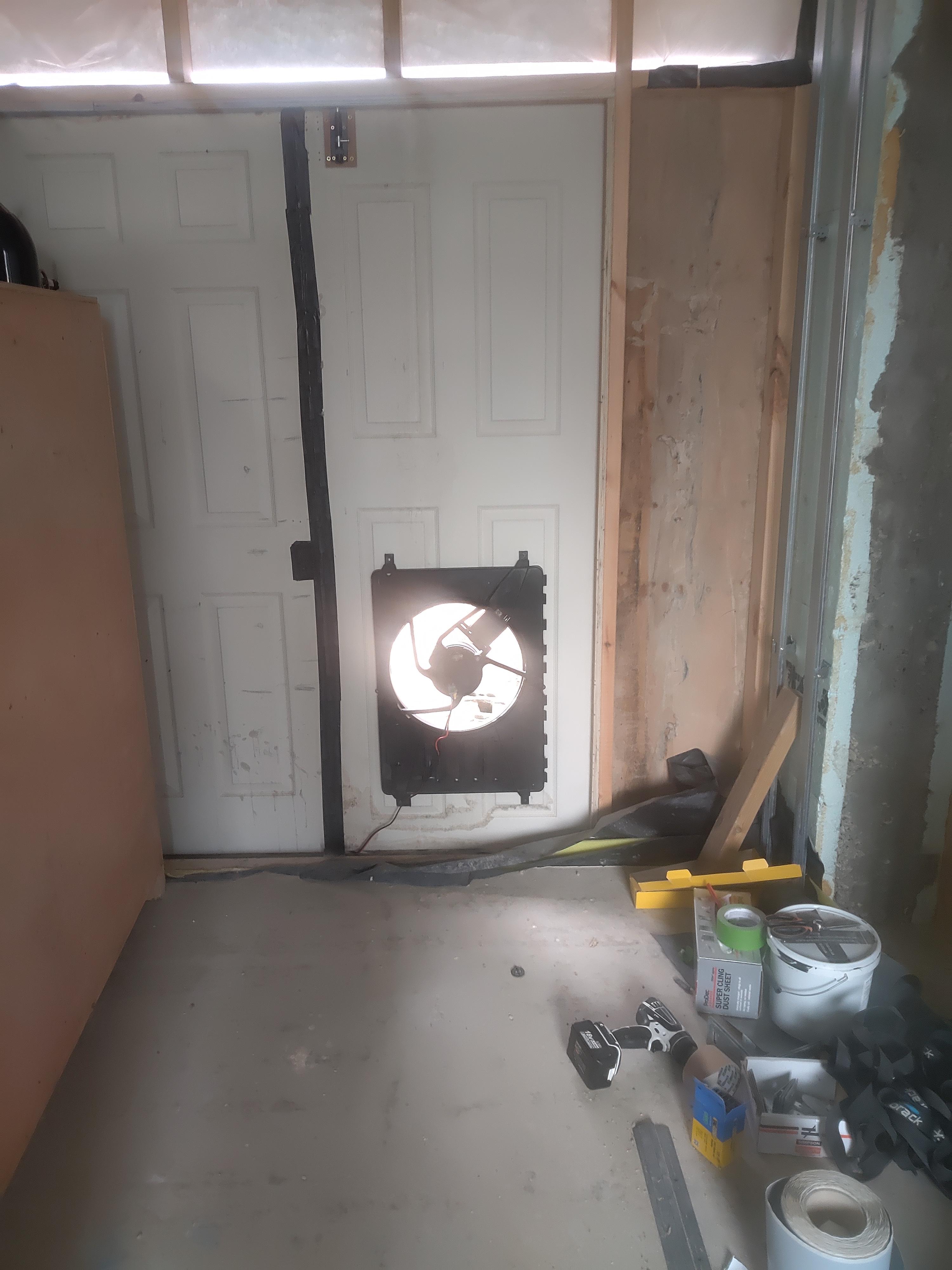

Don't bother getting a professional to do a trial. Rather buy something the car fan below. Bigger is better. Then screw and tape it into one of your sheets of OSB. Get some crocodile clips and wire and attach to your car battery.
They develop a howling gale compared to a proper blowerdoor. It makes it easy to find leaks and you can do so without time pressure. You should be able to just reverse the polarity to change fan direction if needed.
Listen for the biggest leaks.
Lick the back of your hand and feel for the smaller ones.
Use a lighted candle and ram it into a length of conduit or tape it to a broom for a hyper sensitive leak finder.

Another vote for a DIY blower door.  I made mine out of a substantial sheet of cardboard, lots of tape and an old office desk fan as the blower.
You won't get a reading of air tightness but you will be able to go around and find any leaks and deal with them.  Set it up so the blower extracts air so any leaks will be blowing in and be easy to find.

Tadaaa worked very well. Just used jump leads and an old but of cable with a couple of spades on the end. Found some small leaks and very helpfully found one of our huge sliding doors was ok at the bottom but not the top along the closing edge so the door may not be fitted straight. So worthwhile.

The car fan is really effective at de-pressurising the house so the fact that we had some known issues  eg ply in doorways didn't really matter as for sure there was air coming in from there but with the fan strength you can still detect other air leaks. Did cover WC waste pipes and obvious holes but we didn't spend too much time on that. Construction is ICF so we focussed on the risk areas of window/sliding doors and roof to wall junctions. Holding a burning stick we watched the smoke - if the smoke was disturbed then we looked for the source and taped it. Takes a while to move slowly around all areas but 2 people 4 hours and pretty thoroughly done. Some areas will need a bit more time to fix and will deal with them next week - the window installers put tape in all required placed but in a few areas they taped onto dusty blocks which is useless of course so we'll remove, prime and re-tape. The roof junction seemed OK - maybe some small air leaks so will see how best to deal with that - probably some plastic fixed with a batten along the wall in ceiling void and then a batten pinning this onto a joist.
