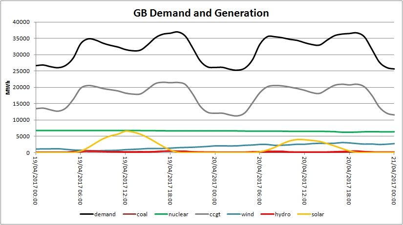

SteamyTea Posted April 22, 2017 Share Posted April 22, 2017 Heard this on the news on way home from work last night: http://www.bbc.co.uk/news/business-39668889 I have made a chart of the domestic fuel mix from GridWatch (http://www.gridwatch.templar.co.uk/download.php) I tripped out the interconnects, Oil generation, OCG, Pumped and Other, as they were either so tiny or not really relevant to domestic generation (who knows what the Dutch are really burning). Easy enough to look those figures up if you want to as they are part of the download. Now the really interesting thing is the solar production. It can now peak at nuclear levels, though the yield over a day is a lot lower. Due to the high pressure over the UK at the moment we have had pretty clear skies, and wind production is down. Gas still makes up the lion's share of our generation, not ideal environmentally and politically, but so much better than coal. What did occur to me is that if we can continue down this low carbon route, and there is no reason why we cannot do so for the next decade (there are technical limitations eventually), we may need to rethink our house building from an emissions viewpoint (that DER, TER stuff). There is still a good argument to reduce usage because of cost (Gas is about £40/MWh, Nuclear about £95/MWh, Solar and Wind about £150/MWh), but it shows that with a serious reduction in usage the price need not be prohibitive (maybe a 25% rise in overall electricity costs, I would need to look at figures a bit more on that to get a truer picture). Now the 'Spot the Coal line' chart. 3 Link to comment Share on other sites More sharing options...
MikeSharp01 Posted April 22, 2017 Share Posted April 22, 2017 Very interesting @SteamyTea Wonder how the solar figure is derived, IE is it just the grid connected large farms or does it include exported domestic, where this is implemented. Also if it does not include small domestic installations then the figure must be distorted because demand will be depressed by people using their own solar and not then drawing off the grid. One thing is clear - what we need is a set of highly focused tracking mirrors out in space to keep the solar farms, and just the farms, illuminated for much longer, perhaps 24/7 in cloudless times. Wonder what the unintended consequences of such a system would be! Link to comment Share on other sites More sharing options...

SteamyTea Posted April 22, 2017 Author Share Posted April 22, 2017 I think it is from large solar installations, domestic just shows a drop in other generation, but hard to get a clear picture. But as we know the amount of small and large scale installed, we could take a stab at working out what is happening on the domestic side. The main consequences of a space mirror is someone like Trump. Thankfully it is not really a viable idea. Link to comment Share on other sites More sharing options...

SteamyTea Posted April 22, 2017 Author Share Posted April 22, 2017 (edited) Had a quick look at the DECC PV figures and using the criteria of below 50 kWp is not metered i.e. domestic and over is metered, then we have 903,513 MWp as domestic and 4,084 MWp commercial. So if that commercial generated 48,788 MWh on the 19th April 2017, 12 MWh per 1 MWp installed, that seems a bit high to me Domestic would be 11,000 MWh. I may have misread the units of the DECC spreadsheet (https://www.gov.uk/government/uploads/system/uploads/attachment_data/file/603803/Solar_photovoltaics_deployment_March_2017.xlsx) But I am in a hurry to get to the food festival. Others can look at it and put me right. There is a bit in the spreadsheet about where the money comes from i.e. FiT or CfD, that may help clarify it. Edit: Just relaised those calculations above a nonsense, so shall try and have a better look later if no one else does. Edited April 22, 2017 by SteamyTea Link to comment Share on other sites More sharing options...

TerryE Posted April 22, 2017 Share Posted April 22, 2017 2 hours ago, SteamyTea said: I think it is from large solar installations, domestic just shows a drop in other generation, but hard to get a clear picture. I was reading one analysis of this and the commentator said that the generators have no accurate means of collecting stats on solar or wind input so the reported "demand" is just the sum of the major non-renewable sources that they get realtime data on: gas, nuclear, coal, hydro. You can see this because the individual component curves simply don't add up to the demand; and the demand paralles the largest variable on-demand supply: ccgt (gas and pellets). What the midday solar peak does is to drop the otherwise midday peak below the early evening peak. Link to comment Share on other sites More sharing options...

DavidFrancis Posted April 22, 2017 Share Posted April 22, 2017 The Gridwatch figures on solar come from Sheffield Uni. This page gives their last update on capacity: https://www.solar.sheffield.ac.uk/news/capacity-update-plus-23k-new-sample-sites/ Link to comment Share on other sites More sharing options...

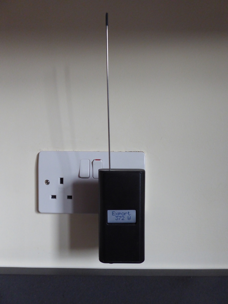

Jeremy Harris Posted April 22, 2017 Share Posted April 22, 2017 Interestingly, I've found that having an energy display that shows whether we're importing or exporting, and by how much, is all that's really needed to change behaviour a fair bit. Mine's a very simple home-made affair: but is plenty good enough to give as much info as you need. I tend to use it at the moment to decide when to charge the car (I could make this automatic, and probably will one day), but equally it's a good enough indicator as to whether to turn on the washing machine, etc. There's no real need for anything more complex, I think. If it were more complex then the chances are it would be more confusing for some. 1 Link to comment Share on other sites More sharing options...
