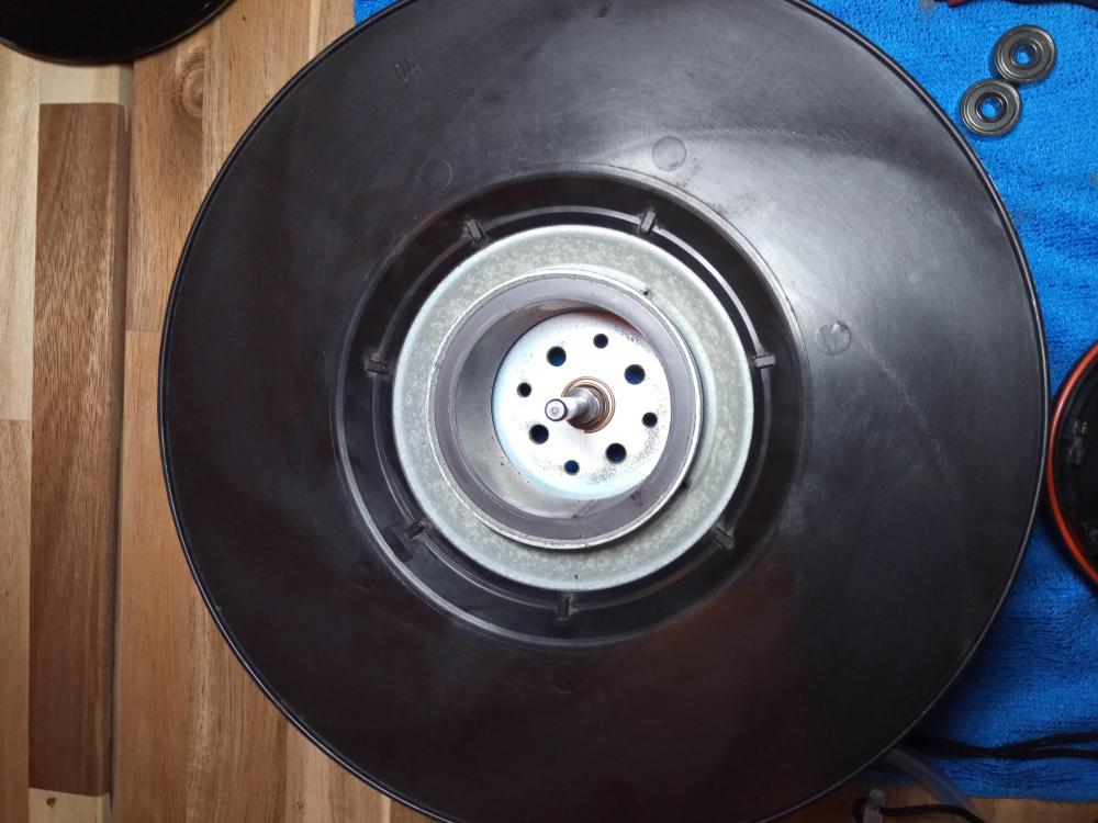

Following on from the excellent post by @DOIGAN where he replaced the bearings in one of the fans from his MVHR, this is a short post to detail the steps to replace the bearings in the extract fan in my Vent Axia Sentinel Kinetic Plus B (being a slightly different model and fan to that of the link below)
The process I followed is basically the same as laid out by @DOIGAN in his original post. I've added a couple more pictures and descriptions below.

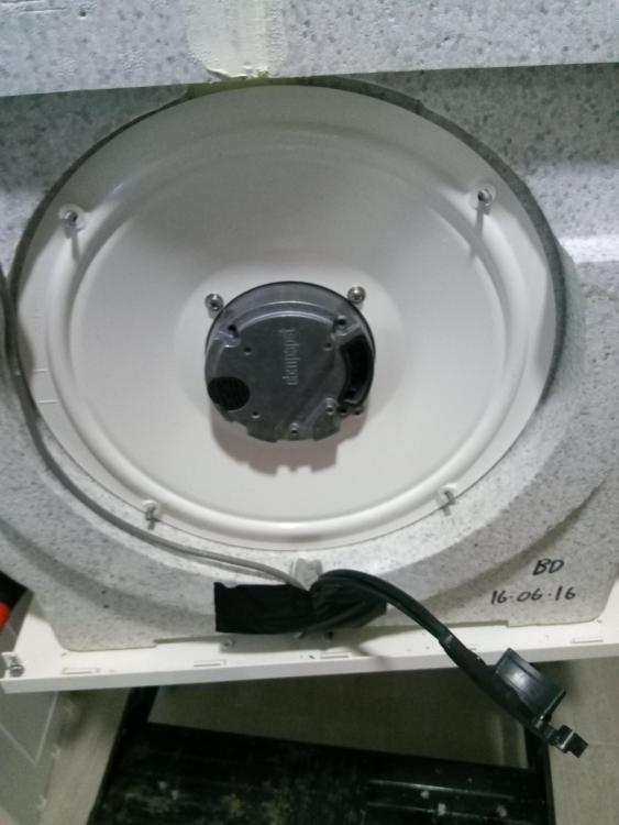

To get at the fans, the unit has to be stripped down.  First the duct spigots and blanking plates are removed.  Both the back and front covers are then removed, allowing the top and side panels to be taken off - the side panels slide/interlock with the top and bottom panels.  You should then have access to the fans on either side which are bolted to the poly core:
I then disconnected the power connector to avoid having to try and unplug from the motherboard / cause any other issues.
From this point I followed the process as per @DOIGAN
Removing the circlip was a bit challenging, as for some reason the hub assembly would not depress, it turns out because the spring beneath wasn't seated properly.  I managed to get the circlip off, but naturally it pinged up into the air and I spent several minutes searching for it until finally finding it some distance away.  The bearings themselves (one on either end of the hub) popped out easily.
I used the same bearings as @DOIGAN
Reassembled and back into the MVHR unit.
Cost - my time and £7.99 for a pack of 10 bearings vs £298.43 + VAT + shipping charge for a replacement fan from Vent Axia.  Vent Axia were unable to give me any detail of the bearings used when I emailed to ask.

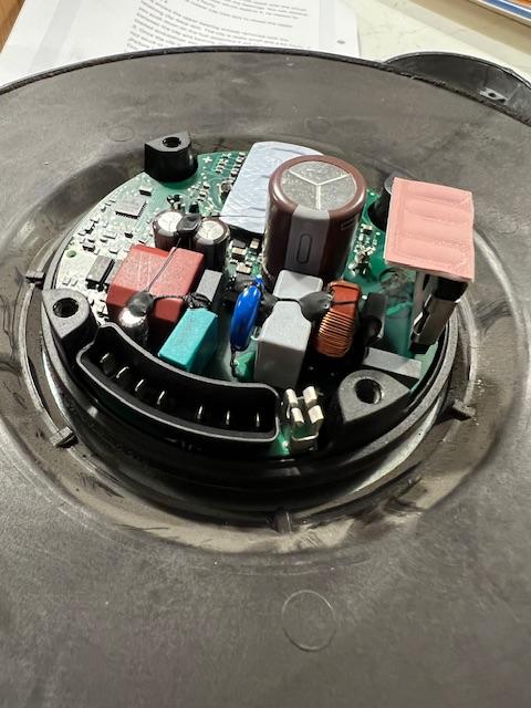

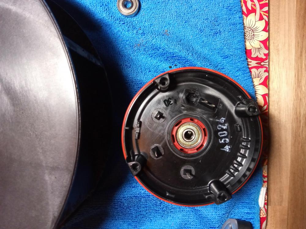

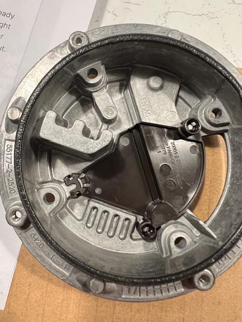

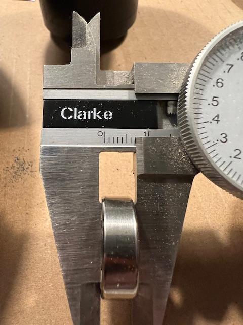

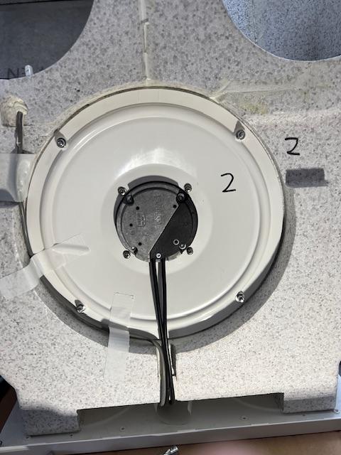

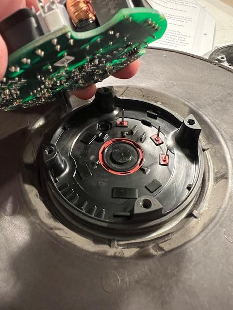

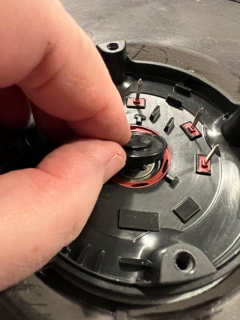

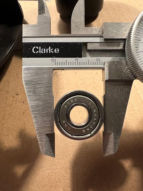

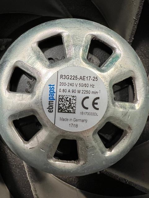

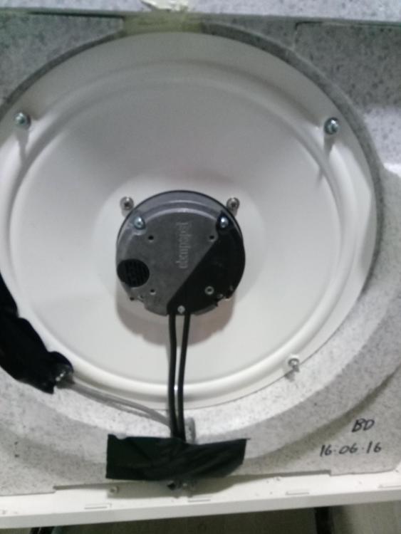

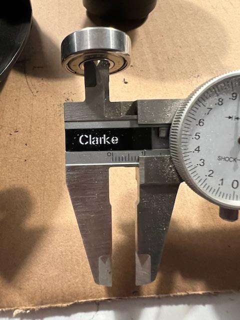

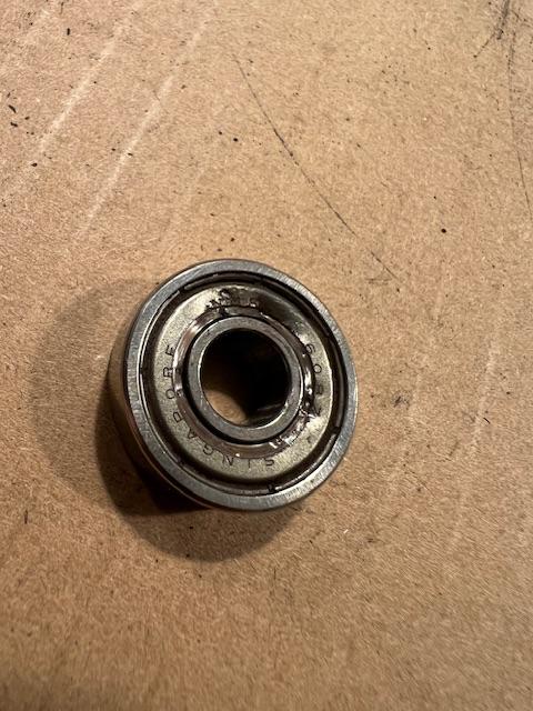

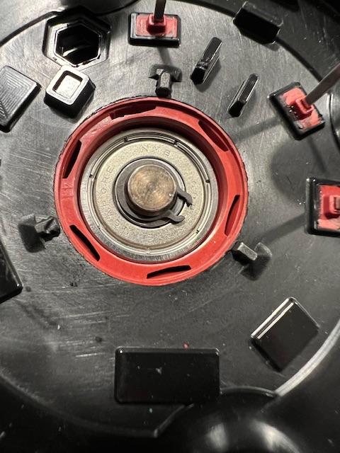

Many thanks to those who’ve contributed to this thread. I’ve just replaced the bearings in my Vent Axia Kinetic MHVR following the directions above. Unit is 6 years old and had become more noisy with some louder squeaking which sounded like a bearing being tortured. I encountered two issues: when disconnecting the motor cover the circuit board was left on the motor - there are a number of pins connecting it to the motor holding it in place, though was fairly easy to lift off and carefully put to one side. The second was that the bearings were a different size than those above! I’ve shown the motor number and bearing measurements from my unit, so a bit of a setback though quick enough to come from Bearing King - I ordered some high efficiency SKF bearings, more expensive though still only £24 for four.
Enclosed are some photos of the process - including one of the poor old bearing that had clearly failed (one of the motors was much less free spinning than the other). While I had the unit off the wall, we took the opportunity to clean the vent pipes using a pull tape and home made microfibre “sweep” - photo included for those interested.IMG_3301.jpeg.f4a2aea96e95477c0e0a9ddde1a74e8f.jpegIMG_3303.jpeg.163104f6c192841006950811c6991e8f.jpegIMG_3305.jpeg.819de4241d10c537288c5e5084934c4a.jpegIMG_3306.jpeg.6e0e226e2ad8cd0f3ec5cb18f7dd9895.jpegIMG_3307.jpeg.9933032969dfb3231bdc11ccd9a4cc73.jpegIMG_3308.jpeg.4df4659250cd797fd8a0f0f32b7c4e04.jpegIMG_3309.jpeg.68bc79b00d211f774e7a3ad468a89d01.jpegIMG_3313.jpeg.3436486c638286640a56f21919ba326d.jpegIMG_3314.jpeg.b1448aadcf8bab3a18cb2cb0099493b7.jpegIMG_3322.jpeg.1b673df401c346da0ac103315b98eef6.jpegIMG_3321.jpeg.4778df7bfb54e1660078ad2ff6ea86e9.jpegIMG_1605.jpeg.dbca085e36c7a28b3e216f90eef10302.jpegIMG_3270.jpeg.7f8f59d9c5051690801118bc295ce48d.jpegIMG_3271.jpeg.93d5b37f839a48e937840e2c82028c9b.jpegIMG_3272.jpeg.a8d3bc09a524566c150600112d24e45d.jpegIMG_3274.jpeg.b78035b9ae48c11f36ff9e308efdd80b.jpeg
