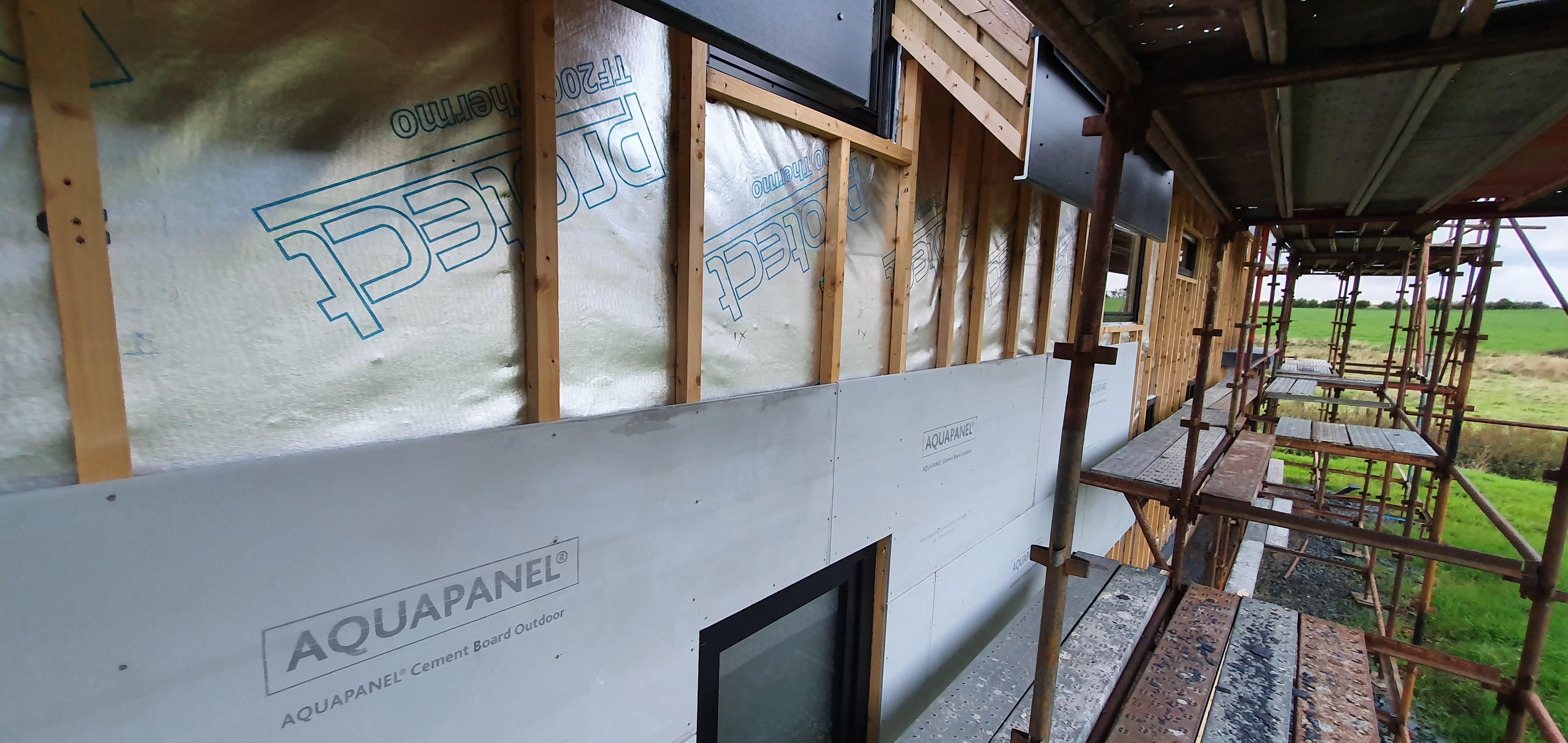

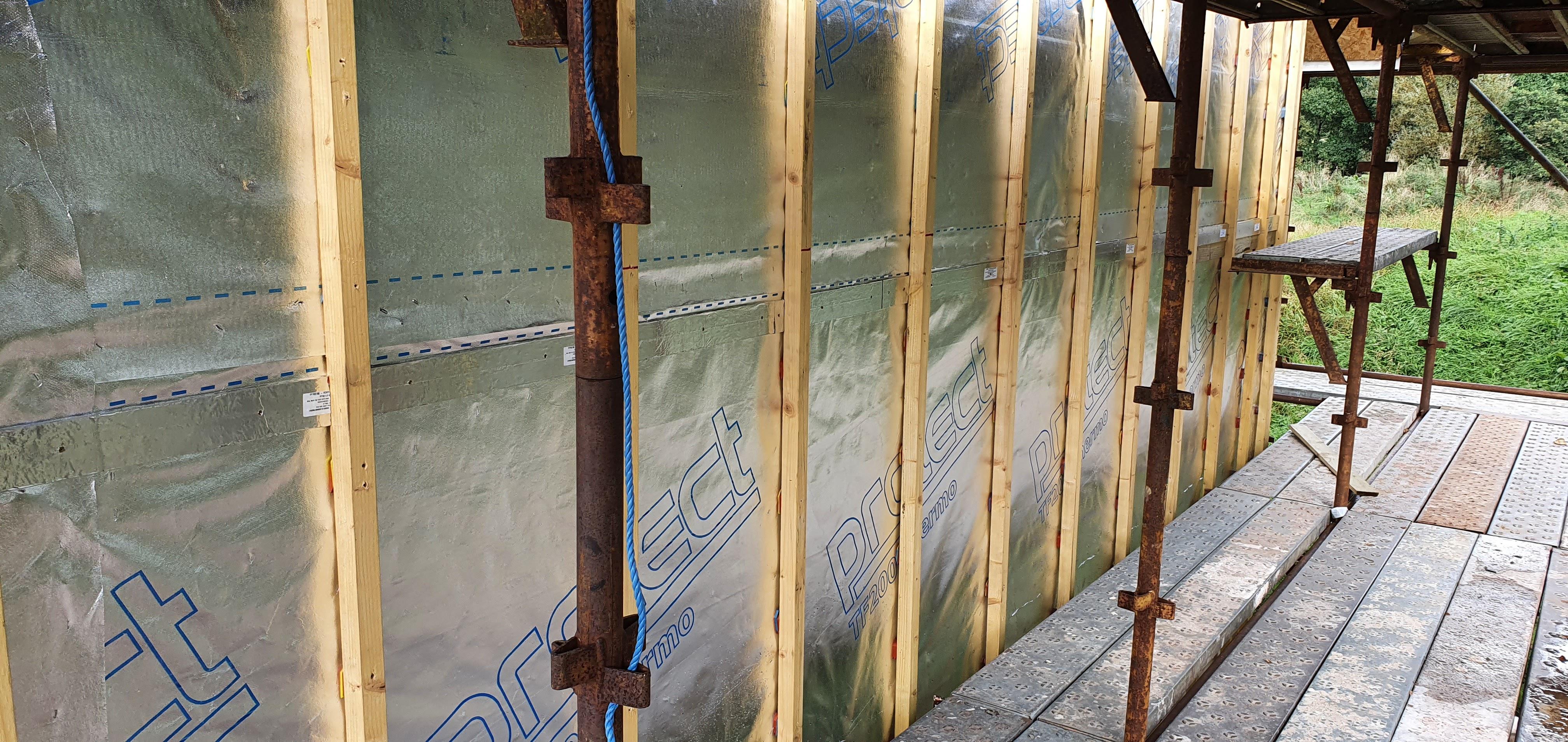

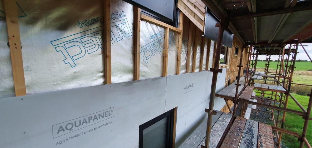

SuperJohnG Posted December 19, 2021 Share Posted December 19, 2021 I've literally just done this. SIPS kit with knauf aquapanel (200m2) mounted on battens main part of the house with a 80m2 leg that is getting clad in fibre cement (was origonaly siberian larch but changed mind). All mounted on battens with a ventilation gap. £2500 is a lot. I used battens at corners as normal firestops, and normal firestops around windows the same. You just ventilate around windows cutting battens back to get airflow. You will need special Intumescent fire barriers which are not the normal red type from tenmat. They do a specialist one that comes in 1m sections and is 3 times the price, but it is the right one and goes horizontally. So in short 1 - agree 2 - bang on. 3 - use t &g or flip to fibre cement and then you only need them top and bottom. Cedral sell them at a reasonable price in the solid versions, avoid the mesh rolls. I found it a PITA in most areas. Do you have an insulated foundation? I'm also Scotland so everything I have done will work for you. Link to comment Share on other sites More sharing options...

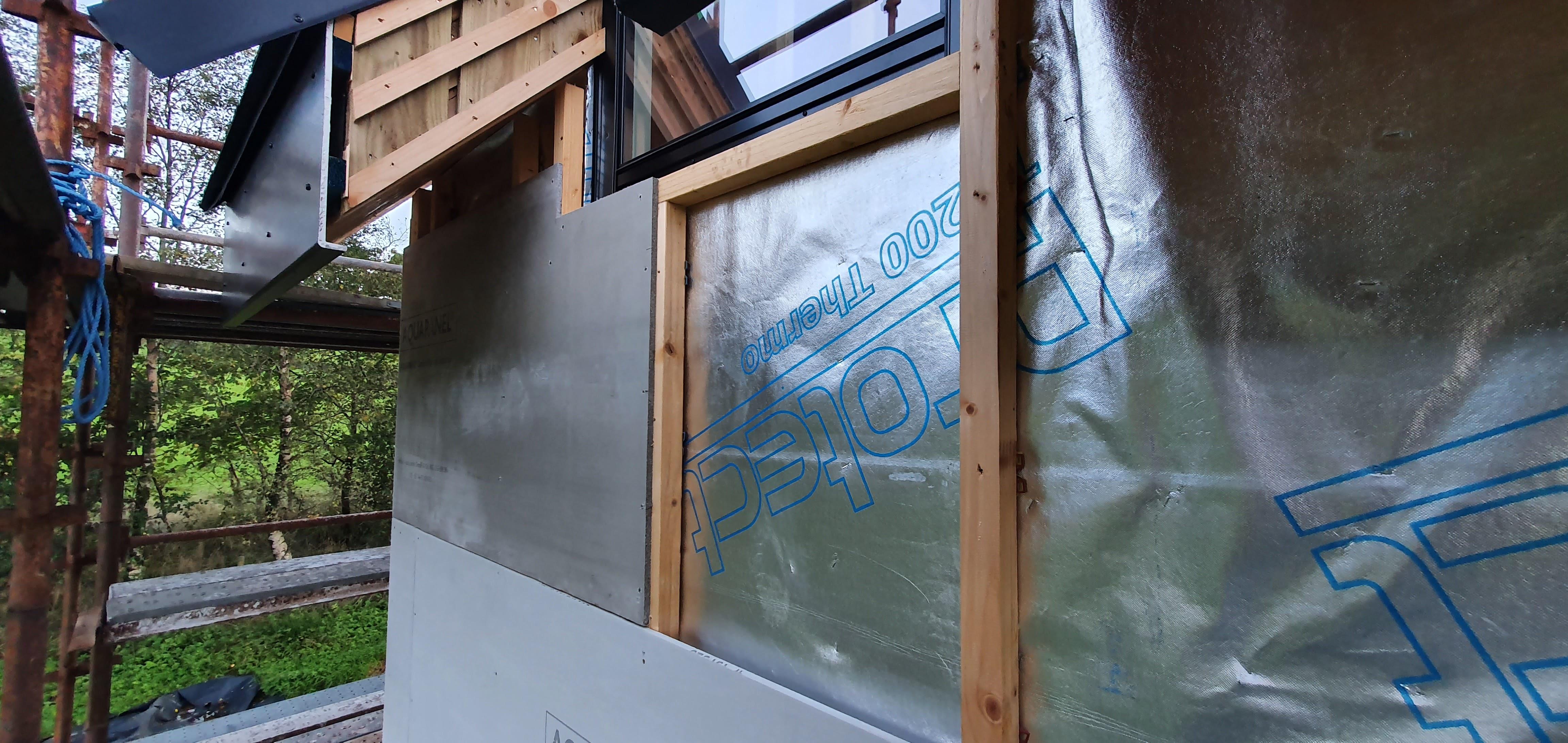

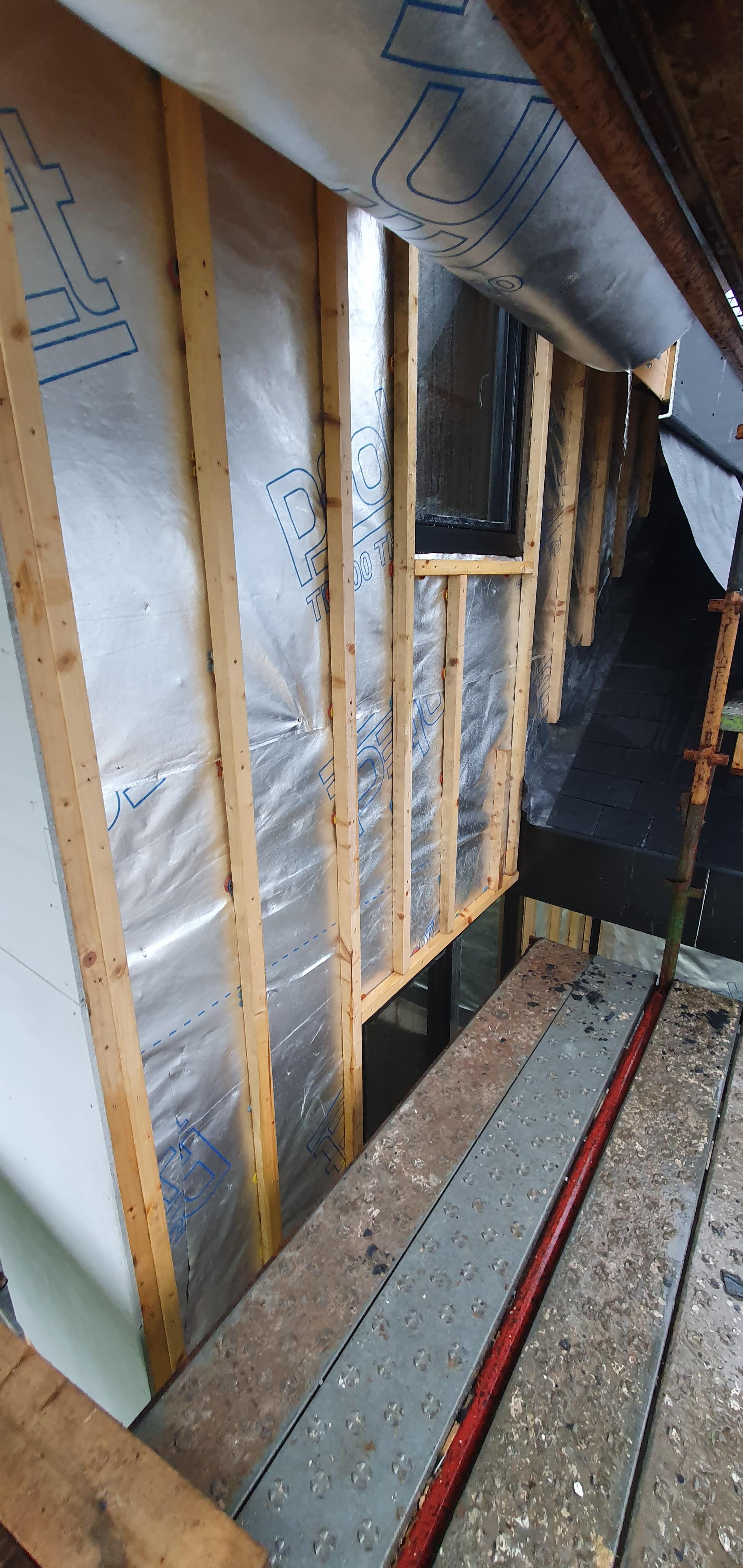

SuperJohnG Posted December 20, 2021 Share Posted December 20, 2021 I spent considerable amounts of time trying to rationalise the rules as both the handbook and the images in it are not very clear. I'd visited others and found they had cavity barriers actually at the base of the cladding, between floors and also at the top of the ventilated gap- which seemed insane. In agreement with my BCO I have one single strip around my main house between ground and first floor, which would stop a fire in the ground floor reaching upstairs through the cavity theoretically but should also be stopped by the window firestops from coming in the cavity. I didnt need at the bottom as it's a slab and the didn't need at the top as it's a SIPS kit and I have fully vaulted ceilings so no loft space. I did add it at a point where I added loft space over the kids rooms as technically it's a new compartment. I didnt add anywhere the top of the cavity I don't need it as I dont have standard eaves where it could get into that loft space as its a SIPS overhang and solid. I didnt add anywhere around on my single story vaulted space as its double height but the same space so no compartment to transfer into. Of course all around the house horizontal travel is stopped by battens and where the battery wasn't straight I used Firefoam to fill gaps. I mounted the intumescent barrier straight on the kit where the void was small enough, but some areas the void was above 44mm and that was its rated width so I mounted on 22mm sarking to close the gap to within tolerance but maintaining the ventilation gap. some pics to help. You have to look close to see the barrier as it's silver. It's not in some pics, just battens. 1 1 Link to comment Share on other sites More sharing options...

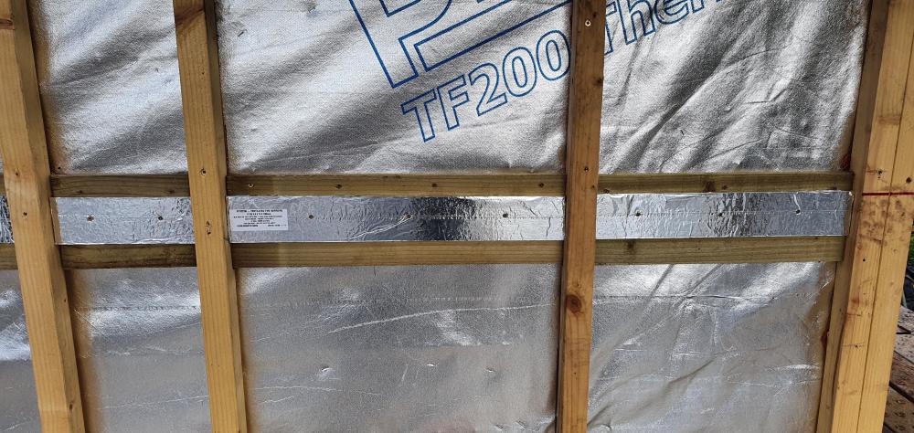

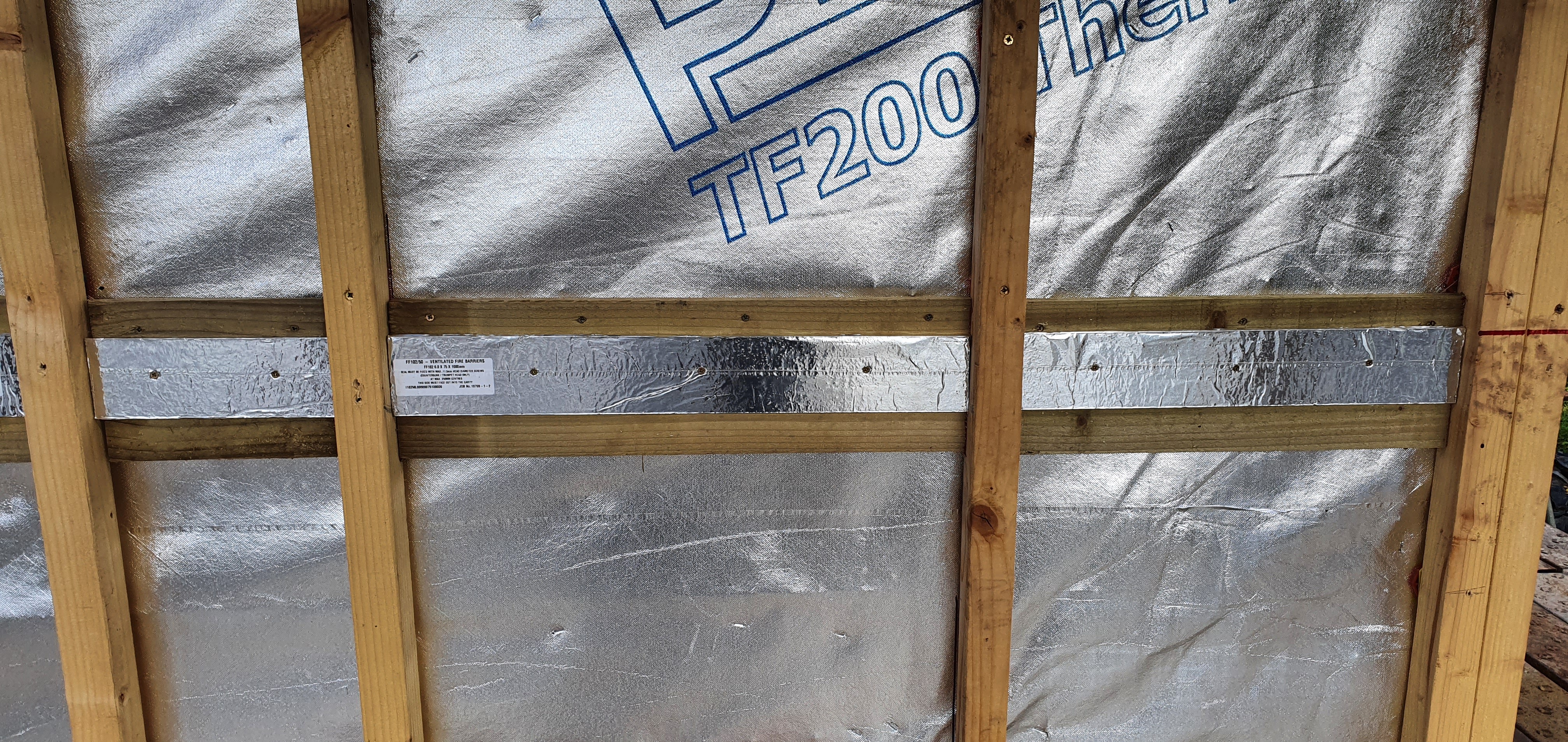

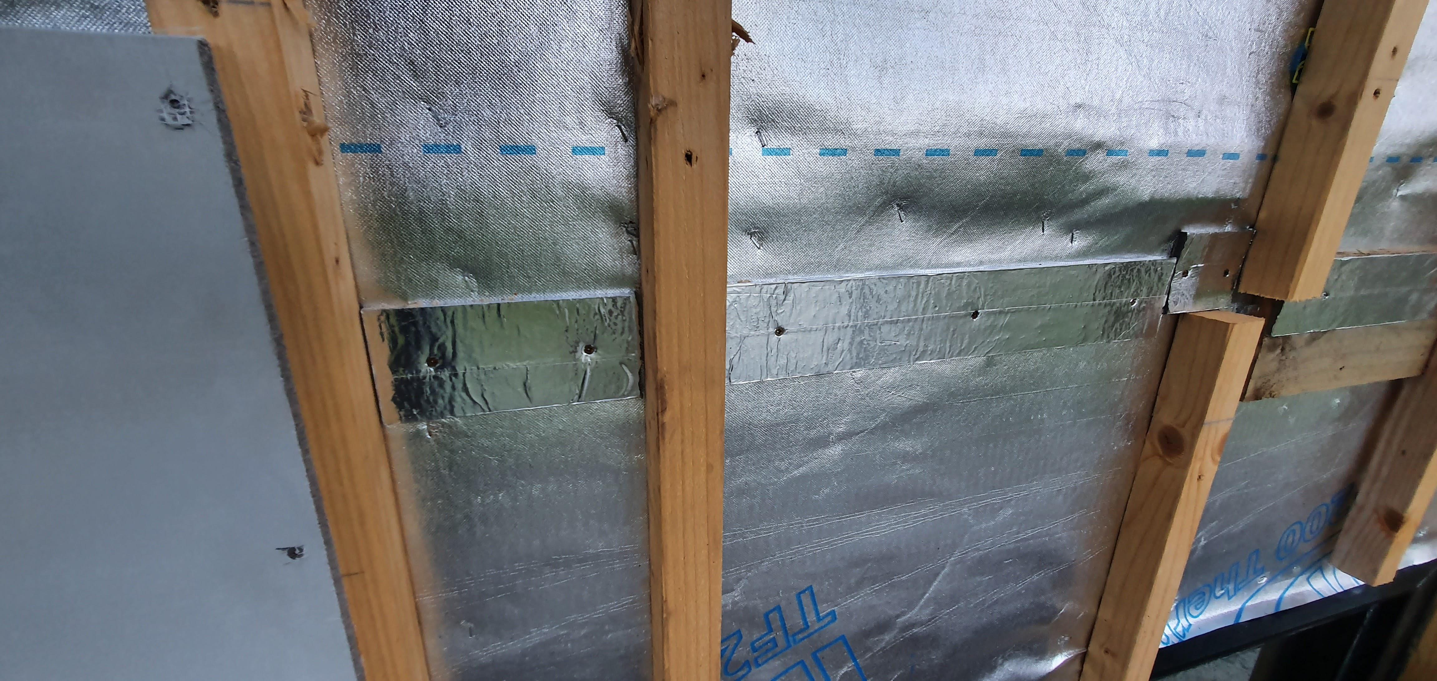

eandg Posted March 4, 2023 Share Posted March 4, 2023 Currently wrestling with detailing cavity barriers for (vertical) timber cladding. Am I right that vertically (at corners) a 2*2 is fine, horizontally (between floors) it should be some form of intumescant strips (i.e. given the cavity barriers I've erroneously bought will block ventilation event if I could fit battens around) and around windows it should be? Link to comment Share on other sites More sharing options...
SuperJohnG Posted March 4, 2023 Share Posted March 4, 2023 (edited) Yes if you have a ventilated cavity you need to buy the correct intumescent straps. Sig (in eurocentral) sell them, they ate tenmat and expensive- but they are the right thing. Firestops in the form of wood around windows is fine. Ensure you cut the battens above the windows short so the air can get it. Edited March 4, 2023 by SuperJohnG Adding images Link to comment Share on other sites More sharing options...
