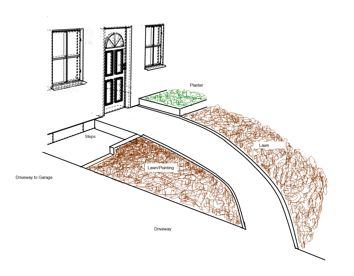

Russell griffiths Posted December 17, 2021 Share Posted December 17, 2021 Morning peeps, can anybody point me at a drawing showing dimensions of disabled ramp to a door for a new build. Interested in size of flat area outside door and also ramp slope angle. Ta very much. Link to comment Share on other sites More sharing options...

Temp Posted December 17, 2021 Share Posted December 17, 2021 One trick is to have a long winding path/ramp upto the front door with a step off the side for able bodies to take a short cut. Looks a lot less industrial than a short ramp. Link to comment Share on other sites More sharing options...

Temp Posted December 19, 2021 Share Posted December 19, 2021 This is the sort of thing that can look good. Effectively an area of the garden is raised to hide the ramp.. Link to comment Share on other sites More sharing options...
Temp Posted December 19, 2021 Share Posted December 19, 2021 (edited) 5 hours ago, Russell griffiths said: Anybody else got anything, help this bloke out. The detailed dimensions depend on if it has to be a Category 1 "visitable house" or Category 2 "Accessible and adaptable dwelling". Think that depends on your planning permission . Cat 1 is less onerous than Cat 2. I think the following meet most of Category 2. Minimum clear opening width 850mm so likely to be an 900mm wide door minimum. (775mm and 800mm door for cat 1). A flat square 1500 x 1500 outside the door (1200 x 1200 cat 1). A ramp/path 1200mm wide. Slope depends on the height but they suggest between 1:12 and 1:20. If you keep it below 1:20 you can go up 500mm in one go over 10m . Steeper ramps like 1:12 is limited to 166mm over 2m before you need "resting places". There is a chart in Part M page 12. If any of that not possible then you have to look at the details of Approved Doc Part M. Edited December 19, 2021 by Temp Link to comment Share on other sites More sharing options...
