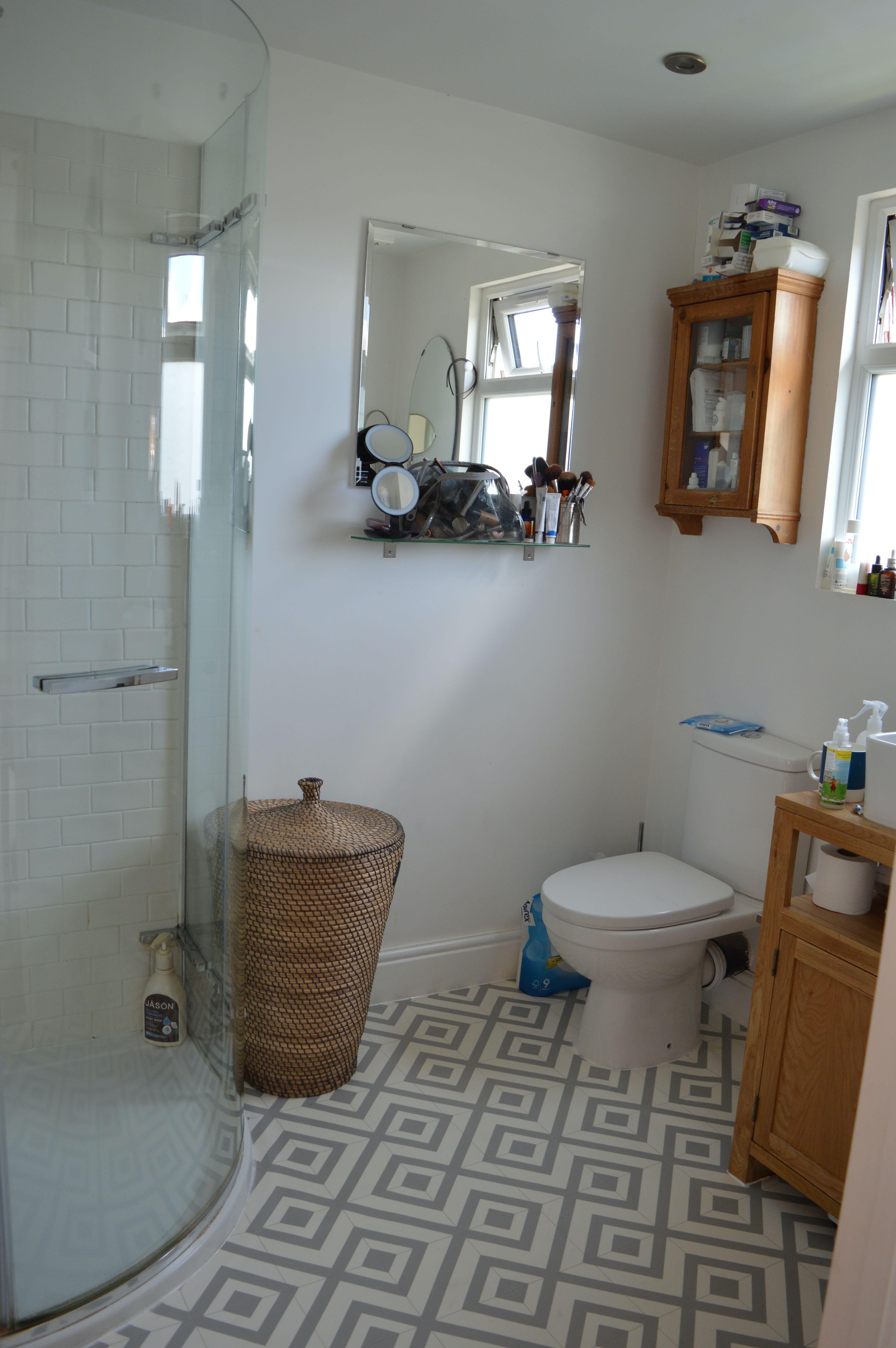

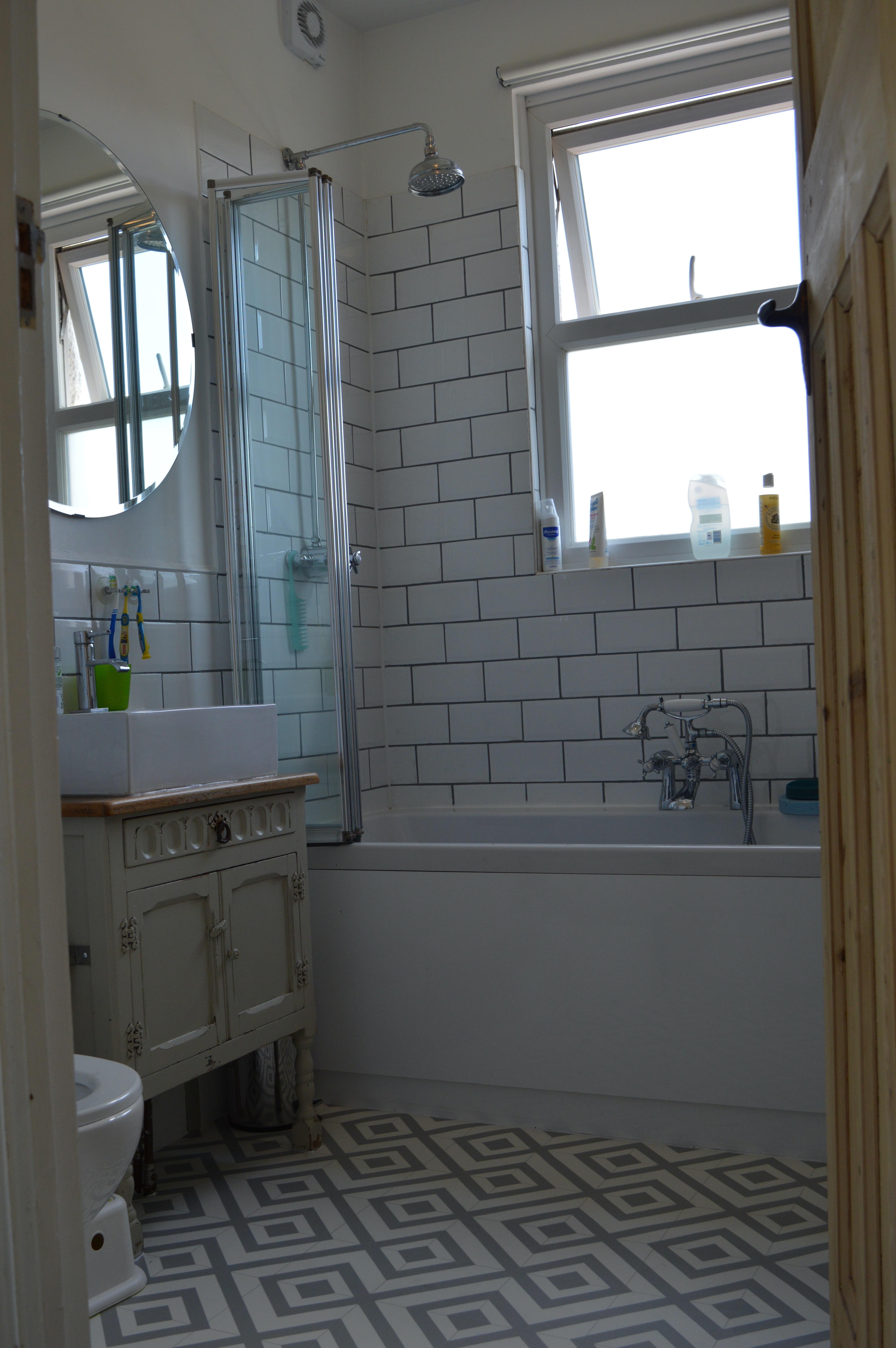

Rachieble Posted December 17, 2021 Author Posted December 17, 2021 No ceiling above the shower in the loft conversion. The room only has about a 2m high ceiling height and the shower head is pretty much right up at the ceiling already. Might be able to manage a cold water tank above the main bathroom shower, though the extractor is there already and the other wall has a window. But wouldn't that just look hideous? Its a pretty tiny bathroom - only 1.7mx2m so not much room for extra bits and bobs.

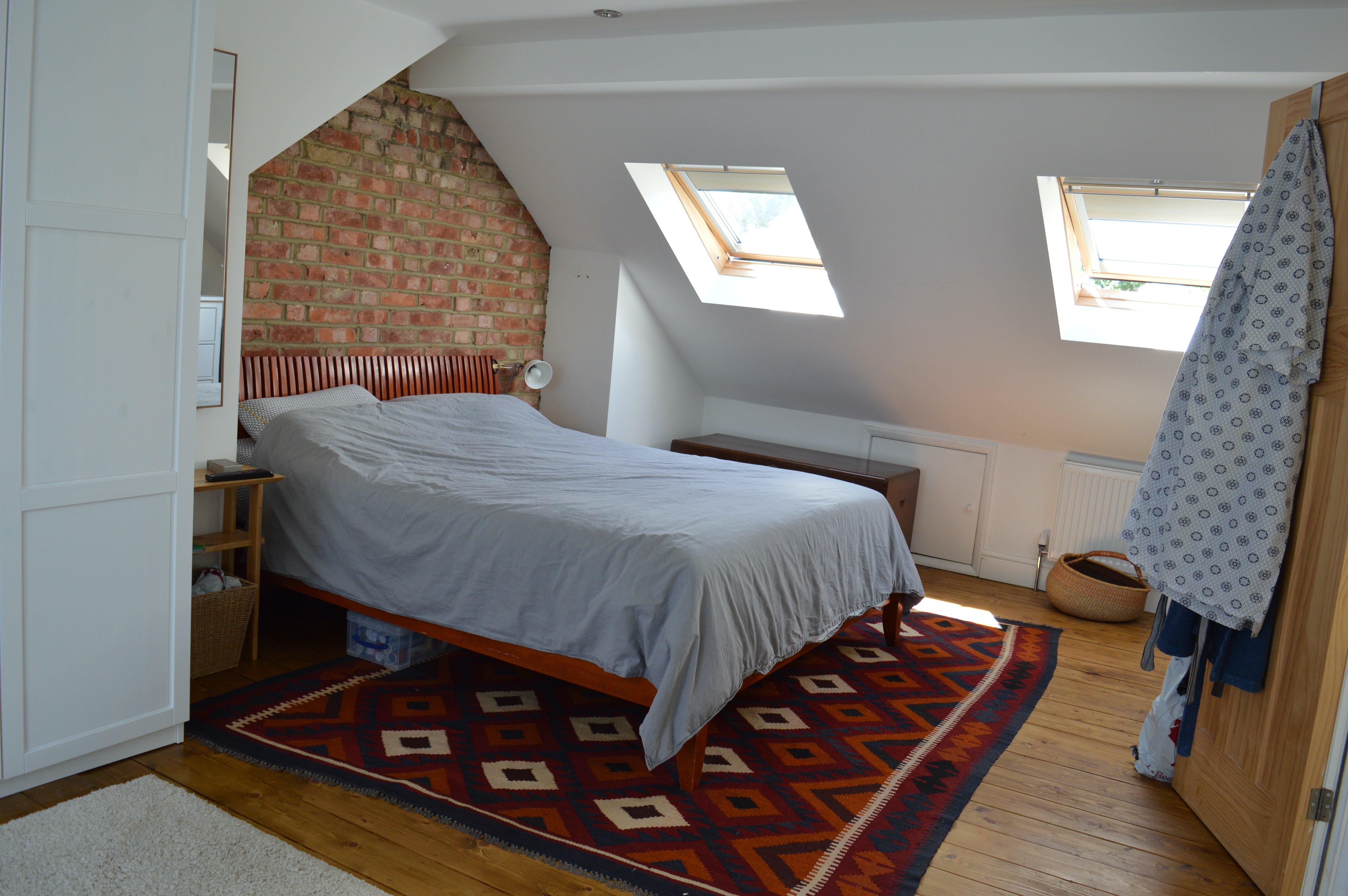

Rachieble Posted December 17, 2021 Author Posted December 17, 2021 3 minutes ago, pocster said: You get get an electric shower that uses gravity from the tank to feed it . Out at the moment a link not easy . @Nickfromwales knows what you want . That's what I thought. But the tank would have to go visibly on the bathroom wall then as there is nowhere above? you can see how little space there is so it'd have to be something tiny (if you look closely you can just see the top corner of the room above the extractor fan). This is the bathroom above, which has even less space (stacked directly above this one), and I've attached picture of the bedroom in the loft, to show you how little eaves space there is, and obviously already finished with radiator and no real access - eaves about 5m across the house from the bathroom on the wrong side.

Rachieble Posted December 17, 2021 Author Posted December 17, 2021 18 minutes ago, TonyT said: Cupboard to the left of the radiator? Its tiny though. And I can't get any pipes across the floor to the bathroom at the other end of the house due to a huge steel cutting it in half - the floorboards are laid directly onto the steel and there is no gap..
