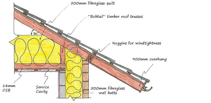

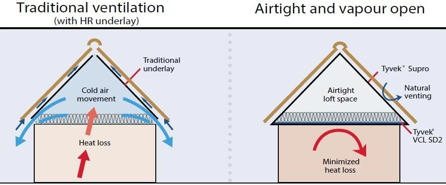

Cold roof here but following tyveks Sealed roof guidance. Thermal bypass is a problem otherwise.
Trussed roof with raided heals aka Denby Dale. 400mm of blown cellulose over the top.
Pros: Minimal thermal bridging and smaller surface area for heat loss. Very very simple to run a membrane and service cavity under the trusses. Cheaper.
Cons:  you can hear the roofing membrane in the wind as it billows. Only works really for a non habitable roof space so perhaps not for you.

Interesting discussion with our architect yesterday.   I expressed my intention to have a cold but sealed roof à la @Iceverge.
Reasoning:
Loft to be non-habitable, cheapest fink truss based, very limited use for storage.
Cold loft with insulation above plasterboard is cheapest and quickest solution.
Hate insecty lofts, with a passion (as I’m now sitting underneath one, humph).
Improved thermal performance.
Fits nicely with airtight strategy as I’ll put a VCL directly above plasterboard ceilings.  Yes I’ll need to faff around sealing round wires and MVHR ducts but I’m happy with that.
So, the architect then mentioned a drawback: it transpires that he’s heard of cases of condensation forming under specific circumstances on the inside of the ‘roofing felt’ (I’m a wrinkly, I know it’s technically breathable tile underlay but everyone knows where roofing felt sits!).   The circumstances are that it’s freezing conditions, roofing felt freezes and becomes vapour impenetrable, condensation forms.   Hmmmmmm.  Don’t like the sound of that.
Now one of my less positive attributes is that I think very slowly, and hours later I realised that this may be a symptom of the architect not being as used to working with airtight house designs as they could be.  My thinking is that if I achieve an airtight ceiling then little water vapour will reach the loft and thus little or no condensation will form.
So, is that a safe assumption?  Will a sealed cold loft above an airtight house have running water?
