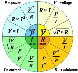

Question can I connect my  currently unused 285W solar PV panels DIRECT to a heating element such as:
Ohms law will tell you what you can do.
Got the T shirt.....seriously.
While I understand this. I suppose my question is can I treat the solar PV panel as a simple 40V dc battery?
i.e. I mustn't short the connections but otherwise I can pretty much do what I want
Or are there any additional considerations I must consider to ensure there is no damage to the panel?
Thank you very much for this post. The power (P) of a good graphic (G) writ large.
For the first time in my life I have realised that I can go round the graphic substituting 230 for each instance of V.
Only took 63 years....:$
That is the power of algebra.
So taking that little heater, was a 12V one that had a power of 200W.
We can work out the resistance using the 'orange' part of the chart.
R = V2 / P
R = 122 / 200
R = 144 / 200
R = 0.72
Now, working out to see what would happen if the voltage was 40V
Using the 'blue' bit we can use.
P = V2 / R
P = 402 / 0.72
P = 1600 / 0.72
P = 2222
That is 11 times the power, so I think you can work out what will happen.

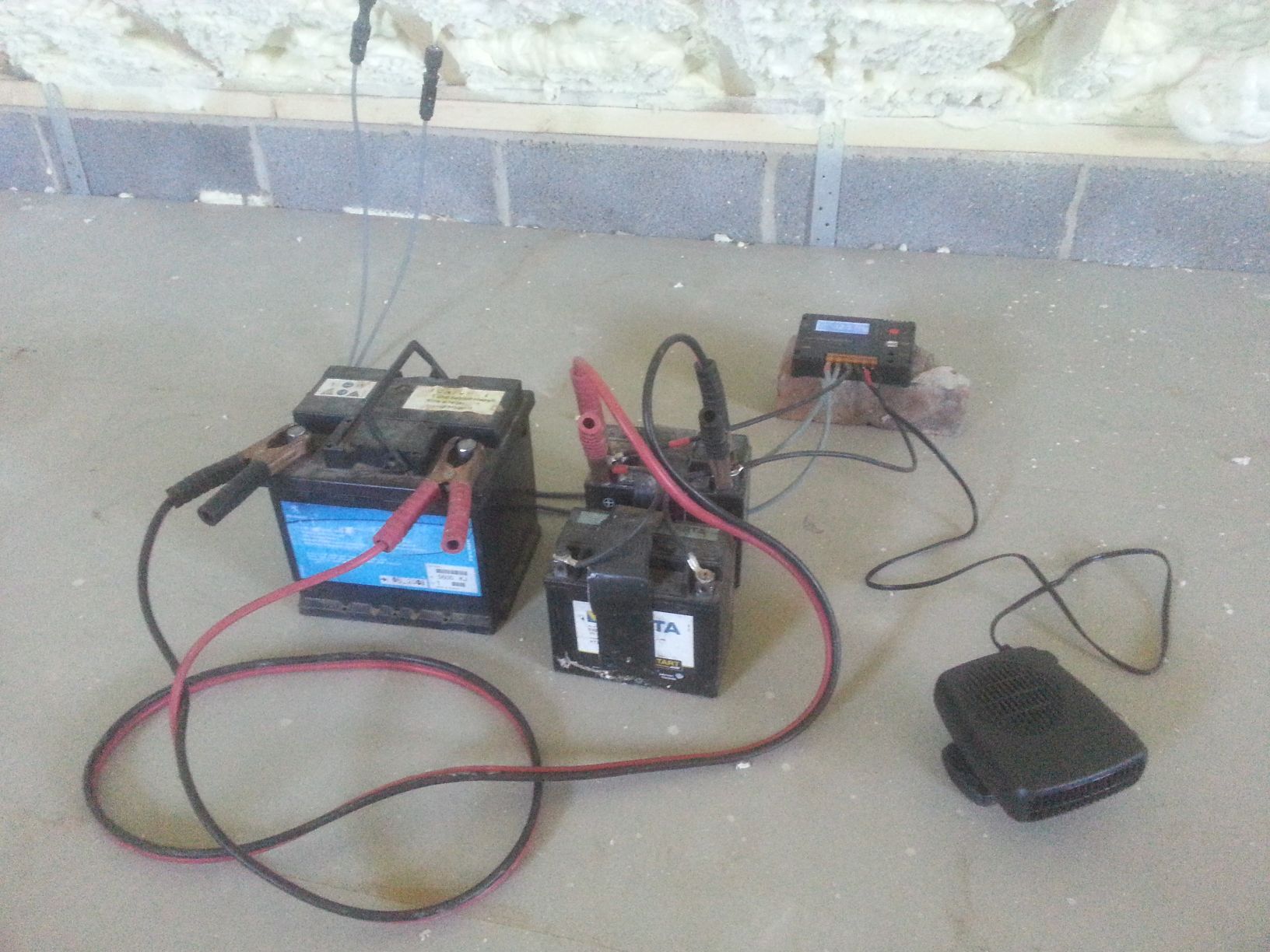

Sorry I forgot to say this is just a temporary solution and therefore I want to keep expenditure to the very minimum but will rig up something using some second hand car batteries and a cheap as chip inverter. Given it appears the little heater will blow up.

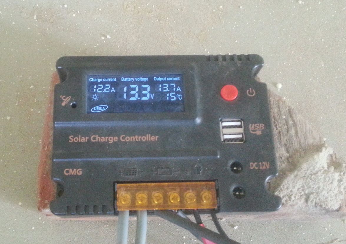

Sorted a £6 150W car fan heater and a few old batteries.
Nicely balanced at 12 Amp in and 13Amp out (when its sunny)
(Though 12A @ 12V is only 144W so long way down on the 285W the panels are supposed to generated - assuming input current measured at 12V and not the open circuit 37V)
