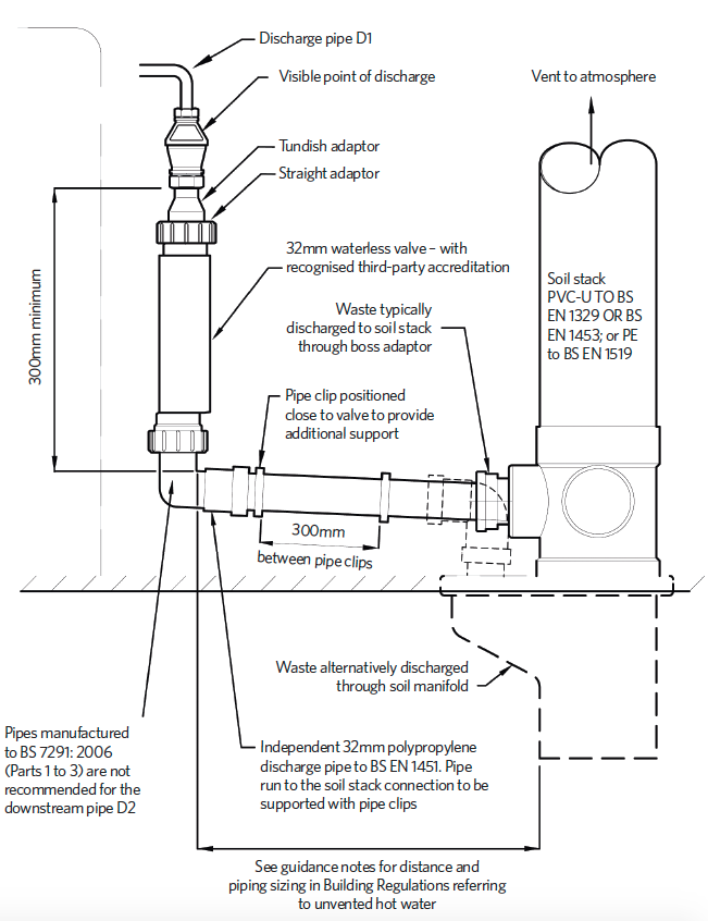

Seeoda Posted December 14, 2021 Author Share Posted December 14, 2021 On 10/12/2021 at 10:45, PeterW said: It is the pressure relief blow off and must be made of copper or a similar material and must go to an outside wall. Thermal bridge is negligible - it’s also sealed into the end of a valve on the boiler so no air flow. They have to run off even if you have something like this? https://hotun.co.uk/benefits-of-hotun/prv-discharge-pipe-routing-issues-hotun-the-simple-solution/ As you say, the thermal bridging is bound to be small. Link to comment Share on other sites More sharing options...
PeterW Posted December 14, 2021 Share Posted December 14, 2021 Yes that is ok but you need to run into the correct pipework as standard polyethylene waste pipe does not meet the standard required under G3. Link to comment Share on other sites More sharing options...
MJNewton Posted December 14, 2021 Share Posted December 14, 2021 On 10/12/2021 at 09:45, PeterW said: It is the pressure relief blow off and must be made of copper or a similar material and must go to an outside wall. Are you sure? Our PRV discharges to an internal soil stack via a length of copper pipe to a tundish, HepVO valve and 32mm 'plastic' (not sure of actual material/markings) waste pipe to an internal soil stack. I believe it is quite a common setup these days. Link to comment Share on other sites More sharing options...
PeterW Posted December 14, 2021 Share Posted December 14, 2021 Just now, MJNewton said: Are you sure? Yes … if it goes through the wall then it has to be copper. If it goes to an internal / tundish arrangement then there are various rules including the lengths and type of pipework. Those BS/EN standards are not on all pipes. They don’t apply to a lot of standard polyethylene pipework. Link to comment Share on other sites More sharing options...

Nickfromwales Posted December 14, 2021 Share Posted December 14, 2021 6 hours ago, MJNewton said: Apologies - I misunderstood what you were saying. I read it that you must discharge externally. You do in every instance where there is existing foul / waste pipework that you cannot confirm the type / specifications of. If in doubt, pipe goes out. As @PeterW says, the boiler PRV is a normally closed valve so no through draft can occur, and if you're that worried about this rather insignificant cold bridge, just cut the pipe off inside, drill back through at 25mm diameter and push a 21.5mm pvc overflow pipe into the wall as a sleeve. Seal that both ends with a suitable sealant. Re-fit the 15mm copper pipe through the sleeve, and fill the gap around the copper pipe with expanding foam at both ends. Problem ( if one actually exists ) solved. Link to comment Share on other sites More sharing options...
