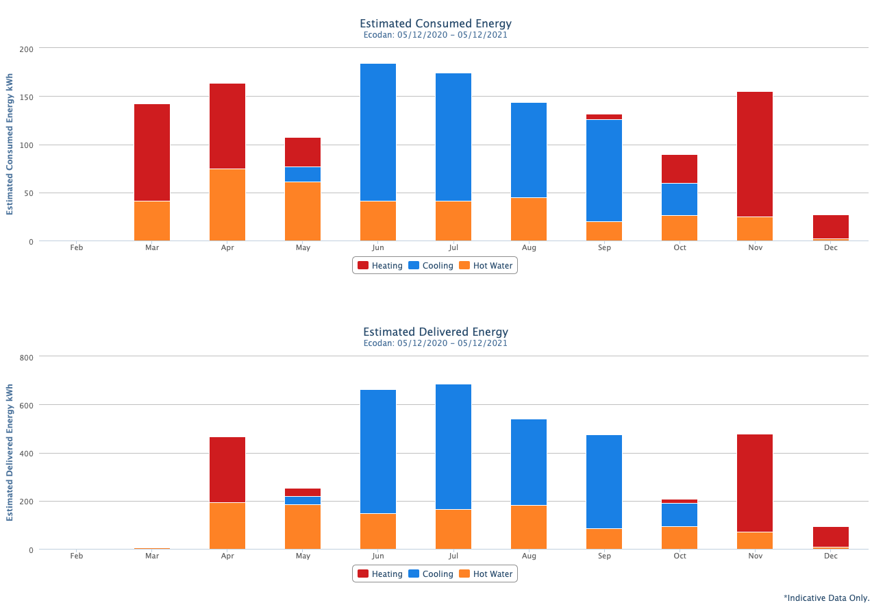

joth Posted December 6, 2021 Share Posted December 6, 2021 Sorry really dumb question but how are you calculating the COP? I have an ecodan 8.5kW, the MELCloud gives a very vague bar chart of energy consumed and delivered per month, but I can't see how to extract actual numbers from it to get a ratio (Yes my cooling usage was through the roof this summer, working on that) Link to comment Share on other sites More sharing options...
Radian Posted December 6, 2021 Share Posted December 6, 2021 14 minutes ago, joth said: I have an ecodan 8.5kW, the MELCloud gives a very vague bar chart of energy consumed and delivered per month, but I can't see how to extract actual numbers from it to get a ratio Long shot... have you ever right-clicked the web page for those stats and selected "View page source" or similar? Maybe just images pushed from server but if there's some <script> stuff... Link to comment Share on other sites More sharing options...

joth Posted December 6, 2021 Share Posted December 6, 2021 (edited) 1 hour ago, Radian said: Long shot... have you ever right-clicked the web page for those stats and selected "View page source" or similar? Maybe just images pushed from server but if there's some <script> stuff... I thought about it a few times, but hadn't got around to trying It's not obvious in the page source (just the pixel height of the bar chart elements) but reloading the report with Network logging on makes it easy to find. (I'd previously used that trick to discover restful commands to turn it from heating to cooling mode and back, meaning in principle I can automate switching the unit over at the start/end of cooling season) That spat out some JSON numbers for consumed and delivered DHW figures for this year, by month. HotWater: [0.03, 41.129, 74.68999999999998, 61.456, 41.15999999999999, 41.328, 45.029, 20.189999999999994,…] ProducedHotWater: [0, 5.39, 192.41999999999996, 184.10899999999998, 148.61900000000003, 165.85999999999996,…] consumed delivered COP Feb 0.03 0 0.00 Mar 41.129 5.39 0.13 Apr 74.69 192.42 2.58 May 61.456 184.109 3.00 Jun 41.16 148.619 3.61 Jul 41.328 165.86 4.01 Aug 45.029 182.04 4.04 Sep 20.19 86.418 4.28 Oct 26.348 93.619 3.55 Nov 25.089 69.9 2.79 Dec 2.21 7.28 3.29 December is suspiciously high, but maybe just data error as we're only a few days into it. But ranging from 4 in summer to 2.8 in Nov seems healthy. EDIT: I'm a bit suspicious though of why the overall demand dropped so much from Sept onwards. We have PV divert in addition to this, but do run the ASHP to heat DHW when the sun is strong too. Give me a grim feeling that when running in Cooling mode, it actually spends a bunch of time chilling then reheating the cylinder. GOD DAMN IT I bet that's the damn Honeywell VA4073A they installed getting stuck in the mid position ? Edited December 6, 2021 by joth 1 Link to comment Share on other sites More sharing options...
