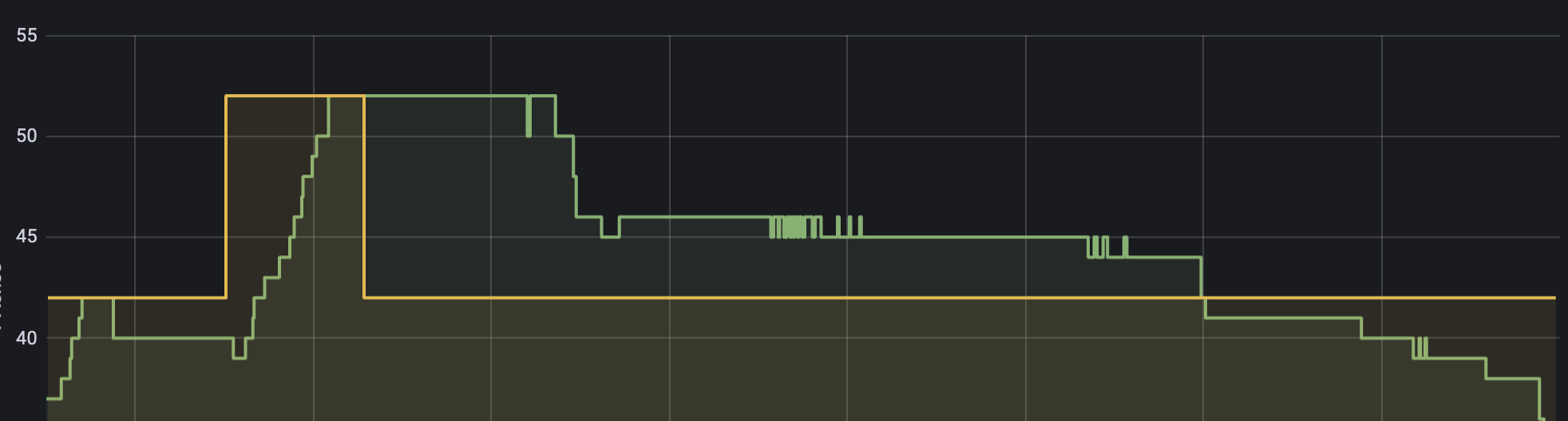

Also, one thing I noticed is that even if we're not using hot water, there's a somewhat immediate steep drop of tank temperature after heating, only then to mellow out:image.thumb.png.a0d14660a1869bc9b3c6900a1cbca554.png
Could it be the heating is pretty focused around the area where it measures, and then when the tank mixes, it starts averaging out, only then to drop more gently?

Sounds like the cylinder is just getting stirred up and cylinder thermostat says I'm hot enough. Heat pump does work at high temperature with no benefit

Even more evidence the tanks just getting stirred

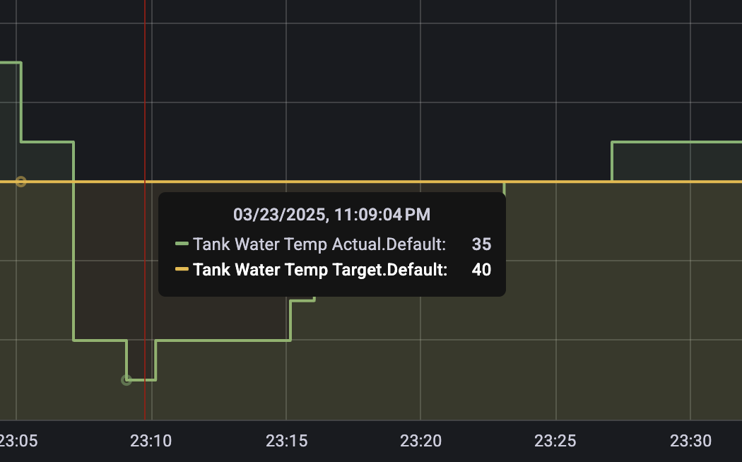

As can be seen in the graphs the pump really only runs for ~20 minutes, regardless of what target temp I set it to. Case in point:
At 11:09 the difference between target and actual is 5C, and the ASHP (mitsu logic) switches off at 23:25 or so, almost immediately when it hits the target temp.
What I am wondering here - if the ASHP is being asked to provide 40C water, and the tank approaches that 40C, can't it just keep running at 40C for a decent amount of time? Or will not being able to lose the coolant heat to the tank heat quickly enough be more inefficient still?

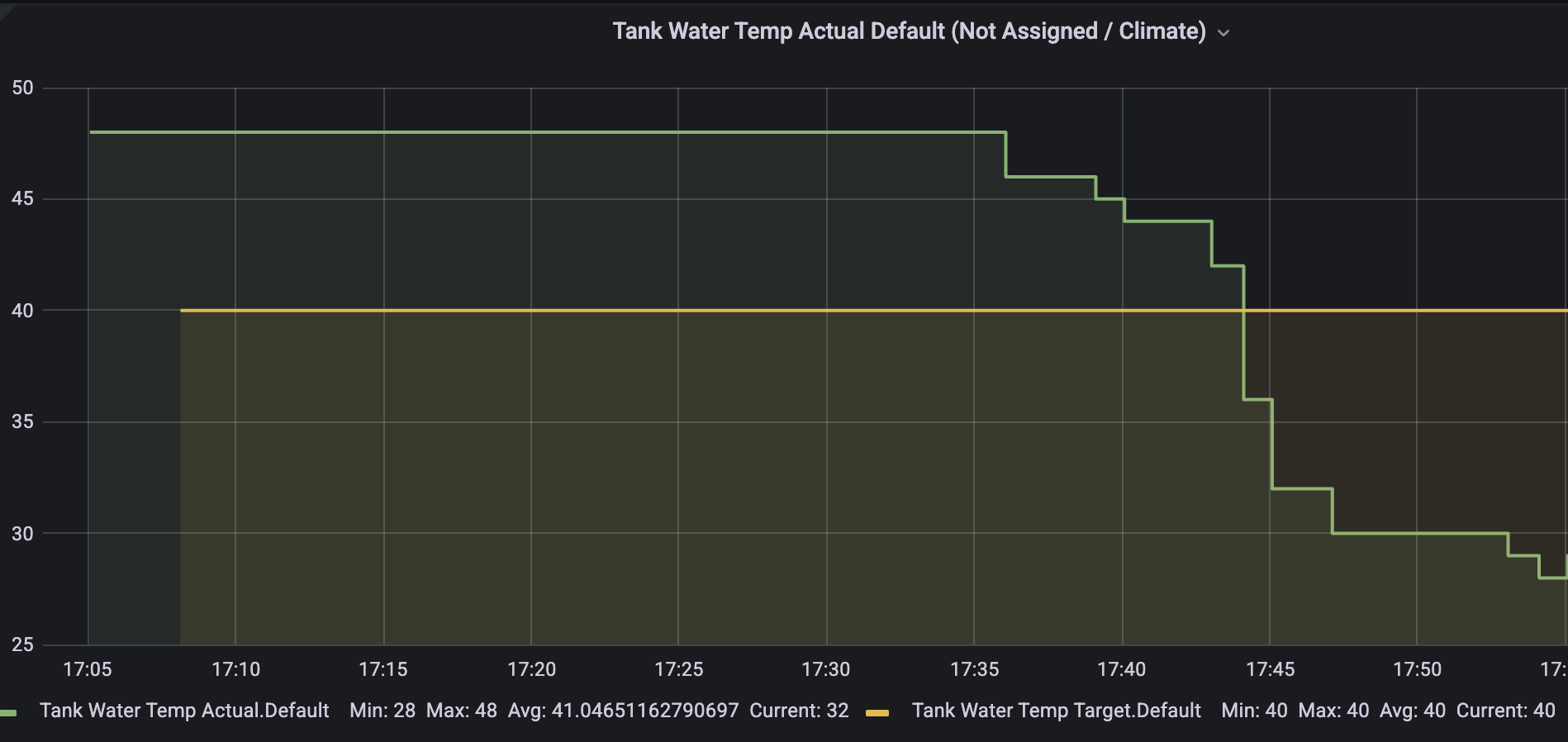

Frankly I'm still trying to make sense of the overall temp in my tank. The amount of temperature loss due to a short shower is massive. Eg this is my kid today showering for, it seems, about 10 minutes, and the tank drops from 48 to 30. The showers are clearly not "eco" but they are also not excessive wrt the amount of water we are talking about. (also my water pressure is 3bar)image.thumb.png.ed7e43079c26eb3f13191e906291346b.png
As I've suggested before, add monitoring/logging for the high and low pockets in the tank, I expect you'll see the top stays permanently at/above target and the bottom around 10°C or smth
Indeed, it's on the todo list :) - I'm sure we'll get to it when things get moving again.
If the water coming out the shower had dropped to 30 C I'm sure your kid would have let you know!  The only logical explanation I can think of is that the sensor is right at the bottom of the tank, for some unknown reason.  That's pretty much was @jothis saying.
