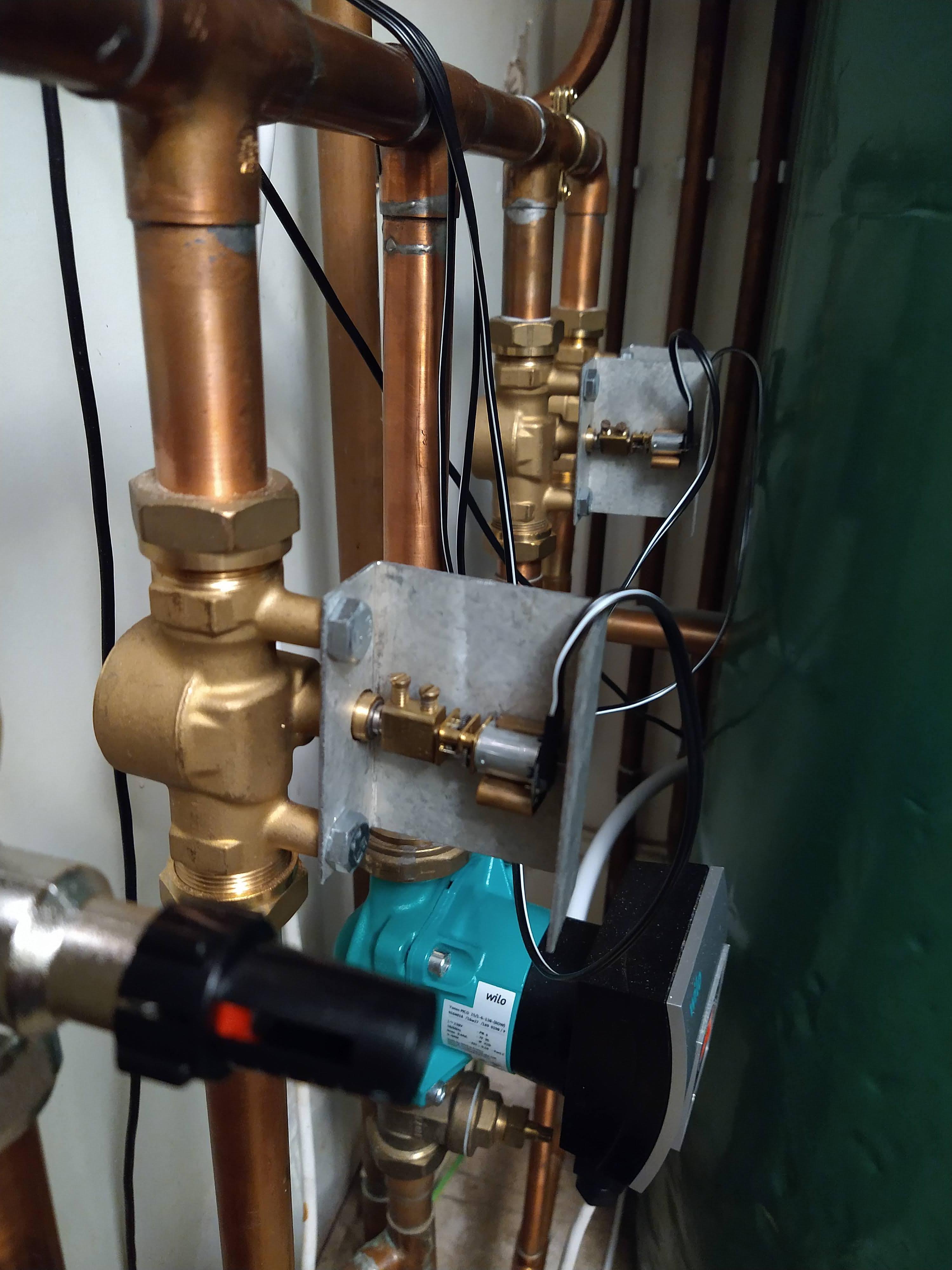

Radian Posted December 5, 2021 Posted December 5, 2021 I have a pathological hatred of typical 2-port valves. They all seem to be based on the same ancient, crappy, design of a synchronous AC motor that gets hot when driven to stall, via a micro-switch hacked-in current limiting resistor (that also gets hot) dissipating something in the order of 6 Watts. Getting on a bit in years, I've lost count of the number of actuator heads I've had to replace and the price of them was beginning to feel more like a tax on owning a heating system. The final straw came on a frosty X-mas morning when the heating didn't come on because... That was a couple of years ago and because SFix & TSn were closed for the festivities, I enlisted a Raspberry Pi, stepper motor and 3D printer to be hero just for one day. This episode gave me a taste for getting back control of my heating system and I have not looked back since. These days I use a bunch of drayton 2-port valve bodies (£3 Ebay) with a micro metal gearbox motors (<£5) driven by Pololu H-bridge constant current drivers (£5) mounted on some scrap metal: My question is... do people around here just put up with the typical Honeywell/Drayton valves circa £60 or do they go for something more exotic (that I've yet to find) or are they rolling their own like me?

Radian Posted December 6, 2021 Author Posted December 6, 2021 14 hours ago, Kelvin said: Interesting. I hate the feckers too. I’ve just replaced two of useless things at a cost of £100. Worse than that the tails were shorter than the same model I took off so had to bugger about sorting that as well. They have failed in every house I’ve owned. Regular failures are a sign of poorly engineered products. But what about the power consumption? I don't see any discussions about this but 6Watts 24/7 x how may valves are in play? Some people can heat their whole PH on that! 13 hours ago, ProDave said: I actually find the Honeywell ones quite reliable. Agree the Drayton ones are pants. If you think 2 port valves are bad, you have obviously never had a system with a 3 port mid position valve. I thought that about Honeywells too, to begin with, but that was the last type I had to replace. And yes, the 3 port mid - I had one that went both ways irrespective of where the shaft was pointing. At least the actuator wasn't to blame in that particular case! I took it apart expecting to see a missing rubber seal but it all looked kind of OK.

Radian Posted December 6, 2021 Author Posted December 6, 2021 10 minutes ago, epsilonGreedy said: Your DIY valve port interests me because I would like per room zoned heating but I also dislike the thought of building a new house that is dependent on wifi at each radiator for heating automation. If you do go down that route, a £30ish Zigbee TRV could be your best bet. There's a zigbee2mqtt project that can be run on Raspberry Pi which, with the addition of node red could let you knock-up your dream-come-true entirely self-hosted setup. I have a blend of both approaches to zoning but when you can home-brew a motorised valve for well under £20 zoning each room does seem attractive. The motors I've used can also be fitted with a hall-effect sensor that encodes shaft position to give full servo control to make proportional valve opening possible. I haven't done that because I only needed three zones that all have their own temperature controlling components. I do make use of the fact that the motor's braking isn't quite up to holding the valves fully shut... to pinch them off I keep the motors in stall (the constant current driver does this loss-lessly through PWM) but when my tiny UFH zone is the only load, the boiler can't modulate down low enough without cycling so I keep the main radiator zone slightly open which has the effect of gently pre-heating them in the wee small hours.
Radian Posted December 6, 2021 Author Posted December 6, 2021 10 minutes ago, PeterW said: So why not use the standard UFH manifold and the Wunda automatic balancing valves ..? Yes, manifold distribution would be the way to go for more than a couple of zones and those are designed with an eye on power consumption at least. How long are the sensor leads out of curiosity?
