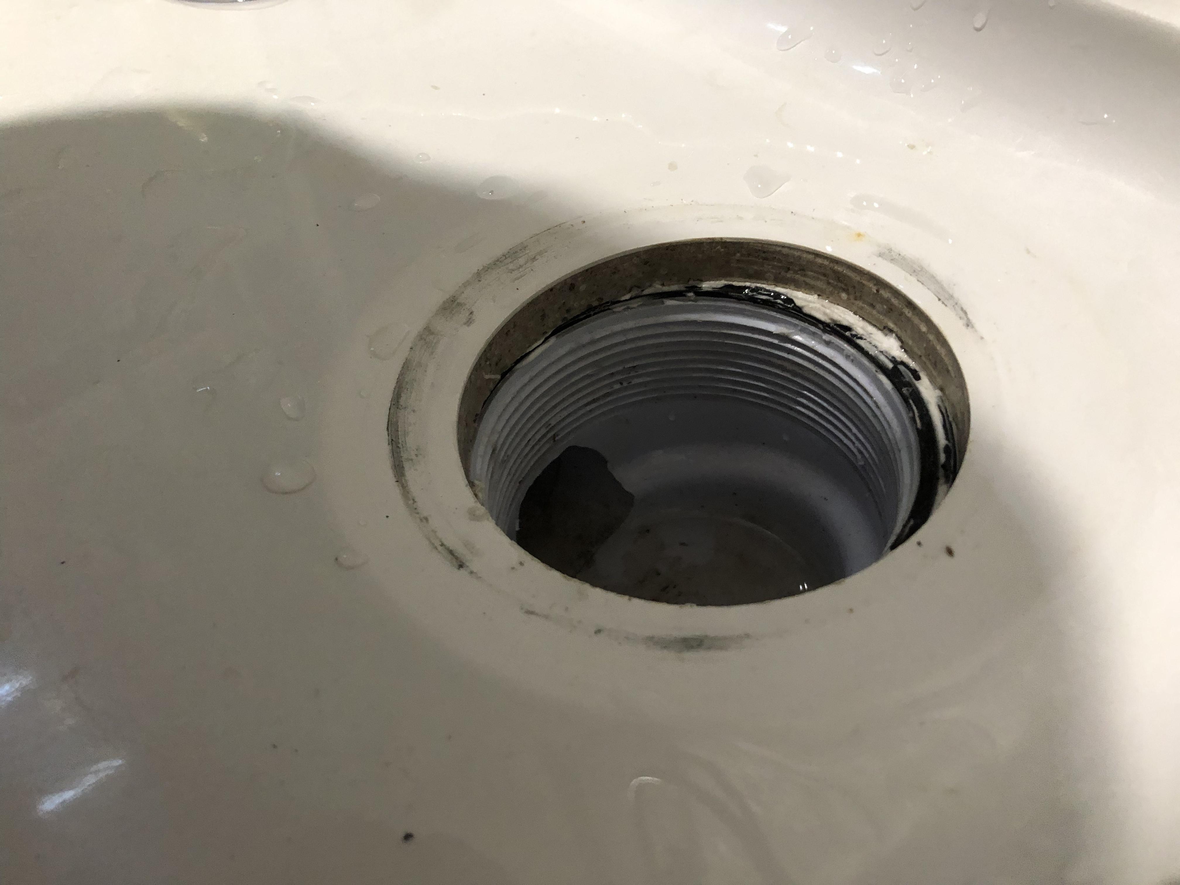

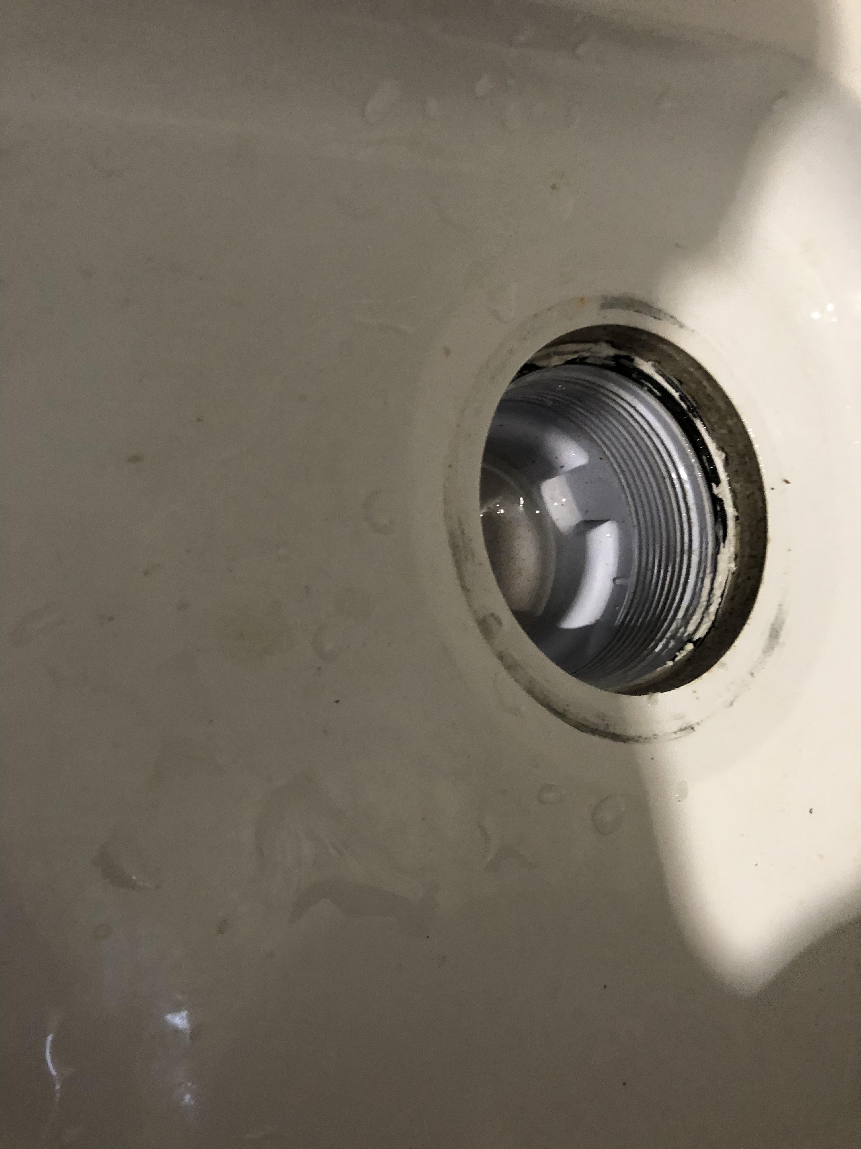

Onoff Posted November 27, 2021 Posted November 27, 2021 Rip it out and start again. Clean all the silicone off of it, every last bit. Was the trap the same make as the tray? Sometimes the trap rubber washers are generic thus a bit of a crap fit to that particular tray ( so said your uncle way back). I can only go by what I did and the tips given. I ditched one washer and loaded with Sika EBT. The top side has come out really well IMO. I wasn't overly fussed about underneath. Baby wipe around and walk away until set: Did the same with the overflow: 1
Pocster Posted November 27, 2021 Author Posted November 27, 2021 1 hour ago, Onoff said: Rip it out and start again. Clean all the silicone off of it, every last bit. Was the trap the same make as the tray? Sometimes the trap rubber washers are generic thus a bit of a crap fit to that particular tray ( so said your uncle way back). I can only go by what I did and the tips given. I ditched one washer and loaded with Sika EBT. The top side has come out really well IMO. I wasn't overly fussed about underneath. Baby wipe around and walk away until set: Did the same with the overflow: Yeah trap supplied with tray . Getting it out is the issue as it’s awkward and trap and metal insert will all be silicone… . Monday I’ll attempt to rip it out . Might try the multi tool under neath to cut the trap in half or something ….
Pocster Posted November 27, 2021 Author Posted November 27, 2021 Well ! The cover ( what do you call the bit that screws in from above the tray? ) came undone easy - too easy imho . Not touched the trap - but it looks like a decent seal .. ( but isn’t ) . Getting the trap out easy now . Recommendation for a new decent trap etc. - screw fix link appreciated !
Gone West Posted November 27, 2021 Posted November 27, 2021 (edited) I used McAlpine Hi-Flow shower wastes at our last place. No leaks. https://mcalpineplumbing.com/traps/shower-traps-accessories/st90cp10-hp2c-112-90mm-hi-flow-shower-trap https://www.screwfix.com/c/heating-plumbing/traps/cat831610?trapapplication=shower#category=cat831610&brand=mcalpine&trapapplication=shower Edited November 27, 2021 by Gone West 1
Pocster Posted November 27, 2021 Author Posted November 27, 2021 9 minutes ago, Gone West said: I used McAlpine Hi-Flow shower wastes at our last place. No leaks. https://mcalpineplumbing.com/traps/shower-traps-accessories/st90cp10-hp2c-112-90mm-hi-flow-shower-trap https://www.screwfix.com/c/heating-plumbing/traps/cat831610?trapapplication=shower#category=cat831610&brand=mcalpine&trapapplication=shower Do I still silicone ring to trap then trap to underside ? . Or just fit unbodged first ? ?
Gone West Posted November 27, 2021 Posted November 27, 2021 3 minutes ago, pocster said: Do I still silicone ring to trap then trap to underside ? . Or just fit unbodged first ? ? I didn't use any silicone but did check the surfaces were flat and smooth. IIRC I used silicone grease on the outlet compression fitting.
bassanclan Posted November 27, 2021 Posted November 27, 2021 Use CT1, both above the tray and below. Every time you undo it there's more likelihood of damaging the rubber, so do it bombproof once. +1 for the macalpine, available in Screwfix or Toolstation (just check the size of hole in the tray) 1
Pocster Posted November 27, 2021 Author Posted November 27, 2021 3 minutes ago, bassanclan said: Use CT1, both above the tray and below. Every time you undo it there's more likelihood of damaging the rubber, so do it bombproof once. +1 for the macalpine, available in Screwfix or Toolstation (just check the size of hole in the tray) Notice also with the macalphine it has a rubber washer for above the tray . Thought it was strange the supplied one had none .
markc Posted November 27, 2021 Posted November 27, 2021 2 minutes ago, pocster said: Notice also with the macalphine it has a rubber washer for above the tray . Thought it was strange the supplied one had none . You can fit without top rubber (some people think the black rubber looks like mold so don’t want it) but then needs a good flexible clear or white ct1 or silicon 1
Pocster Posted November 30, 2021 Author Posted November 30, 2021 (edited) Fitted the mcalphine . Seems a much better fit. Rubber seems much thicker ( SWMBO told me about this ). Had a slight leak on my glued pipework ; up a ladder , limited view, limited light so will forgive myself. Tiger sealed around those joints. So full test tomorrow when SWMBO showers. Also 'cheated' a bit ( but again will forgive myself as accessible ) and fitted a flexicon onto the new pipework again to make my life a bit easier. So so far looking promising!!! Forgot!. Tightening the actual trap to the tray (from above ) about a million times easier than the previous trap. Easy to grip; lots of thread - so much better! Edited November 30, 2021 by pocster 1
