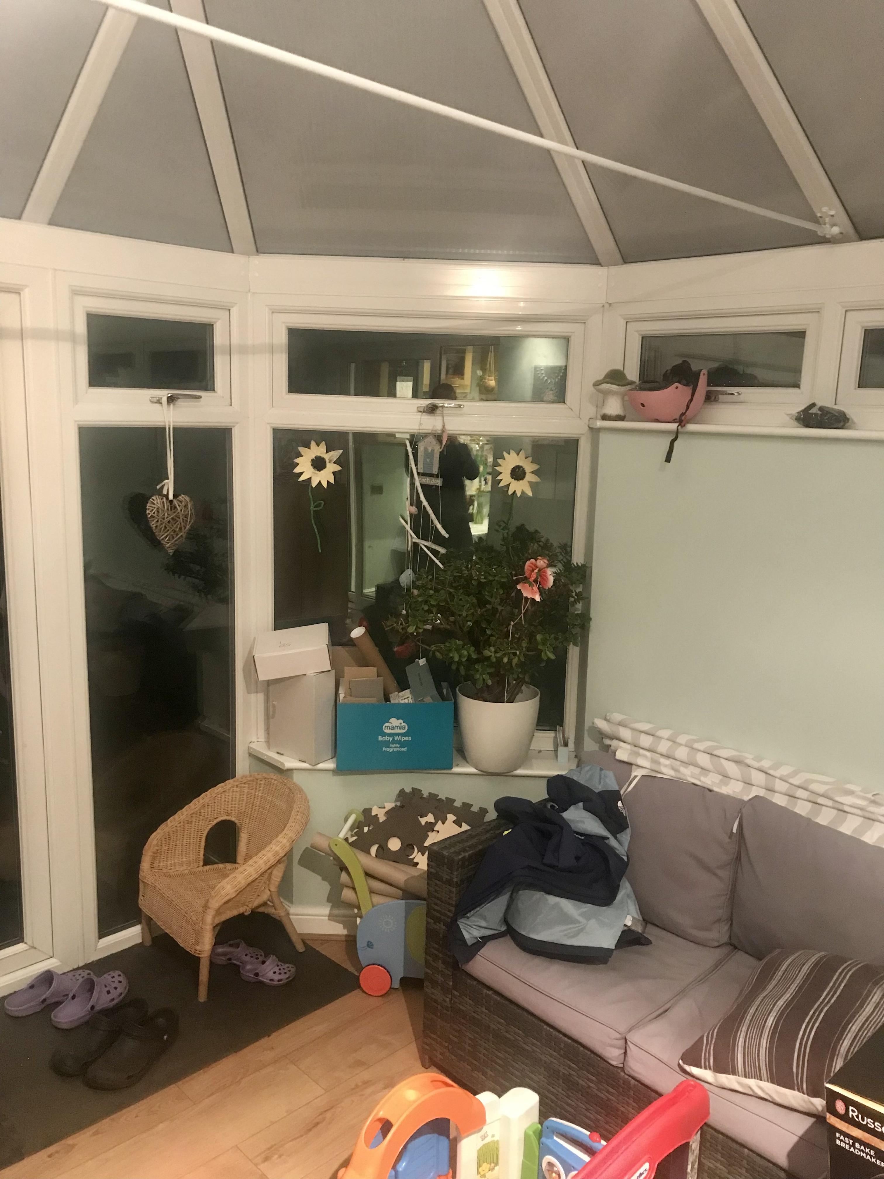

NickK Posted February 2, 2022 Posted February 2, 2022 Hi, I thought I’d resurrect this topic. We have this 4.2 x 3 (internally) conservatory and considering our options now. As you can see from the picture, in autumn and winter, it just becomes a dumping ground. It’s a Victorian shape with two head height side walls and a couple of dwarf walls build on an angle. A local very reputable company visited today to discuss lightweight roof option. Official quote still to come but in short, getting rid of small top windows and bring wall higher, replace the rest with 2 x aluminium over the dwarf walls and joined with 3 pane bifold door. On top, ultra roof style light weight roof with 3 glazed panels. All plastered etc. for £20k - £25k. Thoughts? Worth it or bring it down and build same footprint extension. Could I have flat roof with the weird hexagonal shape? Thanks

Gordo Posted February 4, 2022 Posted February 4, 2022 11 hours ago, gaz_moose said: just fix wooden battens to the roof beams, slot celotex between them and cover it in that space blanket insulation tinfoil stuff then clad it in T+G pvc bathroom ceiling. Don’t do it like this. It would be a bodge job. The company’s who upgrade conservatory roof have had structural engineers advice and from experience have to load test the completed roof to measure deflection in window frames to get BC approval. even then I don’t like it. Often the foundations and floors are substandard. I’d suggest tumble it and start again as safest route.

PeterW Posted February 5, 2022 Posted February 5, 2022 On 02/02/2022 at 20:29, NickK said: On top, ultra roof style light weight roof with 3 glazed panels. All plastered etc. for £20k - £25k. Thoughts? seems expensive for a roof and doors and it’s not going to be much better than what’s there. On 02/02/2022 at 20:29, NickK said: Worth it or bring it down and build same footprint extension. Could I have flat roof with the weird hexagonal shape? that would be my choice - and yes you could do any shape in GRP as a roof. You’ve got around 12 sqm - even at £2k/m you should get change from £25k for a nice extension
Temp Posted February 5, 2022 Posted February 5, 2022 4.3x3m at £25k is £200 per square foot. Seems expensive to me.
SteamyTea Posted February 5, 2022 Posted February 5, 2022 6 minutes ago, Temp said: 4.3x3m at £25k is £200 per square foot. Seems expensive to me. Mixed units. £1938/m². Could build a proper house for that. 1
