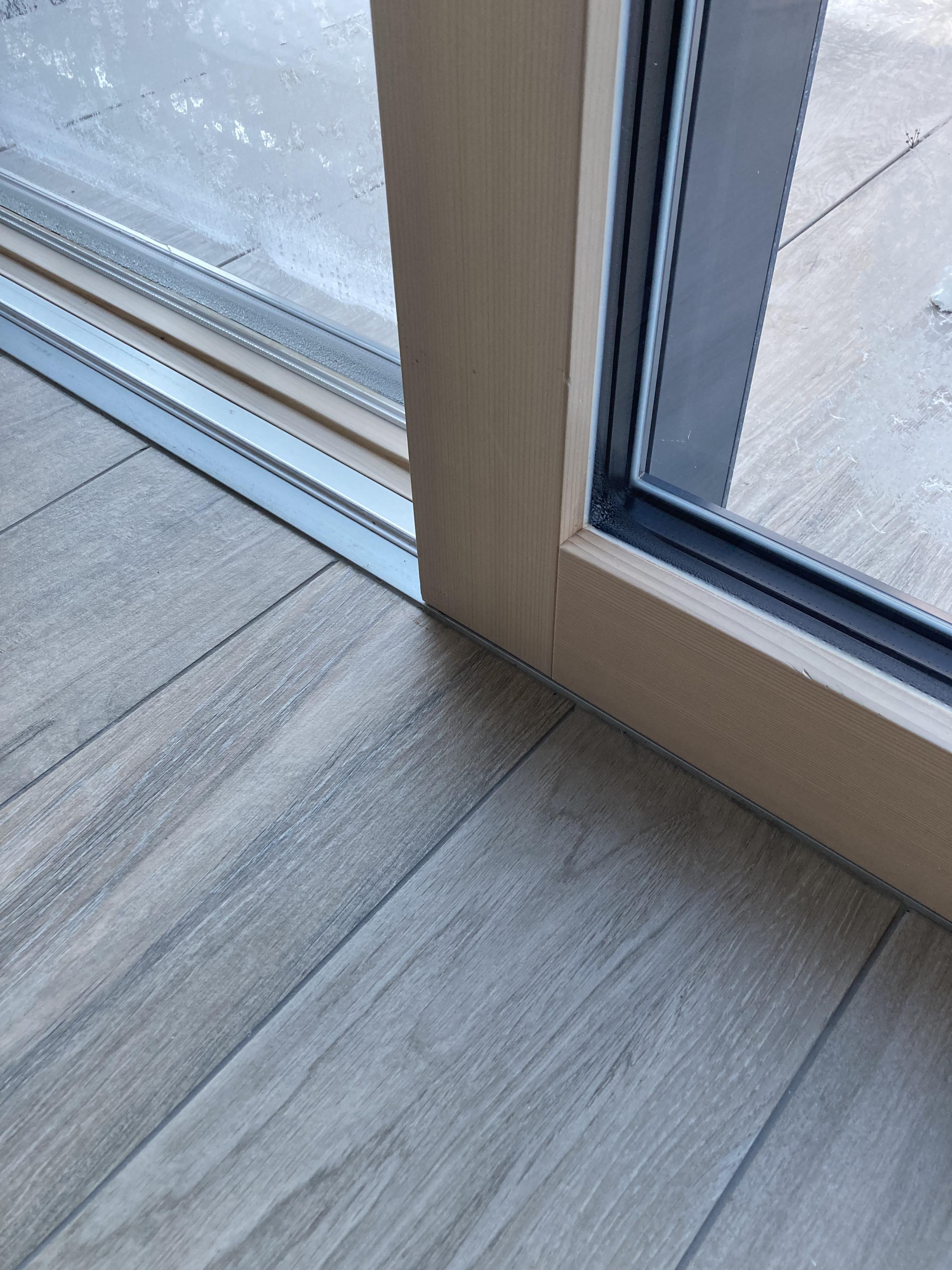

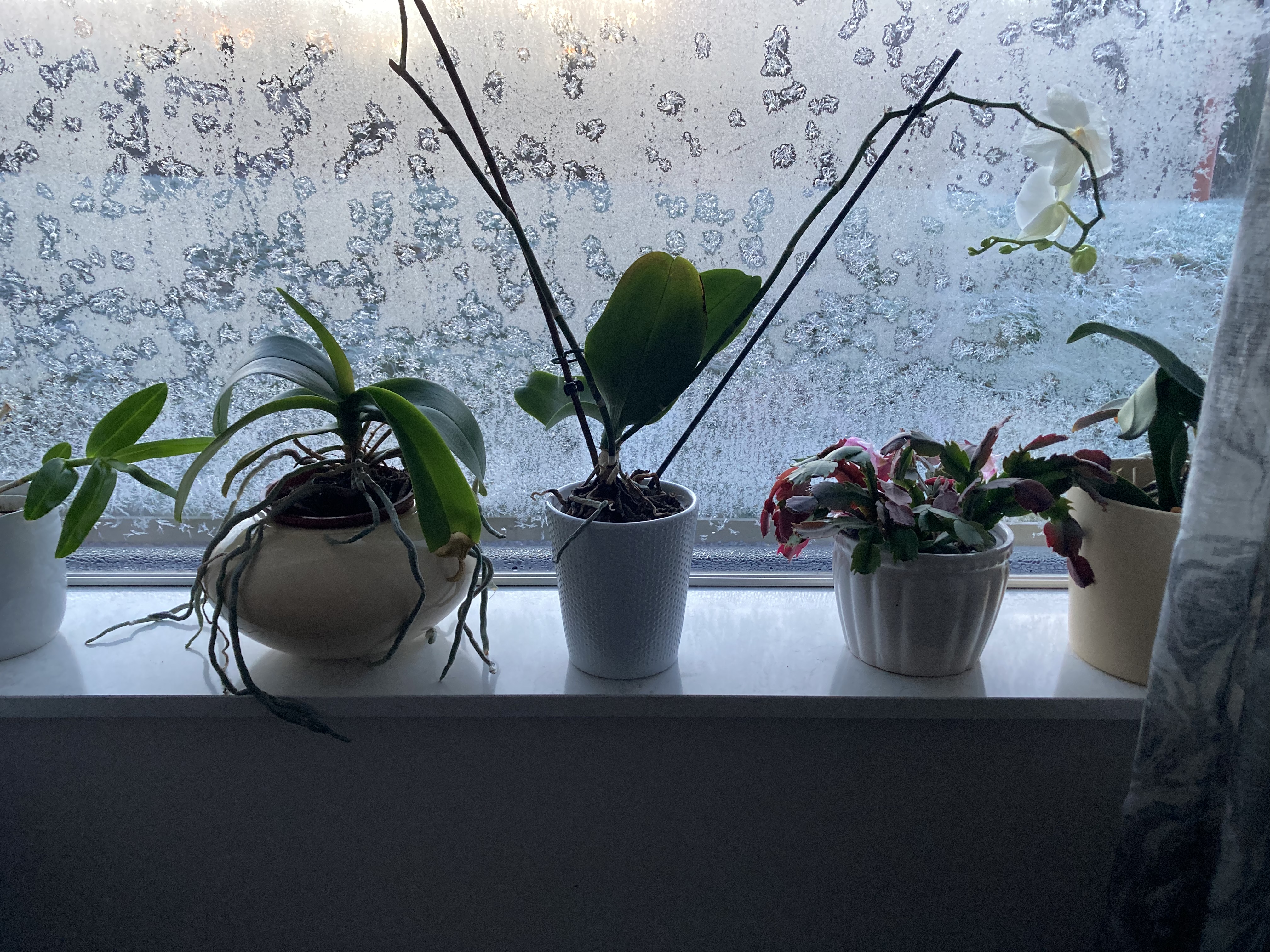

Russdl Posted January 18, 2023 Author Share Posted January 18, 2023 An update some 12+ months on: Here’s a picture of ice formation on the outside of our windows, I think it looks quite striking. What is not so nice is the condensation along the bottom on the inside. The house has had another year to dry out (it wasn’t ‘wet’ anyway despite the assertions of some). The internal temperature is 19.5o and the external temperature is -4.5o I’m sure it must have something to do with our enthalpy heat exchanger but as it only happens when it’s well into the minus figures outside we’ll live with it. Link to comment Share on other sites More sharing options...
Stones Posted January 18, 2023 Share Posted January 18, 2023 20 minutes ago, Russdl said: An update some 12+ months on: Here’s a picture of ice formation on the outside of our windows, I think it looks quite striking. What is not so nice is the condensation along the bottom on the inside. The house has had another year to dry out (it wasn’t ‘wet’ anyway despite the assertions of some). The internal temperature is 19.5o and the external temperature is -4.5o I’m sure it must have something to do with our enthalpy heat exchanger but as it only happens when it’s well into the minus figures outside we’ll live with it. Is it just that window, or every window that you have condensation inside (when outside temp is as per you describe)? Link to comment Share on other sites More sharing options...
Russdl Posted January 18, 2023 Author Share Posted January 18, 2023 @Stones this morning and other cold mornings it’s pretty much every window. The worst was the en-suite which can be put down to me for having a shower in the evening and not putting the MVHR on boost. The photo is of the kitchen/dining window. Biggest room in the house and no cooking activity since mid afternoon yesterday. Link to comment Share on other sites More sharing options...
Russdl Posted January 18, 2023 Author Share Posted January 18, 2023 Here’s a picture of the slider in the kitchen/dining room - south facing if that makes any difference, the other photo is an east facing window. Link to comment Share on other sites More sharing options...

MDC Posted January 19, 2023 Share Posted January 19, 2023 On 18/01/2023 at 08:15, Russdl said: An update some 12+ months on: Here’s a picture of ice formation on the outside of our windows, I think it looks quite striking. What is not so nice is the condensation along the bottom on the inside. The house has had another year to dry out (it wasn’t ‘wet’ anyway despite the assertions of some). The internal temperature is 19.5o and the external temperature is -4.5o I’m sure it must have something to do with our enthalpy heat exchanger but as it only happens when it’s well into the minus figures outside we’ll live with it. Those houseplants trapped behind the curtains will create the condensation on the inside of that window. 1 Link to comment Share on other sites More sharing options...
Russdl Posted January 19, 2023 Author Share Posted January 19, 2023 8 hours ago, MDC said: Those houseplants trapped behind the curtains will create the condensation on the inside of that window. I’m sure they don’t help but the condensation forms on all windows, some without houseplants, some without curtains. Link to comment Share on other sites More sharing options...
