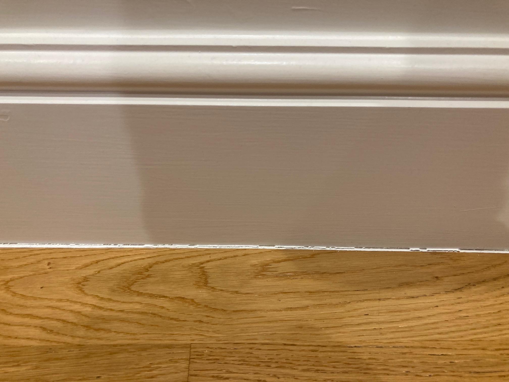

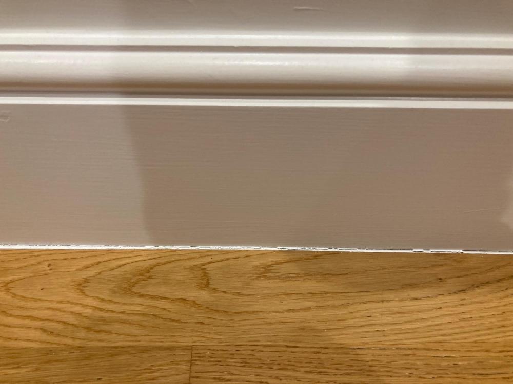

steveoelliott Posted November 23, 2021 Share Posted November 23, 2021 Hi, I had a decorator do our hallway a couple of months back and unfortunately a lot of areas of caulking between the skirting and floor have cracked. There was caulking in place previously which had also cracked in a similar way. I understand there will be some movement / flex at play here. Is there a product / technique that can avoid this cracking? I am not minded to contact the decorator regarding this as frankly I wouldn't be using him again owing to the amount of paint splatter (tiny little dots of paint) I keep finding on the floor and having to painstakingly remove. Any tips greatly appreciated. Link to comment Share on other sites More sharing options...

Bonner Posted November 23, 2021 Share Posted November 23, 2021 The trouble here is the gap is too small for anything to flex enough. Better to leave it, or use clear silicone which will still split but won’t be visible. To be fair the decorator has done a decent job, apart from not covering the floor perfectly. I have seen a lot worse! 1 1 Link to comment Share on other sites More sharing options...

Roundtuit Posted November 23, 2021 Share Posted November 23, 2021 4 hours ago, steveoelliott said: Any tips greatly appreciated. 1st tip: stop looking at it. No one else will ever notice! 2nd tip: a bead of white silicone would finish it nicely, but it needs doing by someone who can run a neat bead of silicone. (I don't think using clear silicone will help if it's the visual gap that offends). 1 Link to comment Share on other sites More sharing options...
steveoelliott Posted November 23, 2021 Author Share Posted November 23, 2021 33 minutes ago, Roundtuit said: 1st tip: stop looking at it. No one else will ever notice! 2nd tip: a bead of white silicone would finish it nicely, but it needs doing by someone who can run a neat bead of silicone. (I don't think using clear silicone will help if it's the visual gap that offends). You’re right with the first tip… one of my downfalls lol. I think white silicon bead may be the way to go. I wouldn’t attempt myself but might ask the guy that did the kitchen flooring as that has a nice neat bead around the edge. 1 Link to comment Share on other sites More sharing options...
bassanclan Posted November 23, 2021 Share Posted November 23, 2021 To me that looks more like a line from masking tape than caulk 1 Link to comment Share on other sites More sharing options...
steveoelliott Posted November 24, 2021 Author Share Posted November 24, 2021 10 hours ago, bassanclan said: To me that looks more like a line from masking tape than caulk I know it was definitely caulked... it had split before and when he did the skirting he tidied it up nicely. Over a few weeks it has split in some places but still fine in others. Obviously this is down to movement and the fact the caulk isn't adequately resistant to it. Link to comment Share on other sites More sharing options...
Bozza Posted November 24, 2021 Share Posted November 24, 2021 Acrylic caulk is what you need. Was told that by my decorator a couple of weeks ago. Especially in new builds. 1 Link to comment Share on other sites More sharing options...

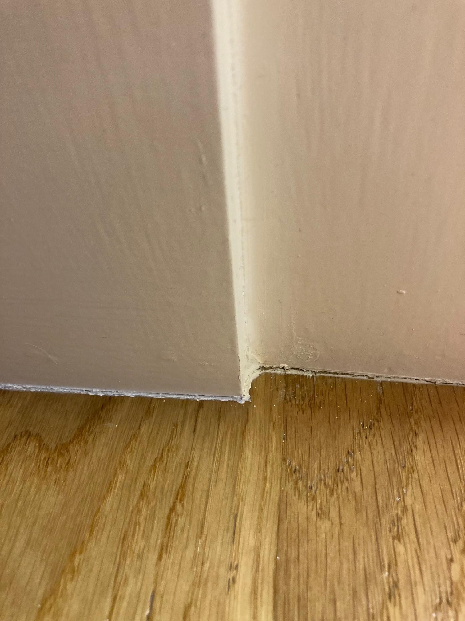

steveoelliott Posted February 3, 2022 Author Share Posted February 3, 2022 (edited) Well... this morning I was up bright and early so figured I try an area with a couple of thin metal opening tools (used for prying electrical things open etc.) I am quite pleased with the results... But I now see absolutely no reason for the caulking being used. This was before: The tools used: I should have taken identical before and after pics but they are the same pieces of skirting... I also did under the architrave on this section too. It took me around 40 minutes for this section so I have my work cut out. I was going very slowly / carefully. I'm sure there are better tools to use but I am wary of marking the engineered flooring. Are there any chemicals that would be safe to use to make this job easier? I have an area in a cloak room I can use a test first. Edited February 3, 2022 by steveoelliott Link to comment Share on other sites More sharing options...
Radian Posted February 3, 2022 Share Posted February 3, 2022 I found siliconised acrylic sealant to be far better than either acrylic or silicone in this kind of application. Supposed to have +/-12.5% flexibility. Overpaintable and cheap too. Link to comment Share on other sites More sharing options...
