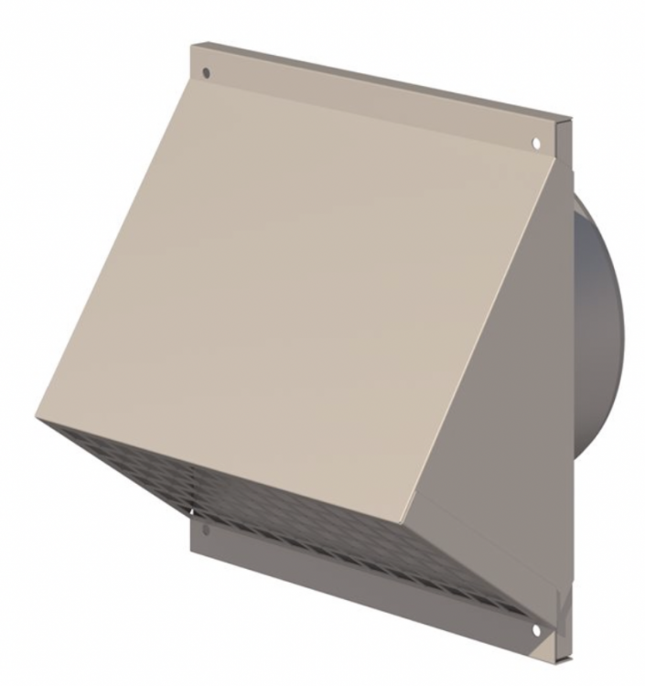

Dreadnaught Posted November 18, 2021 Posted November 18, 2021 How do I go about drilling holes in my exterior walls for MVHR ducts (2x) to atmosphere? What tools should I use? How should I do it? Guidance, suggestions & tips most welcome! External walls (closed cassettes) OSB, 12.5mm, Smartply Propassiv – inside Empty cavity 240mm, to be later filled with blown-cellulose insulation. Studs every 600mm. Magply, 9mm – outside House warp: Tyvek Firecurb Ducts (2x) Ubbink 160mm (internal diameter) insulated ductwork External diameter: 192mm External cladding (not yet installed): Cedral lap planks (190mm, 30mm overlap), over treated battens. External wall terminals (x2):

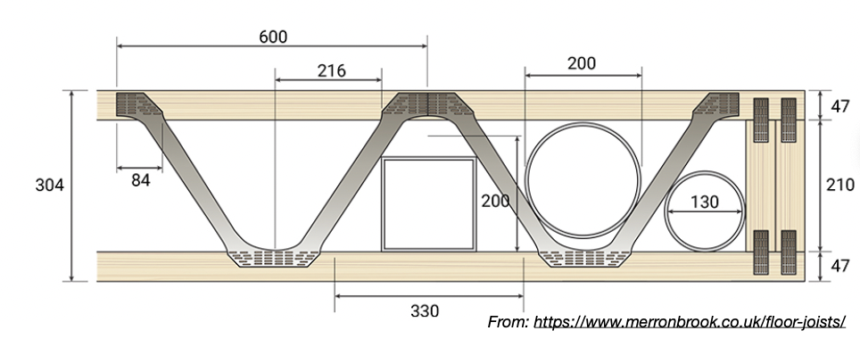

Dreadnaught Posted November 18, 2021 Author Posted November 18, 2021 Good suggestions. Thanks all! One problem. For the inside holes I will be cutting through the span of a posi-joist, which is positioned against the wall. I don't think there will be enough space for a jigsaw. The posi-joist is 304mmm, so a 200mm howl will only just fit, as follows:
saveasteading Posted November 18, 2021 Posted November 18, 2021 yours is 192mm so looks ok but very precise work in lining up your wall hole. How precisely are the joists laid? a few mm +/- may give you issues. Is there any concern that your pipe could vibrate and transfer noise to the joists and then room?
Dreadnaught Posted November 18, 2021 Author Posted November 18, 2021 Just now, saveasteading said: How precisely are the joists laid? a few mm +/- may give you issues. I checked them with a tape measure so all looks well. Just now, saveasteading said: Is there any concern that your pipe could vibrate and transfer noise to the joists and then room? Good point. It is foam mass-flow ductwork so I think it should be OK. It should absorb any vibration. And, too, the joist in question only serves a utility room and the main bathroom, fortunately not a bedroom.
Nickfromwales Posted November 18, 2021 Posted November 18, 2021 5 hours ago, Dreadnaught said: One problem How far from the inside edge of the pozi to the internal PP panel? Maybe a recip saw will be the weapon of choice if you cant get a jigsaw in there. I'd rather buy a tool I know I'll use again vs a one-shot tool that will gather dust from that day onwards. Or, https://www.screwfix.com/p/erbauer-adjustable-holesaw-with-cowl-29cm-9-piece-set/2571V?tc=FB3&ds_kid=92700055262507123&ds_rl=1244066&gclid=Cj0KCQiAkNiMBhCxARIsAIDDKNXkPP7NLdl4oP0CRkpnaiIufaNeLkbkj04xNZWniNY_IihSVsxYZwQaAlU7EALw_wcB&gclsrc=aw.ds Can be used for cutting spots out etc later so multiple uses for that. The cowl on that will need to be removed to get in between the webs of the joist, and you'll need balls if steel for that. Me personally, I'd just remove a 600mm square of the external board, cut the PP panel from outside in with a jigsaw / multitool / recip saw and refit. Drill a centred pilot through the hole you just made to mark the external panel, after glueing and screwing it back to the 600mm c'd vertical frame spines, and then cut out with the jigsaw..
Gus Potter Posted November 18, 2021 Posted November 18, 2021 5 hours ago, saveasteading said: yours is 192mm so looks ok but very precise work in lining up your wall hole. How precisely are the joists laid? a few mm +/- may give you issues. Is there any concern that your pipe could vibrate and transfer noise to the joists and then room? Good spot.. learn something new here every day here!
Dreadnaught Posted November 18, 2021 Author Posted November 18, 2021 9 minutes ago, Nickfromwales said: How far from the inside edge of the pozi to the internal PP panel? The pozijoist is touching the wall. 8 minutes ago, Nickfromwales said: Me personally, I'd just remove a 600mm square of the external board, cut the PP panel from outside in with a jigsaw / multitool / recip saw and refit. Drill a centred pilot through the hole you just made to mark the external panel, after glueing and screwing it back to the 600mm c'd vertical frame spines, and then cut out with the jigsaw.. Ingenious! Thank you to everyone once again for more ideas. I'm back on site on Saturday and I will be up on my step ladder again for another look… and think.
