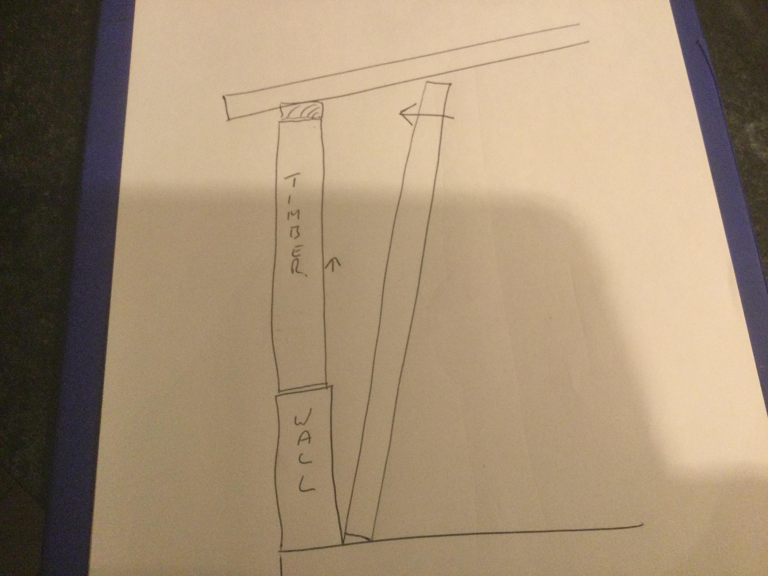

Thanks for this Mark. Are you able to point me to a YouTube video or draw a quick sketch of what you’re describing please? I have never used a jack before and can’t quite picture what a timber on top of a jack looks like!! (Total novice here)
Hi, depends on what car jack you have and where you can lift/support your structure.
think of putting a fence post on top of the jack to make it much taller (assuming you will lift under a rafter or door header etc. Be careful to make sure it is vertical and jack is secure or the timber will want to push out …. With force.
an acro prop is the safer and easiest way of supporting/lifting joists or a doorway etc.
Is the ceiling In yet?, if not get some 4x2 a little longer than floor to ceiling joist height, against the wall at the bottom at an angle and slide (wollop) against the ceiling joists, this will lift it the small amount you need.
brilliant! Thanks so much. We have plenty of timber, and no ceiling on as yet, so will have no problem doing this.

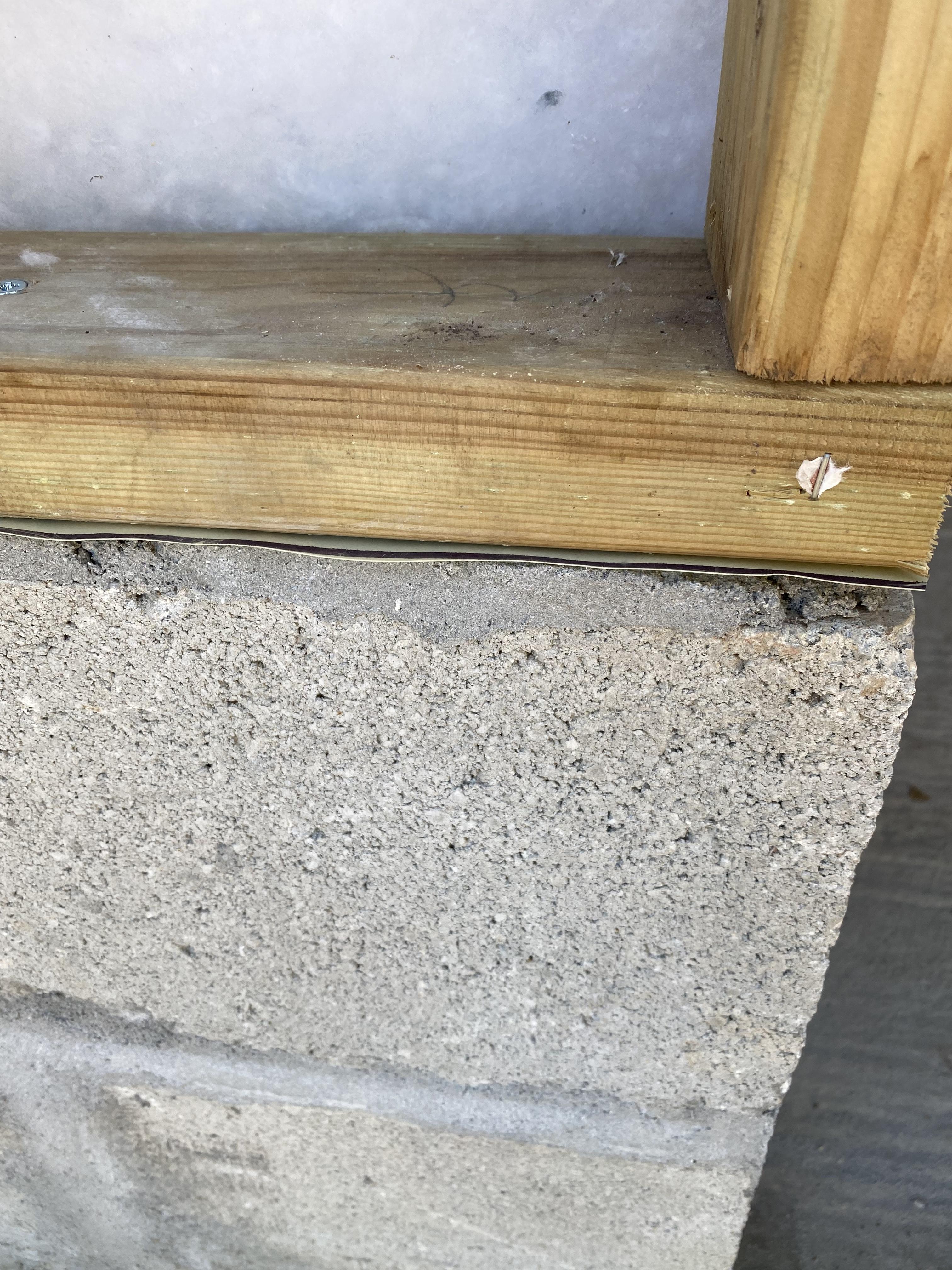

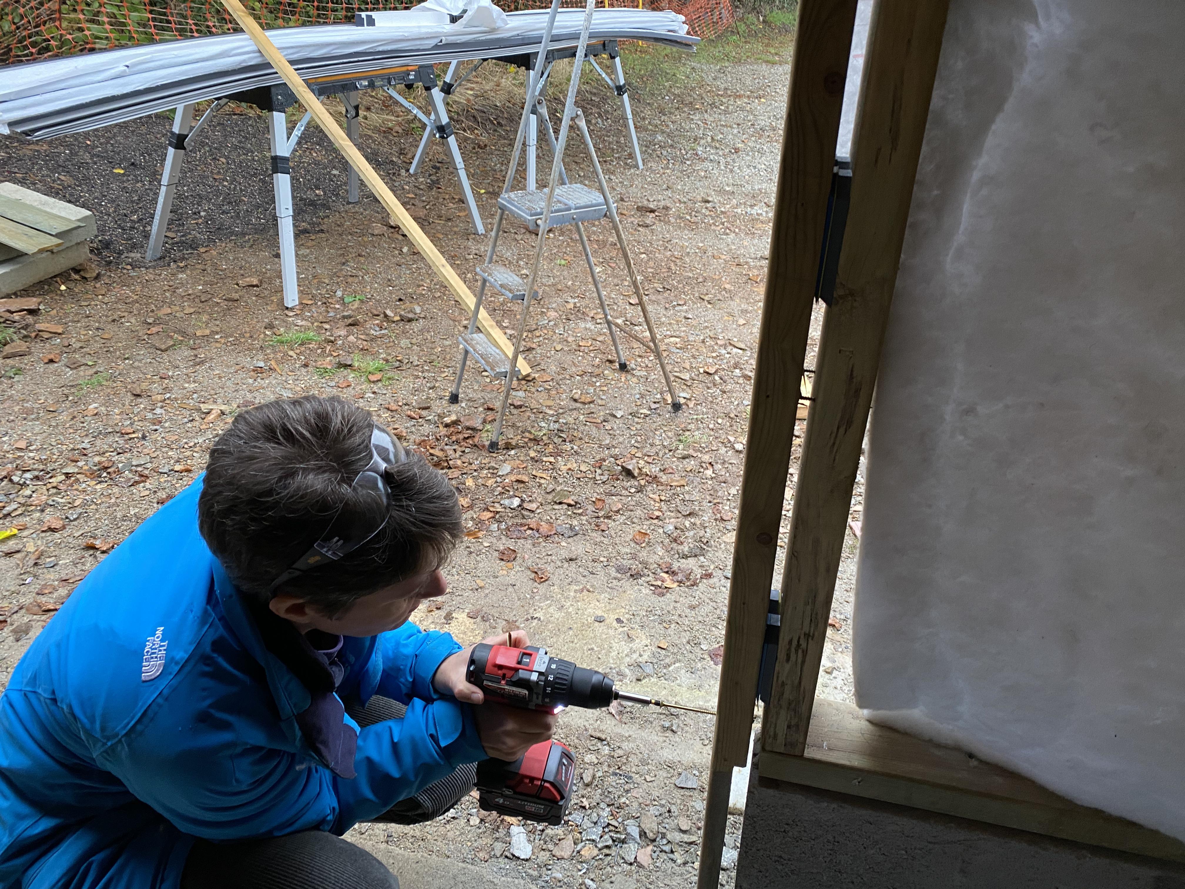

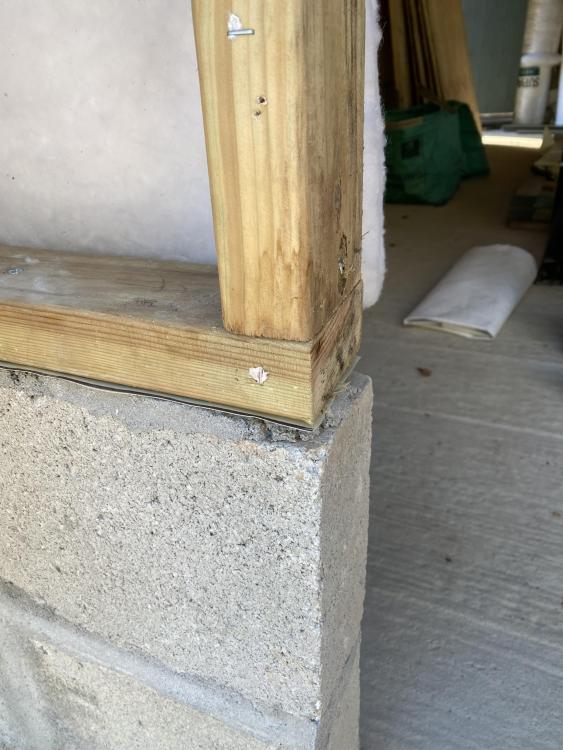

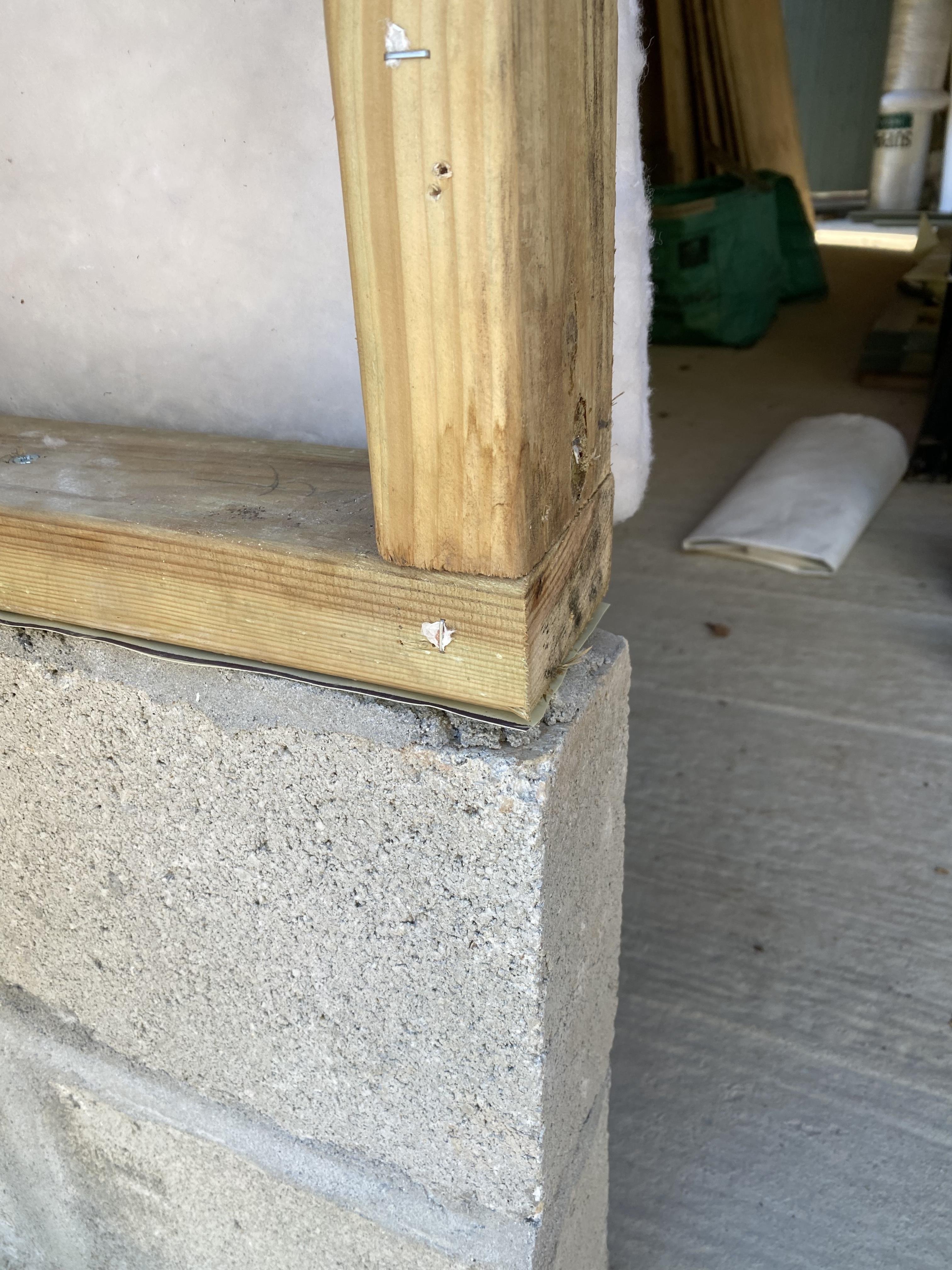

@tonyshouse @markc @joe90
thank you all so much for your advice on this. Just wanted to update that this was successful and not too difficult. I’ve uploaded a couple of pics which are not that fascinating but a testament to the excellent advice you all gave me. Thank you! m
