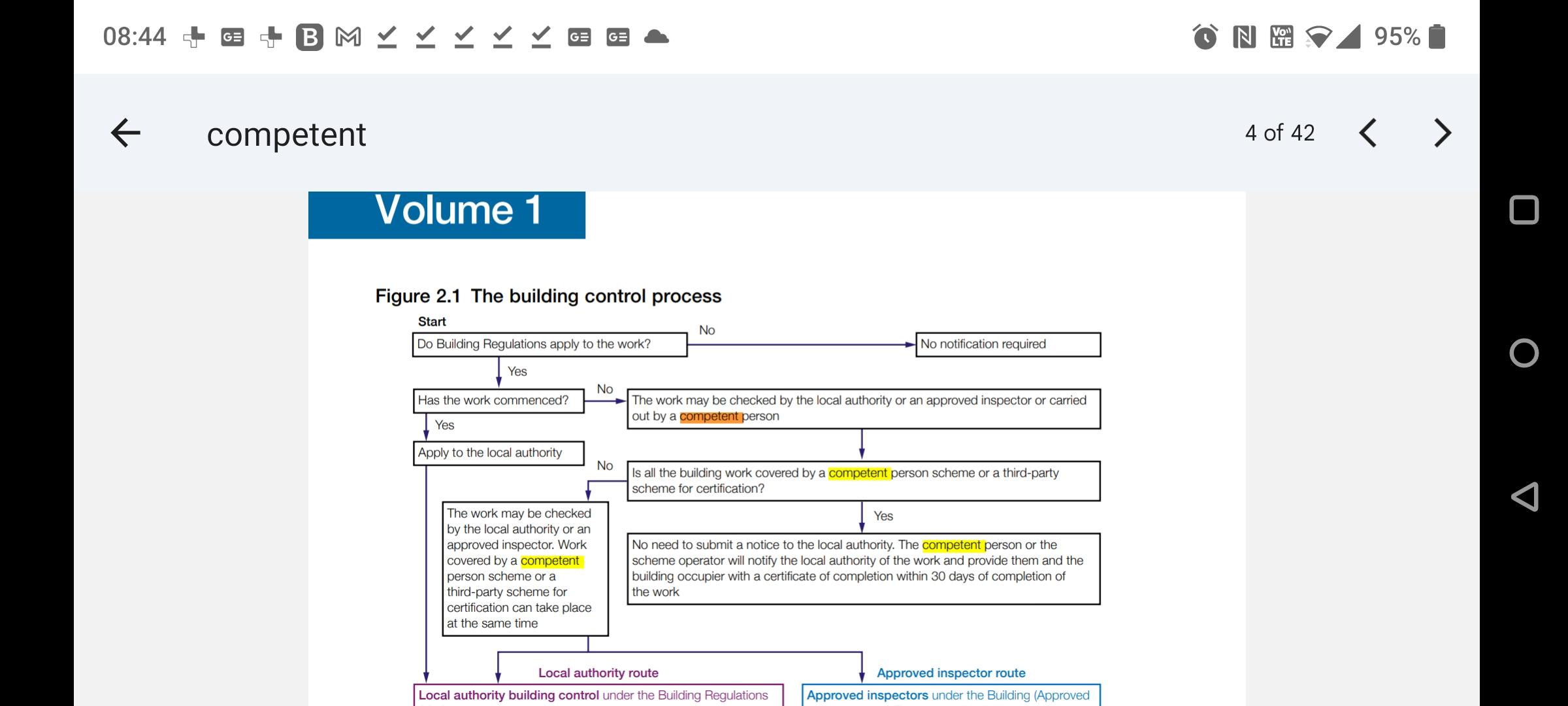

JohnMo Posted February 20, 2024 Share Posted February 20, 2024 1 hour ago, JamesPa said: If that's correct then it's a long way from what the industry tells us, ie that you _must_ have the qualification to install a UVC (with a strong implication that it's a legal requirement). I think I will do some more reading of the building regs! G3 regs state 3.10 Hot water storage systems should be designed and installed in accordance with BS6700:2006 + A1:2009 Specification for design, installation, testing and maintenance of services supplying water for domestic use within buildings and their curtilages BS6700:2006 states 4.1 Maintenance procedures Maintenance procedures shall be adopted to maintain the performance of the installation at the level specified in this standard for the original design and installation. Unvented hot water storage installations shall be maintained and repaired only by a competent person (see building regulations A.1). 4.7 Vessels under pressure Any vessels storing water under pressure shall be inspected for indications of deterioration no less frequently than at the intervals recommended by the manufacturer. Expansion vessels shall be inspected for indications of deterioration in strength and the gas pressure measured no less frequently than at the intervals recommended by the manufacturer. If the gas pressure is not within the limits specified for the application it shall be adjusted to within those limits. Link to comment Share on other sites More sharing options...
sharpener Posted February 20, 2024 Share Posted February 20, 2024 1 hour ago, JohnMo said: G3 regs state 3.10 Hot water storage systems should be designed and installed in accordance with BS6700:2006 + A1:2009 Unlike the rest of the excerpts the use of the word "should" here implies that it is not in fact mandatory. But as it is notifiable under the Building Regs I don't know how you would in practice get away with anything else. If DIY I imagine they would inspect just like other building work. G3 installers can self-certify IIRC. Then there is the old conundrum about definition of "competent", maybe it is elsewhere in the G3 regs. OSO cylinder has internal expansion space and no provision for measuring or adjusting the pressure. The instrs have a complicated process for initial fill which I have never had to implement (and I bet the HP installers don't know about). Ariston instrs are much the same as Ideal quoted above, annually. If the pressure is wrong there is water hammer so you soon know about it. Link to comment Share on other sites More sharing options...
JohnMo Posted February 21, 2024 Share Posted February 21, 2024 8 hours ago, sharpener said: Then there is the old conundrum about definition of "competent", maybe it is elsewhere in the G3 regs. They don't make it easy. The Manual to Building Regs states "Some types of work may be done by a ‘competent person’. This is a term for an installer who works under a scheme that has been approved by the government." Then a table showing work process. Link to comment Share on other sites More sharing options...
JamesPa Posted February 21, 2024 Share Posted February 21, 2024 (edited) Thanks for looking this up. Its particularly interesting that they use 'should' for the installation and 'shall' for the maintenance. One might expect it to be either the same or the other way round. Poor drafting? The 'competent person' chestnut is as you say an old and frequent one. Its obvious that a way to 'prove' competence is to have a relevant certificate (notwithstanding all the evidence that many HP installers are not very competent), but its not clear its the only way. A key point (as I understand it*) seems to be, however, that even if you have the qualification (proving 'competence') you still need to notify building control (and thus pay the notification fee) unless you are also a member of a competent persons scheme. I guess that if you do notify and also present your certificate of competence they may be less likely to inspect, but since you have paid the fee anyway its unclear whether this is to your advantage. All a bit confusing! *The closest I have found in the actual regulations (applying to England) is reproduced below Building Regs 2010 Article 12 And from Schedule 3 Edited February 21, 2024 by JamesPa Link to comment Share on other sites More sharing options...
JohnMo Posted February 21, 2024 Share Posted February 21, 2024 1 hour ago, JamesPa said: you still need to notify building control (and thus pay the notification fee) unless you are also a member of a competent persons scheme I rang mine and they basically said not interested. If covered by other work that required planning permission, they are interested, otherwise not interested, get on with it. So I would think most councils will be the same. Unlikely they log what properties have an UVC unless otherwise stated in a planning application. Basically I have 2 certs "water bylaws" it states I should join a self certification scheme, where as, the "G3" cert says nothing. You would think it would be the way round. Not sure they know which way is up, so why should anyone else? Think like a lot of conversation on here, it turns out the 1% (or less) of people try to go the right thing, while rest do what they want, even the professionals, than should know better. Link to comment Share on other sites More sharing options...
JamesPa Posted February 21, 2024 Share Posted February 21, 2024 2 hours ago, JohnMo said: I rang mine and they basically said not interested Fascinating, you might think it was easy money for building control! Link to comment Share on other sites More sharing options...
JamesPa Posted February 22, 2024 Share Posted February 22, 2024 (edited) @JohnMo @sharpener I read the Building Regulations 2010 (England) (as amended by subsequent enactments) end to end (except the bits specific to types of building other than DHW). I confirm that the only requirements I could find are (a) that the works conform to the specified requirements (reproduced below) and (b) to notify the local authority of the works (which, in England anyway, attracts a fee) unless the works are carried out by someone who is a member of a competent persons scheme. Some might argue that the 'safest' way to achieve this (if you are yourself fairly capable) is to have the qualification and do the work yourself, working strictly to the guidance document and manufacturer instructions, with the next safest way (or safest if you are not yourself fairly capable) being to employ someone who has the qualification . In the latter case, if they are also a member of a competent persons scheme, building control don't have to be notified. However none of this is an actual requirement in the regulations, unless I have missed something*. Its rather interesting how the law has been drafted, even more so since @JohnMo tells us that his building control weren't interested. (*there may have been something additional which applies if you are doing the work as a business for another person - I wasn't looking for that) Additionally there may be guarantee/insurance issues as you point out, although I do wonder how valuable this is - i.e. how many DHW cylinders fail within the guarantee period I wonder - other than the immersion heater?) For an individual keen on DiY there might be a good case for simply doing it, and getting building control to inspect and issue a completion certificate or tell you what was wrong. Regulations related specifically to DHW reproduced below Edited February 22, 2024 by JamesPa Link to comment Share on other sites More sharing options...
