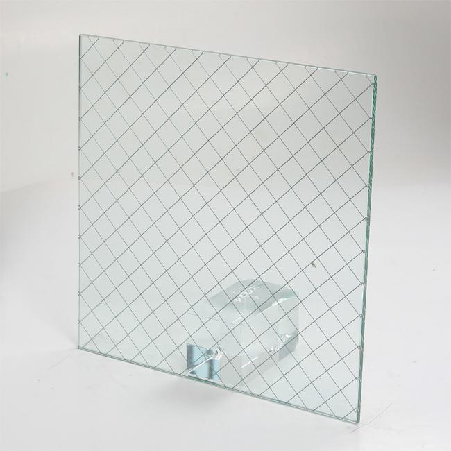

Or you could fit wired glass.
With wired glass, would the wires be visible, given that it will be almost 2m from head height. Because if not, that might be a great idea.

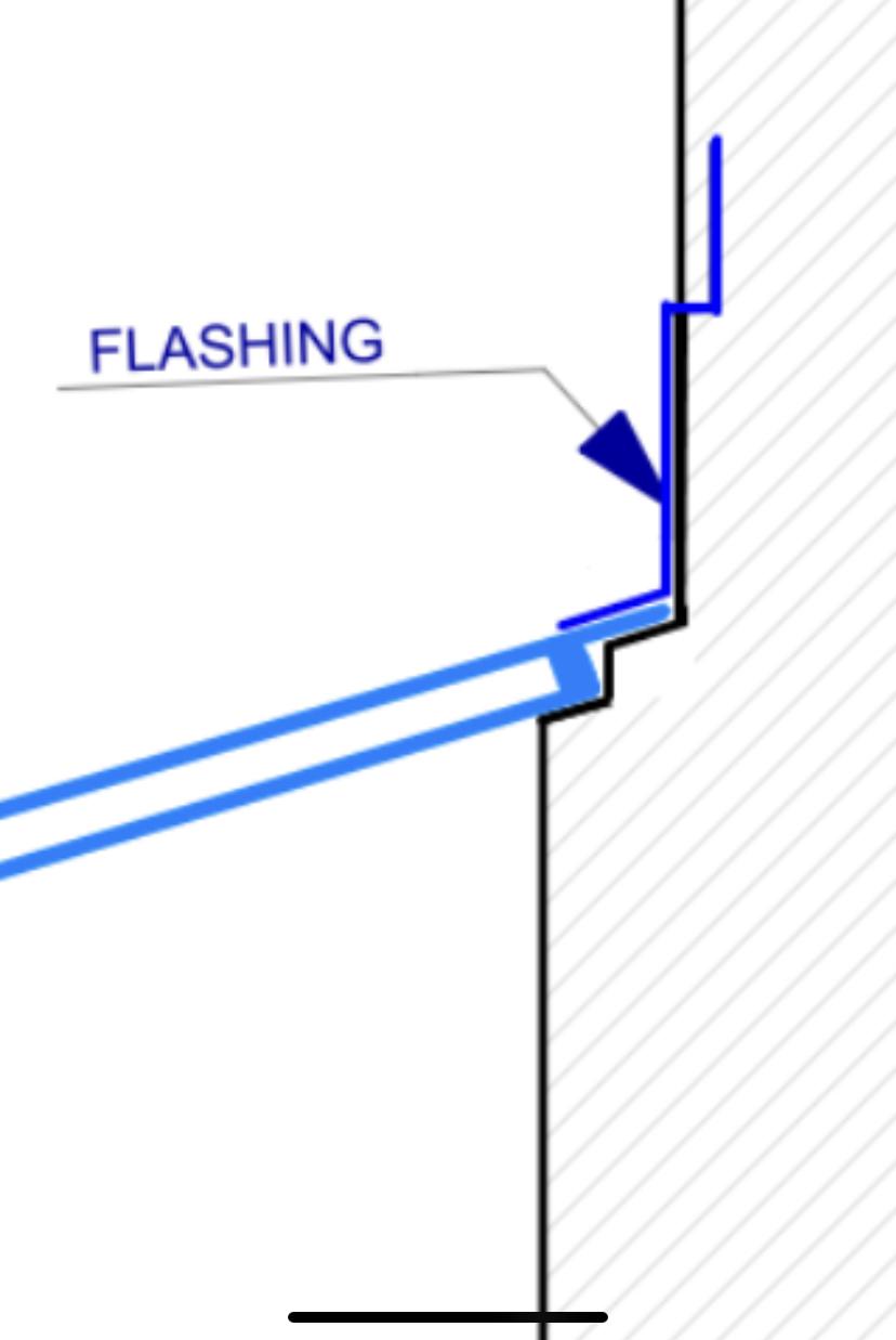

Sorry, really out of my depth here. This is a drawing of what is proposed:
i now realise the angle is much more than 4 degrees.  Can somebody explain the staining? How much staining will there be and how far will it spread across the glass? If it is just a couple of cm, it shouldn’t matter because there is a a plasterboard overlap internally that will hide some concealed internal LED lighting strips as well as prevent from unseeing the edge of the roof light.

So … given this is 4m by 1m, how was the architect planning the roofer insert that flashing too ..?? You need to be able to kneel in front of the wall to do it - as it stands you’ll need to stand on the glass to install it.
Also, how will the rendering company render down to that flashing ..?  It is incorrectly designed as the flashing just needs to cut into the blockwork by 30mm and then the render goes over the top with a bell cast or stop bead.
None of that has been thought about and it really should have been from the outset.

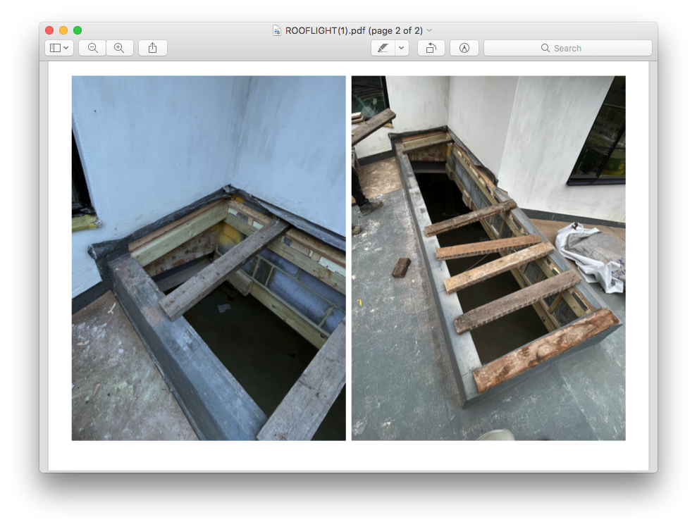

I haven't ordered the glass, so in theory you are right that everything is still possible. In practice changing things up at this stage is going to be prohibitively expensive. here are some pictures. Keep in mind the pitched roofs on either side AND the wooden upstand on the left and the top frame of the opening all the way around is ALL covered in a rubberised coating that also covers the pitched roofs. That coating insn't straightforward to re-do so moving the hole is not going to be cheap. Structurally, there are a couple of steel beams under either side of the opening. One of those beams supports both the first floor extension wall and will also support that side of the rooflight, whereas the other beam supports the rafters and the other side of the roof light.

Ok so that needs doing in 2 sections. The “architect” has drawn something that is only suitable for the enclosed end, the open end will need a full aluminum flashing as there is nothing for the glass to mount onto. You can’t just stick some structural glass compound on top of that rubber coating and hope the glass sticks to it.
Have you taken a straight edge to any of that ..? More than 3-4mm out of plane and it will need packing etc.
Have you spoken to a specialist and got them to properly survey this as that is not a quick or simple job - a picture speaks a thousand words.
Also - where is the insulation in that kerb, and how are you insulating that flanking wall as it’s a big cold bridge.

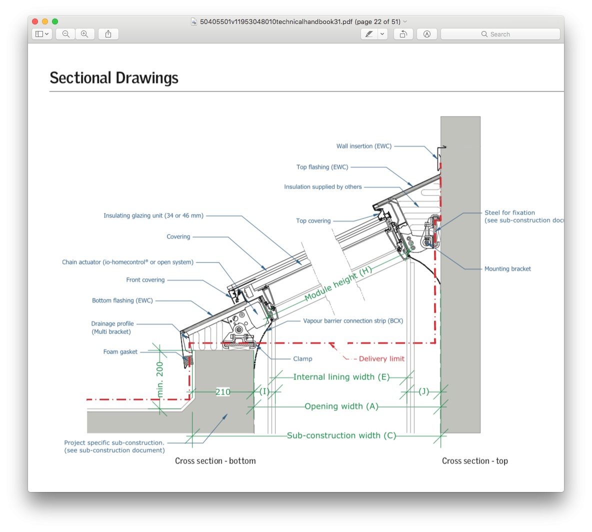

Looking at the cross sectional design of the Velux product you've suggested, it also has a flashing (marked "Top flashing (EWC)"). See below.
So I query what the difference is. I think it's that Velux flashings are made of aluminium and then painted grey. What's to stop me painting my flashing with an appropriate grey paint?
The EWC flashings are correctly designed for this sort of installation - you can see how they are cut into the wall with the lip to stop the flashing pulling free.

The other one also has a  flashing, but it will take water away from the glass down a fall in the opposite direction,
So how is that detailed at the change of direction ..? I can’t see any flashing return round the corner which you need to seal the top of this detail. There is a lot of things that can go wrong here and leak - it needs to be right first time.
I would be treating this as two separate panels - the first up to the end of the wall, then a second unit covering the end that is open. Both need different fixing and watertight detailing. Due to the thickness of the upstand you’ve got room to play with a frame system too - that allows you to detail all the fixings, sealing and flashing and then fit the glass.
