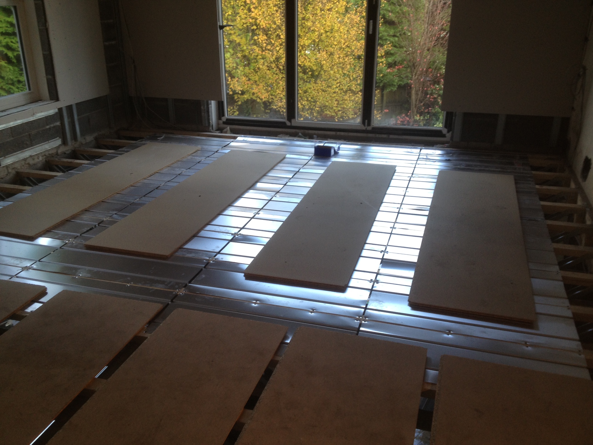

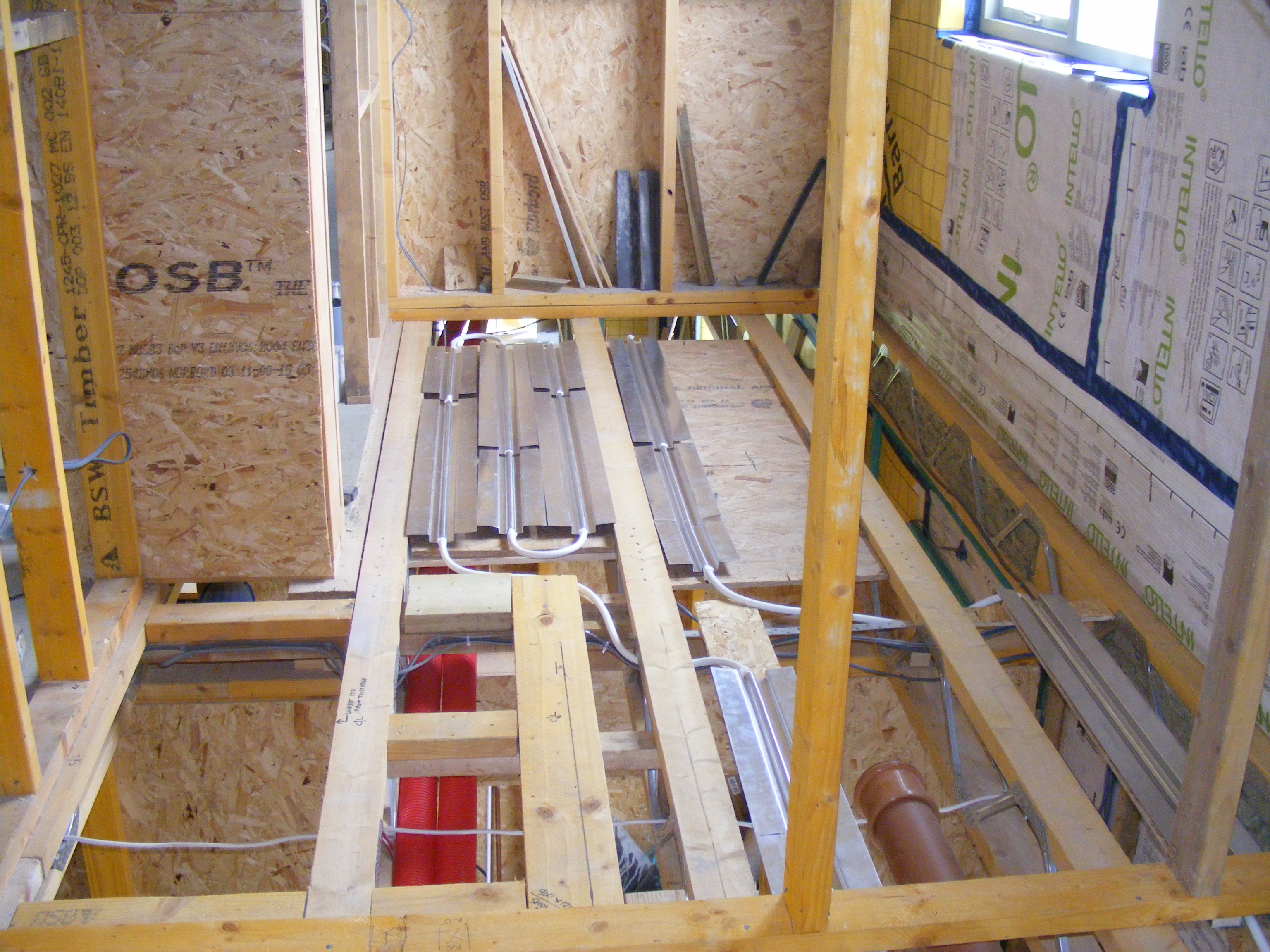

On 02/05/2017 at 09:38, ProDave said:
There is another part to this, slightly related, is that most of the room will have a non structural  OSB or ply deck suspended UNDER the top member of the posi joists, to support UFH pipes under the final floor. .
How did this arrangement work for you? Do you have any photos? I can't imagine how you cut the ply to easily fit in between the webs.
You don't go perpendicular through the webs, you go along the joist voids ;). The reference to under, I believe, is just the physical level, and you simply attach noggins as "catchers" to the underside of the top member to create a lip for the lengths of osb to rest on and get fixed to.
This is negated by using aluminium spreader plates.
Of course, that makes a lot more sense! Any advantages other than cost and the reduced potential for noise/creaky spreaders to this method?
In my case the bathroom UFH IS within the joist space.
OSB support "trays" held in place by bearers screwed to the underside of the top member of the posi joists.
Whern the floor deck goes down it touches the spreader plates.  I put a few dabs of sticks like on each as I laid the floor to stop "creaking plates"
The fiddly bit is threading the UFH pipe through the web where it needs o cross a joist. Ok on a small room with a short run but it would be a rel challenge doing this on a large room with a long length of pipe.
