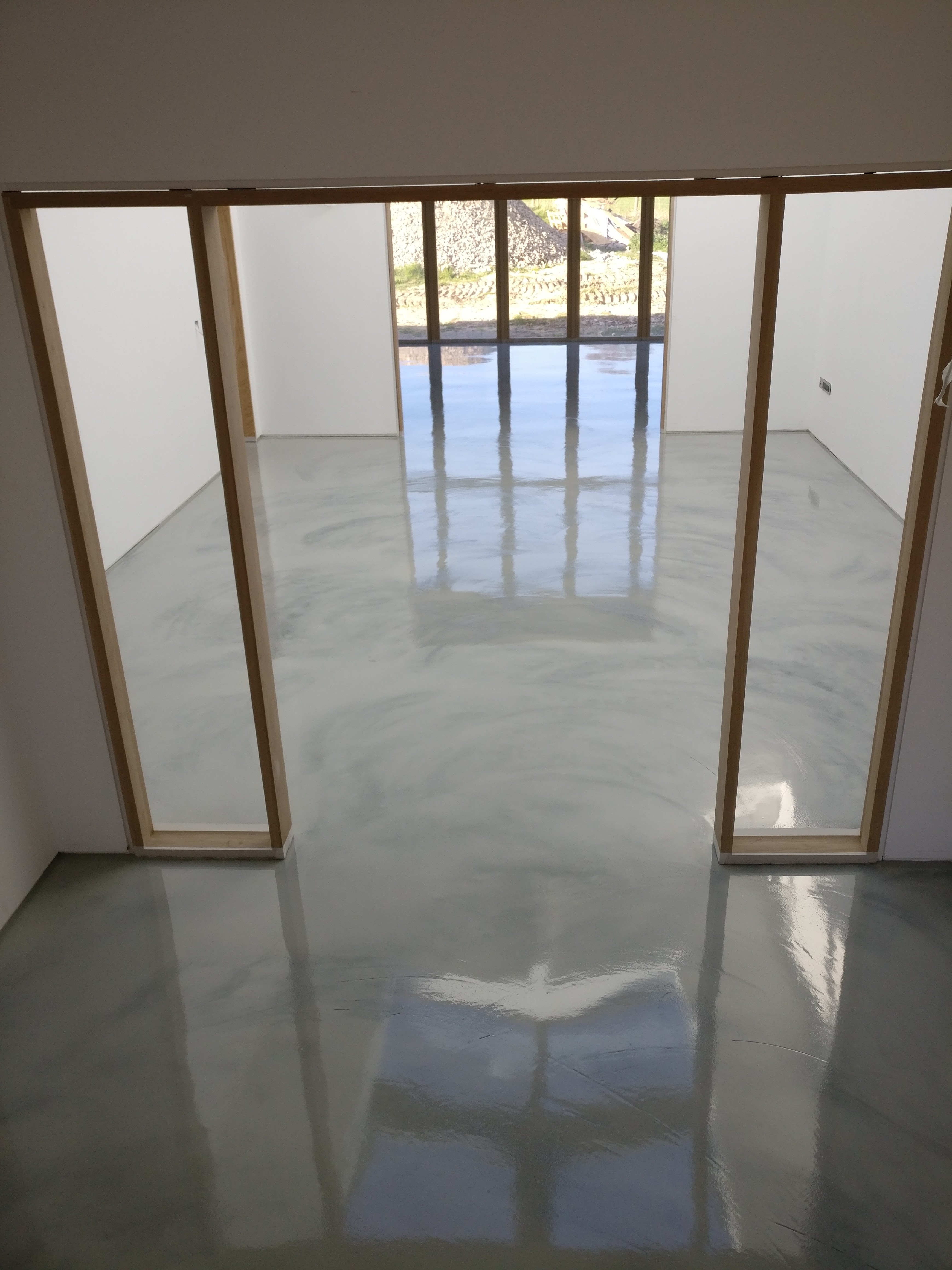

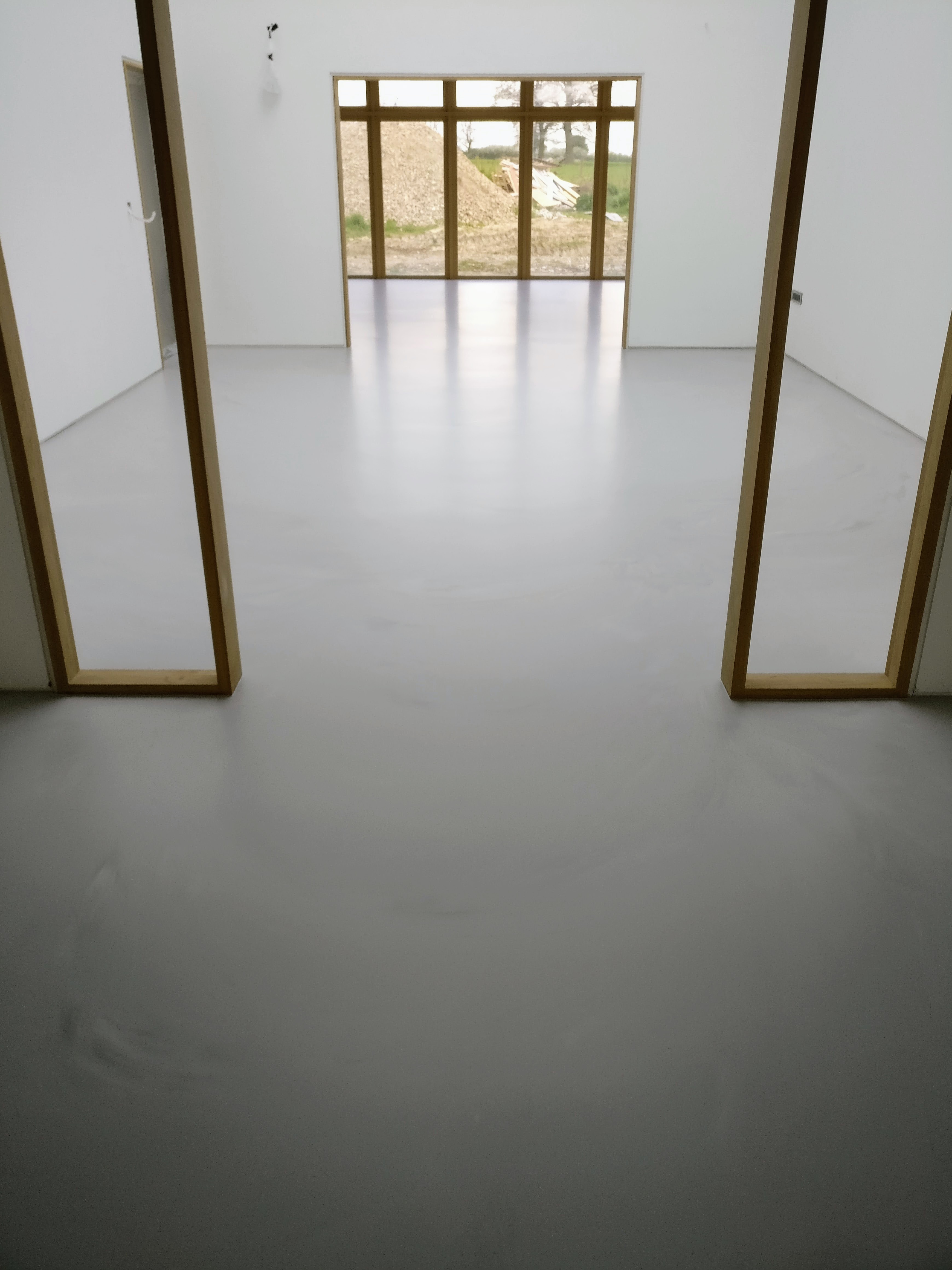

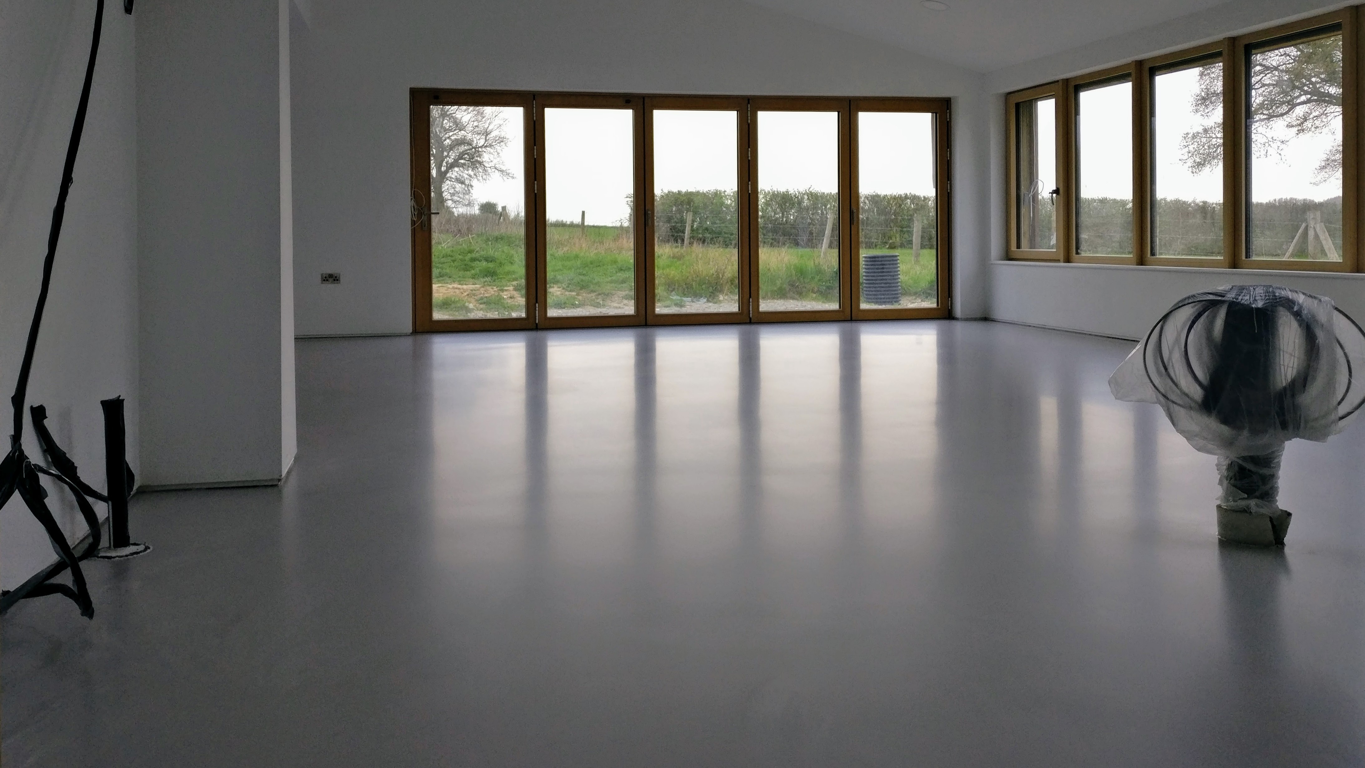

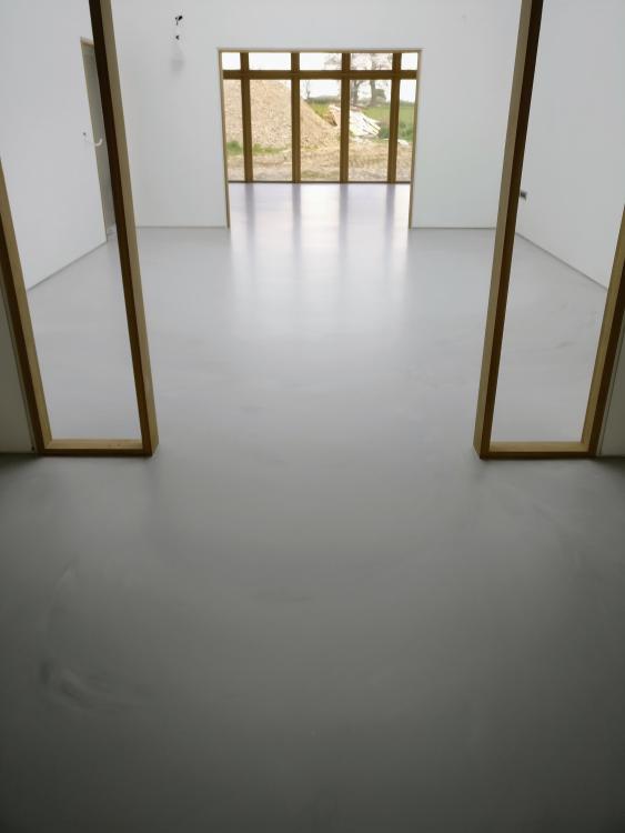

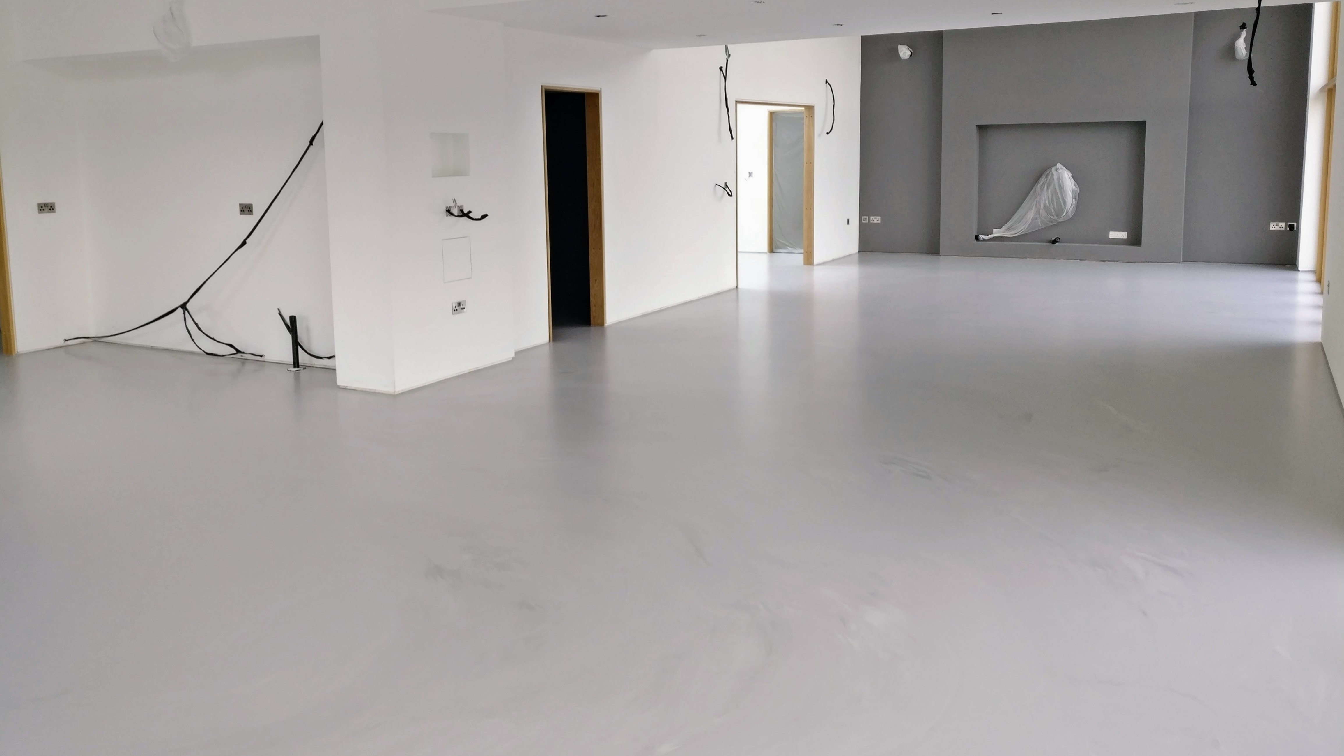

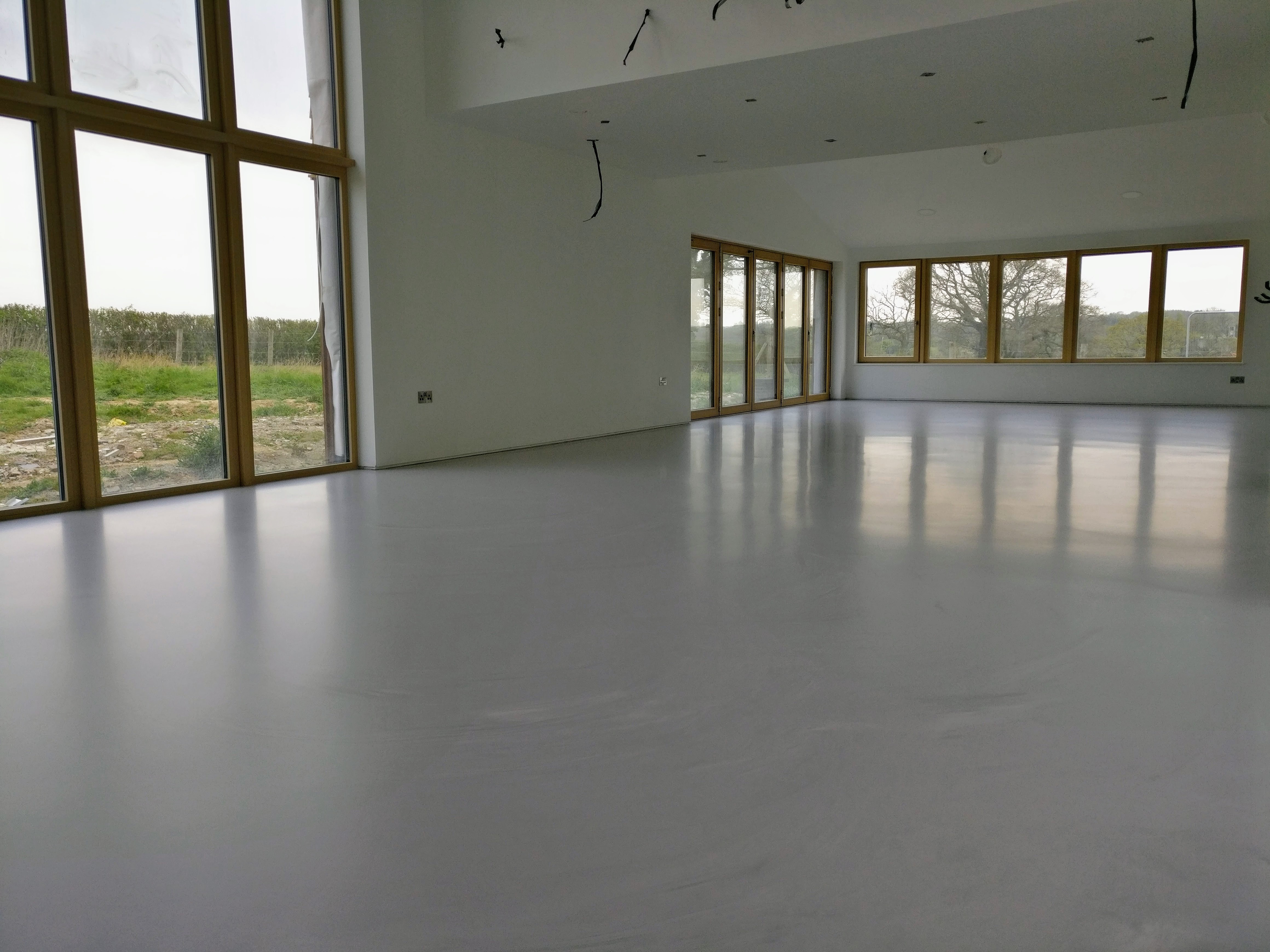

Poured Resin Floor finished and a definite success!!!
Poured Resin Floors have been discussed here a couple of times and over at eBuild.
For our living areas we looked at tiles, micro screed, polished concrete, wood and poured resin options - finally making a tentative decision to go with Poured Resin. We feel we took a bit of a risk with limited options to view the product installed, and only got to view it in a commercial/retail situation.
We got quotes from about 6 companies, but only had confidence in two of them and one of those two has, what were for us, unacceptable payment terms so the decision on the supplier took some time but ultimately made itself.
The floor was started last week and finished Monday night. First opportunity to walk on it (in socks) was today. Going to leave it another 5 days before covering.
I'm glad we took the risk, the finish is outstanding. And glad we didn't go with our second choice of polished concrete as during the light grinding stage, to key the surface ready for the resin, many more hair-line cracks were exposed than we were aware of when it had the natural power-float finish.
Great attitude from the installer too, first time they'd installed on to a C35 power-floated slab and found the grinding much harder going than they expected, so the planned 1 day's prep ran to 4 days, but they just took it on the chin.

Ours is what they describe as a "concrete look", with a two colour body coat to give some movement to the finish. Again there's the opportunity to bring the cost down a little by using a single colour, which I loved the look of, but my wife thought was too clinical.

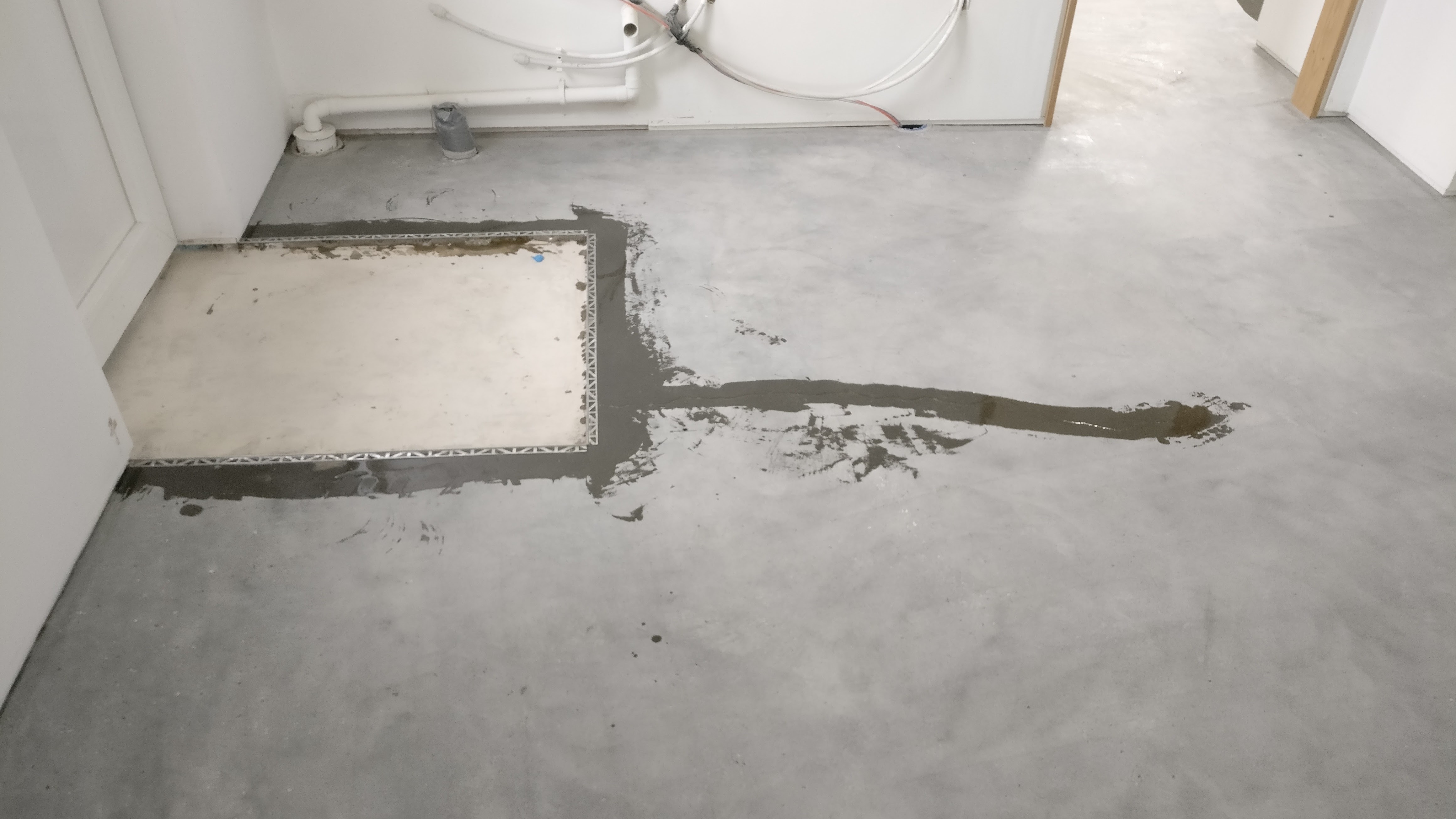

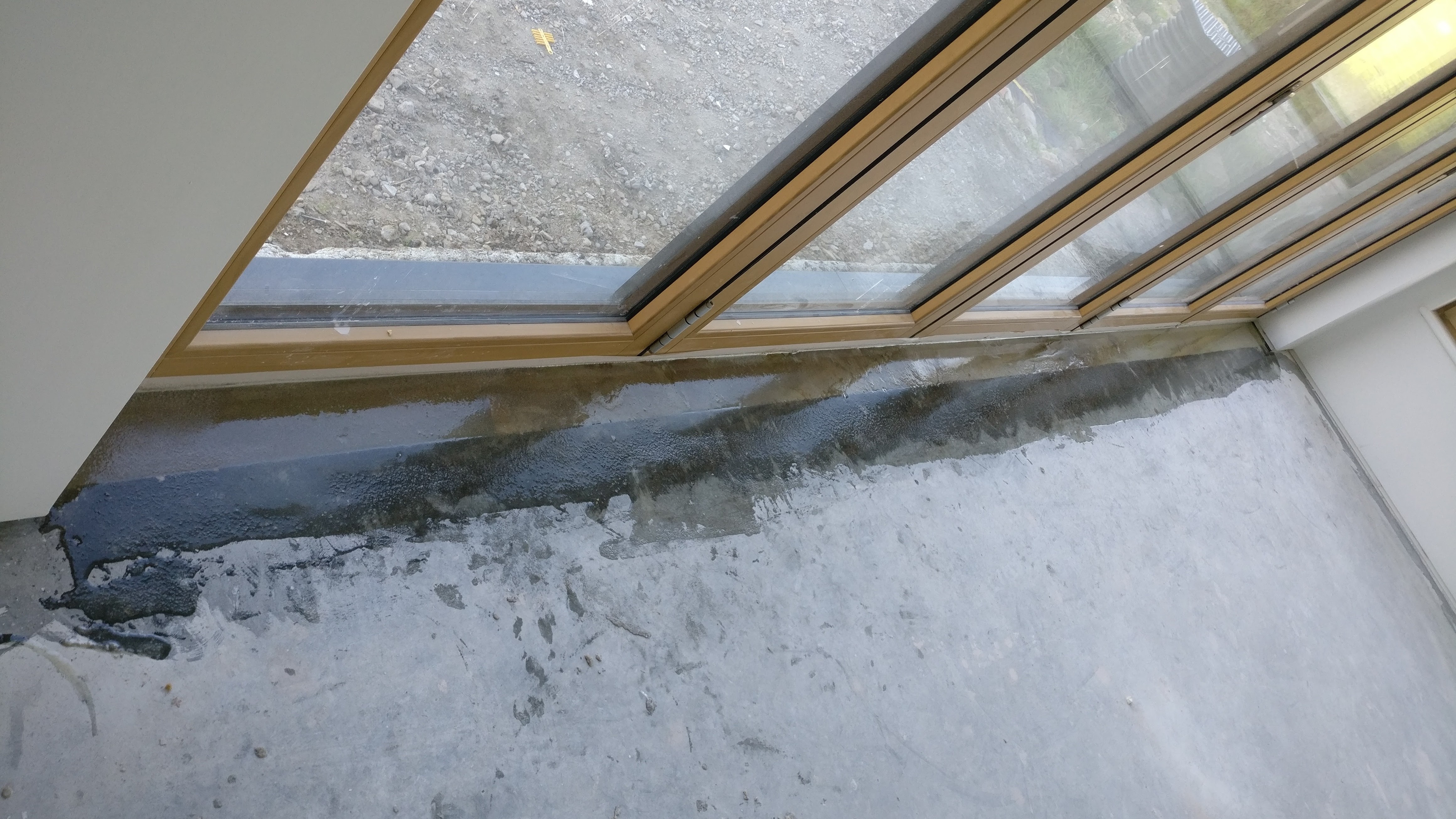

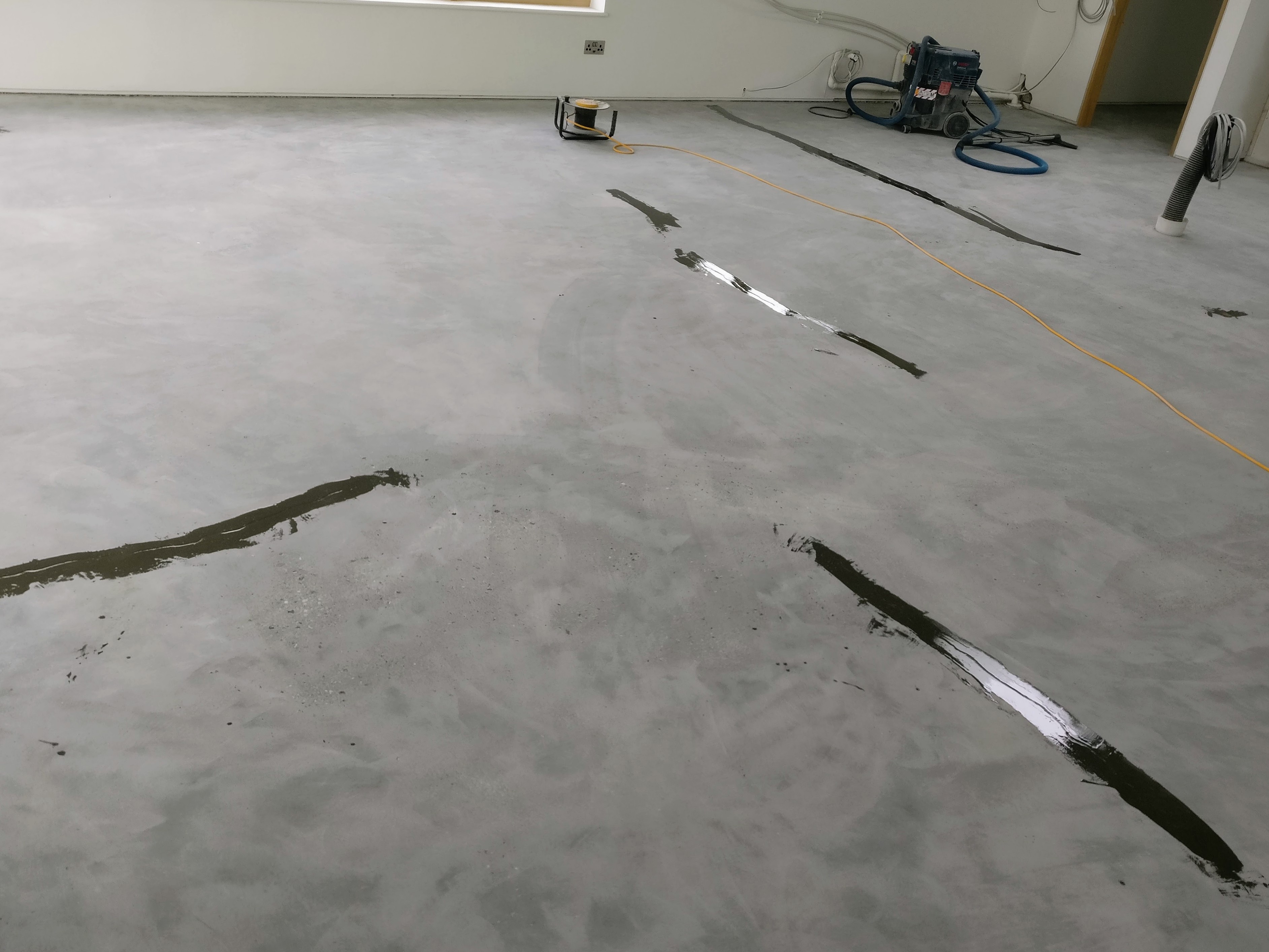

A bit of the process:
Recessed thresholds back filled with Epoxy mortar:
Slab surface lightly ground and any cracks cut back and filled with epoxy resin
Mat wells trimmed with stainless beads which are screwed and stuck (epoxy again)
Primer coat (epoxy resin) and then PU resin scratch coat applied
Then self smoothing colour coat and two sealer top coats to give the pics in the first post.

I definitely would. 5 years in and it still looks like new....almost everywhere.. We were very careful with it while the build finished, covering with a thin cortex sheeting, and giving all the trades mats or similar for putting doors, cabinets etc on to to avoid any accidents. We are still careful, in a similar way you would be with a wood floor. All our furniture has felt pads, outside shoes tend not to make it beyond the boot room.
Our boot room gets very heavy use, we live on an ex-farm and have 3 young boys and two 60kg dogs. The floor gets filthy, and outside boots come in with stones in the soles. Even this floor will mop up and look excellent, if not quite brand new. In the boot room there are two surface scratches, that are noticeable as the dirt catches in them and our floor is a light grey. The scratches are our fault, a metal dog crate got dragged across it without thinking, but work boots haven't made any wear marks.
We found a slight oddity with getting "dull" patches where we have some rugs and mats. Only just noticeable and seems to be worse if there's a backing on the rug/mat that is dark in colour. Remove the mat and these patches seem to fade away after a while.
Overall, I would definitely have it again. The groutless/seamless finish leaves no dirt traps. We can leave a robovac to take away 95% of the daily detritus from children and dogs, and just mop it perhaps once a week and it stays looking spotless. If you accept it's not as hardy as a porcelain tile, it's a fantastic floor finish.
